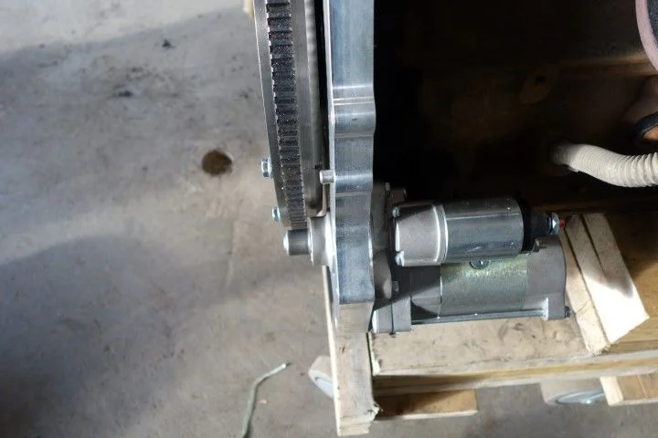

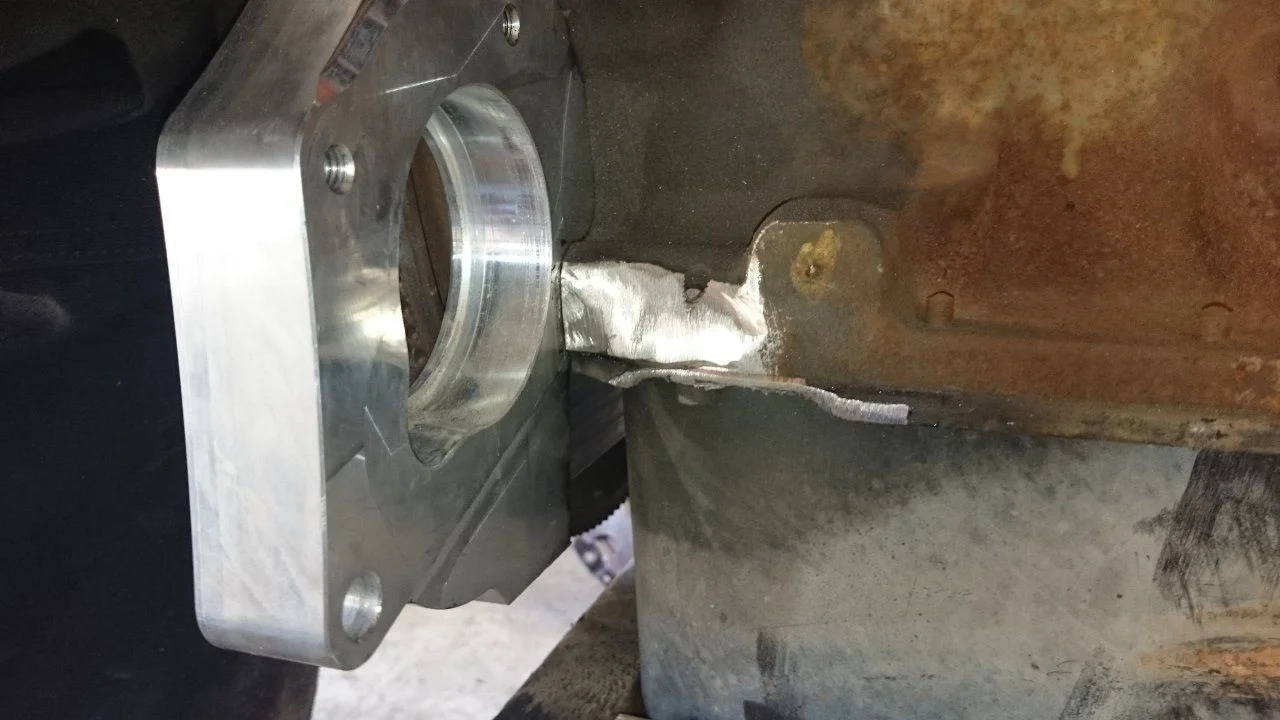

First objective was to install the starter and test clearances. The Destroked Adapter plate moves the starter to the right hand side of the engine… factory location for the Cummins is on the Left. This requires grinding a bit of the casting off the back of the block.
Once the starter was installed and bolted in, I checked clearances to the Flywheel to check starter engagement. They ring gear on the flywheel was far to close to the starter, some 13mm to close, in fact.
I called Destroked, the maker of the adapter plate, they diagnosed that I had the flywheel for the ZF6 transmission, and needed the flywheel for the ZF5 transmission. In fact the previous owner indeed had a ZF6 attached to this engine, and I was re-using the flywheel that came on the engine. According to Destroked, things should work out if I get the right flywheel. They gave me the name of the guy at South Bend Clutch to talk to, and apparently if I tell him that I am using a destroked adapter, he will sort me out with exactly the flywheel/clutch I need. So now I wait for those parts.
Still :popcorn:

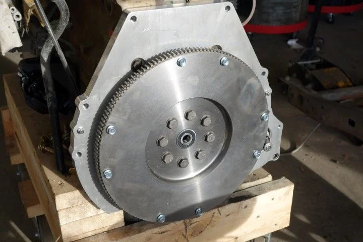

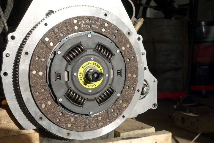

New Flywheel and clutch arrive from South Bend. Installed, started installed, and starter engagement tested A-OK. Hurray! I like it when you can just spend a lot of money to make things work.

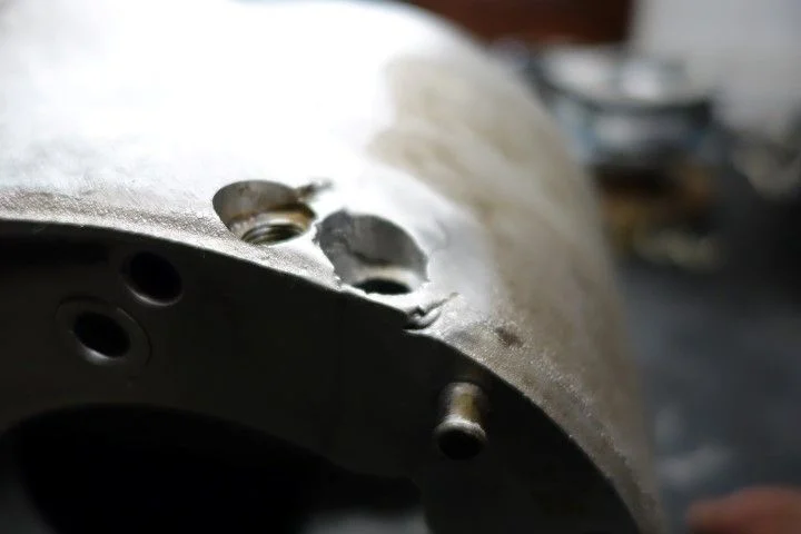

If you've been following along, you will recall that the used Atlas Case I acquired had the wrong input, and upon dissassembly to replace input, a crack in the case was found, and the new input with thte correct splines required that the main shaft be shortened. Well, that is all done now... case welded and shaft machined by local welding/machine shop.

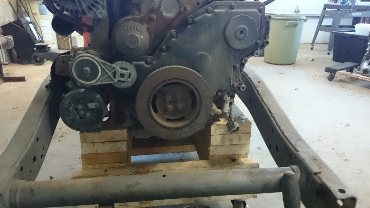

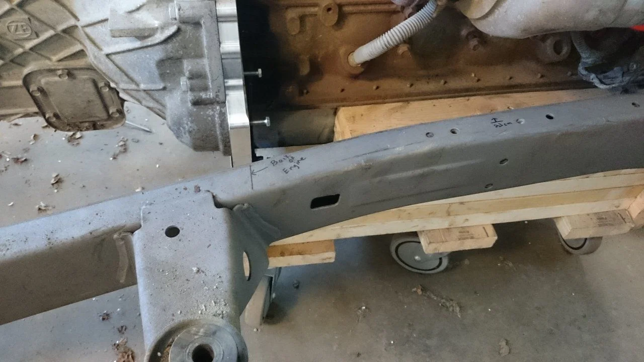

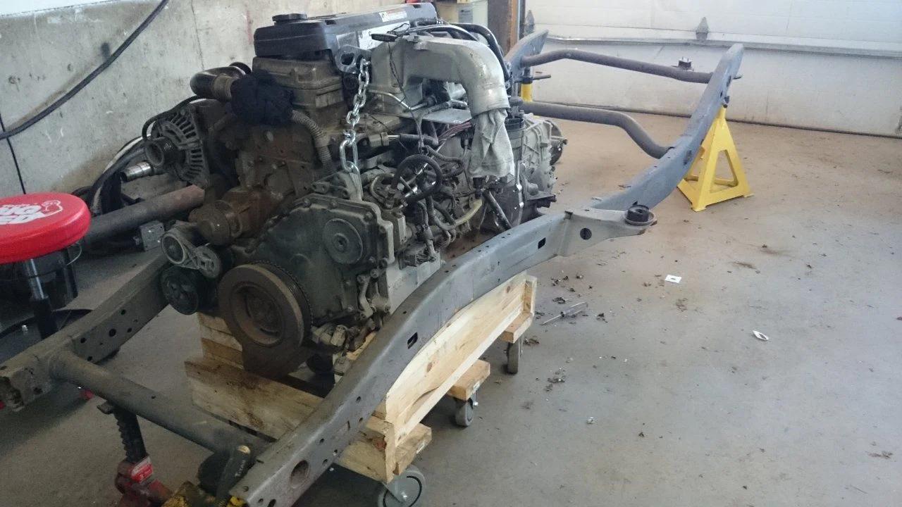

It fits between the frame rails, but it's REALLY tight. I acquired factory Ram engine mount brackets and engine mounts, and there is maybe 2-4mm of clearance between the frame rails.
Issue #2. ZF5 clutch slave cannot be installed/removed because the mounting is too close to the frame rail.
Solution... widen the frame. I can widen it by up to 180mm. More width will allow some room for the engine to flex without touching the frame, installing the clutch slave, and possibly retaining the facorty power steering pump mounting location, and possibly even allow the exhaust to be inboard of the frame rails. And, I can fit a wider radiator too.
THe down side... the extra width begins to limit steering angle, especially when articulated. The RCV Shafts I am planning say they allow 45 degrees of turn, but I measured my bone stock BJ74 at 27 degrees. I think 30-35 degrees of turn might be the right compromise. Next up... cut the frame and start mocking up for final width.
