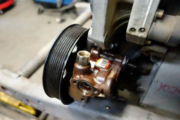

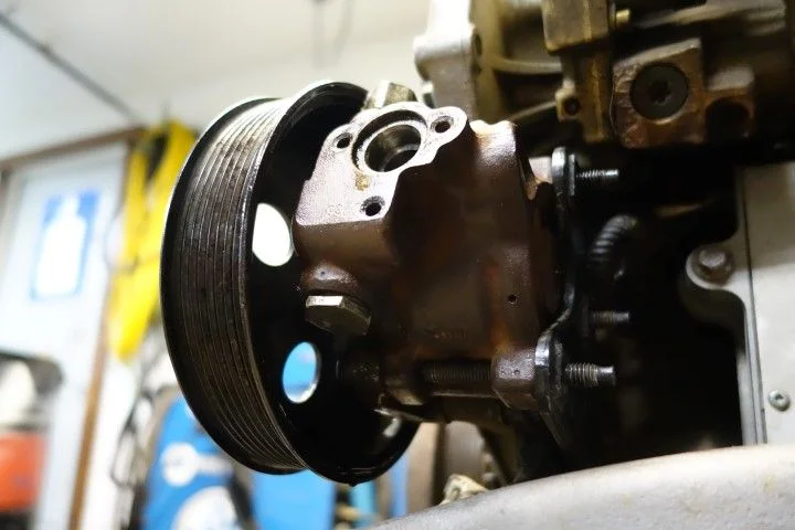

I did some inventing. One of the problems with the factory power steering with the Cummins is that the high pressure output line points down, directly onto the frame rail, where the steering shaft will need to be. I tore it down this evening, and the pressure relief spring and the output mechanism, can be reversed, so the line can point up. That problem is solved. (Mind you, I should do some testing to make sure everything works... both ends of the housing have bypass ports, and the main spring is perfectly centered between the ports, and it assembled nicely, so on the bench, at least, all seems fine.
Interesting note... for the first time I can ever remember, I got to use a 20mm socket... those pressure ports on the power steering pump are 20mm! I went through every wrench and socket in the drawer, and couldn't find anything that fit. 19 too small. 21 too big. Found an old 20mm socket, and that was it. 20mm. Who knew?!??

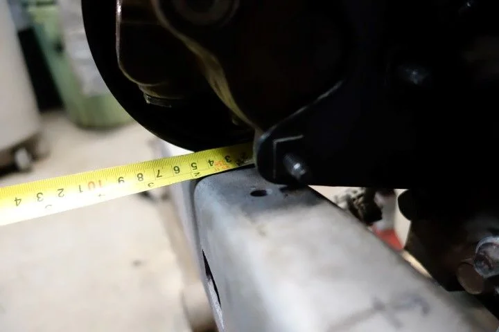

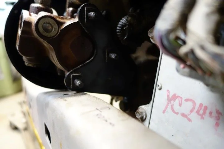

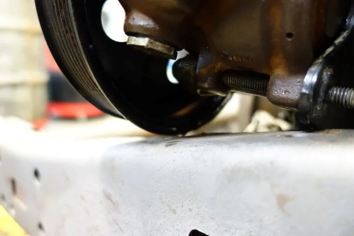

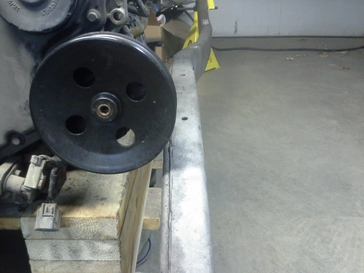

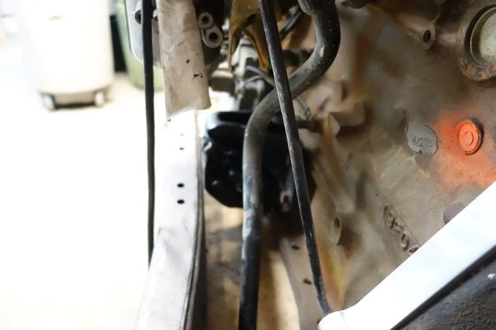

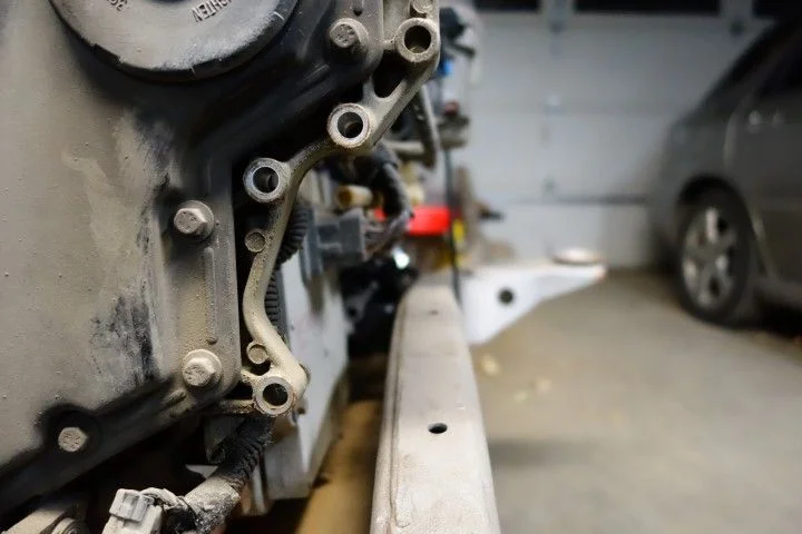

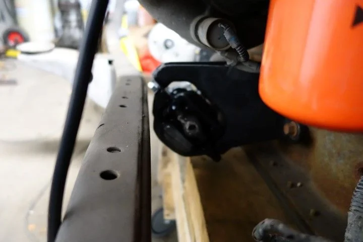

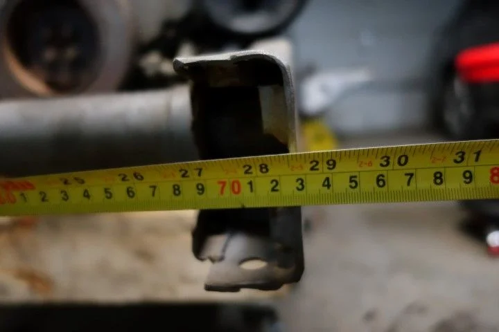

Problem remains that the power steering pump is just too close to the frame....

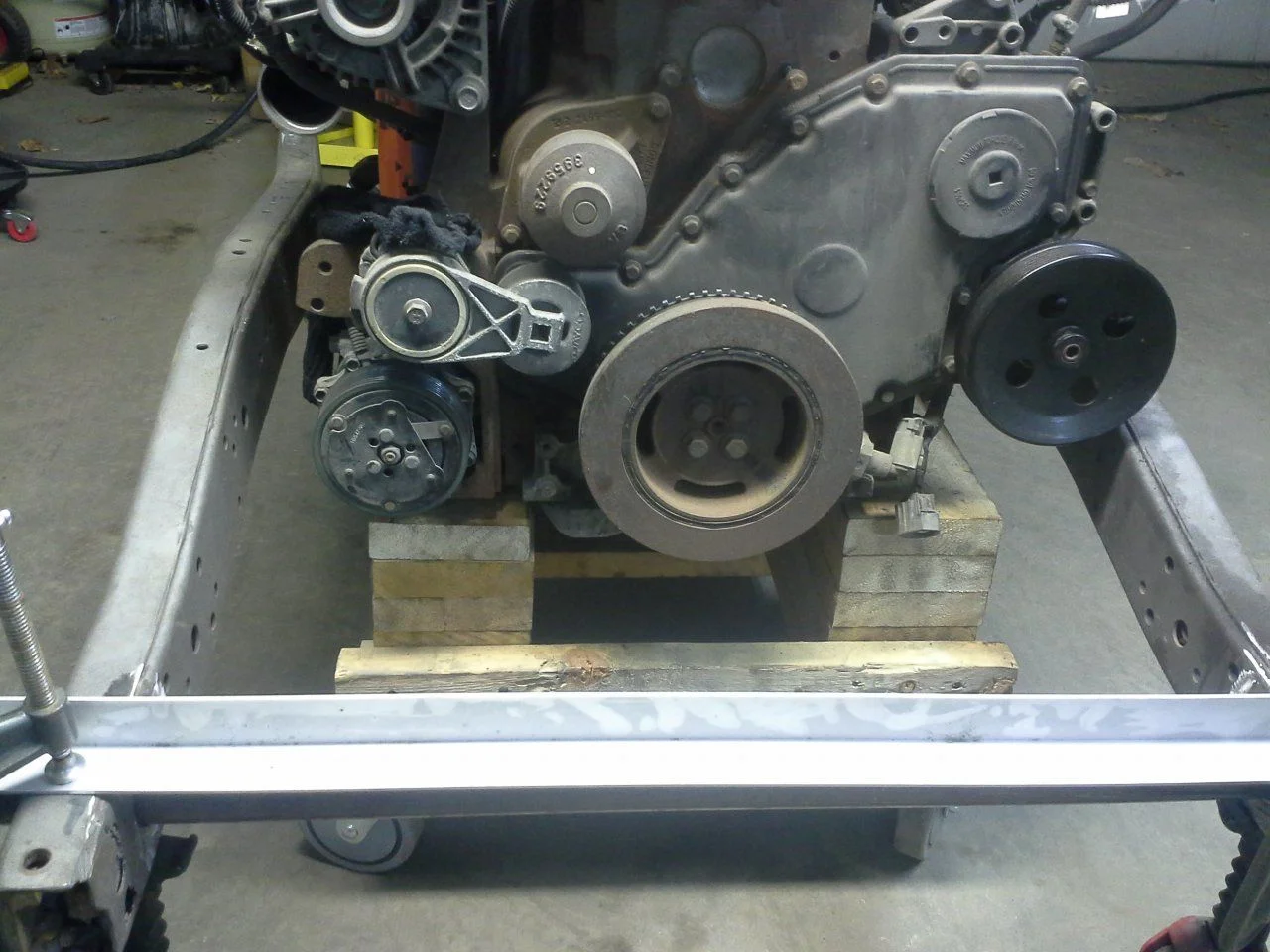

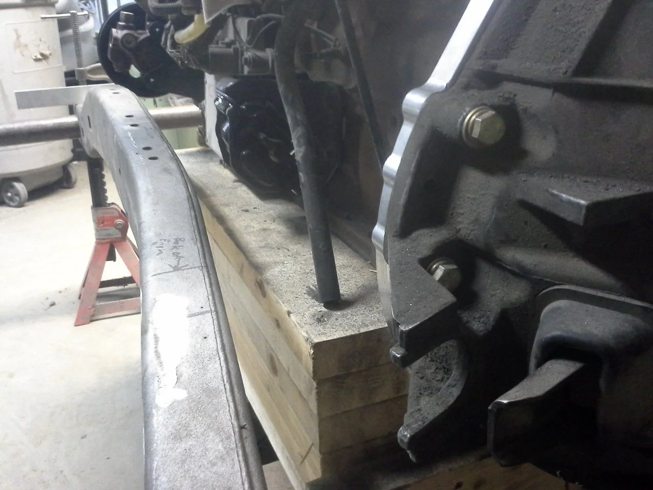

If the frame were about 50mm further outboard (100mm overall) then I could easily clear the frame with the power steering pump and pulley....

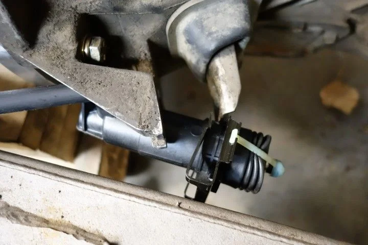

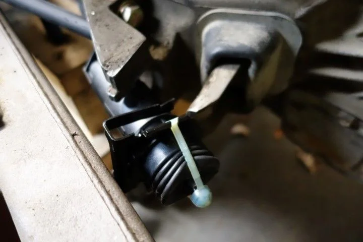

And I would probably have the extra 45mm I need in order to install the clutch slave without pulling the engine out of the frame...

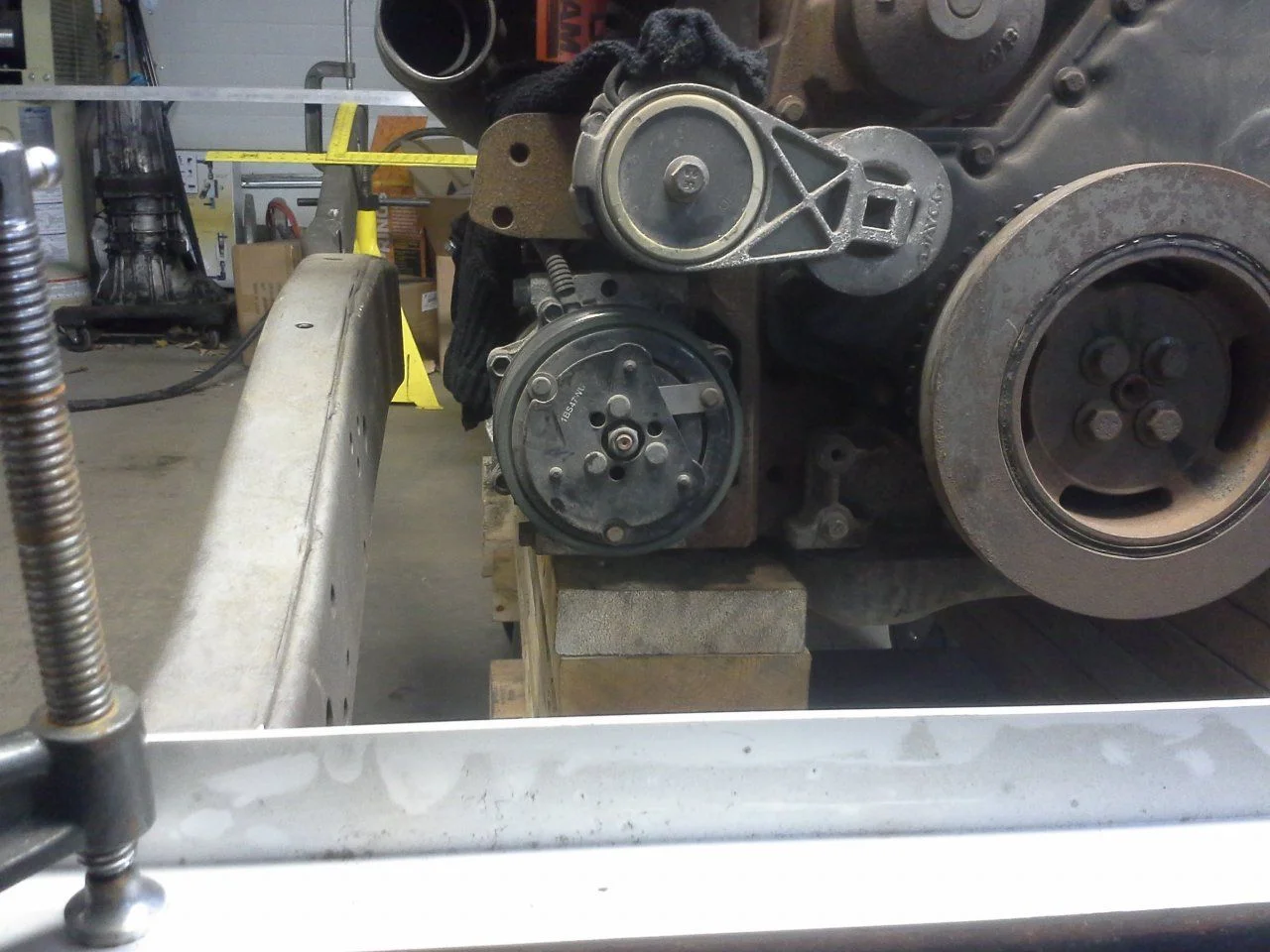

And I would then have a little more room to inboard the 3.5 to 4" exhaust inboard of the frame rails...

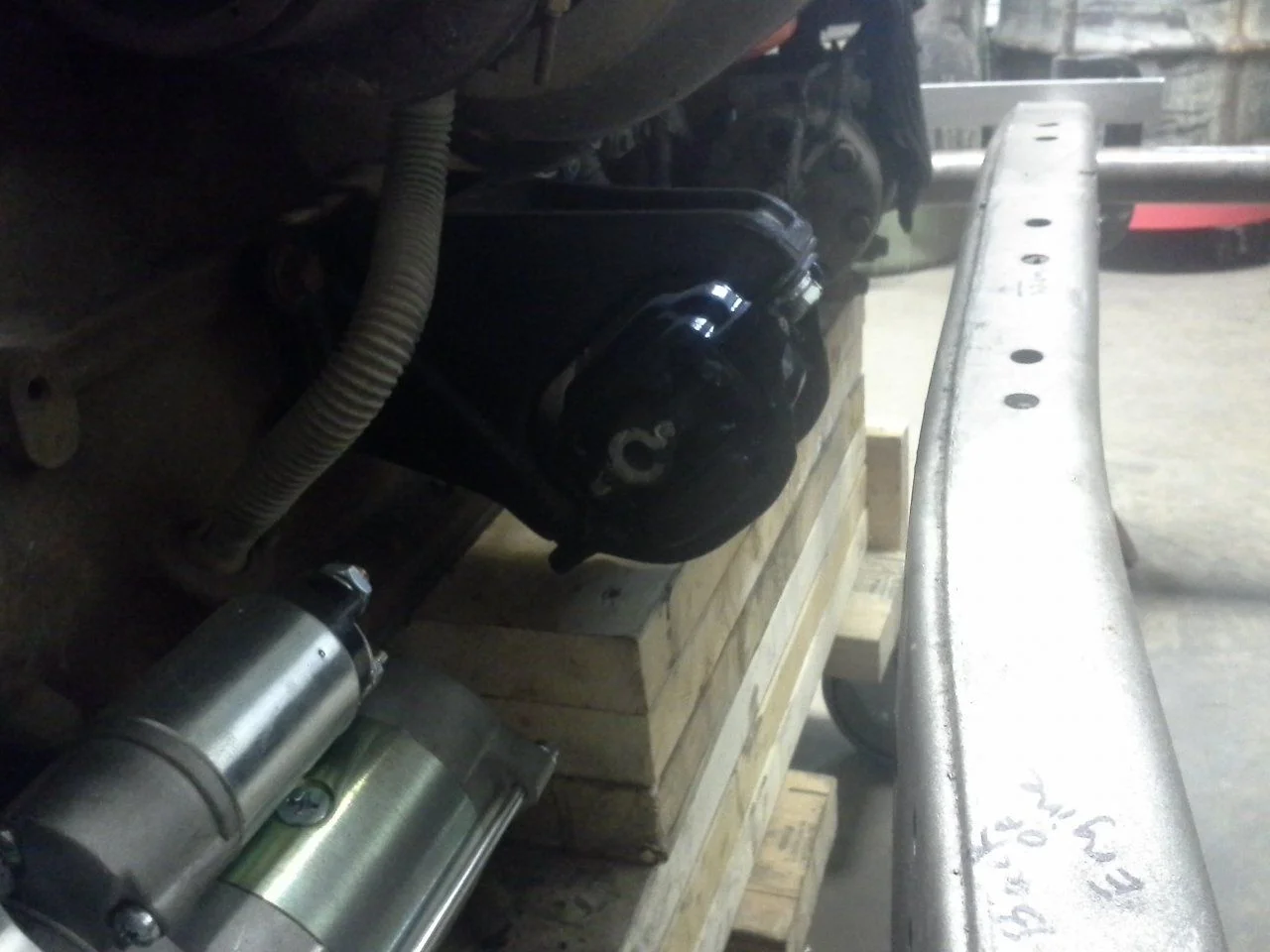

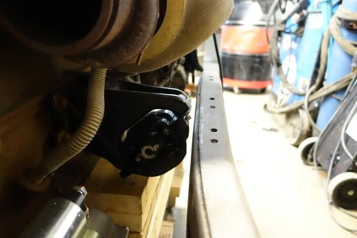

And give me just a bit more room between the frame rails for engine mounts.

So that's if for my evening with the tape measure. Time to order some DOM to widen this sucker by 100mm.

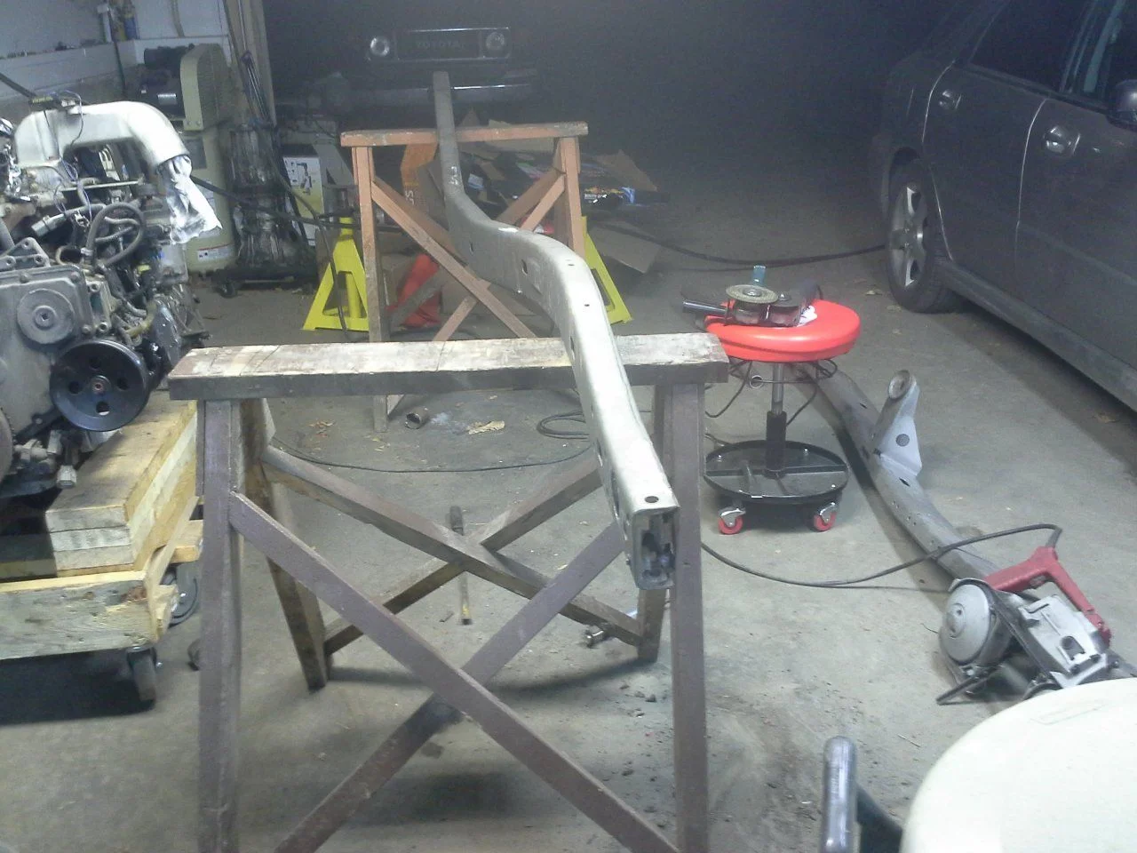

Frame cross members unwelded from frame rails....
And frame rails mocked up 100mm wider. Looks positively spacious now
