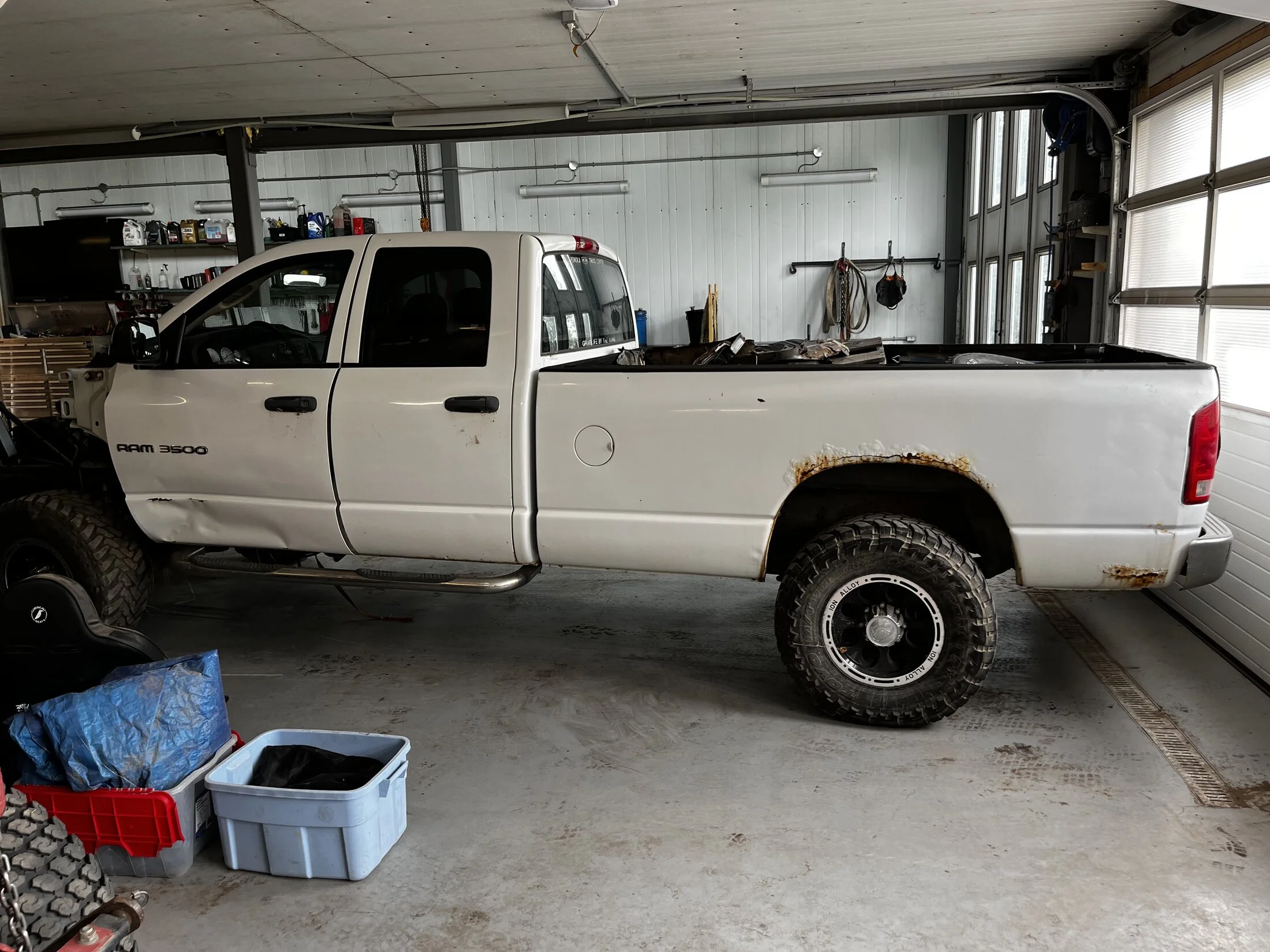

In the mean time, here's a pic of the shop I built, with the extensive help of a great many people that are watching. So much gratitude for all their help. I owe you all shop space anytime you want it.

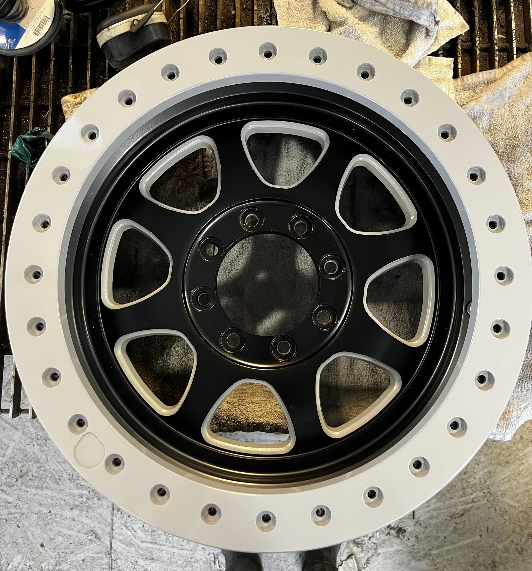

Of criticla importance is the wheel/tires. I already have them... Trail Ready DOT double beadlocks, with Michelin 12.50R20 XL's.
Now, I know what you're thinking. Those directional XL's are noisy on the road, and only 40" tall, and ridiculously wide at 12.5". Why not get the tantalizing 11.00R20 XZL's that are non directional, quieter, 43" tall, and 6% narrower? Well, I don't aleady own them. The 12.50's are pretty close in size, and when I wear them out, I will definately get the 11's.

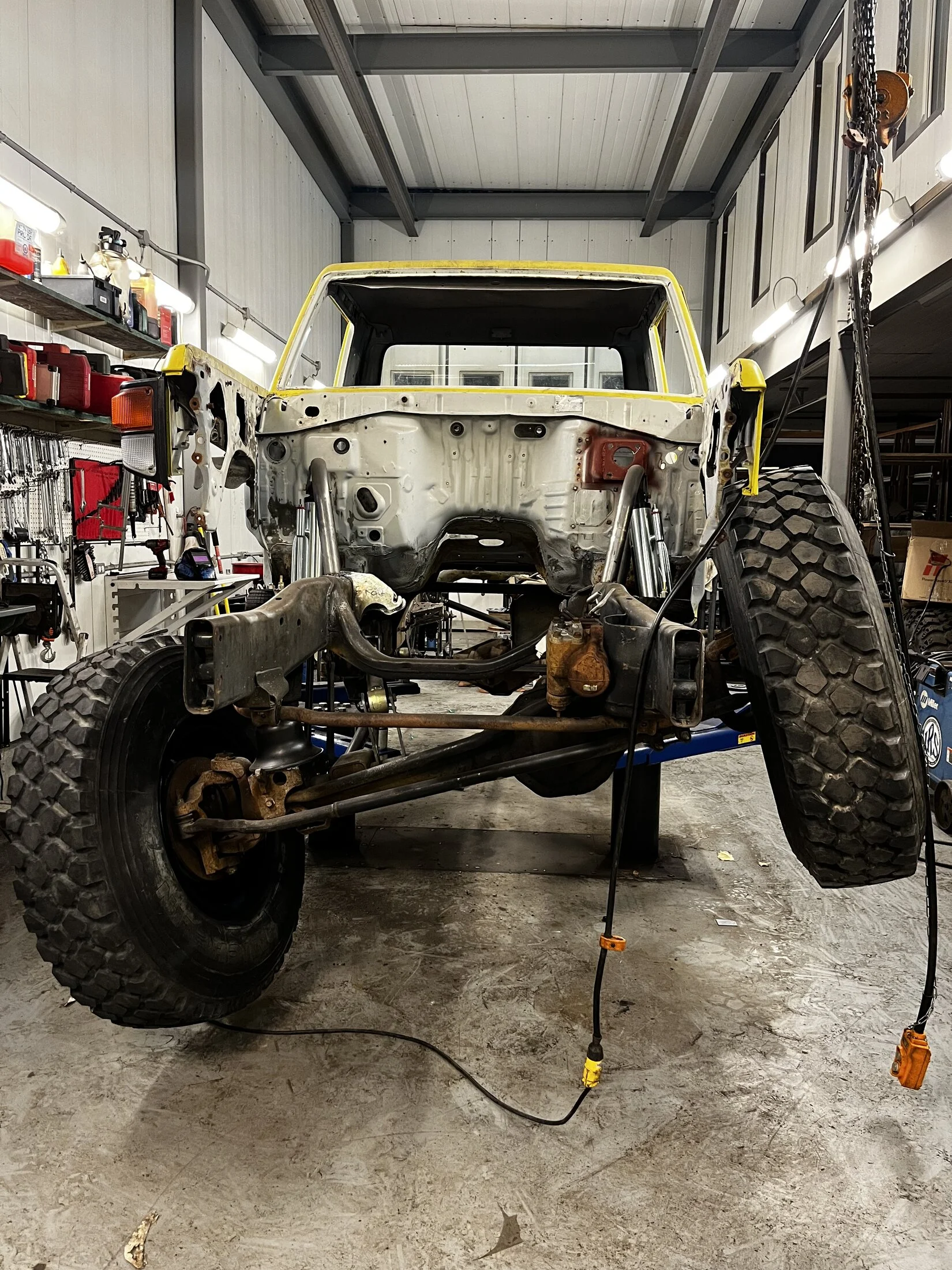

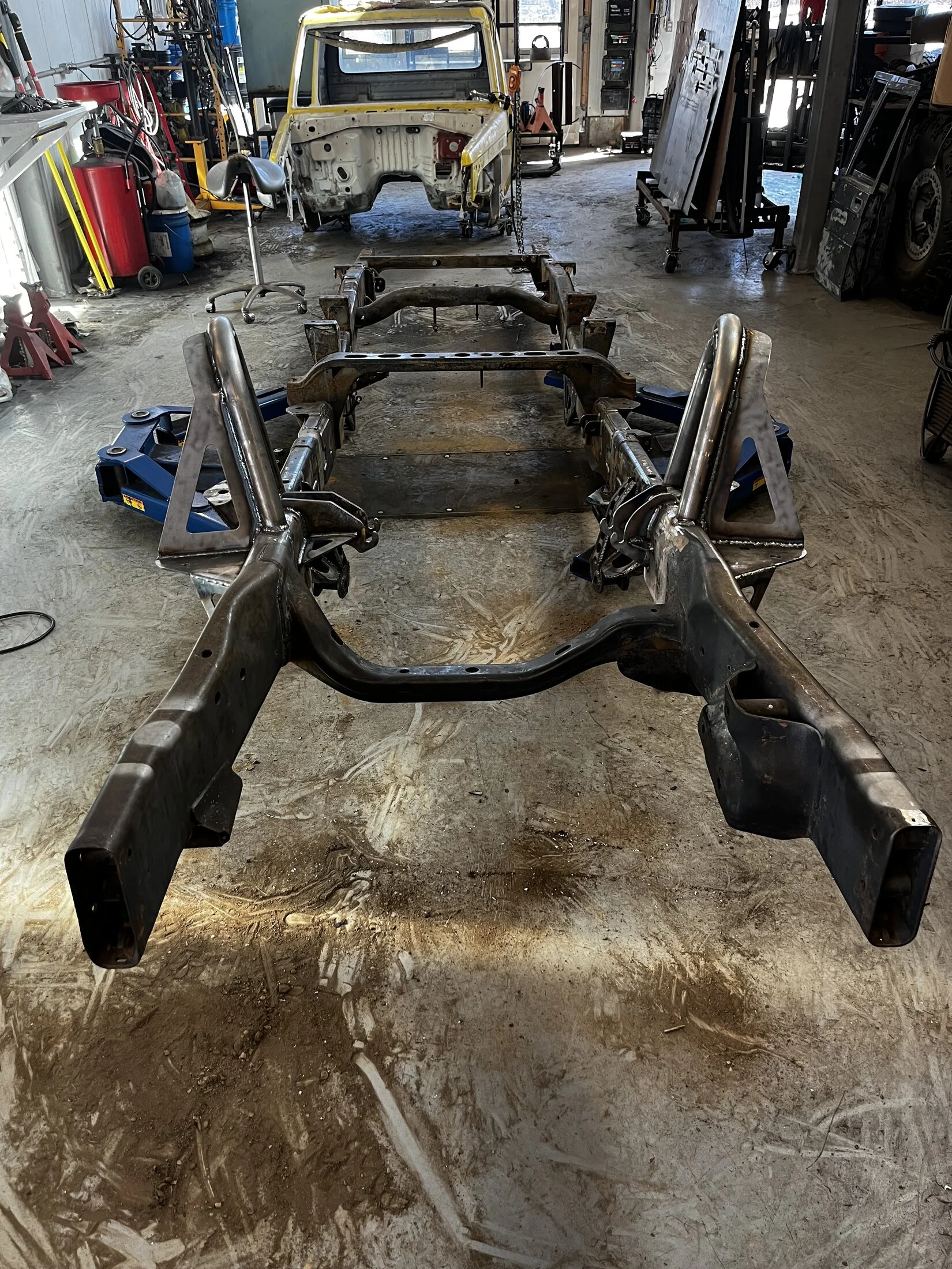

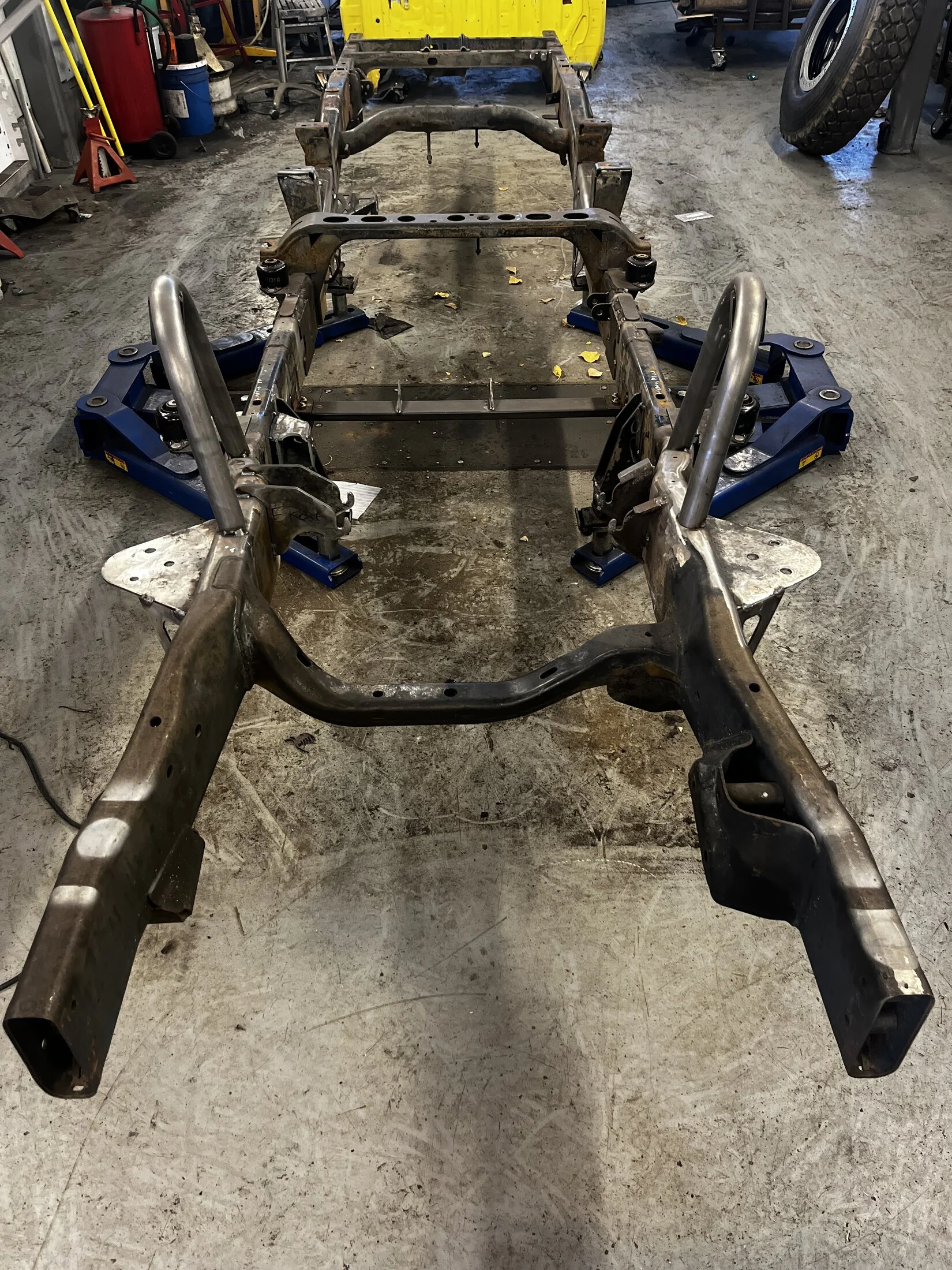

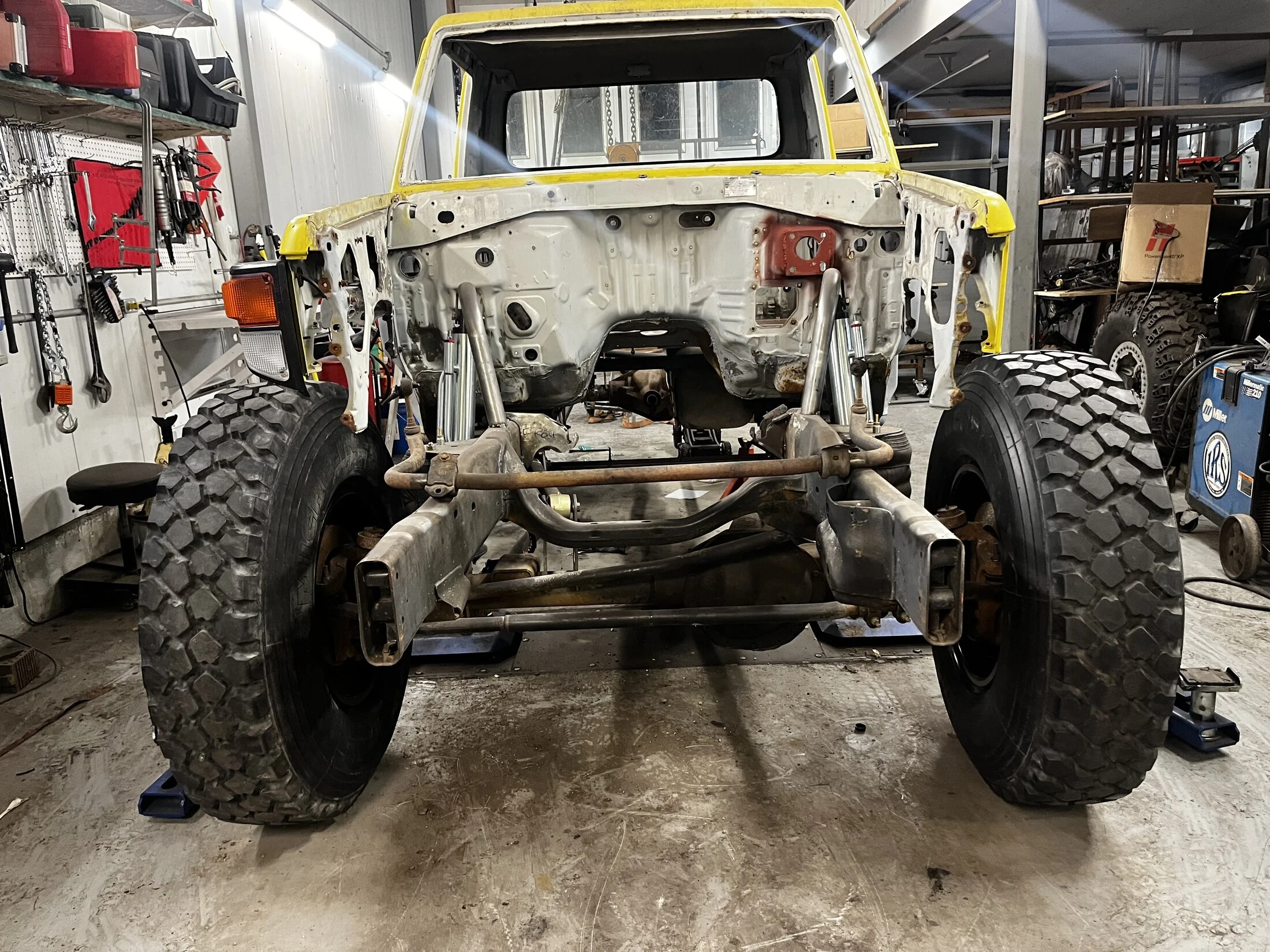

But, I indeed, HAVE been working on this project. Plan B is underway. Shortened 2005 Ram 2500 frame. 79 series cab. a 'kennel' of some sort, with a flat deck behind that. Air bags, triple bypass shocks, links everywhere. 5.9 common rail Cummins - 6 speed G56, NWF doubler, NP205 transfer case. Stock axles, with air lockers, and 11.00R20 Michelin tires (43" tall). That's the plan. Some random progress pics from the past 18 months....
stoked to see you back on your build!
So far do you like using the truck frame vs custom square tube? Is the cab and suspension fitting without issue vs where the frame has bends and the frame width?
Any downfalls using the stock axles? Lockers and gear ratios?
I here dead lines like making it to Rubithon 2025 are the best motivators 👨🏻
factory frame vs. custom Square tube: Much

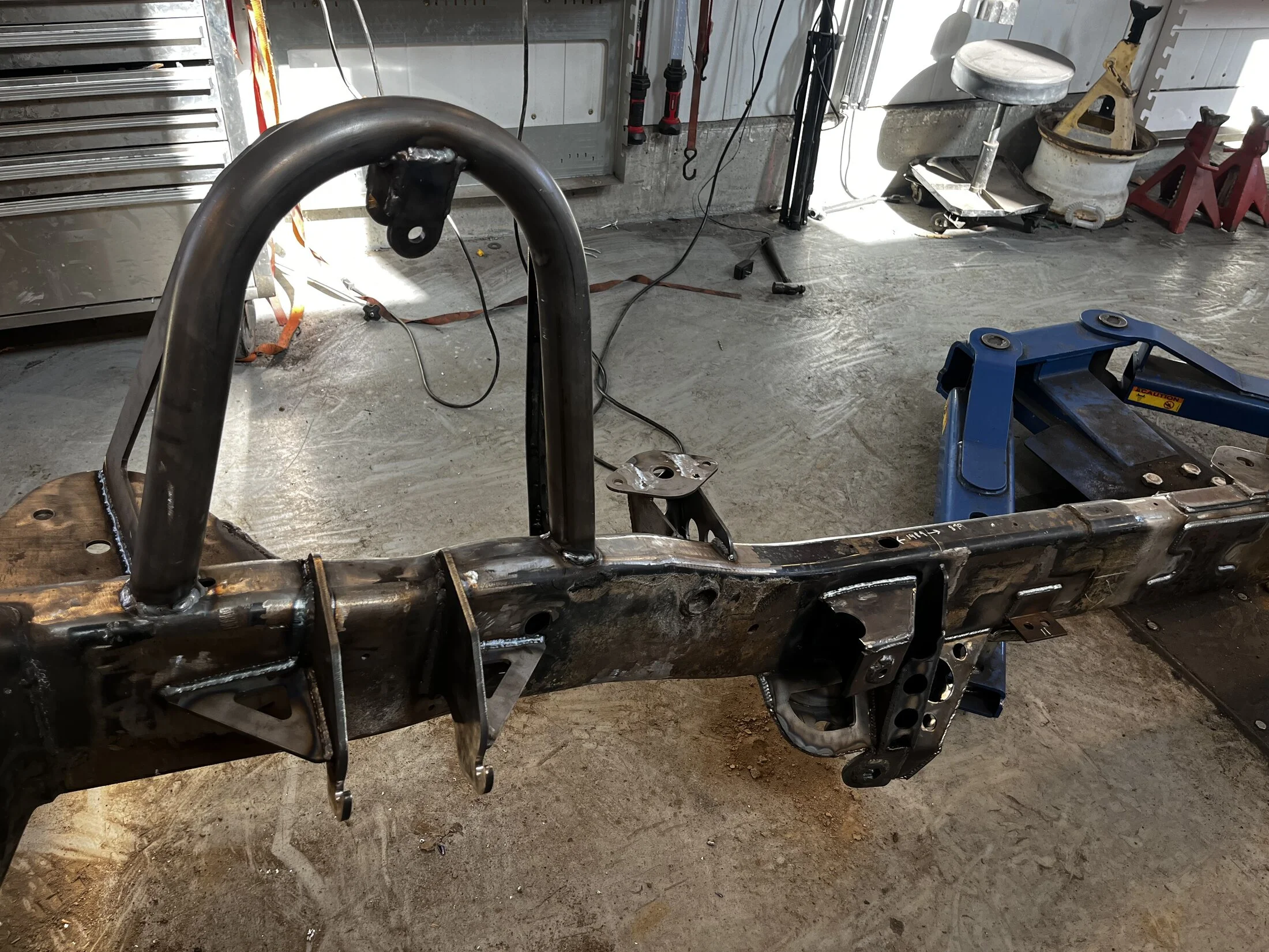

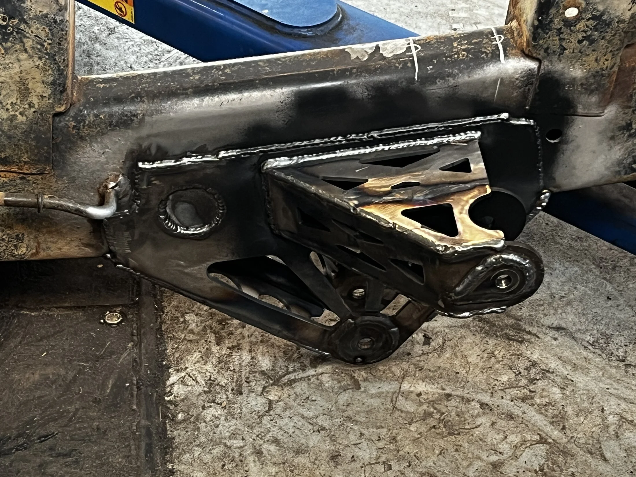

Factory frame is nice.. A big upgrade, actually. it has the right bends in the right places, and lots of things are easier because of that. Especially the whole steering, panhard, sway bar setup. I am keeping all that. I also think it is just stronger and lighter... higher tensile steel, hydroformed, and such. All good. But, there were still lots of changes.
  • I took 2 feet out of the middle of the frame, under the cab.
  • I am keeping the front axle in the same place, to re-use the steering box and panhard mounts and such,
  • but with using the big 43" tires, I had to move the cab back from factory location to clear the tires.
  • That led to moving the engine back 6" as well to tuck up under the firewall
  • But then the accesories would not fit between the skinny part of the frame, so I had to shimmy the engine to the left a bit more than factory, but since I was doing custom mounts, I was able to make everything fit.
  • custom body mounts of course . I was place the cab snugly around the enging with the shift poking through the floor at about factory ish location. The body mounts on the 79 cab are just wide enough to clear the frame. So far, i have not needed to make any mods to the 79 cab.
I am real happy with the way it all worked out. All the primary fab work is done and welded. Ready for assembly

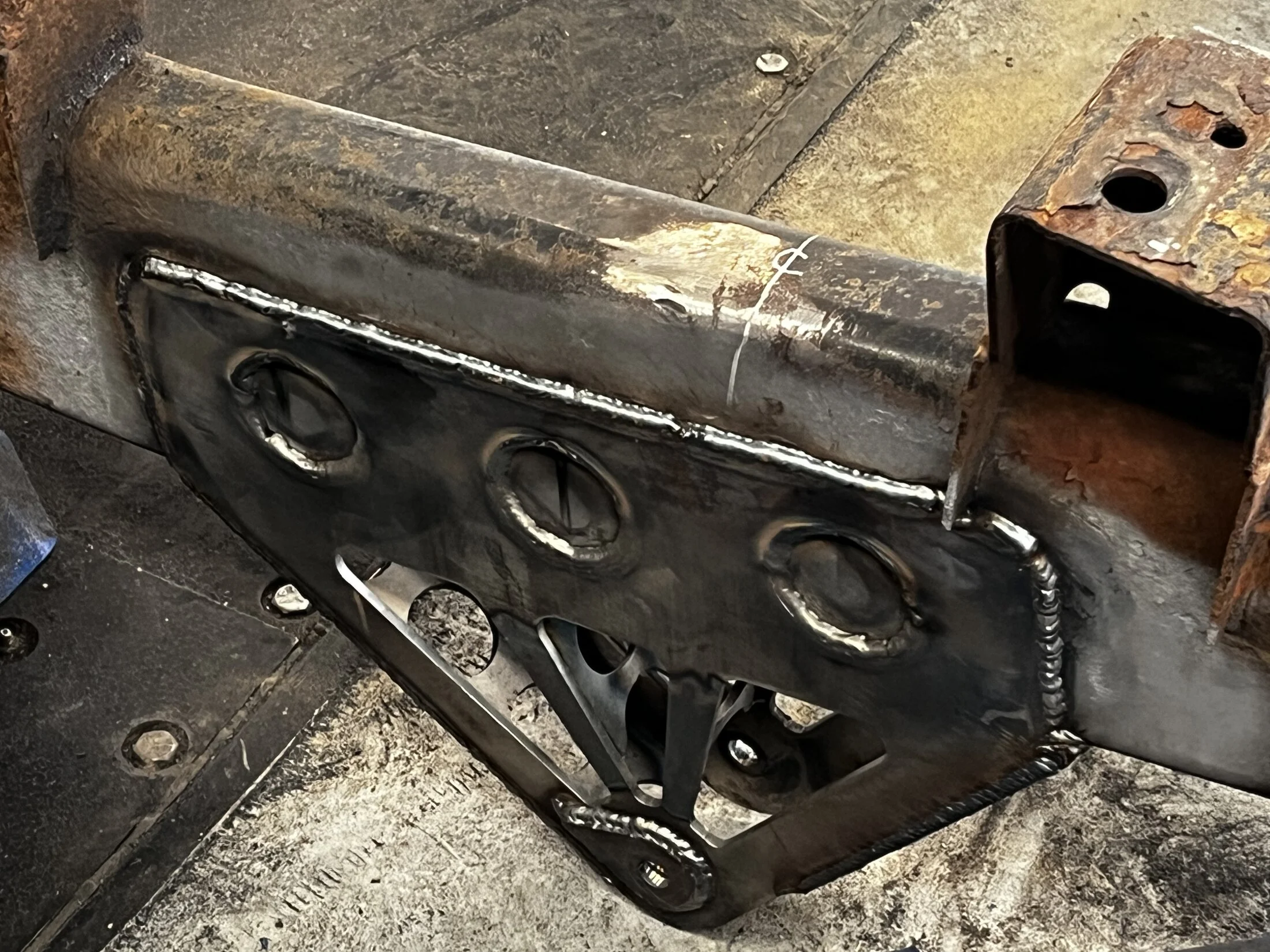

I kept the factory front lower link mounts on the front axle, and the factory front panhard. Everything else is custom. "3 Link" front and rear, using 12" travel air bags, and 12" Triple Bypass Radflo shocks. For fun, I am using 'The Kong' dog chew toys for bump stops. Seriously!
Front axles are mostly ffabricated. Ready for welding. That' what I am working on now.
