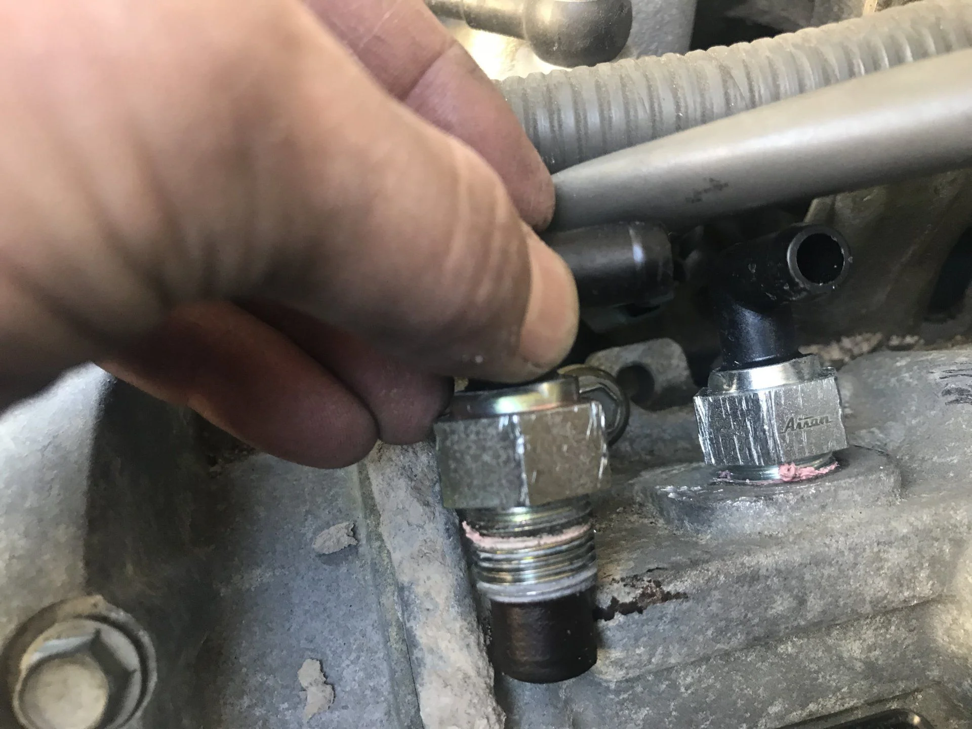

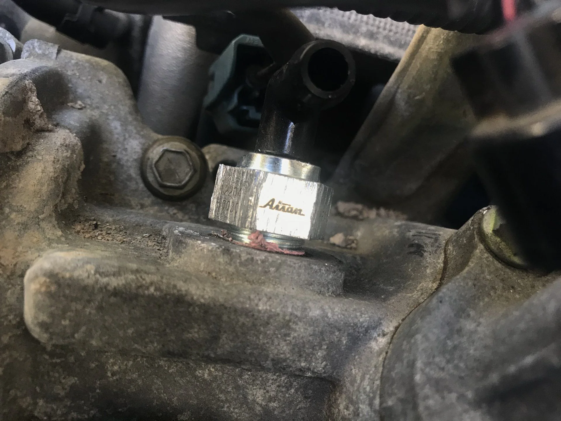

I found a couple threads on changing the PCV valve one mentioned it was on very right. My question is how tight should it be? I just changed the PCV on my 2006 corolla and it goes flush against the block.
When I took the current one off the cruiser (04) I noticed that it was not flush. I got about a 1/3 turn past where it is in this pic and backed it off. Surely it shouldn't be this tight should it? I was really having to wrench on it.

If they just sat in a grommet in earlier years then I'm assuming this is fine. I will just put it back together unless someone tells me otherwise. Thanks @bucfl
98-02 have rubber grommet. Over time they wear loosening allowing vacuum leak (slight intake pressure drop). This reduces effectiveness of ventilation system allowing air, dust and moisture into intake. It's a good idea to replace both DS & PS hoses of PCV system as well as grommet if cracked or worn.
03-07 have threads, FSM states 20ft-lbf of torque (in one spot I found) when tightening. It's a pre-coated part new, so use a lock-tight on threads if reusing old PCV valve.
PCV valves themselves can usually just be cleaned if sticking. Using a synthetic oil helps reduce failure of valve as they'll stay cleaner IMHO.
for 98-02 models apply some FIPG around the PCV, grommet and valve cover. :-)

New is always good! 20ft-lbf is not much.
Just did mine and it was installed about as far as the one in the pic is. My new install has at least 1 full revolution of less engagement than yours. I did not want to force it as it gets tight quick.
The red dope is sealant. The PCV pops at such a ridiculously low pressure I don't see the need to yank down on it.
Had mine installed for 500 miles and no evidence of residue around the threads. The old one had 80k on it and it was as clean as a whistle.
