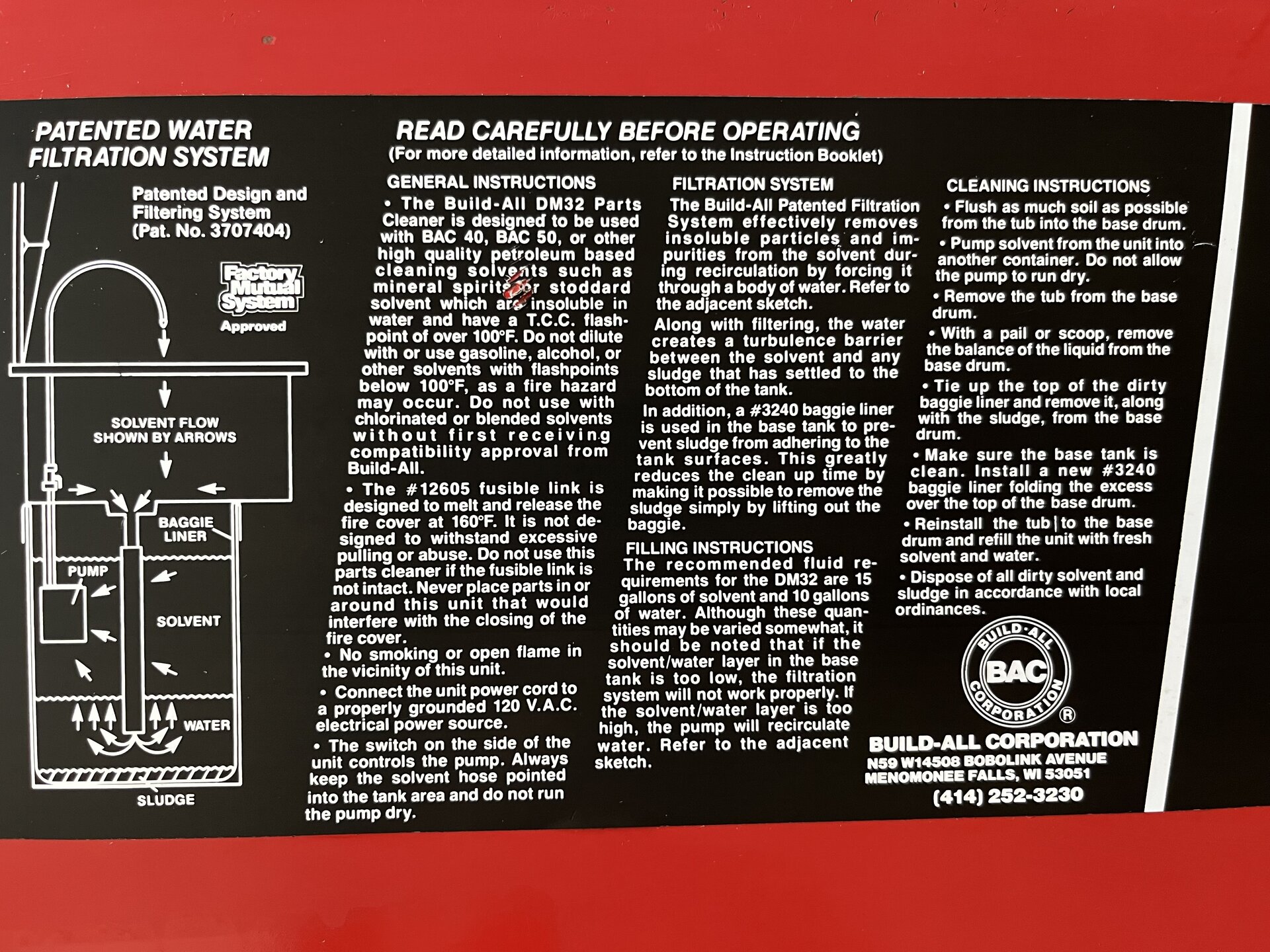

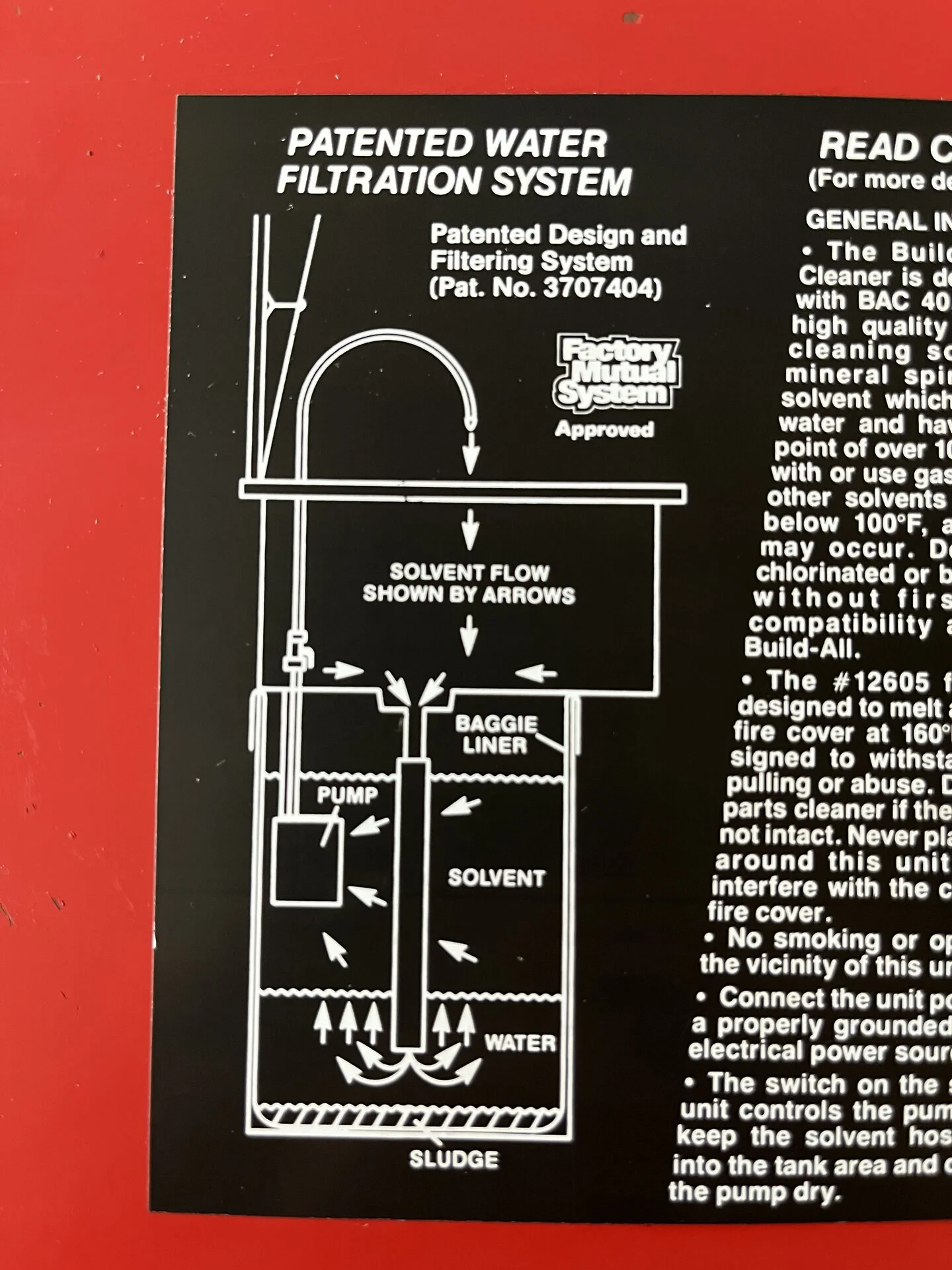

I bought a used parts washer and this is on the lid. Very interesting!

This one?
Interesting that it makes no mention of any issues with use while the specifically "non-caustic" one I linked has a maximum dilution ratio for metals.
