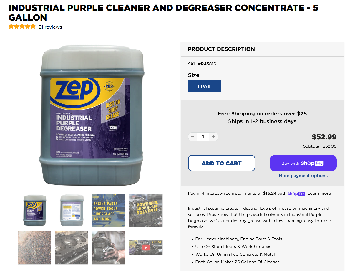

I bought this two years ago, and I still have a gallon left; granted I don't rebuild as many 80s as some folks do...
Good for everything, just don't let it sit on aluminum for a long time.
I buy 10 gallons of this stuff at a time from the local petroleum / chemical house. It works quite awesome.
The purple cleaners work great, but IME they also kill the seals in the pump and some plastics don't like constant submersion in it.
