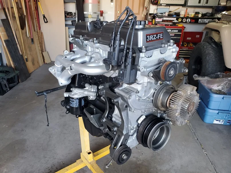

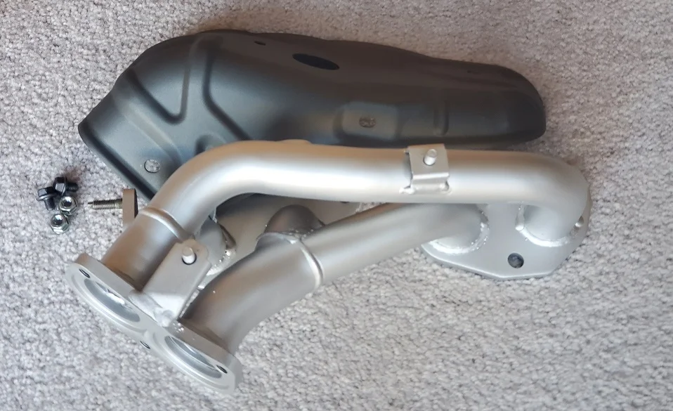

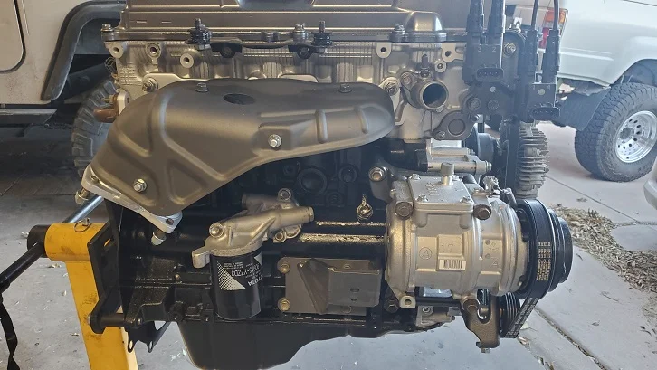

Well, as usual, I had to put up with the usual abuse, er, encouragement, on the new engine. One question asked was if I was going to run a header. The answer was sort of yes. Early 3RZ engines had a cast manifold which were prone to cracking. Mine was cracked. Around 2000 Toyota went with a factory mini-header on the 3RZ. It looks a whole lot like the Doug Thorley, which appears to have been disco'd.
I bought it, then sent both the header and the heat shield off to get ceramic coated to try and keep under hood temperatures down.
On the engine.
With heat shield.
Looks great, Pappy! What’s left before it gets stuffed under the hood?

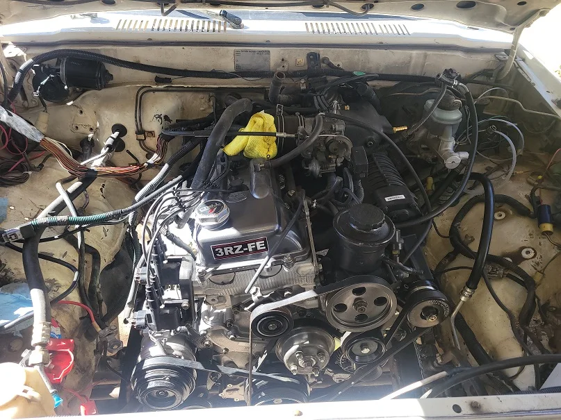

I heard from Mike today. I have his cost. There were some things I needed to take care of at my end.
- Battery tray. Everything is reversed on this engine. Fuel, intake, battery, exhaust. I bought a conversion battery tray from TOS. I just need to spray it with paint.
- Finalize the fuel line solution. Like I said, everything is reversed and I need to relocate the fuel supply, return, and evap lines. I have a solution engineered, I just need to fabricate the lines for real.

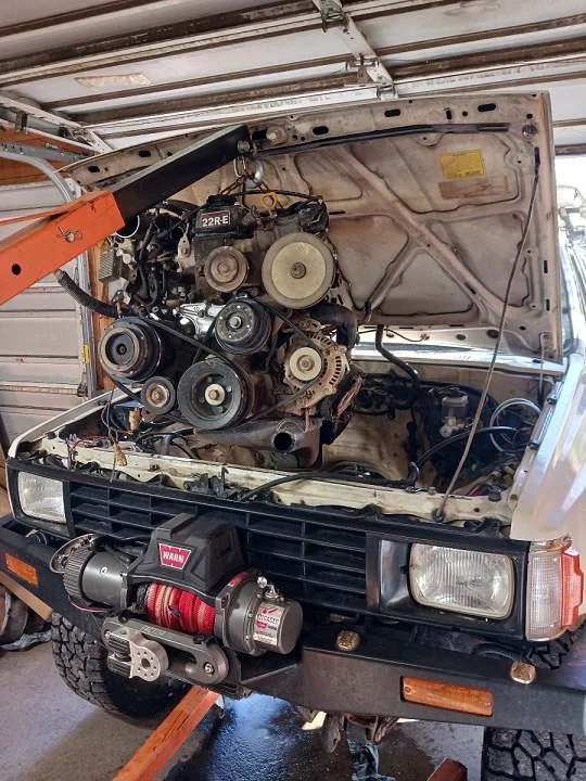

Nuff said. Out with the old.
Ain't it purty?
PORN, that's pure porn right there , I tell you what 😁
