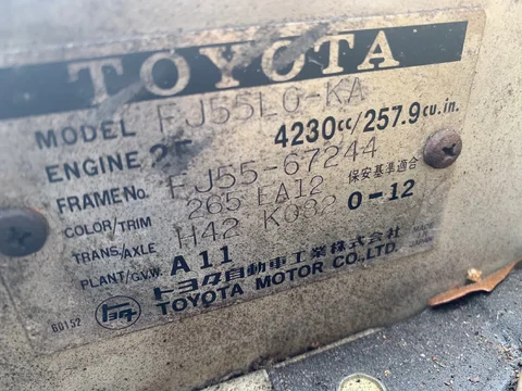

Does your VIN plate have the color code? Mine is on the plate in the engine bay, along with the engine, axle, and diff codes.
I have not seen the vin plate under the hood. the one on the door pillar does not have a paint code. Ill check and root around there when I get home at the end of the week. that would be amazing if it had the color code there.
It won't be on the door pillar plate. My engine bay VIN plate is (more accurately "was" at the moment) on the passenger firewall near the front.
Awesome! well I hope its under there that will help out a bunch. Learned something new. I cant remember If I had seen that under there or not. I will be able to report back on this till friday or saturday. Ill be away till then I think.
