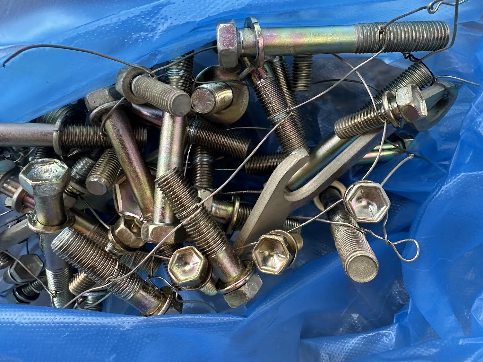

In the morning, we retrieved the unibodies and screws so the shop could start putting them together.
Almost shiny naked aluminum. People who paint aluminum, WTH man!

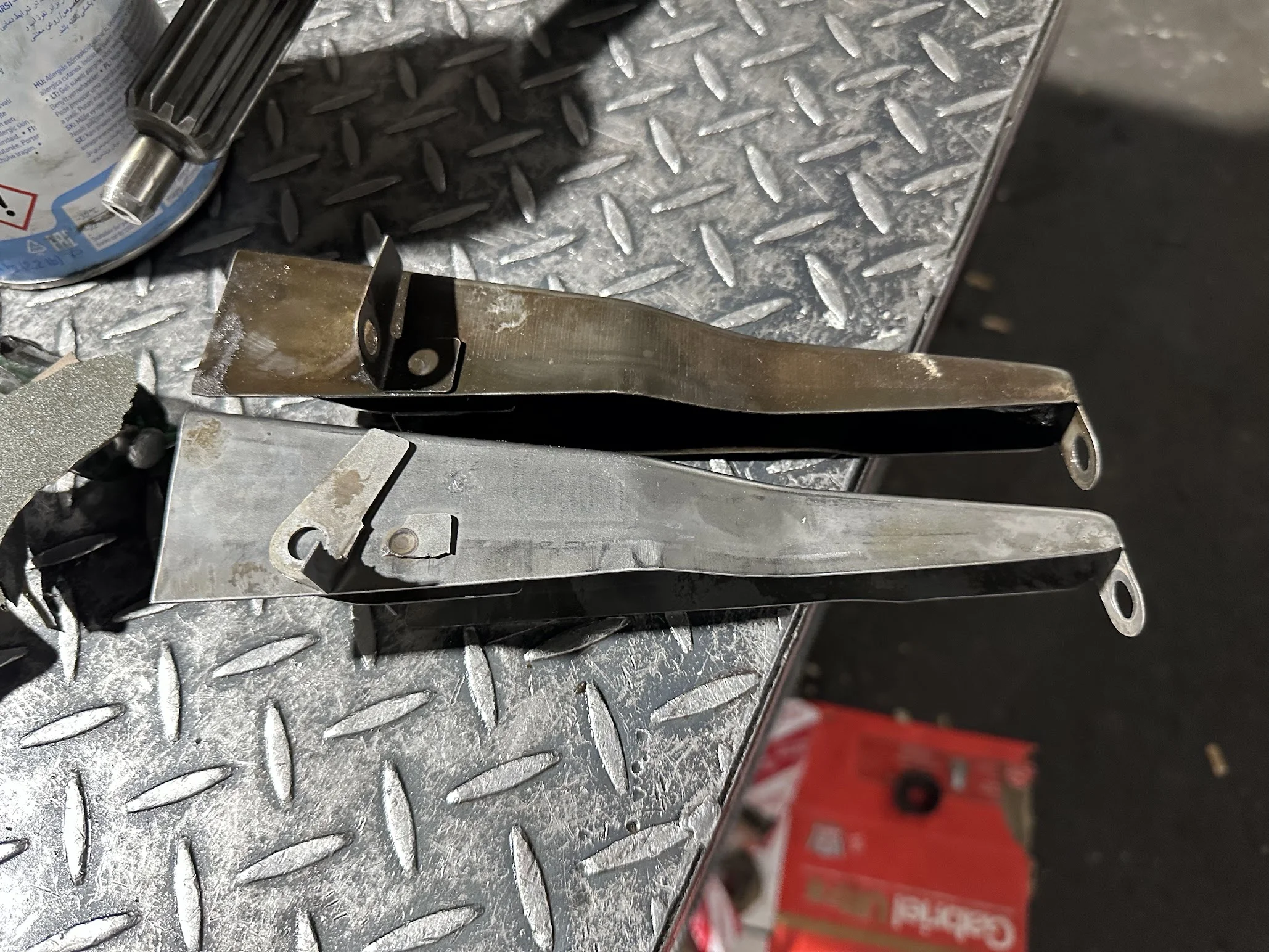

Sourced the mysterious broken piece.

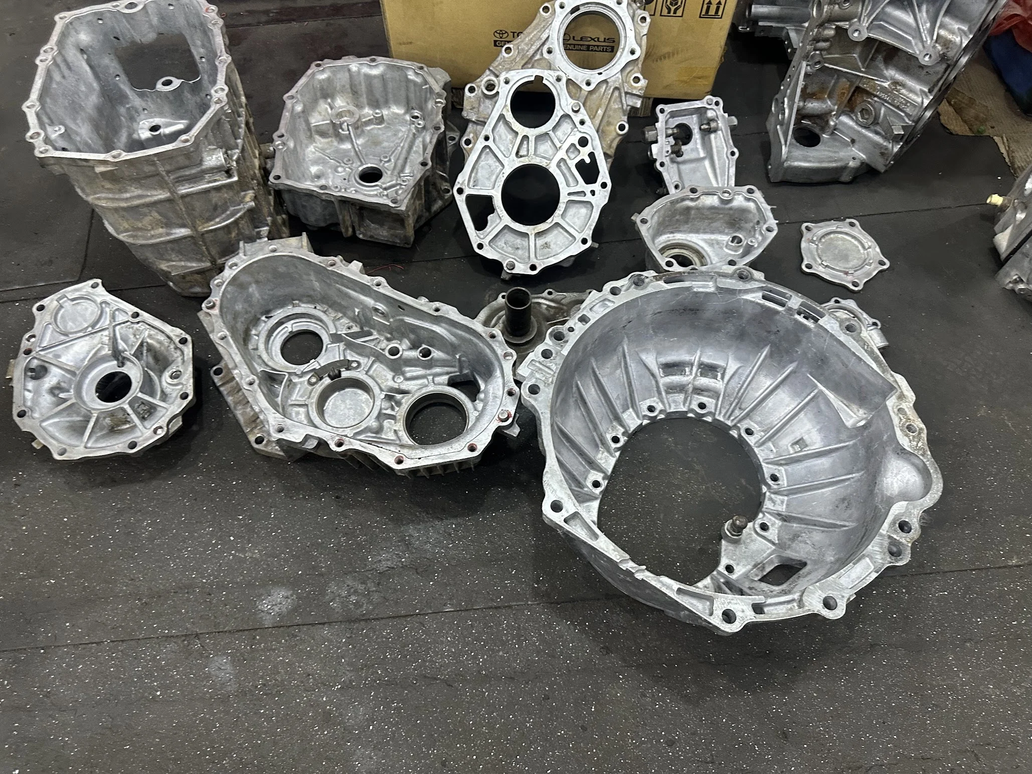

The beast H150 after cleaning.

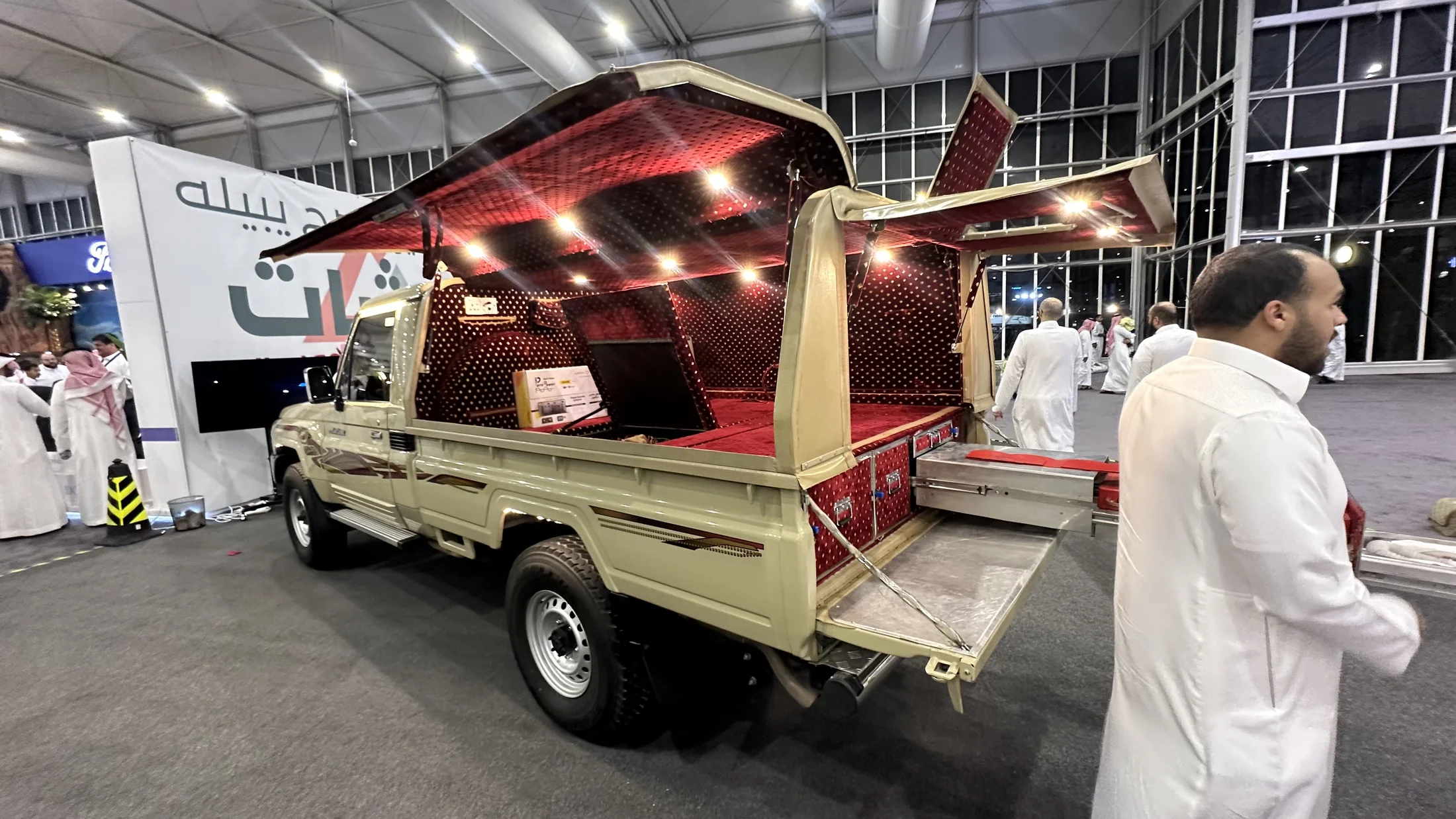

@DrRock First, I apologize for not responding to your text because this project was just started.
Those styles evolved over time as local shops refined them for Saudis' needs, "exploring or hunting." It used to be much simpler, but it started with the boxes you want to make.
I think I need to write a thread about its history

Very cool, thanks for the information, looking forward to the thread! No worries on the delay, I know you’re busy which is great.

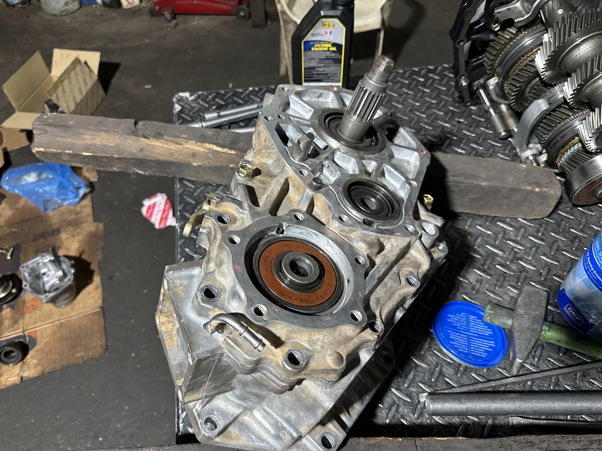

Trans is done and soon will drive it out of mechanical shop

I brought the Multi D so we can try to do a final wash "without using a steel-brush! I hate them on aluminum."

Examining the housing, the information before cleaning suggests that we need a new clutch.

Great work as always Meshal. I saw many of these tops while living in Riyadh, especially in the Turaif area but I don't recall ever seeing one on a 75 series when I was there. The 79 series had already been out nearly 20 years when I was there so I think everything was built for the newer model. I'm sure I could have had one built. Too bad we didn't meet while I was there.
I also could never find the "saddle bags" that go over the transmission hump for the FZJ75. Al Sanidi only had the ones for the FZJ79.
