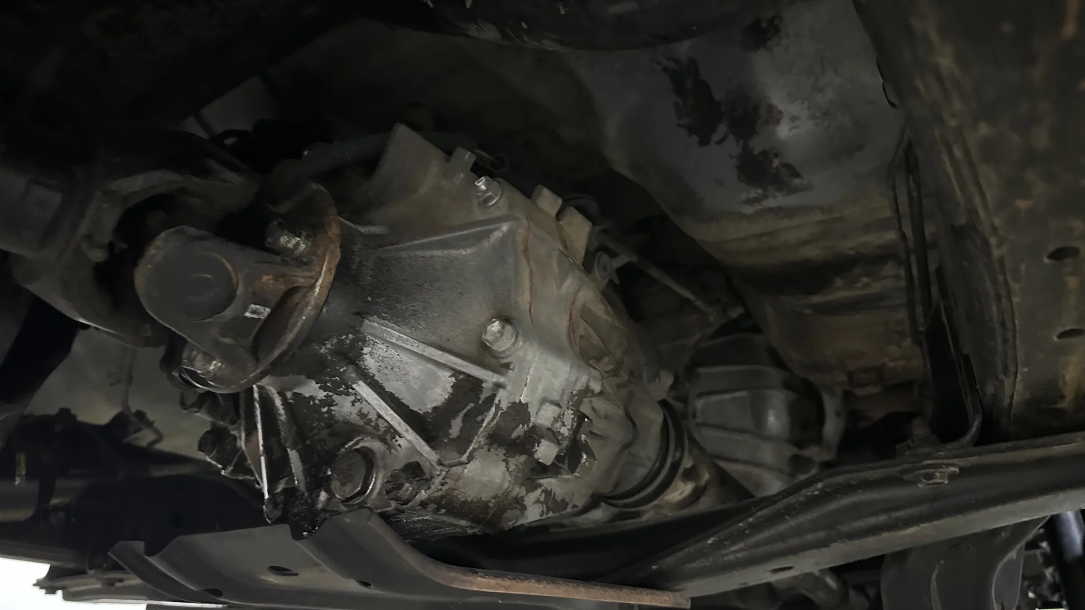

  • Front differential rebuild: This includes all the bearings and a complete gasket kit for the knuckles

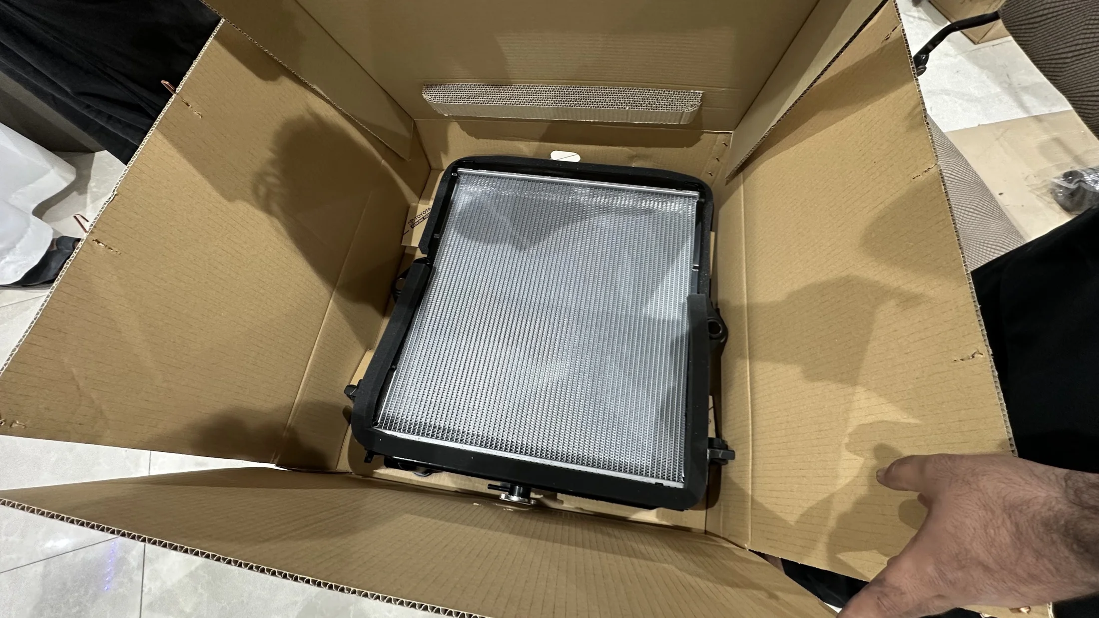

  • Cooling system refreshments: For such a truck, I always recommend installing a new radiator unit, but we will also be replacing additional components in the system.

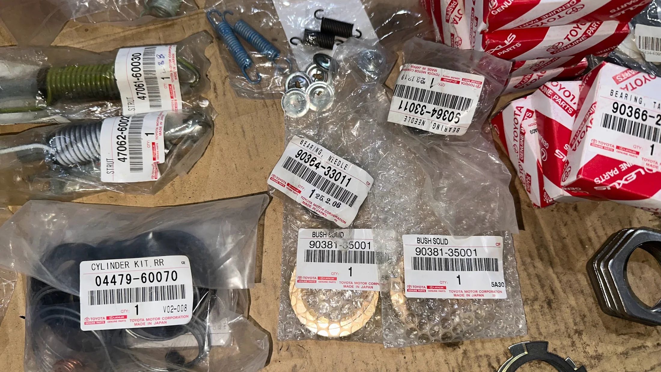

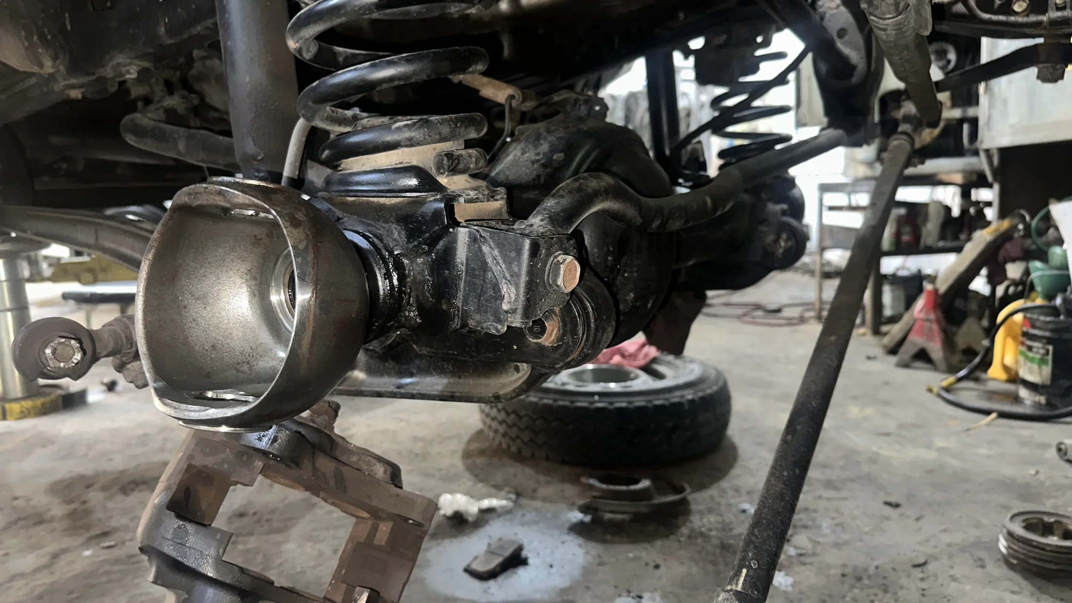

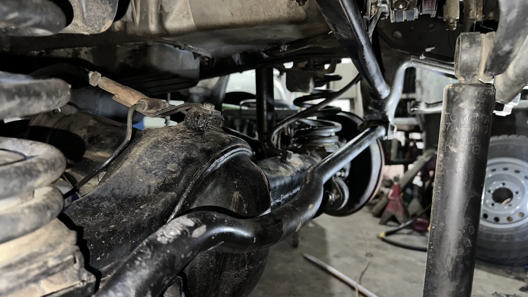

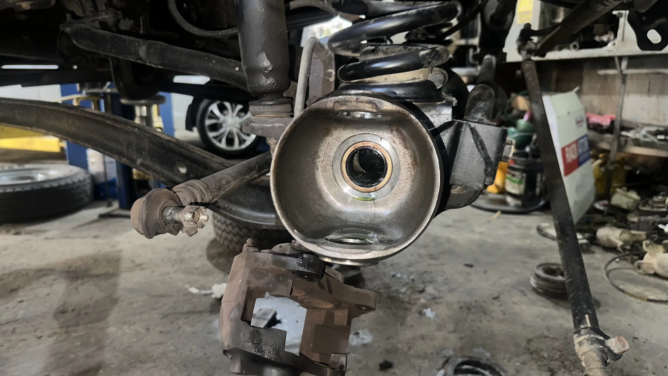

We start unplugging all axles componints to add the new goods
Front axle is good with no bad oil but we are going to replace it anyway.

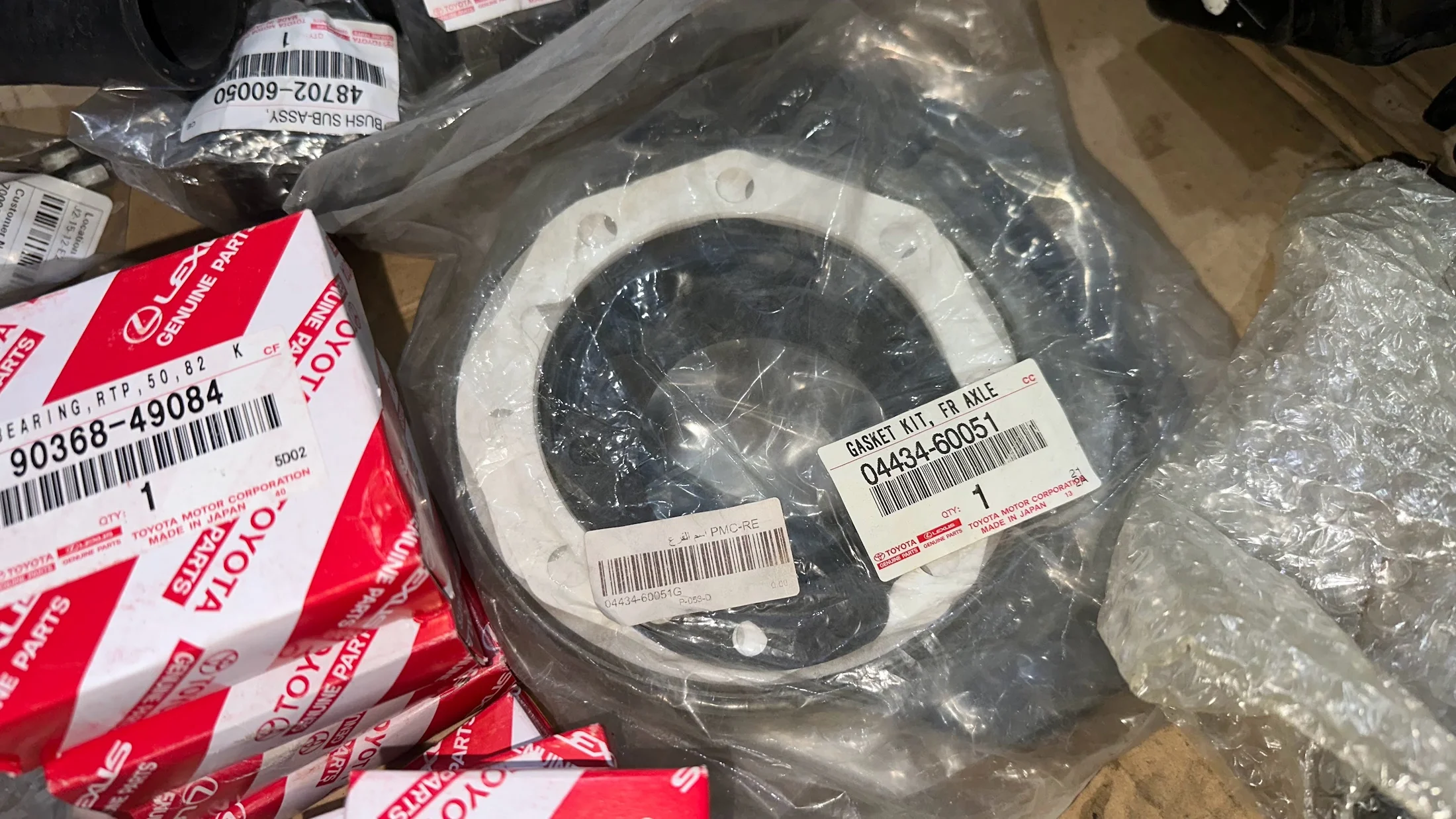

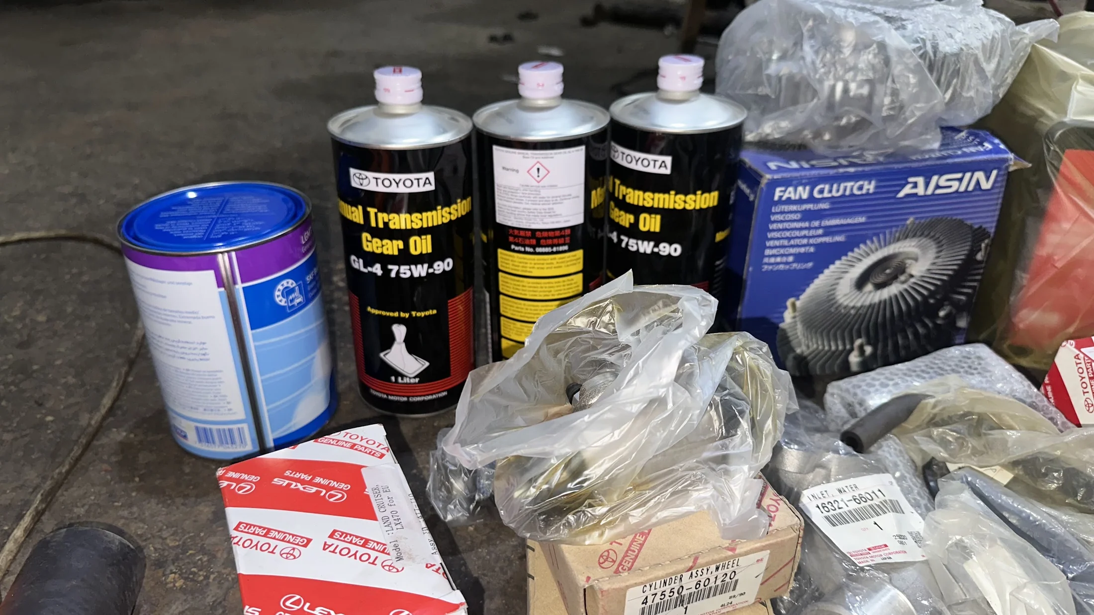

  • Bearings:
    90368-49084
  • Strearing Bearings:
    90366-20003
  • Knuckle Kit:
    04434-60051
  • Cylinder Kit
    04479-60070
  • Seals
    90311-62001, and 90310-35010
  • Break Pads
    04465-60340

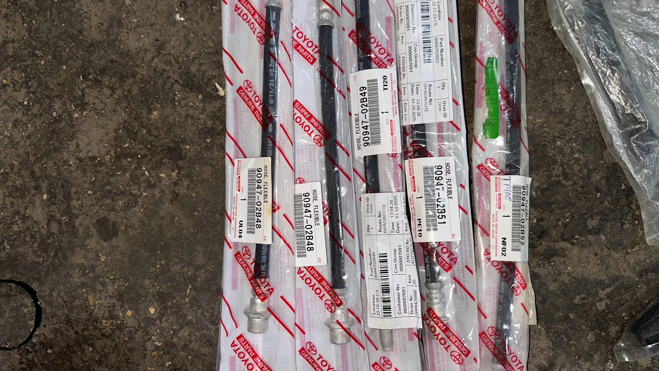

  • Front Main Hose
    90947-02B51
  • Break short hoses
    90947-02B48

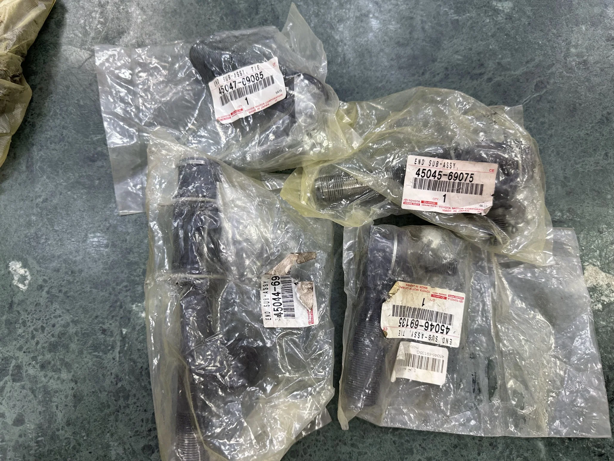

Stearing components are receiving a good amount of lower arms, bushe,s and end rods from the trusted 555
  • Lower Arms Bushes
    48061-60050
  • Control Rod Bushes
    48706-60070

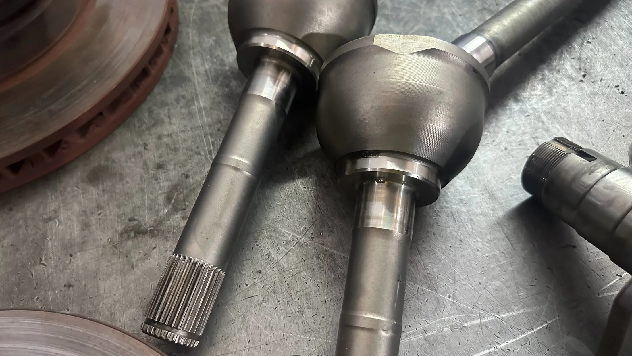

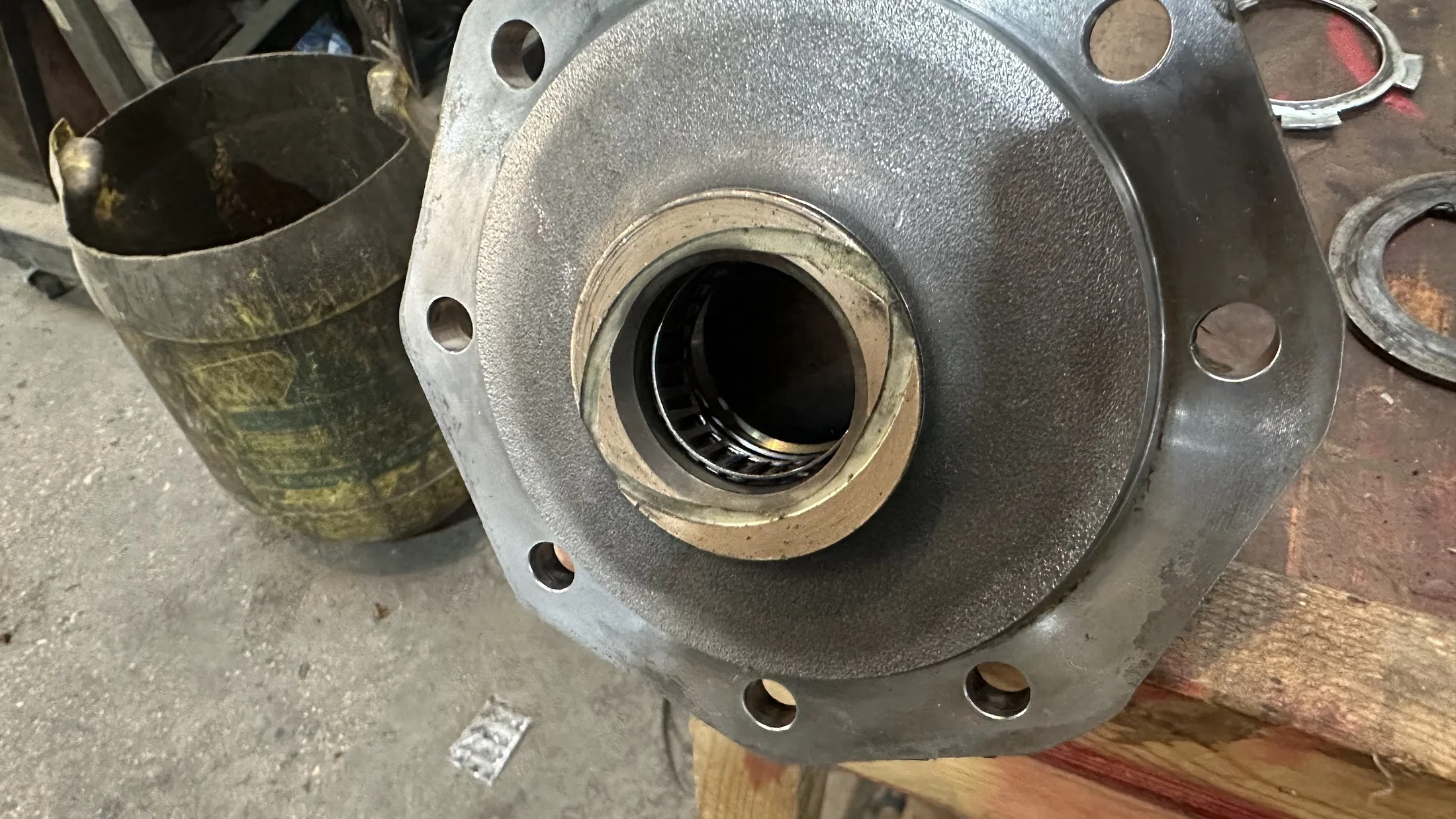

It is the first time I see bad spindle bearings, so we ordered new bearings and the locking bushes
  • Bearing
    90364-33011
  • Locking Bushes
    90381-35001
Shaft ends are good.

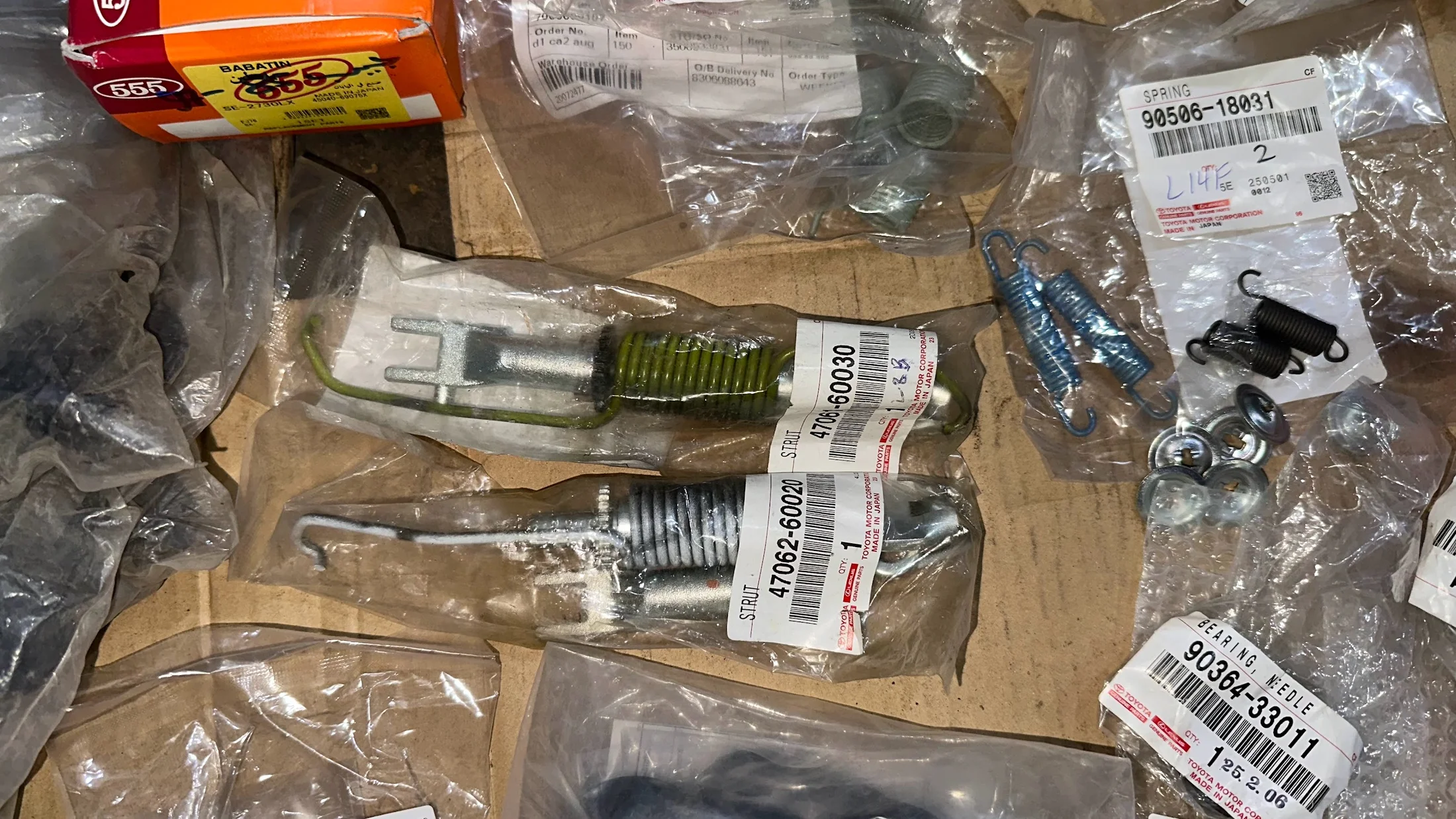

The rear drums are receiving the following parts
  • Shoe Kit
    04495-60070
  • Cylinders
    47550-60120
  • Strut Sets
    47061-60030 RH
    47062-60020 LH
  • Springs for Shoes
    90506-18031

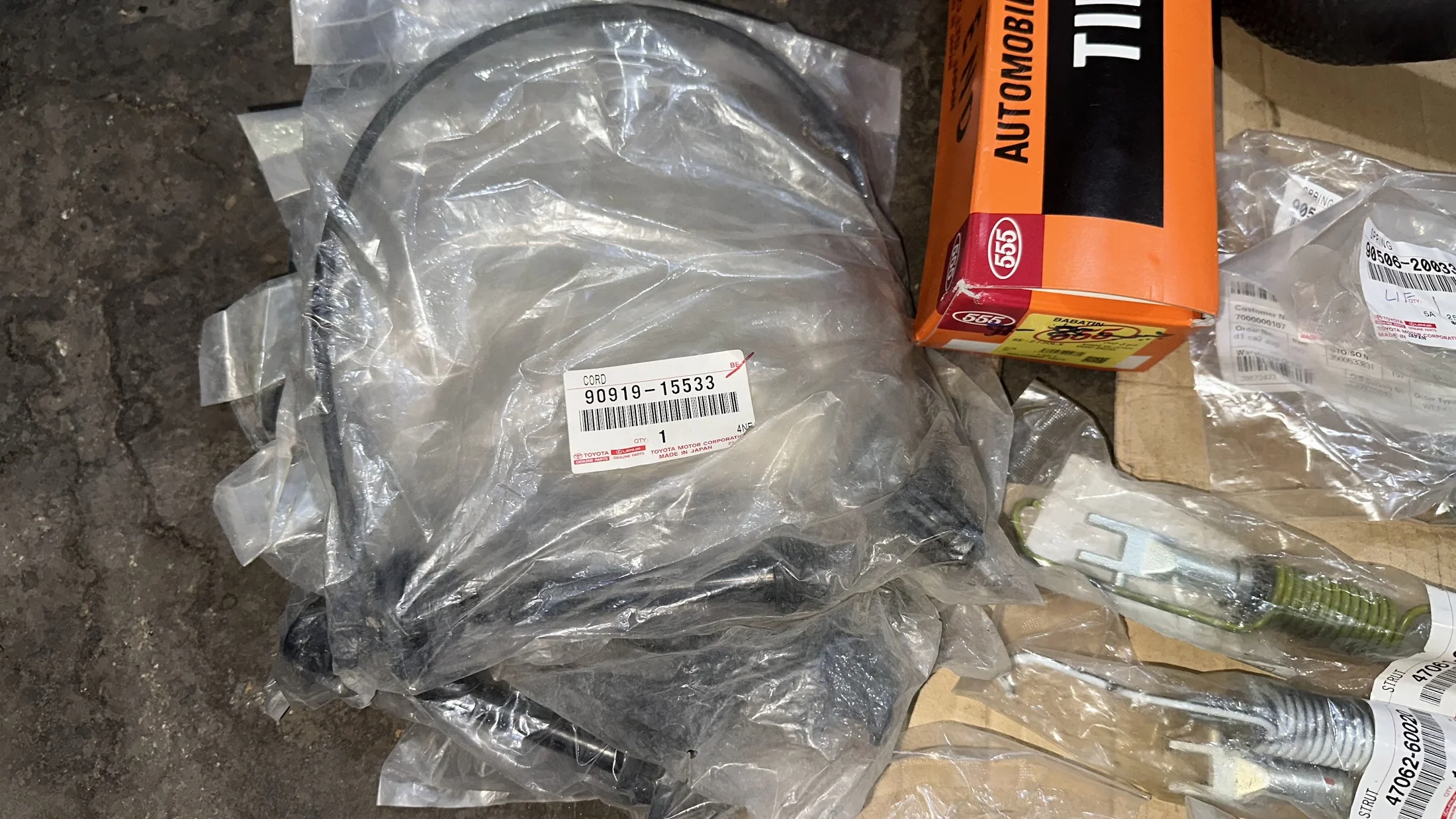

  • Inner wires
    47616-35030
  • Rear Main Hose
    90947-02B52

I like my part guy; he allows stocking LC parts. However, sometimes he gets it wrong. This time, the 555 end rods were short and missing the back side. I don't know the'hell of what he gave us, but we are returning it. If no 555s matching what we unscrewed, we will get OEM.

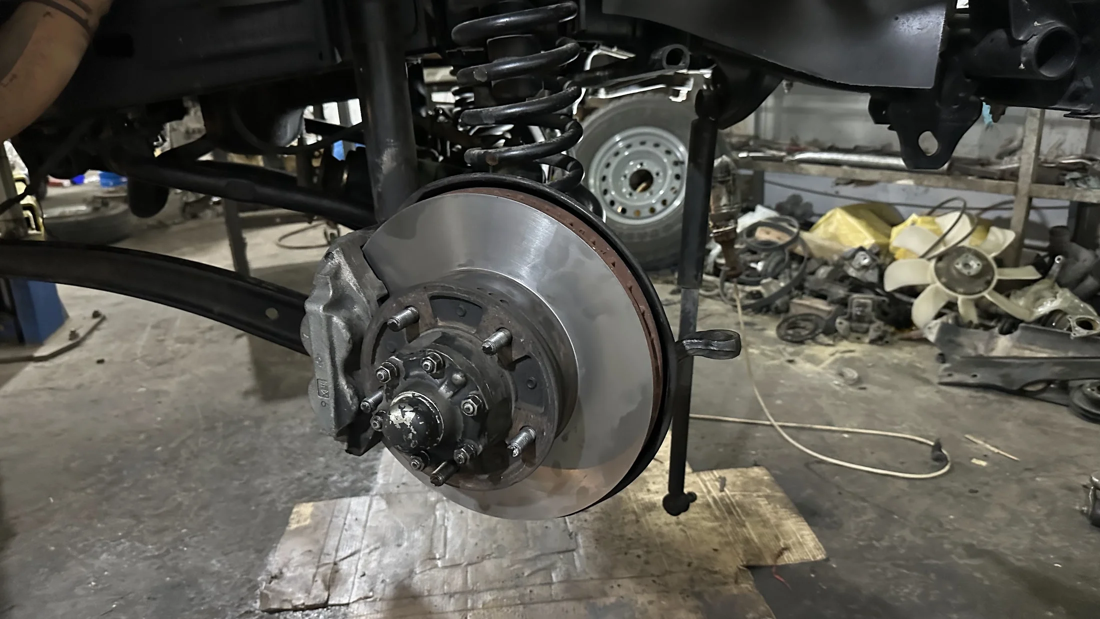

The front diff and calipers are washed and nicely done, but I'm waiting for the rods and the hoses.
I am not happy with the cleaning, but I will find out later how to wash it. I already asked them to clean with gas, but it looks like it needs more.

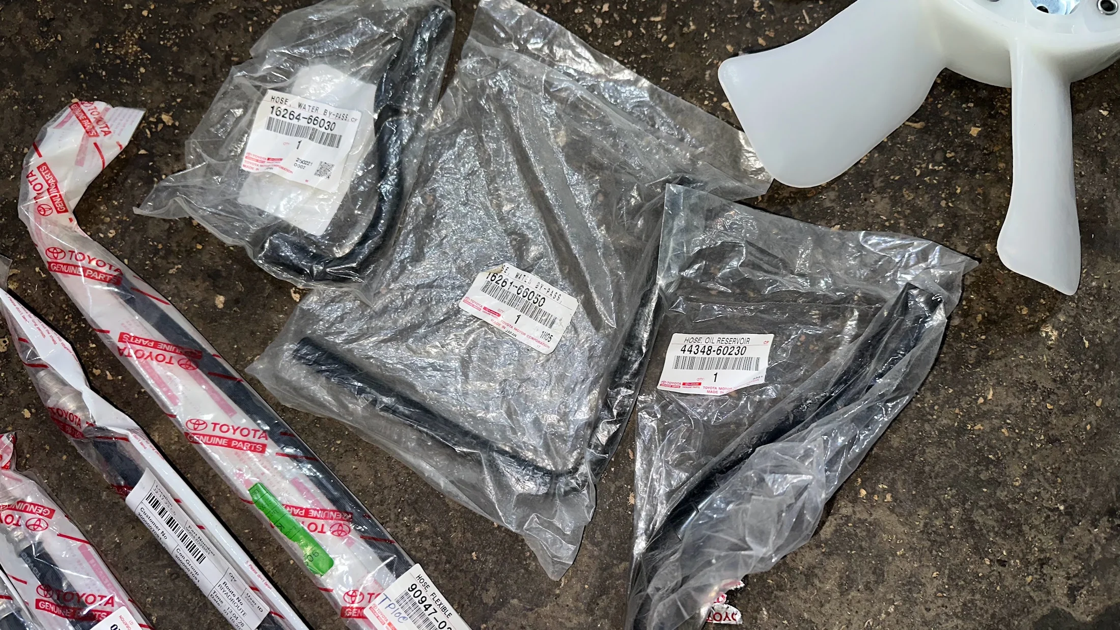

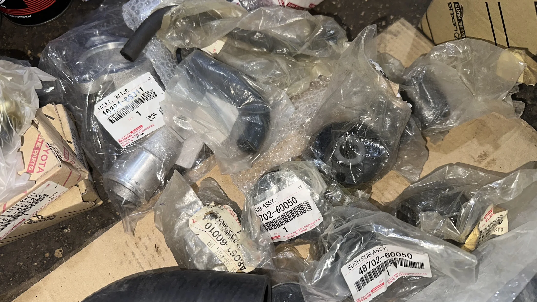

The beautiful hoses showed up! There is no excuse not to replace a 25-year-old hoe.

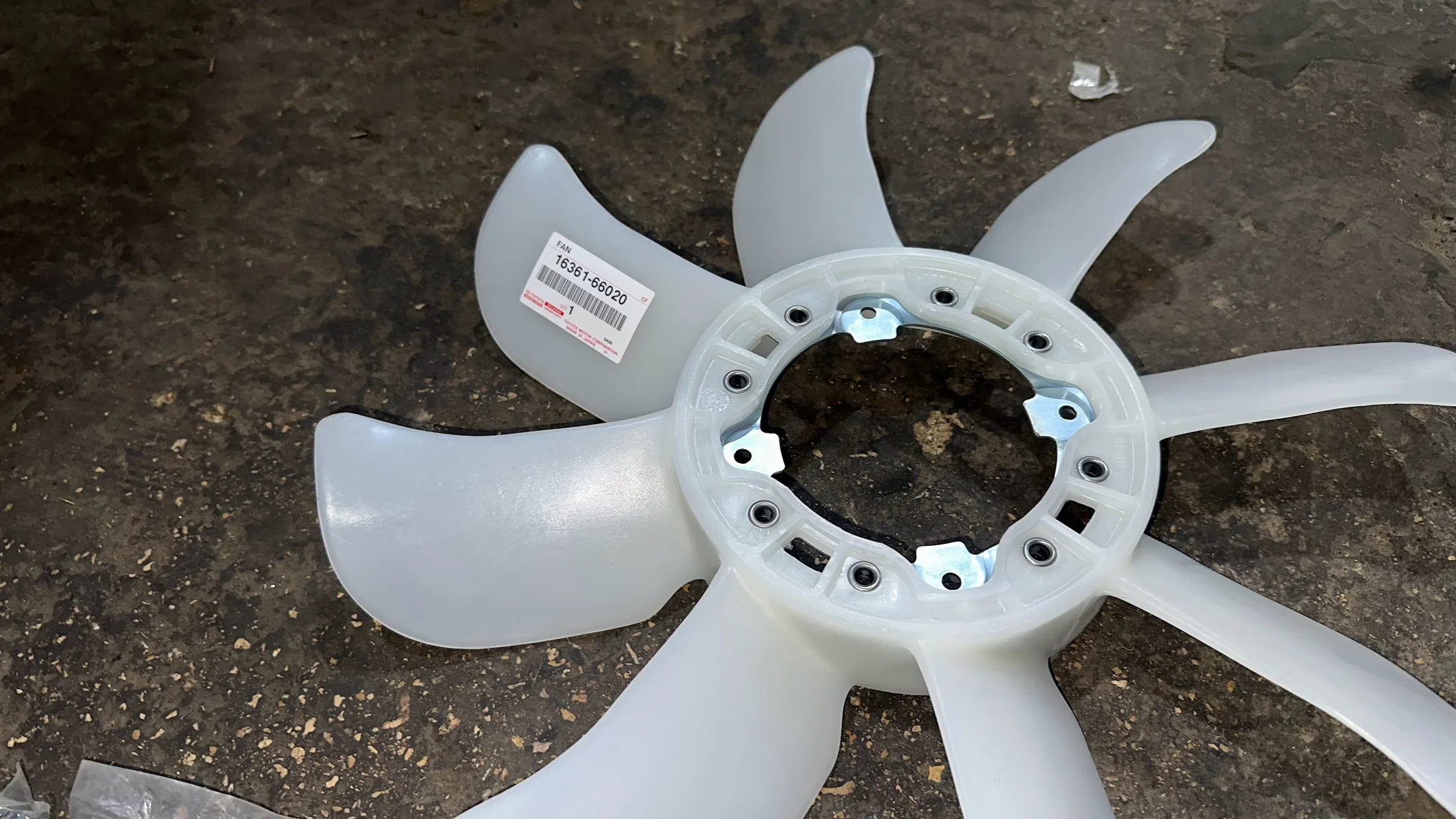

I keep remembering @OGBeno 's comment about the fan, which mentioned that it was made of plastic, haha. a new whater pump is comming too.
I figured I would replace the PS's reservoir hose as well.

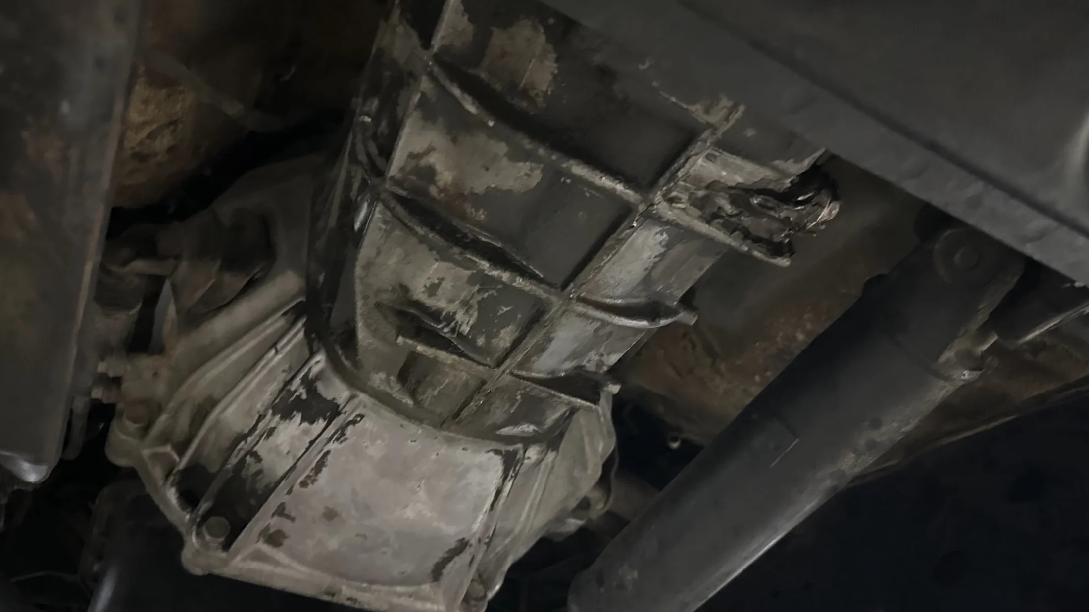

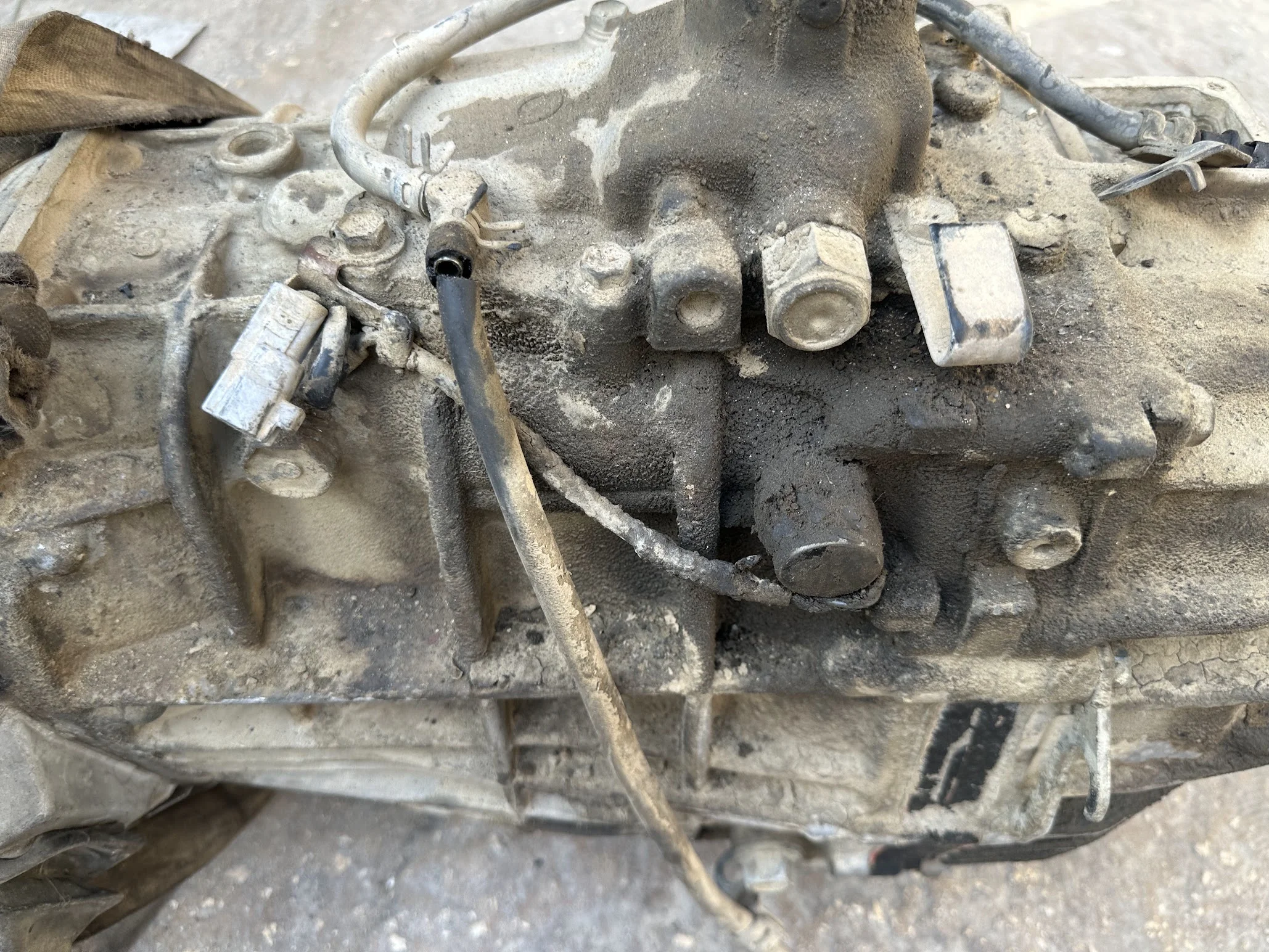

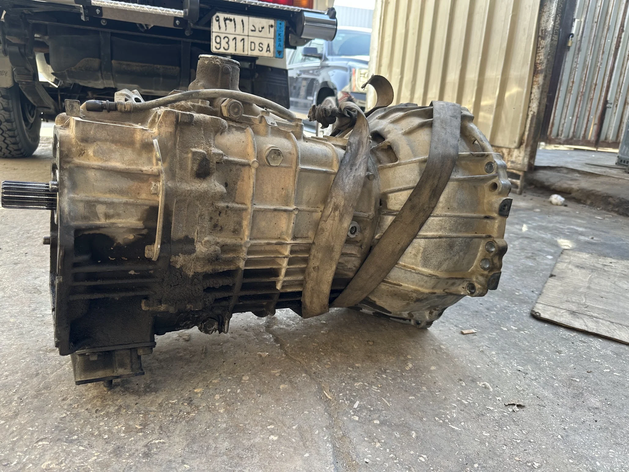

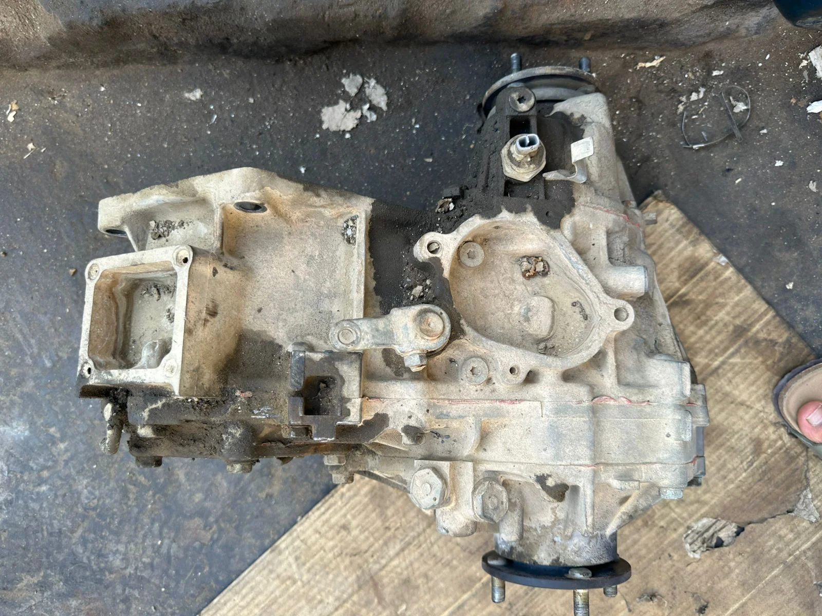

Then, the nasty transmission is sent to my friend Moboark so he can ensure all components are in good condition and allow us to heat-wash all aluminum bodies, enabling us to install new parts like switches and seals.
Nasty switches.
One of the parts we need to change is the bush for the case's shifter.
Properly done. Another example of the quality of @Meshal's work. Can't wait to see it!
We're super excited to be working with @Meshal on this one. It will end up as a personal rig for the foreseeable future, and my 75 will be up for sale. An original truck wins hands down over the repaints that we typically pull from the UAE, and a 79 > 75, of course.
Love this, great to see another solid FZJ79* making the trip across the pond. Mine is built like the space shuttle, the cab is sealed so tight I have to crack a window to make the doors close easier :)

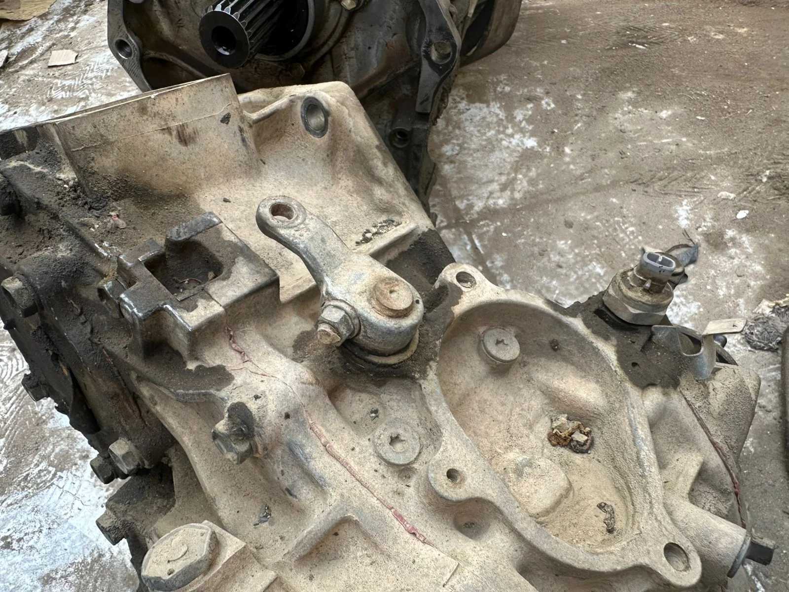

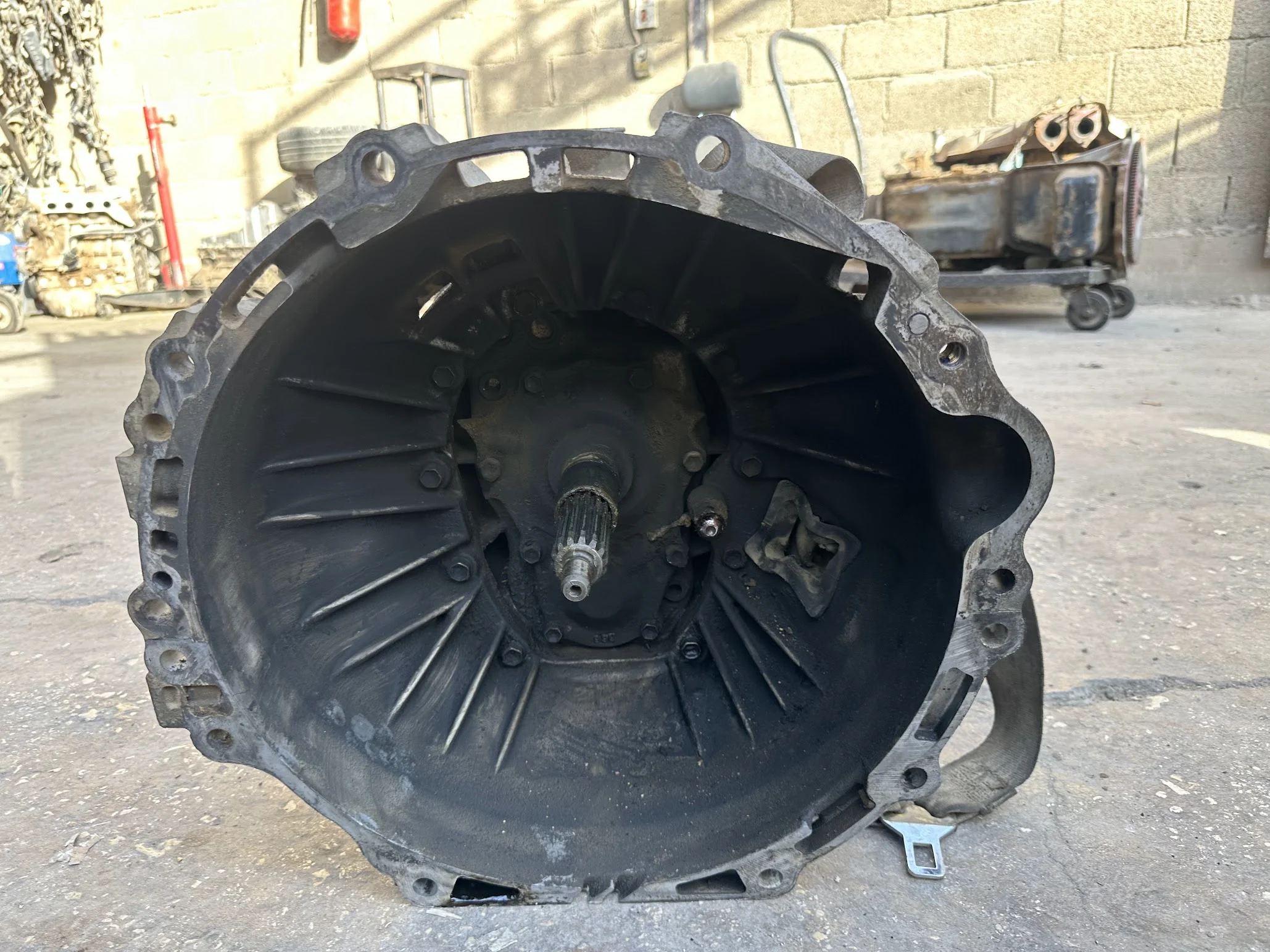

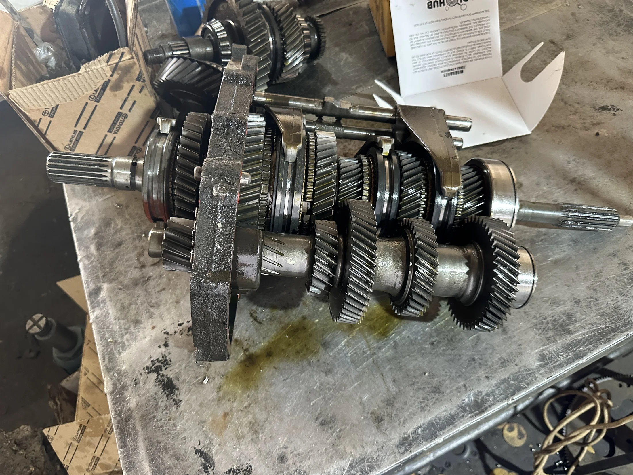

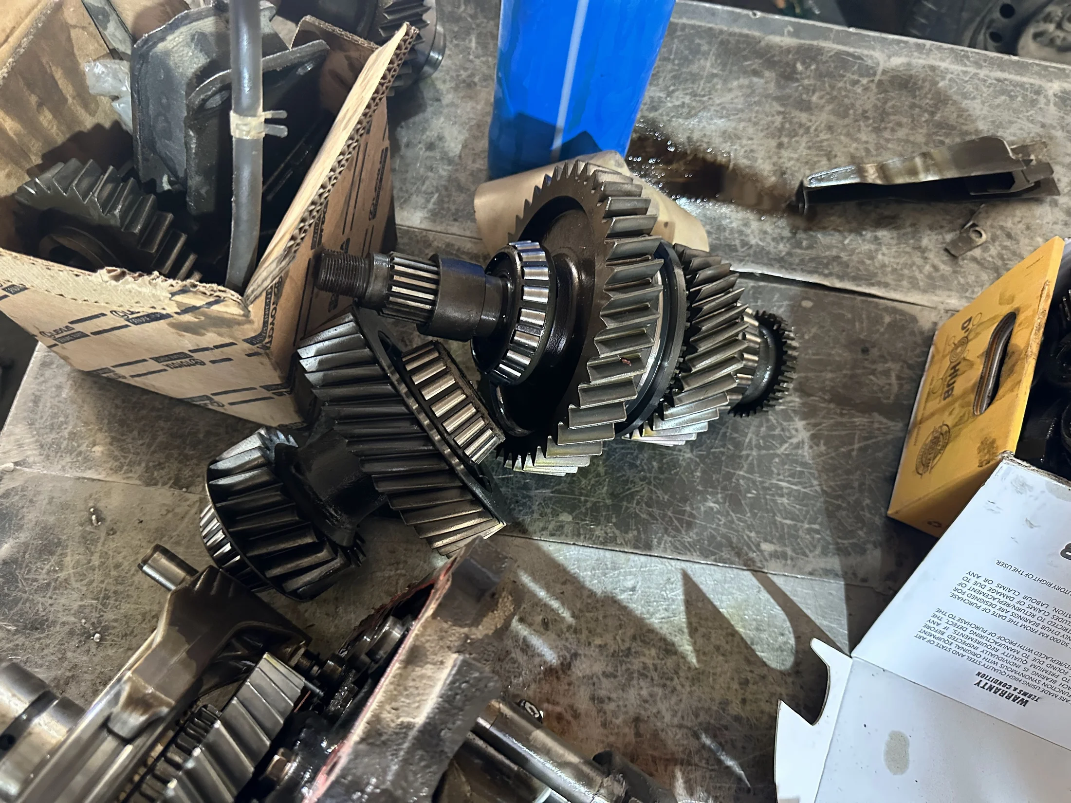

Transmission work began with unplugging the body so we could send it to the hot bath. The trans and T-case were shifting smoothly, but I did this so we could clean and inspect the inside before sending the truck overseas. Today, they should provide me with a report on the component's condition.

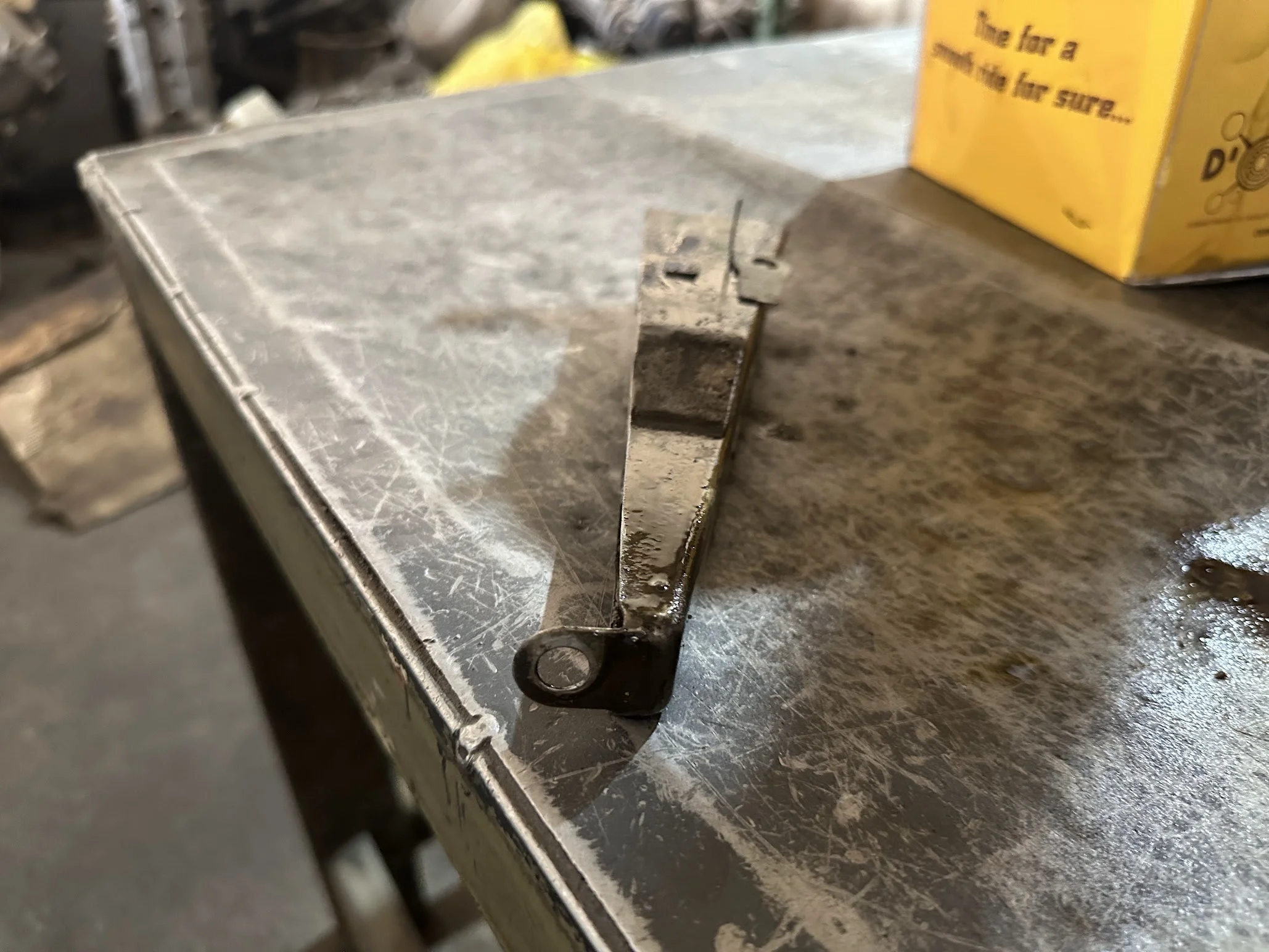

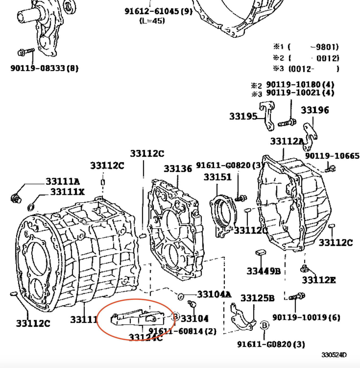

One part that they found broken is this one. I had unplugged H151 before, and this one was broken as well. My guy said you don't need it "Saudi Style", but I found a take-off for it.
This time, I would like to ask for your help: what is its function?
@orangefj45
@OGBeno
I believe that it's located in the catalog. Part number:33124-60020, SUB:33124-60070
Alright, my part guy couldn't help with the rod difference, so he replaced it with an OEM set; I need to check with 555 to find the right fit for the modern J7X for future projects.

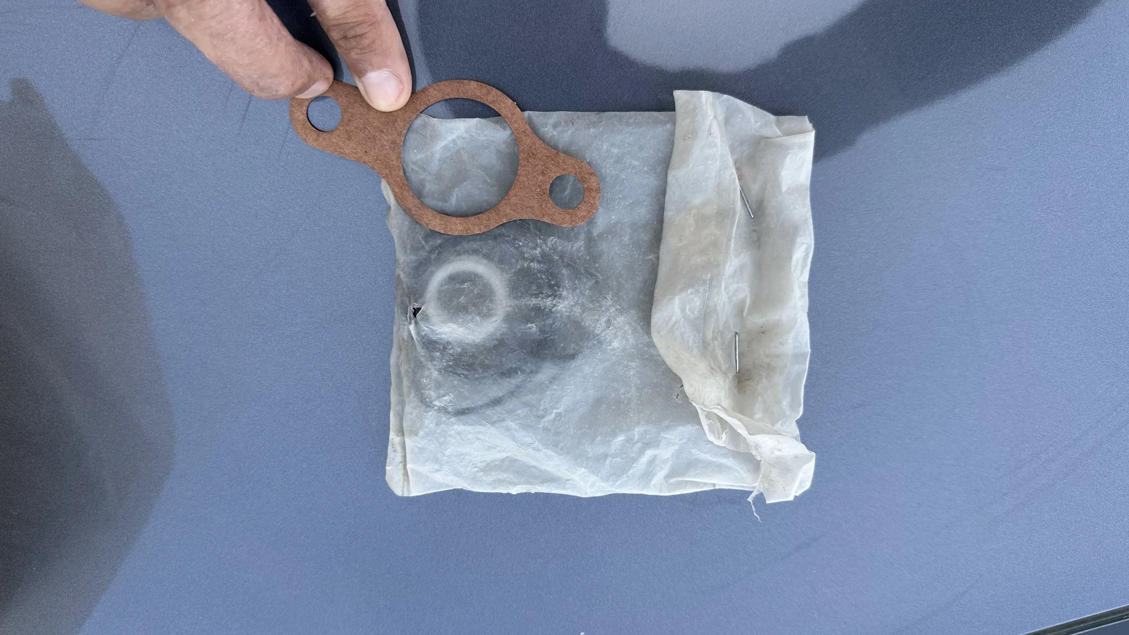

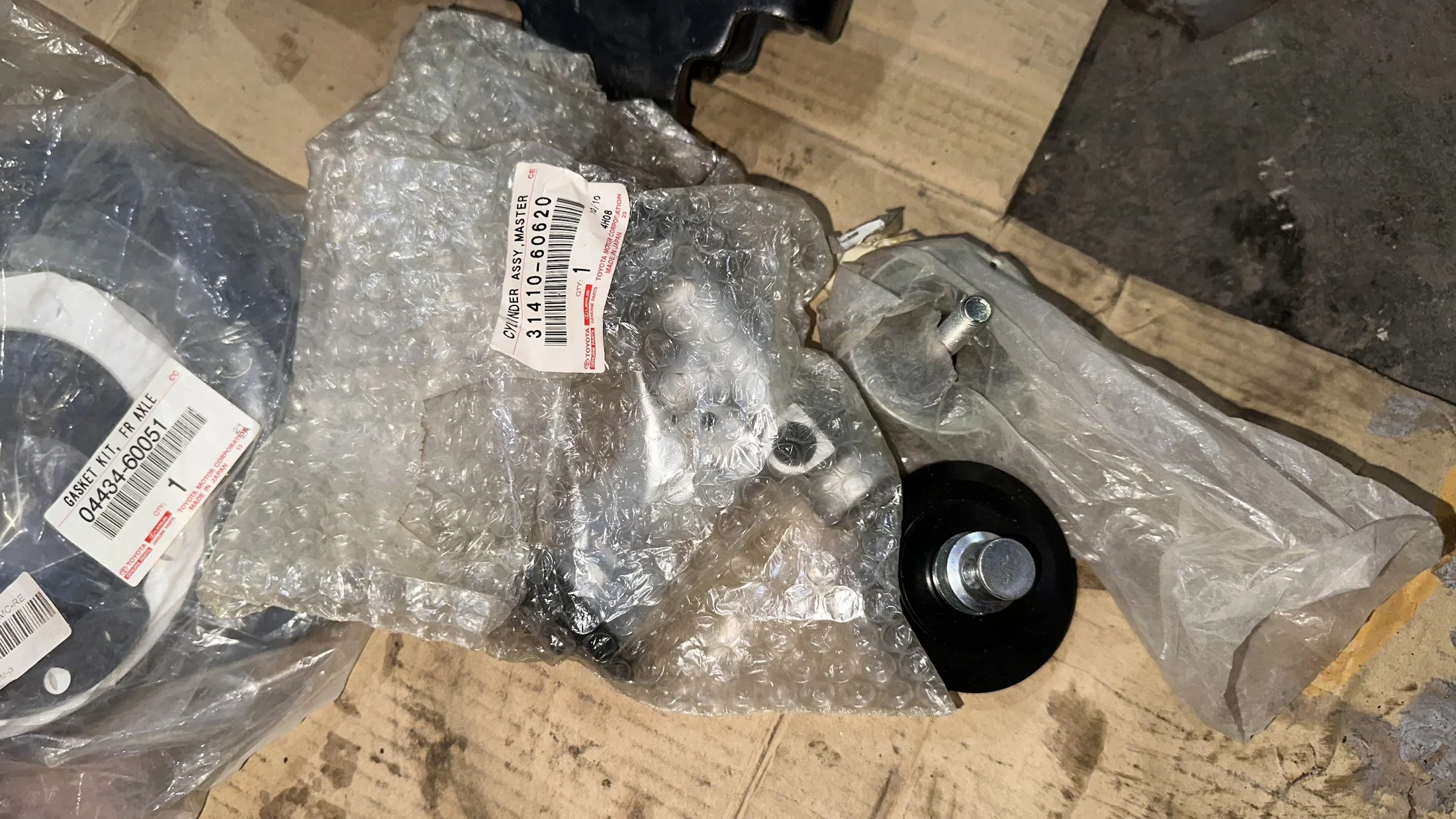

Clutch master's gasket: and an H150 rebuild kit showed up too
  • Gasket, clutch master cylinder
    31415-60020
  • Gasket kit, manual transmission overhaul
    04331-60200

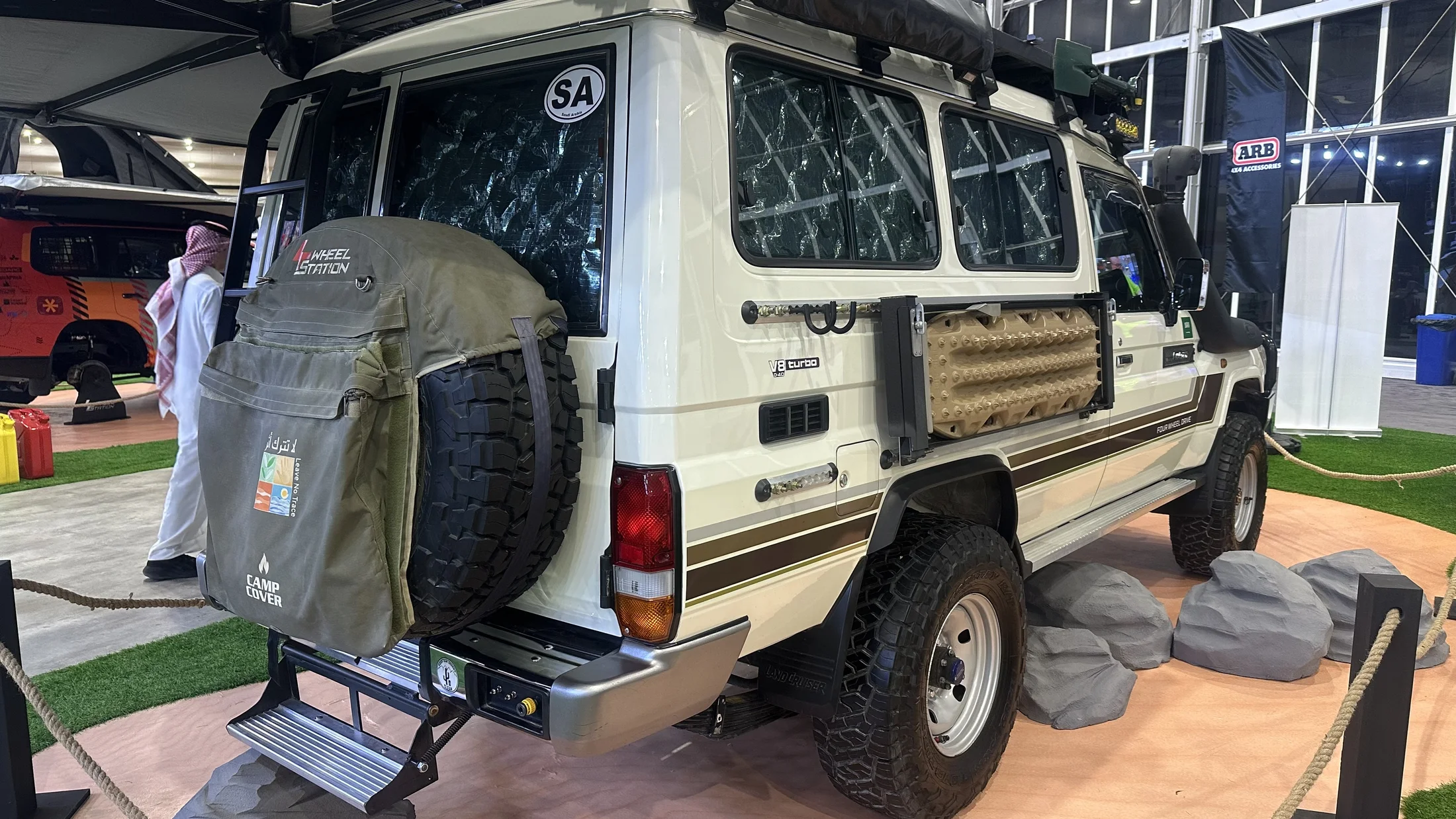

No work today because the aluminum needs another day to wash. however i decided to go to the falcon and hunt expo to do some gears shopping for my fj45 troopy.
those are some of the 70 series i saw
this whole ugly ass is a bathroom.
a 78 built by @Lo2aY in his professional shop 4Wheel Station
another 76 by Loay for a guy who drove around the world or something like that. some fancy snapchat celebrity
