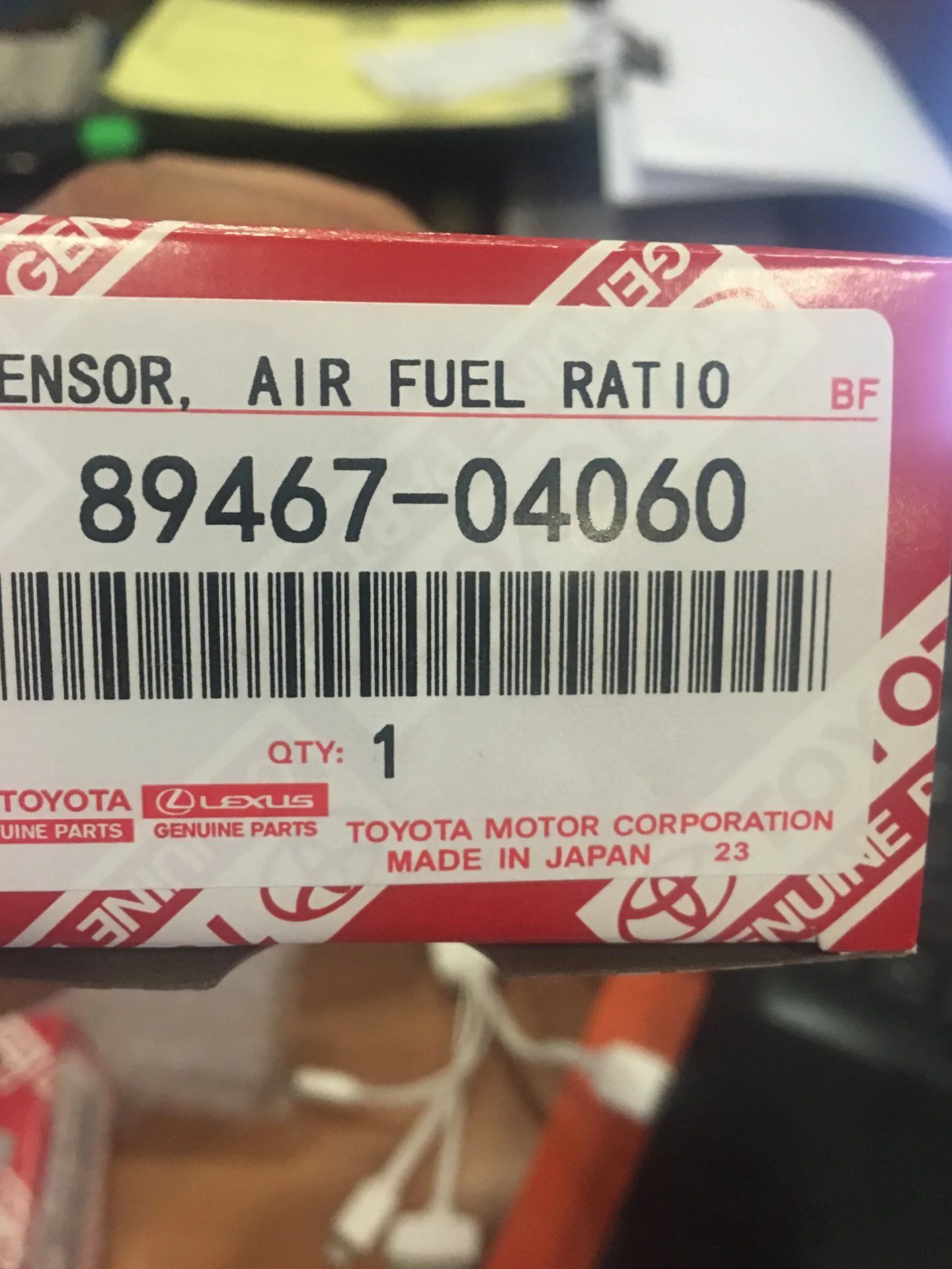

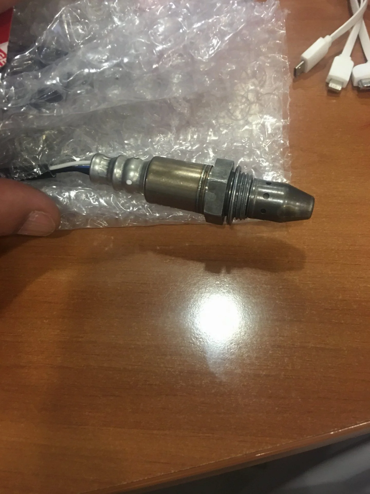

So I received A/R sensor today and they sent me different part number.
If it fits, and I think it will, will it cause any difference/issues?

it says on ebay and alibaba website that those number are interchange with 234-9051 denso
Toyota Sequoia Tundra Tacoma V8 Air Fuel Ratio Sensor 89467-04060 234-9051 15996 | eBay
Alibaba Manufacturer Directory - Suppliers, Manufacturers, Exporters & Importers
I don't see how. My A/F sensor did not look like that from Denso. Install at your own risk.
What year is your LC? That looks like something for a six cylinder. The Alibaba link says it is for 2006-2007 Tundra or Toyota.
It's lx 07
Ya it's for tundra 4.7 with same engine.

I double checked and its oem denso
So, let me get this straight. You start out by posting that they sent you the wrong part number and now you are convinced it is the right part number? You don't have to convince me of anything. Put whatever you want in your LC but be sure to post back the results when you are done.
I'd make very sure o2 sensor is a match to your year 07 and model (Land Cruiser or LX) using a Toyota or Denso parts info, not a general retail web sight like ebay, amazon etc...
It's returnable or resalable until you install, then value drops in 1/2.

i am not trying to convince you. i was trying to find out if the part number/AF would work fine or i will have issues.
but since it was oem and its compatible with 4.7 engines, i was going to give it a shot, otherwise i will return it.
Thanks Paul,
that's what i was looking for.
already contacted the seller and provided the part number KYlandy posted earlier.
Thanks
