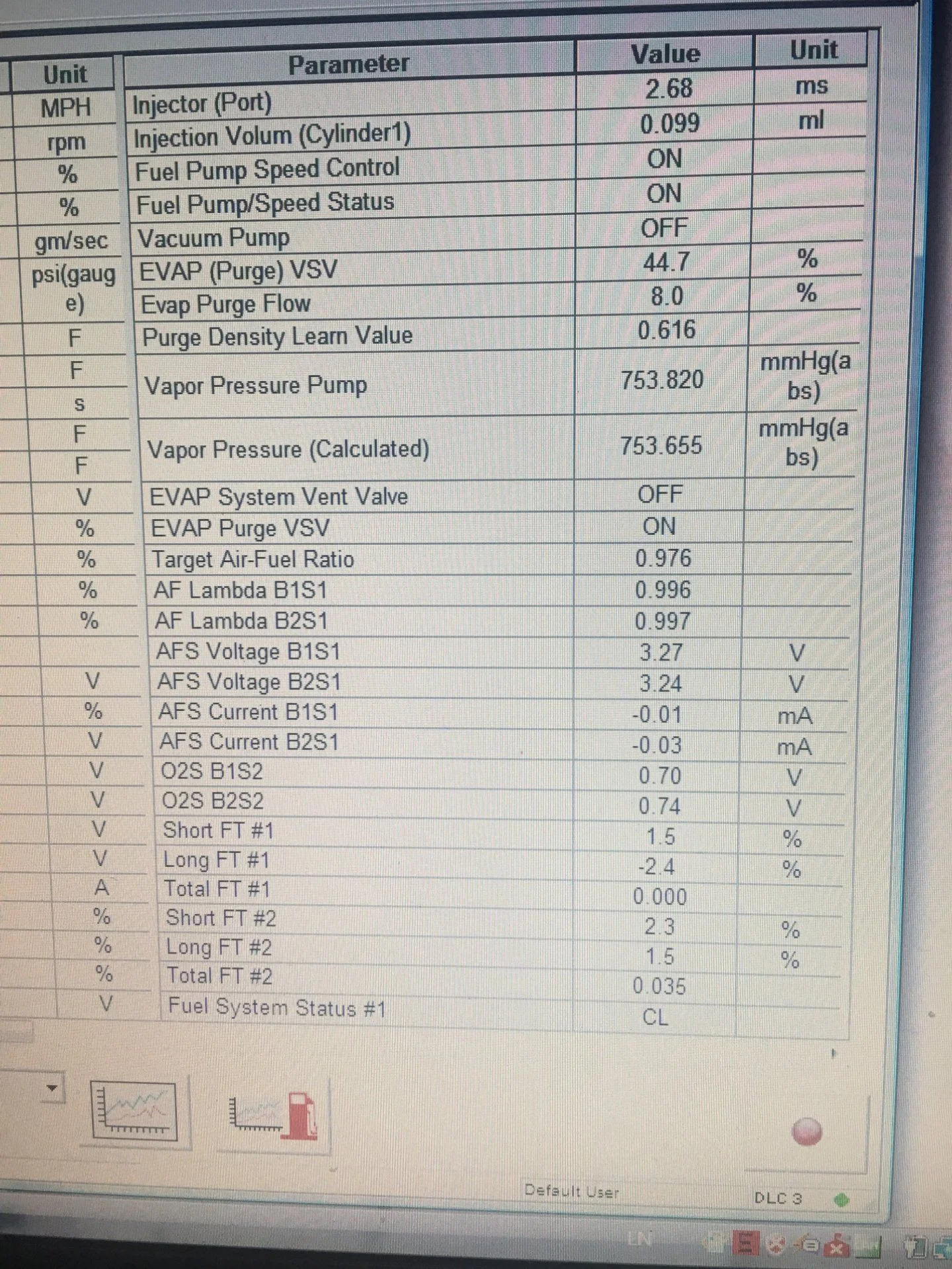

Can those with more experience than me take a look at the freeze frame data in the photos and tell me if you see any obvious issues?

The code that you have is a catalytic converter below threshold code and relates to a catalytic converter code. According to snap on's shop stream software it is about a 60% chance of being a catalytic converter and only 40% chance of being an oxygen sensor or an air fuel sensor.
Once you have ruled out the air fuel sensors and the oxygen sensors by swapping them if the code still persists then your catalytic converter truly is below threshold specs.
You may have noticed from my previous threads that I am dealing with a catalytic converter that is on the threshold and will throw the code sometimes and won't other times.
Good luck with solving your problem and please post your Solutions and your progress on this thread as it will help others that will come after us.

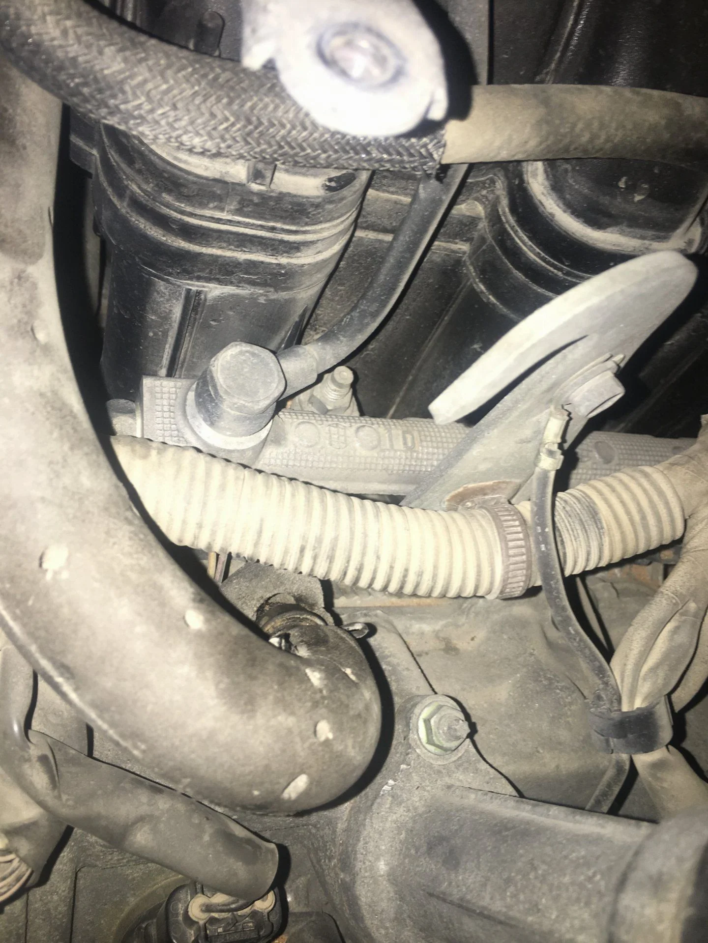

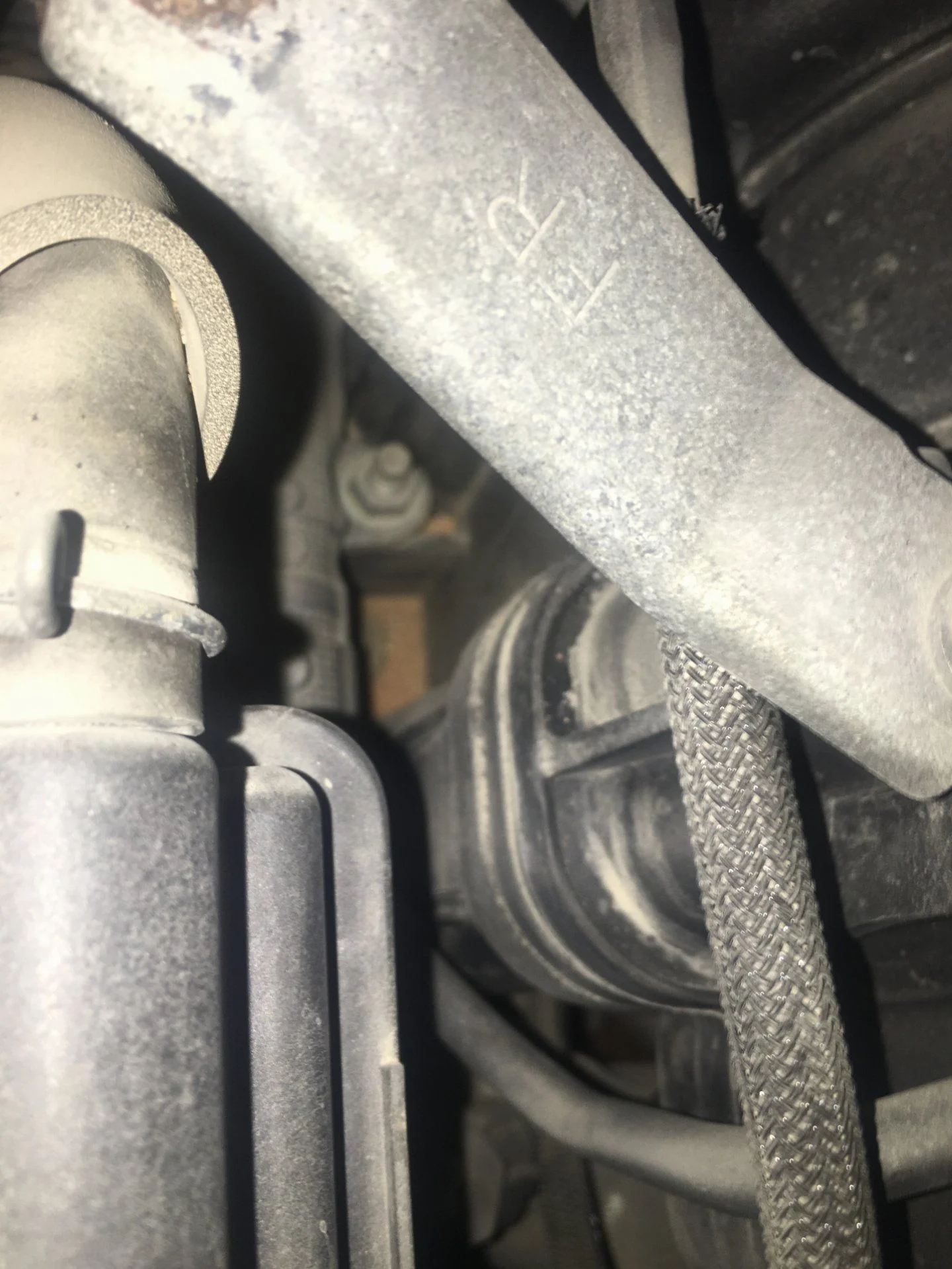

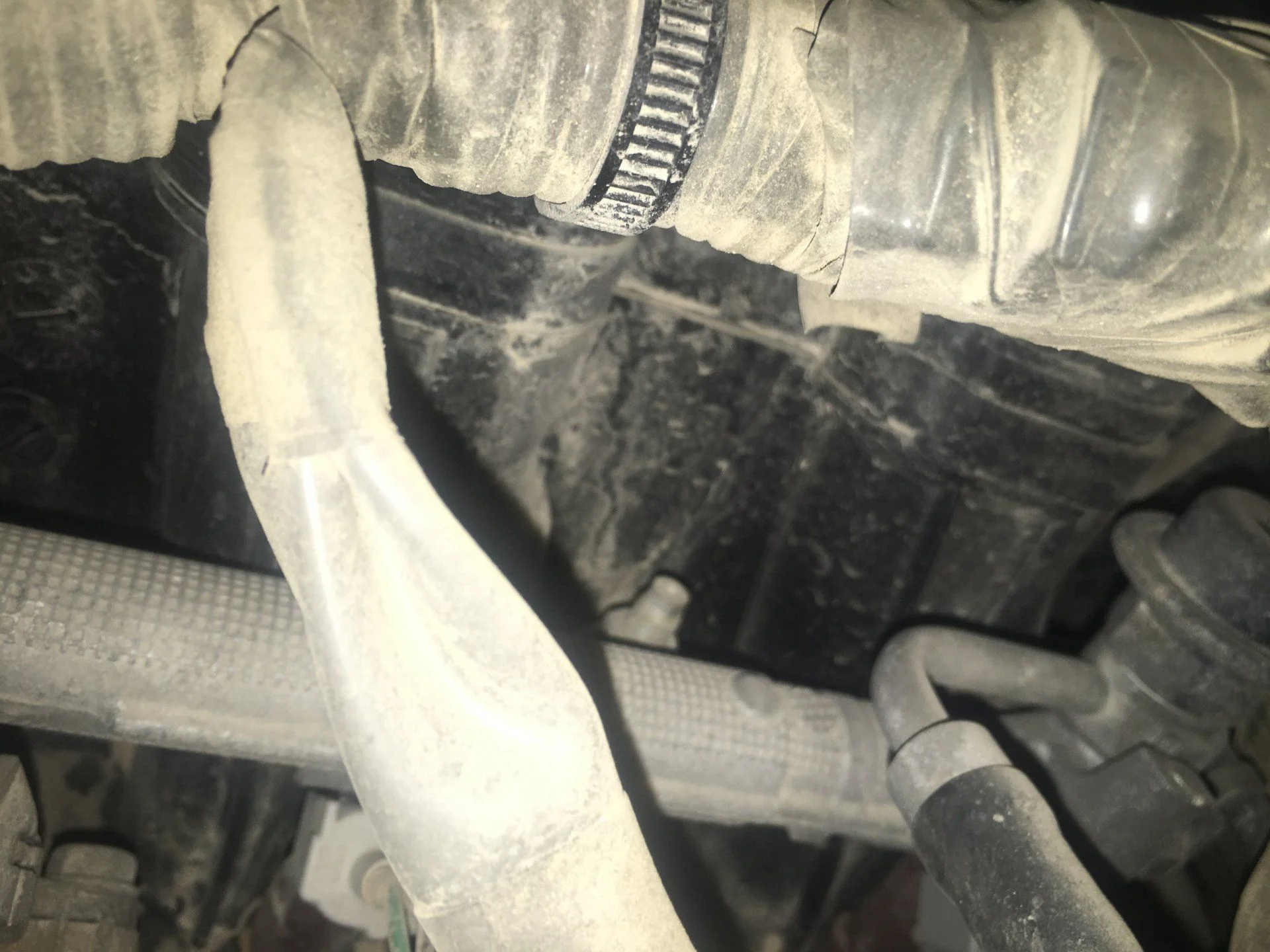

Here are some pics I took
No leaks but some sand
or this is not where leaks should appear?
I can't see bottom half of your plastic intake ports real well. But from what I do see they look dry (no oily build up). This would indicate you've a good seal at intake gasket.

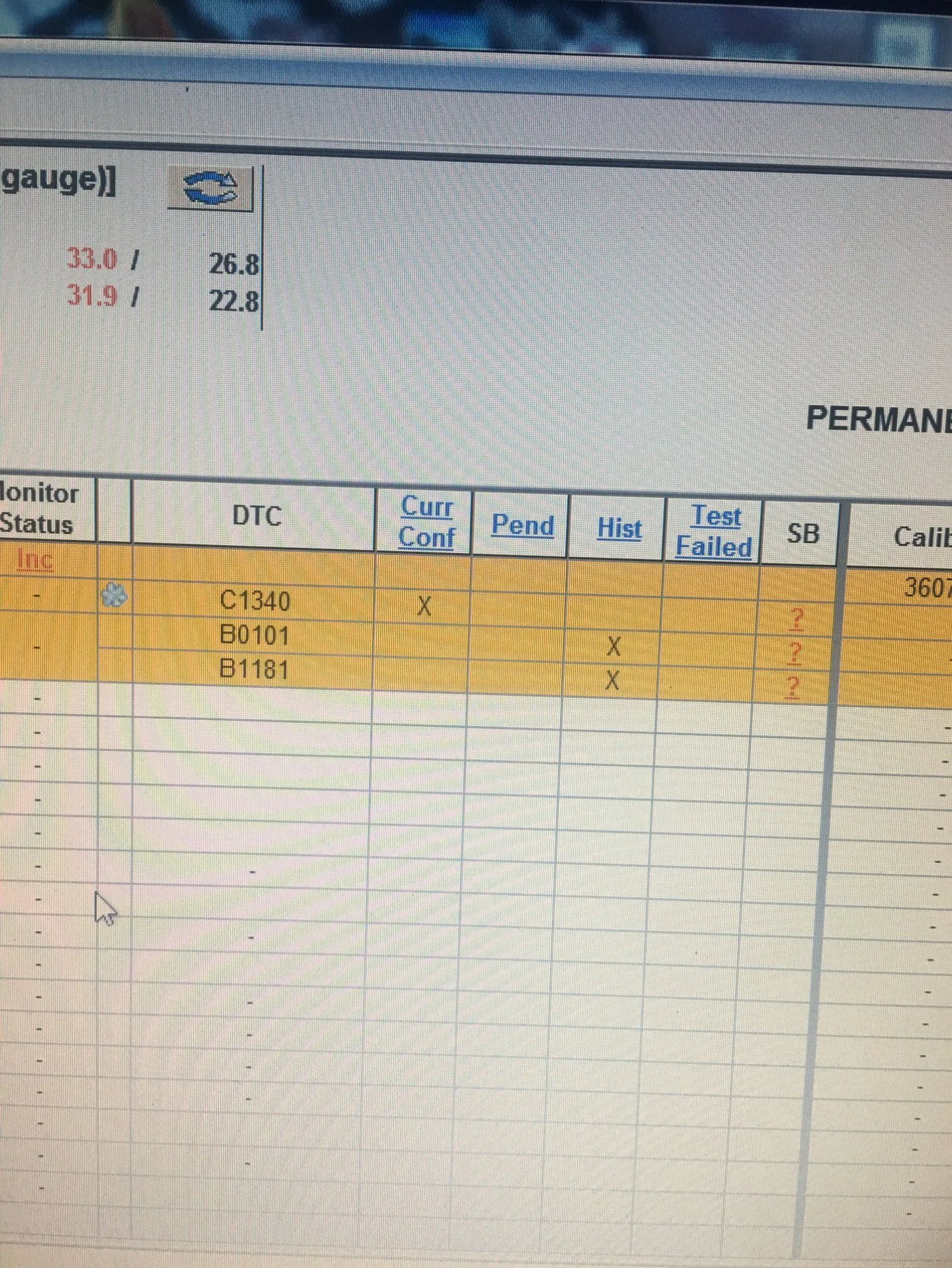

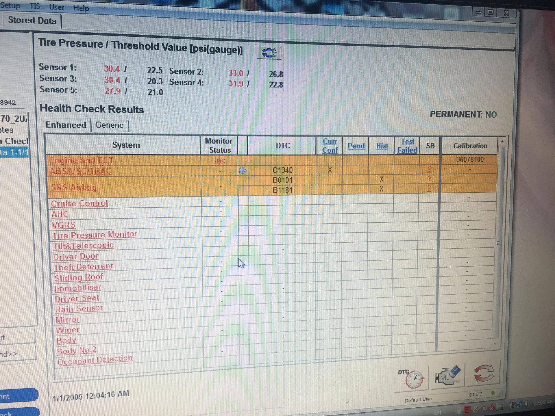

i still keep getting the P0430 every 200-300 Miles i clear it right away. This weekend, i decided to replace my K&N air filter and have paper filter (as backup when i clean K&N). Once i installed it, i drove off and code triggered right away(didn't clear it yet). i thought maybe this new filter has more breathable air Than K&N so, decided to clean MAF and see if the Code will disappear, it didn't so i cleared it.
While i was checking the rear pressure after installing new springs and spacer (Thanks Baddo Pressure is perfect now) i found a code in TIS C1340 which is Open circuit in central differential lock signal. all my search on the code was getting same result except one :
C1340 Engine Code Meaning - C1340 Engine Trouble Code - How To Fix C1340 | EngineCodes.net
Doesn't that confirm the need of sensor replacement?
"i am still waiting on my sensors to be delivered and replaced"
oh i forgot to mention, O2s seem to work find according to TIS
Thoughts?
