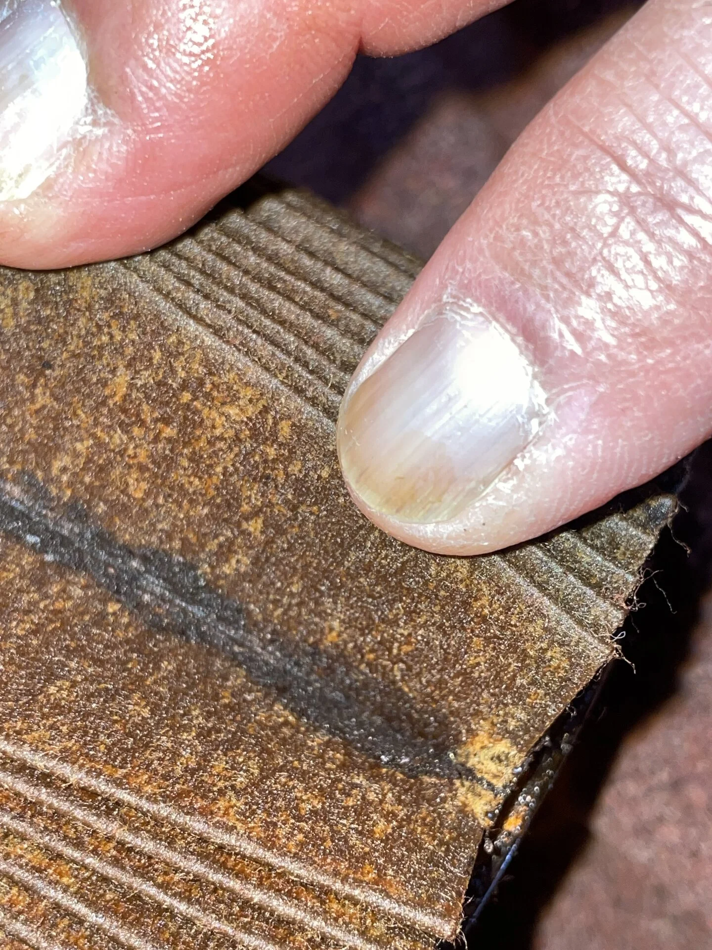

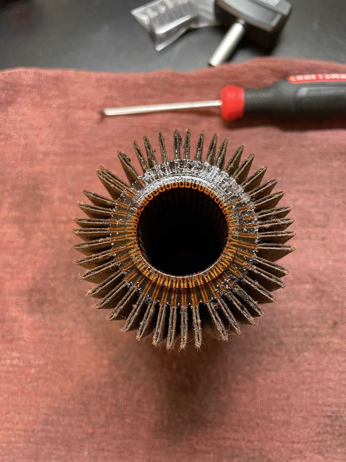

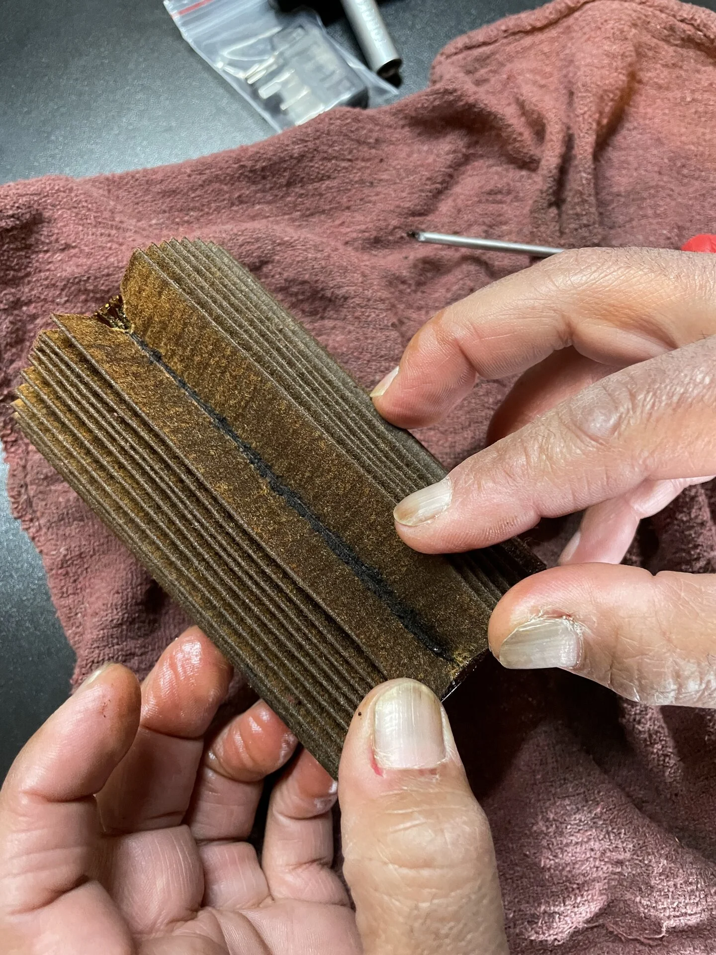

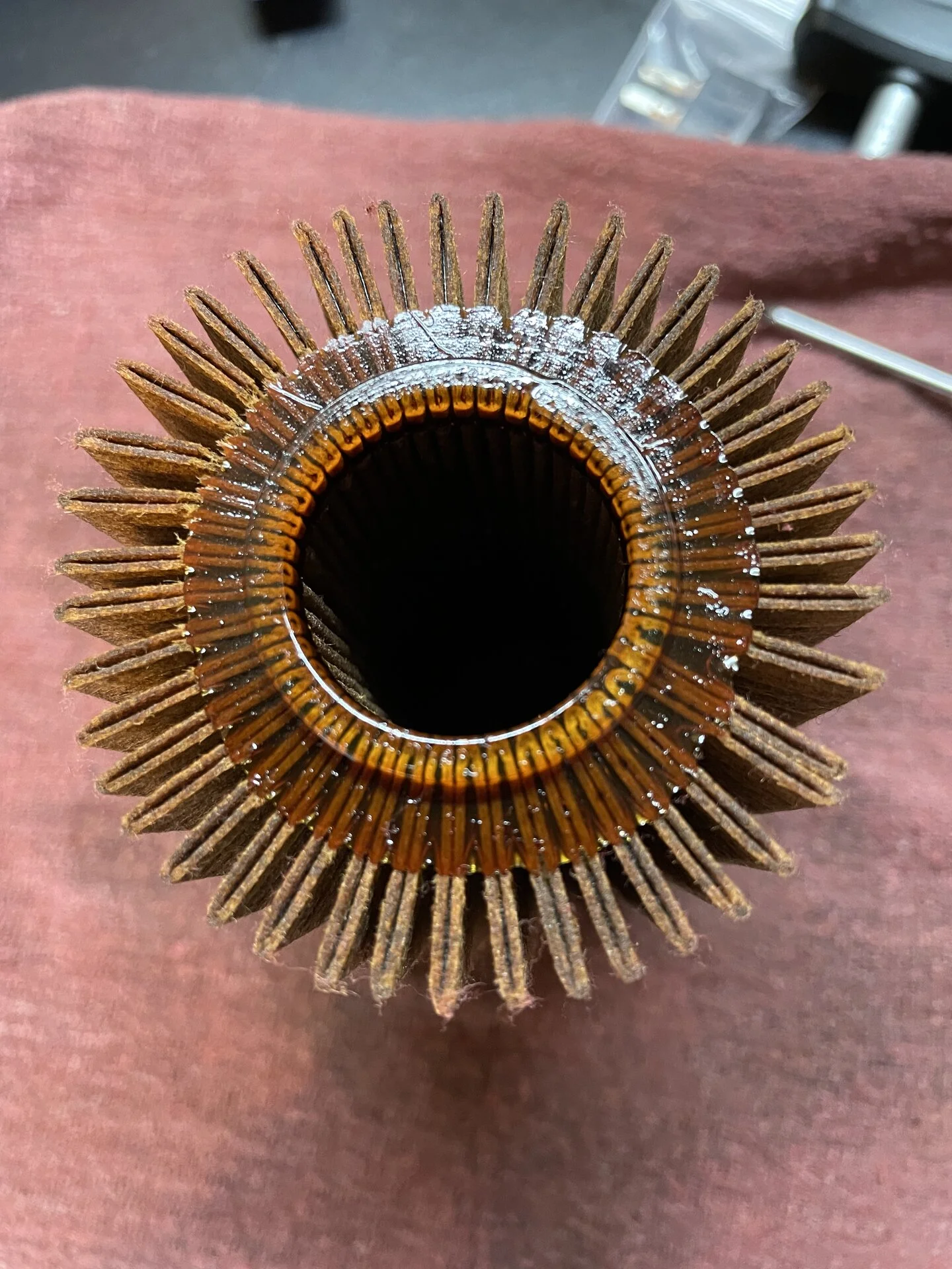

So it wasn’t split open. But I took it home so I could take a closer look at it. The master tech said it looks normal. He wasn’t alarmed. This looks like a normal filter to me. There is no metal debris or anything indicative of metal debris. My magnets didn’t pick up anything when I ran them through/over/in the pleats. No glitter using direct light. Curious what y’all think.
I picked out some of that gunk and nothing was metallic. The lighter colored specs were soft and more like pieces of filament. Not metal.
Doesn't look like metal. Usually when they go they go quick. There really isn't a chance for the carnage to get into the oil. If it's just a bent valve consider yourself lucky. What we saw was when the spring broke it dropped the valve down in the cylinder. That then broke in a few pieces hitting more valves and breaking them. Then the motor stopped.
There is still a small chance that rod bearing isn’t happy but it isn’t worth dropping the upper pan and pulling the piston to find out for sure. After all this happened at low engine output.
I’d say the filter state is great news..

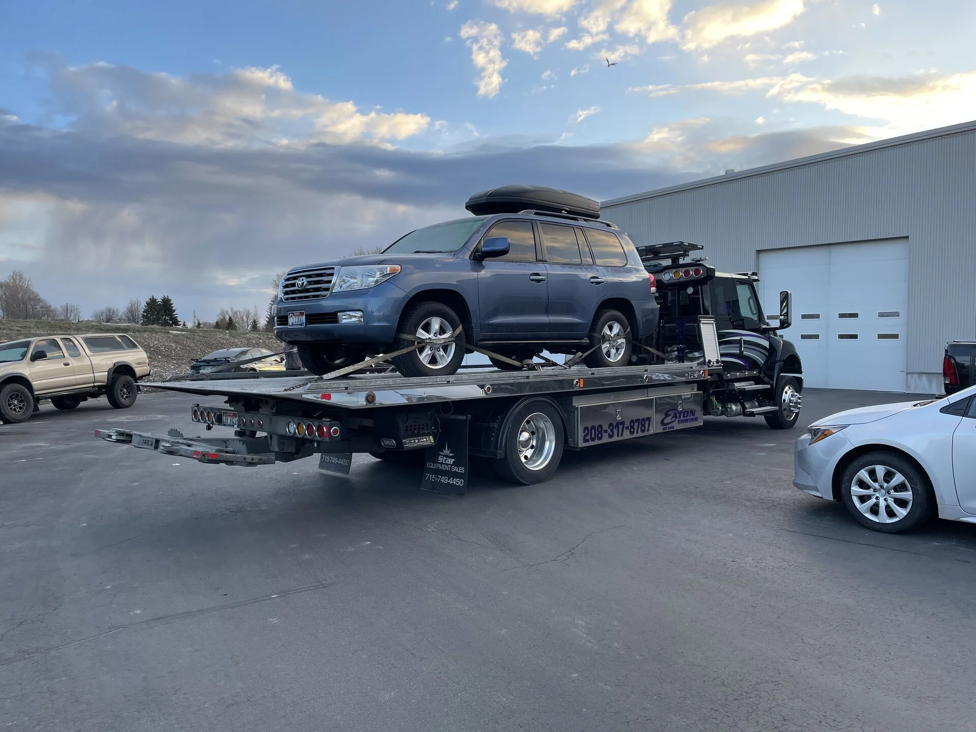

She’s on her way to Bozeman. Overland Cruisers is expecting her later this morning. She’ll be in good hands. Crazy…seeing her pull away on the flatbed I was freaking emotional. I know it’s just a vehicle. But it’s not.
Even the bird in the sky doesn’t know what to make of a Landcruiser on a flatbed wrecker
sure, it’s got 4 wheels and an engine which makes it a car but it’s also a representation of all the memories it’s made possible for you and whoever has gone anywhere in it.
We got ours a 3 years ago and it was originally known as “daddy’s car”. That was until our first major multi week camping trip a few months later… my kids started to correct me when I would say “let’s hike back to daddy’s car”, and began to refer to it as “the Land Cruiser” on that trip. 3 years later my wife jokingly refers to as the 3rd child she never had to deliver.
