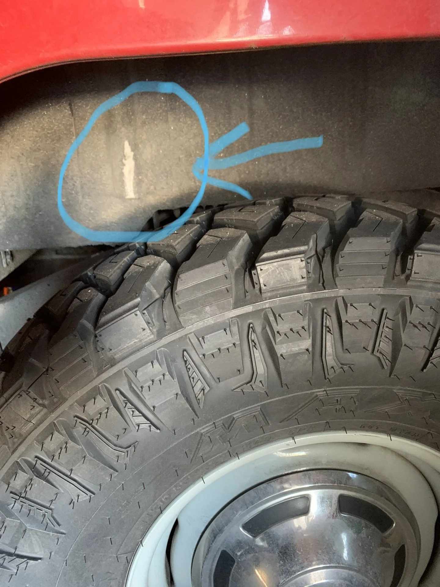

Got a ‘78 FJ40 with what believe is a 2.5” OME lift. I grabbed some 33x10.50 Maxxis Razr MTs as an upgrade to the 31x10.50s that came on the vehicle. Everything I read led me to believe the new tires would fit. After the first run with any real bumps it looks like I have some rubbing in the rear wheel wells.
How concerned should I be? It seems pretty benign other than the paint wearing off. But I’m also a total newb when it comes to making badass vehicles more badass.
where it's rubbing is fairly common and should only rub. If it cutting the tire then it's really a problem. You could try 1/4" spacers between the rim and thr drum. If you do this make sure you have enough clearance between the tire and the wheel opening and that the lug nuts have enough thread engagement. I wouldnt limit flexibility, unless it was a last resort.

I think that would make sense based on my measurements. The rub marks are ~2” in the wheel well. If you have another 1.5” of clearance you might not have the rubs.

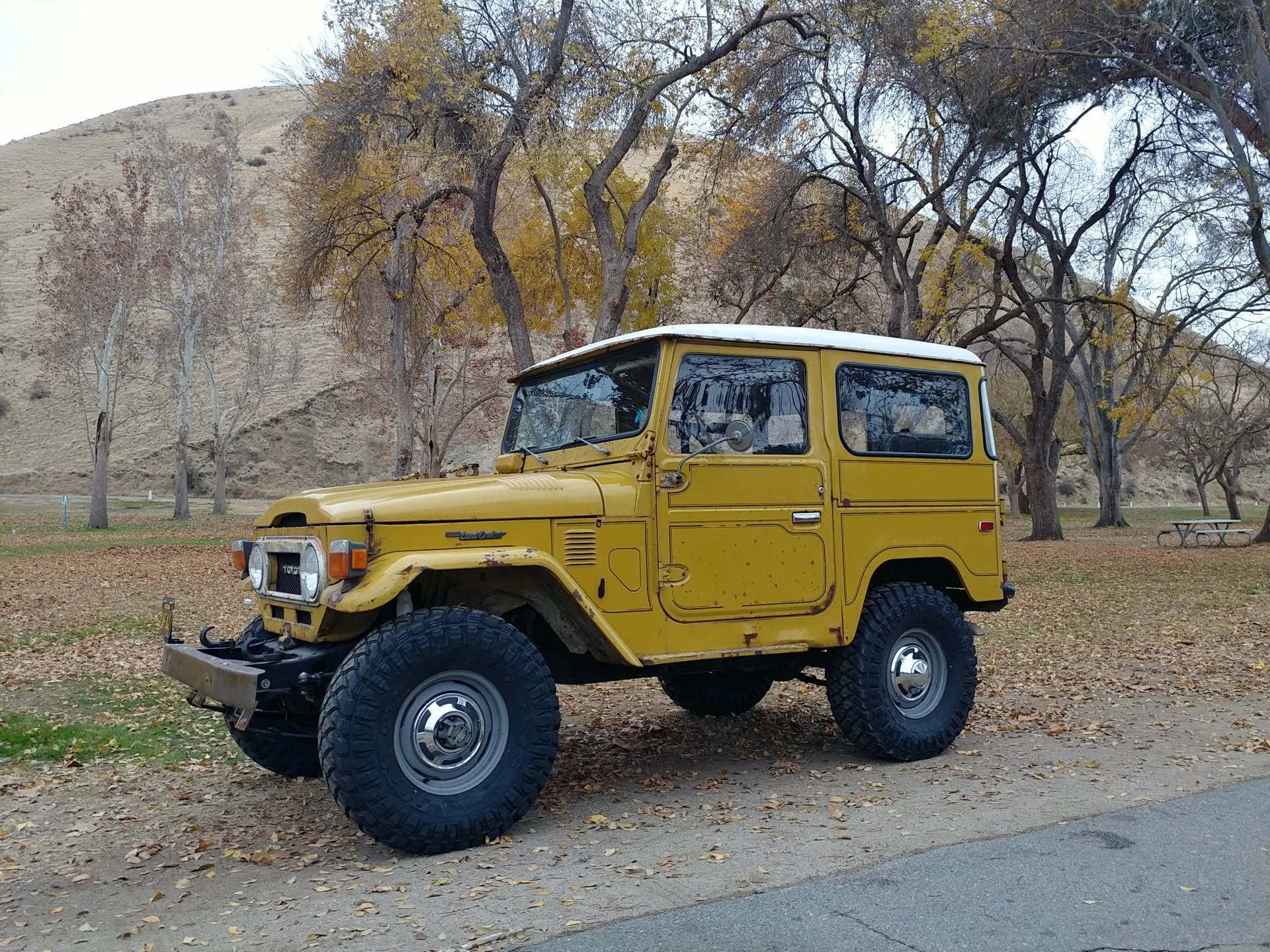

Same tire and lift combo, haven't noticed any rubbing on mine but if it does it's minimal enough to where I haven't noticed.

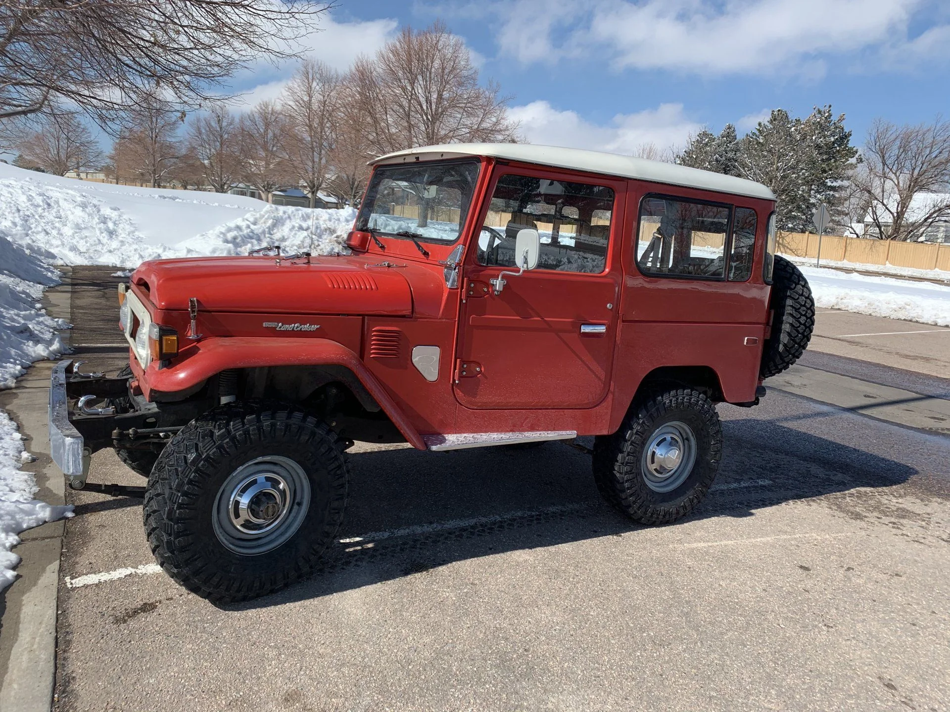

Looks like my truck with a different paint job...Yeah. I actually just noticed while I was getting gas. Didn’t notice any noise in the moment. Of course, it’s hard to hear anything in the moment, so 🤷‍♂️...Guess I’ll leave it and see how it goes.
