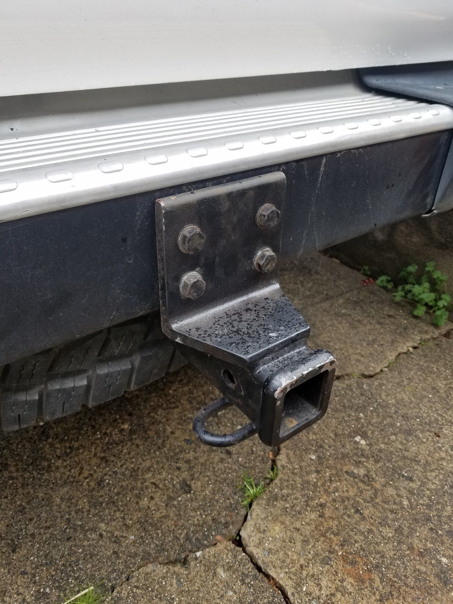

Outsane, The rear hitch should not be used for much towing. That 4 bolt bracket ties the two rear bumpers together. No link to a frame member. If memory serves. Plz. double check.
I didn't use it for towing, just holding bike racks

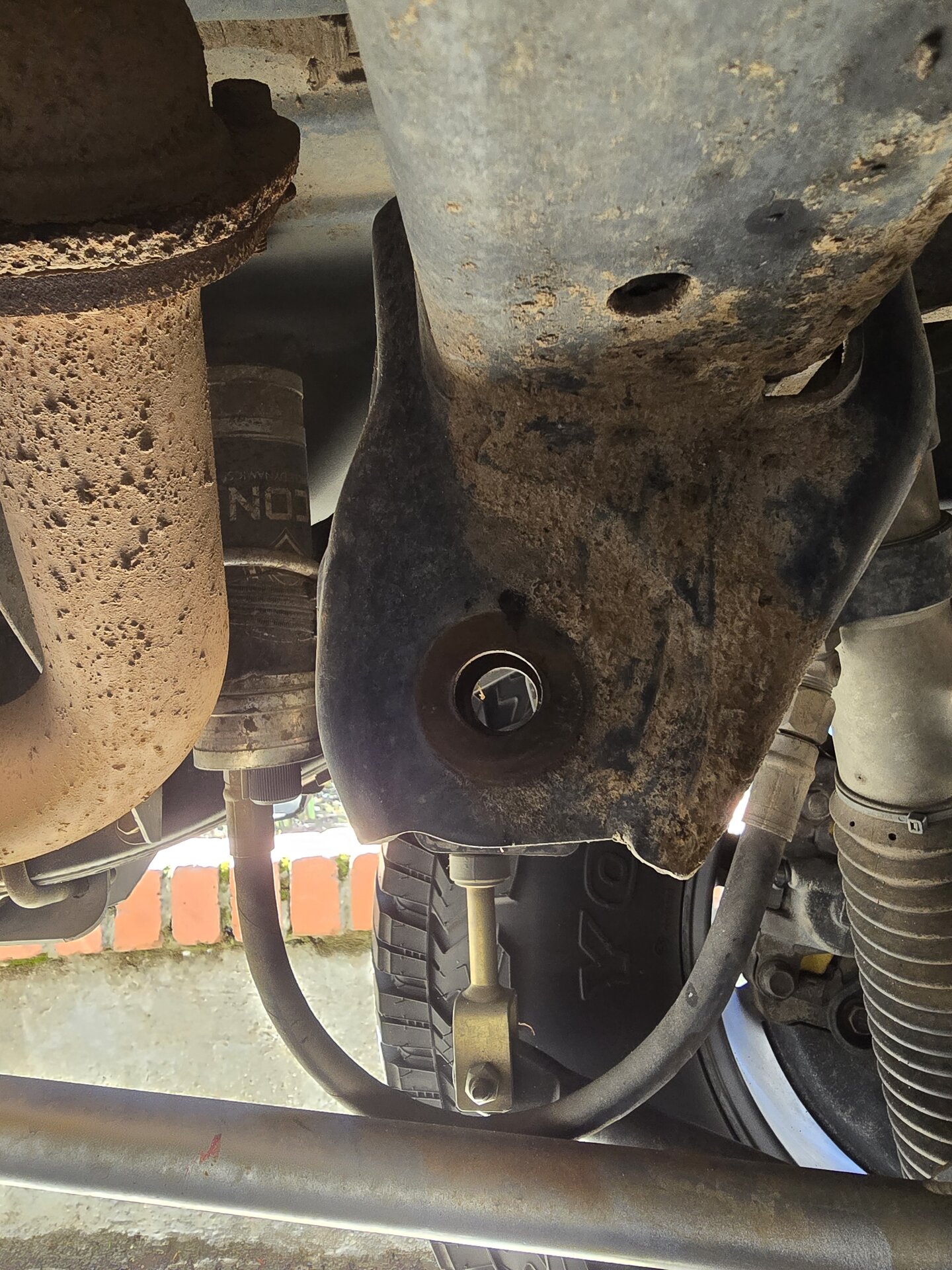

The rear upper link mount to the frame had some slop in it. I used a bolt that was too small in diameter and was supposed to replace it and never did about 40k ago.
I made some plates and welded them in.
Also replaced the printed bushings. They were all dry and not as tight. The continous rotation had worn away the tpu so the insert had some space.
