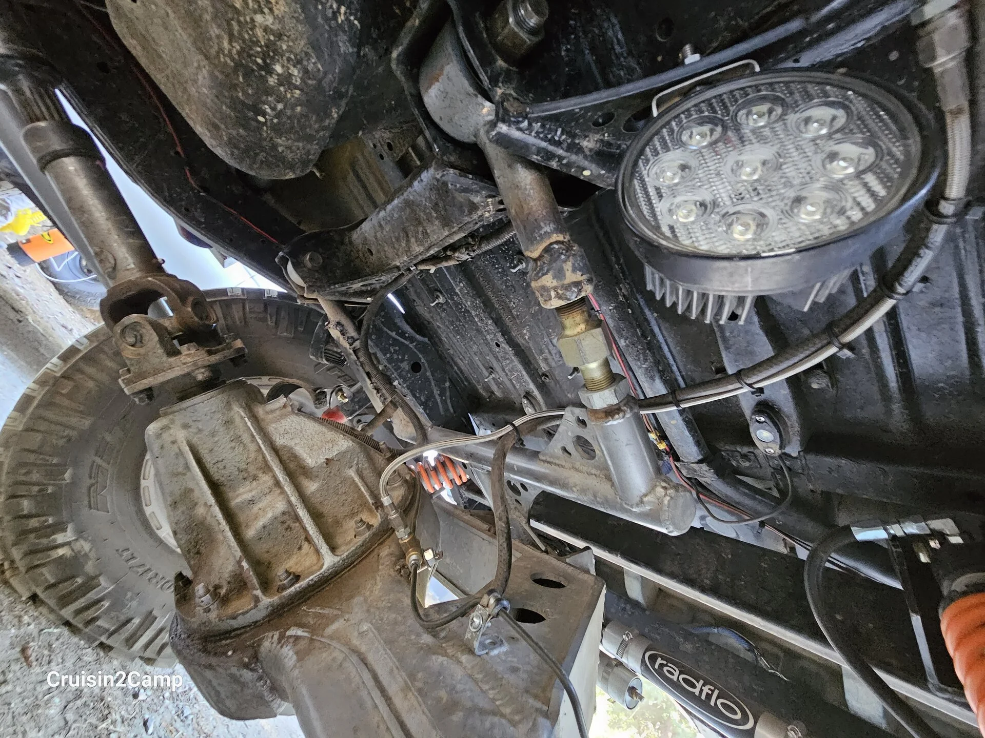

It relocates the oil filter so it faces down and does not empty its oil while sitting.
M-6880-B50 Ford racing part
Also let's you run big ford or toyota filters.

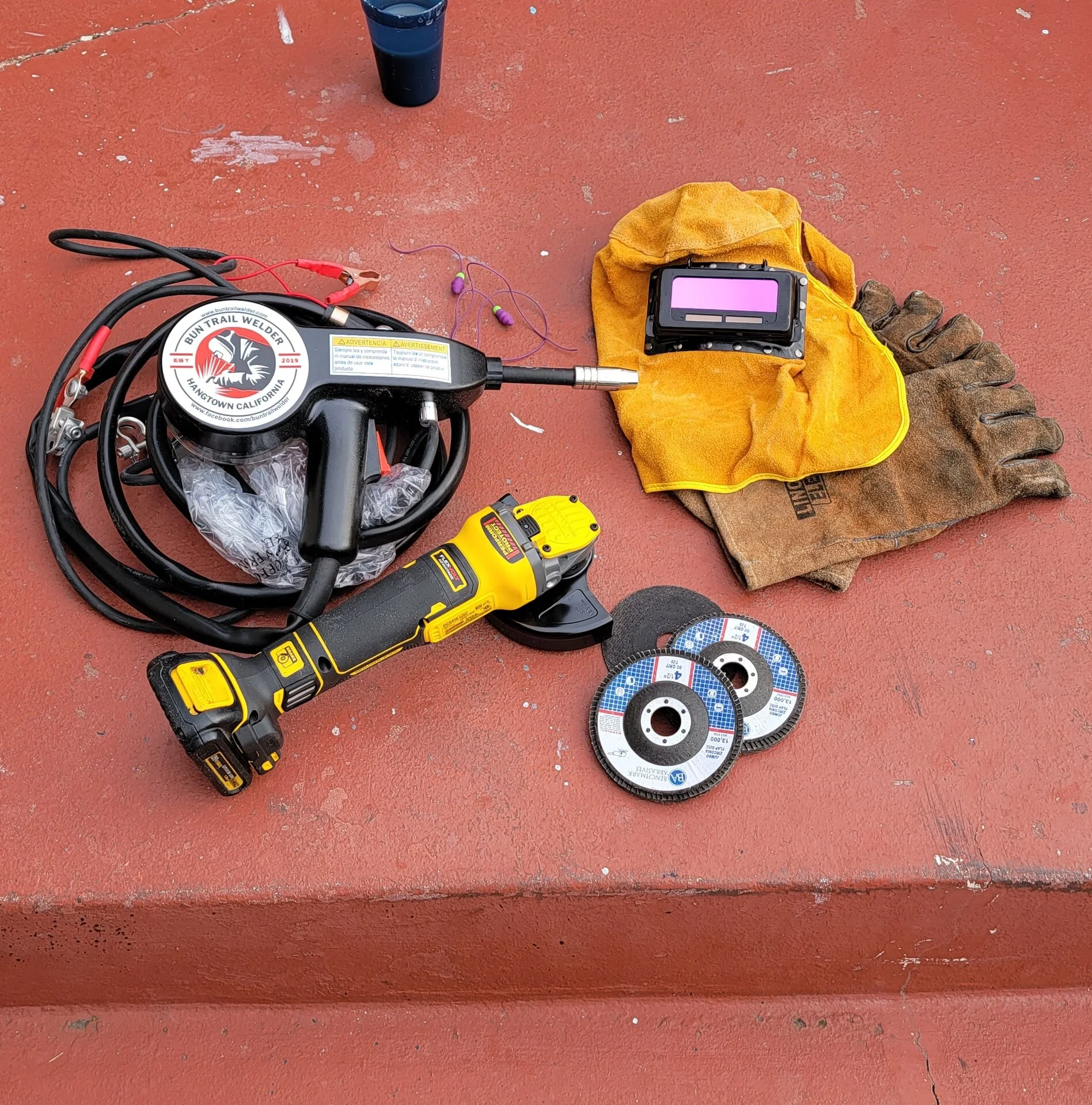

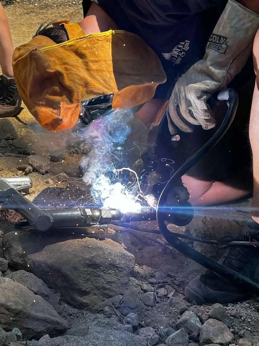

Bought a trail welder

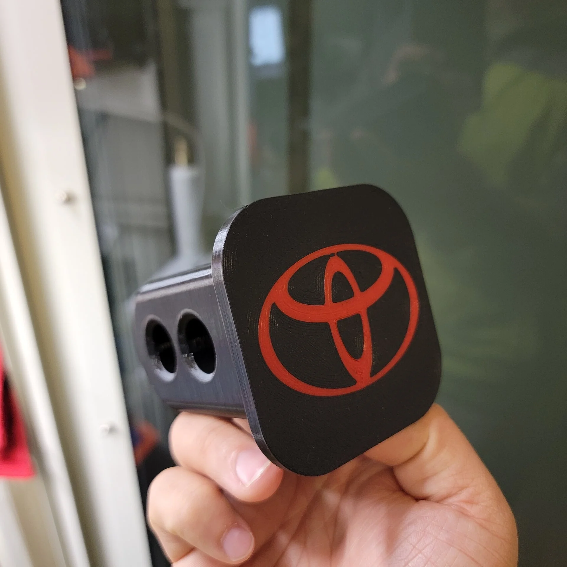

Made a hitch plug

I have used it a few times.

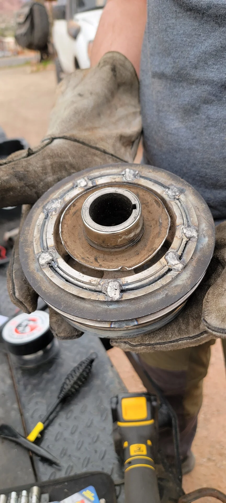

Attached a crank pulley in moab 22re
Fixed @jcardona1 rear link y thing
It's about $350 to $400
Needs 24v, usually two batteries.
I am going to try making 24v from my lipo.
It works great, it's lightweight.
Forgot the link
I built something like that to throw in my Cruiser. Last year, I put a bunch of lithium's together, dumped the whole thing in a pelican case and made it portable. For decades I ran an alternator/arc welder. I like the spool gun much more.
For the price, the Bun Welder is not bad. That spool gun is almost $200 on Amazon plus you have to mod it. I added a speed control for the spool and mostly run it near full speed anyway. With the leather hood, the battery jumper, all the clamps and controller, I'm about $300 into mine.

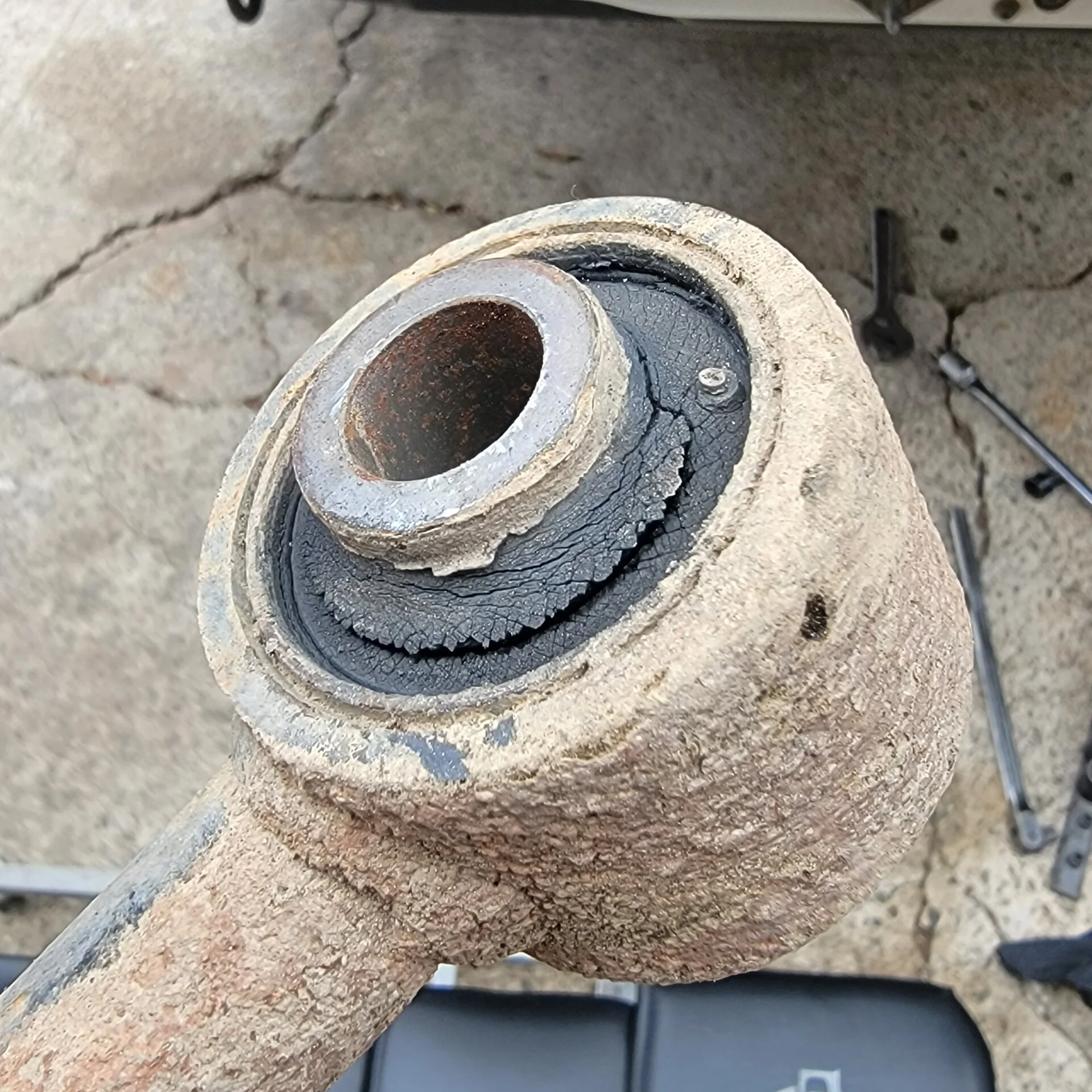

I made 3d printed bushings for the rear upper links to replace these.

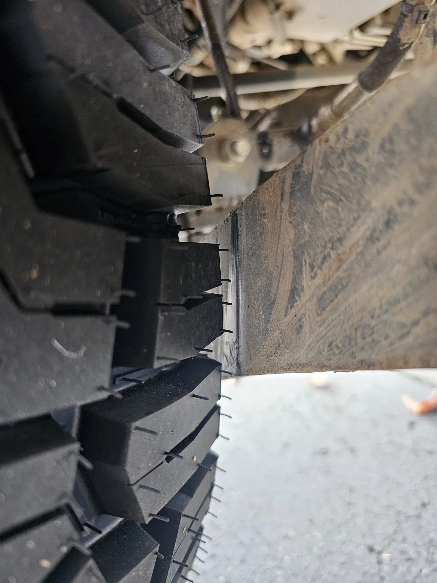

Little trim

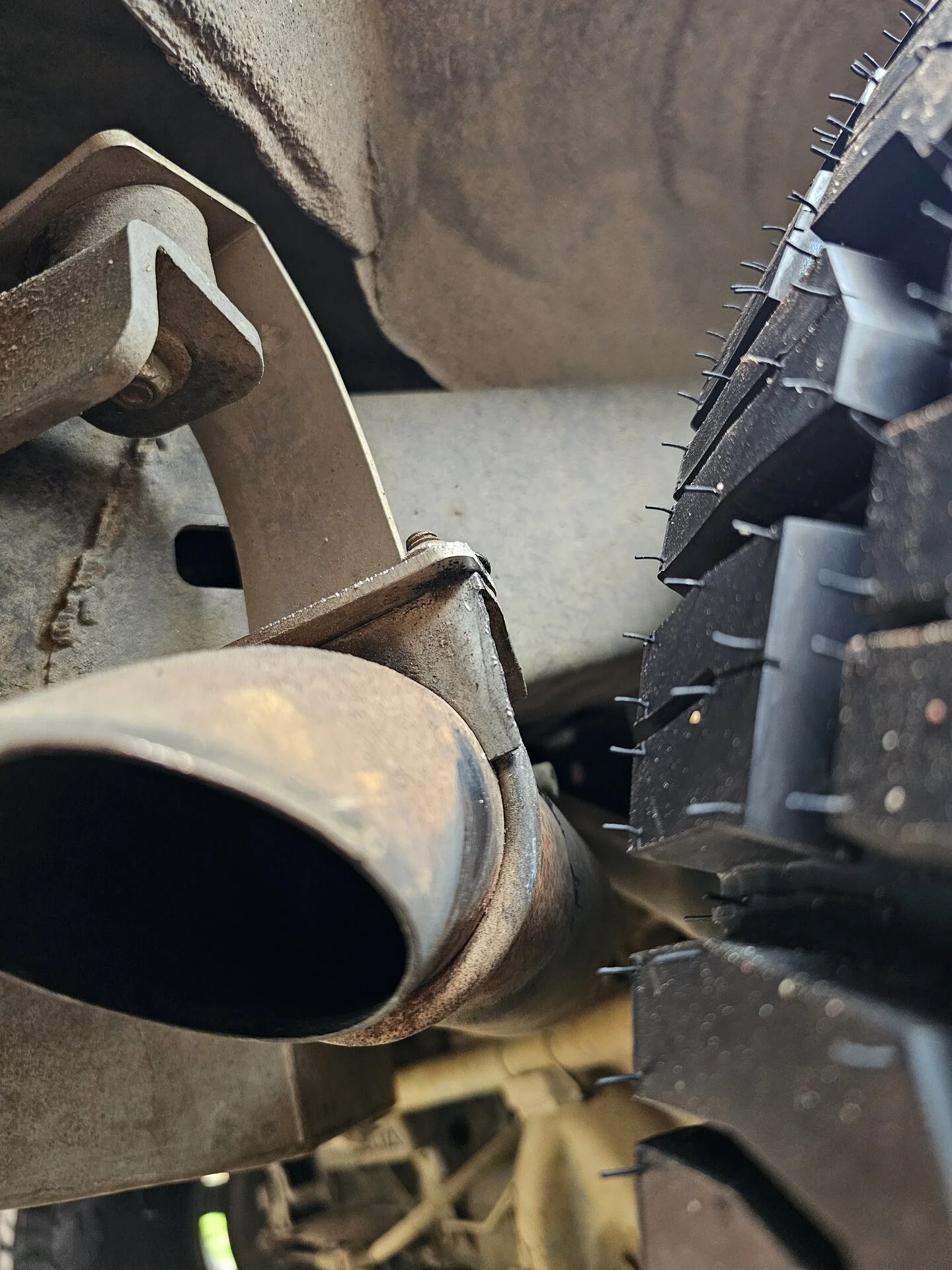

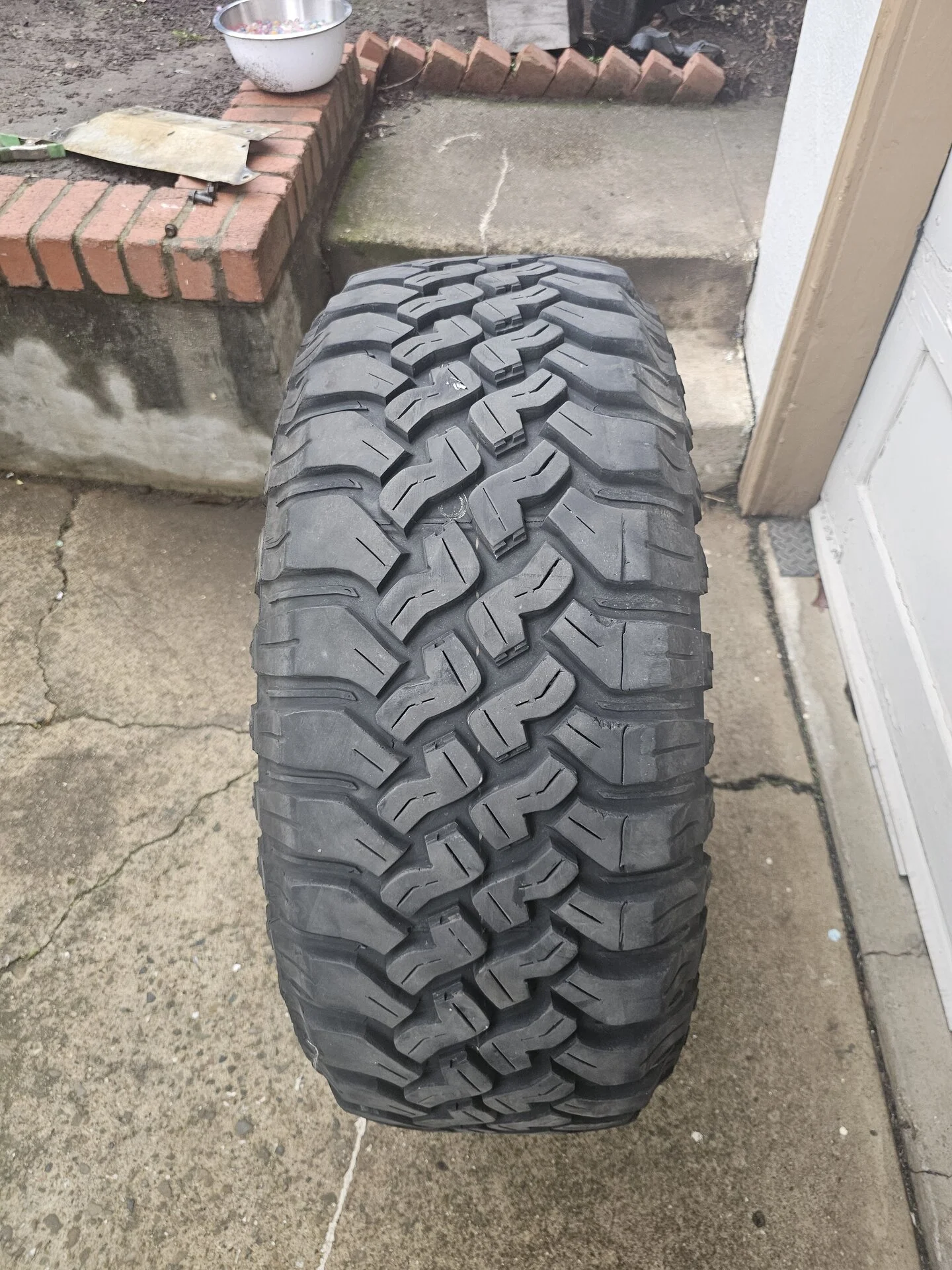

These were rubbing with the 35s, the falken MT tires bulge out on the sidewalls pretty far.
That groove is from when I had the methods with -38 offset and they hit the fenders.
I hit some points with spray paint so they can be used at witness marks when the tires rub.
