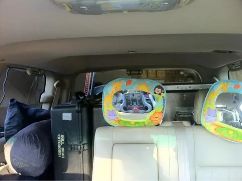

I was planning on putting my fridge on the passenger side because the view is already obscured by the tire on the bumper. I am thinking the slide (not what you did) on the driver side would allow easier access because you can stand to the side and reach in where the other side has the open tire carrier in the way. Curious about the view out your rear window with the fridge and tire carrier
I still plan on using the 3rd row occasionally (1-2x per year, Vegas baby!). I estimate that I can remove the drawers in about an hour or so. The seat belts looked like a PITA to remove and it's just one more thing to reinstall.
As for the view, I don't really notice. Slee's tire carrier already blocks most if what you need to see. The fridge sits behind the driver and behind the 60% section which was also intentional. l always have the twins with me so putting the fridge on the DS makes sense because I can fold or remove the 40% section and have the full length to work with. Also, I'm planing on adding the ladder as soon as Christo gets around to selling the Rotopax swingout.
Pic show view from rearview mirror level. Note the fridge is at the same level as the headrests.
