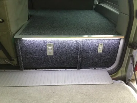

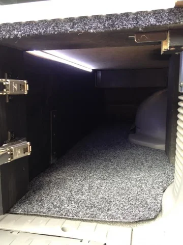

I am thinking of getting these. One thing I just though about that would be a great mod, is some sort of interior LED light that comes on when the drawer is opened.
LEDs are great

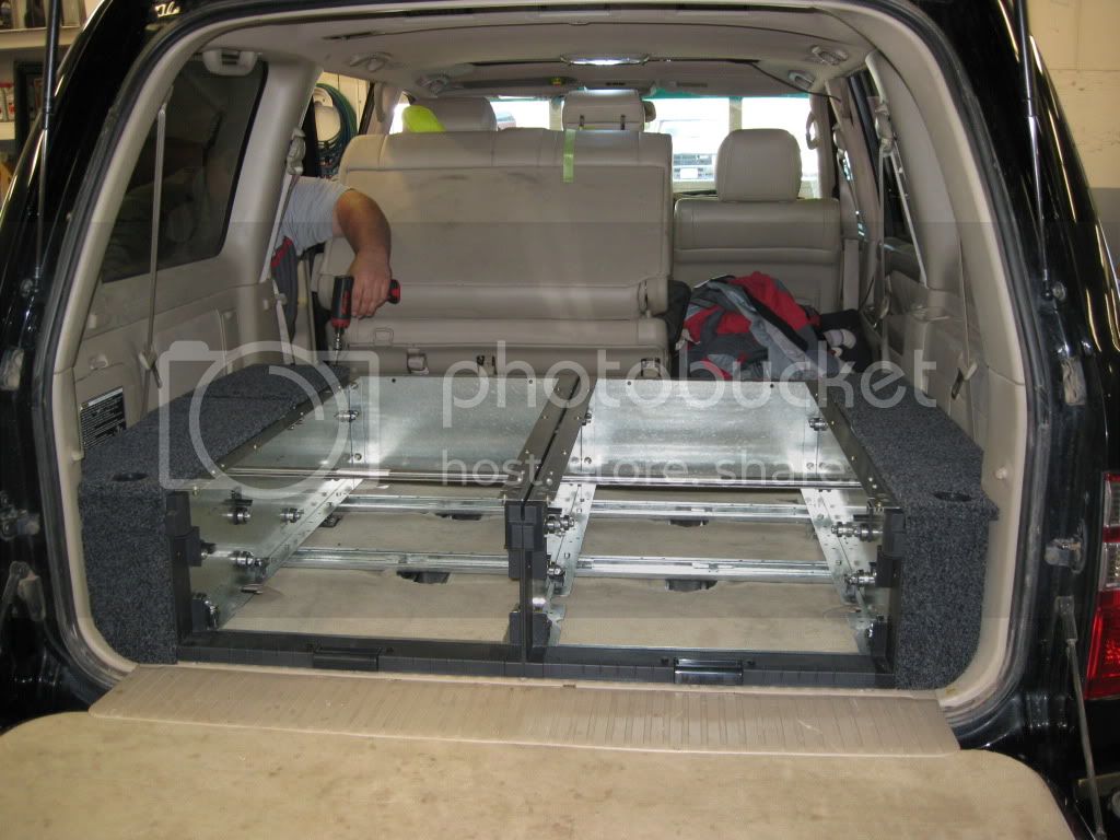

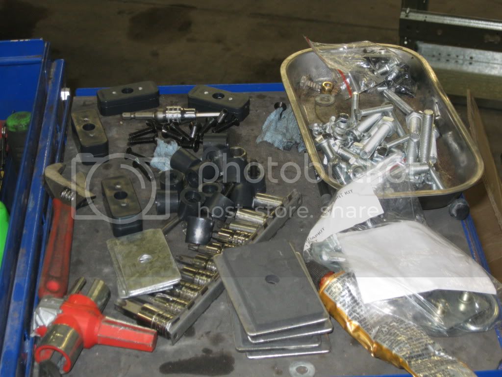

All of the hardware
The installed frame system and side fitments.

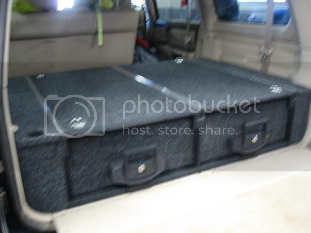

Finished drawers. I also ordered one set of D ring hold downs. These are capable of securing very large loads. I am planning on adding one more set to have 4 above each drawer.

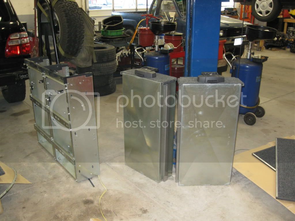

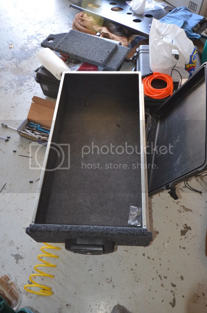

One drawer. Drawers are removed by removing 2 small screws.
The drawers are mounted on heavy duty ball bearing rollers. Even with a full load they roll very smoothly. They lock open so they wont close on you if parked on a grade.

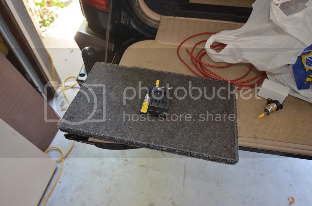

I took advantage of the realestate under the right fitment panel to mount a fuse box (soon to be replaced with a Blue-Sea) I wired 4 gauge from the battery through a 100a fuse and to the box, currently I only have the National Luna plugged into it but I will be adding some 12v plugs and an inverter with remote house plugs mounted in the fitment panels.

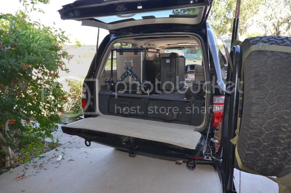

Finished Product with Tembo Tusk Loadspotter. The Loadspotter is securely attached with 8 bolts to the plywood top. Fitment was perfect and nothing got in the way of the drawers.
Makes for a nice clean solution when loaded. The left drawer currently contains my tools/spare parts and the right drawer has camp chairs, propane and the girl's pack-n-play. Note the small gap on the right side of the fitment parts. I assume this is for airflow to the rear-AC unit. The large locable handles are easy to grap in the dark and provide a good grip when opening a loaded drawer.

It sounds like you may have a broken lockout. It is IMO a inferior piece of hardware consisting of just a small plastic tab. I broke one which cause the drawer to not lock open properly. Luckily ARB was very accommodating and sent me a set quickly. The Part # is RDSTP and they come in a pair. I'm guessing you have one or two broken tabs. The red circle is the weak point. If those are intact than you have some kind of alignment issue.
This part consequentially must be removed to get the drawers out. Empty the drawer and you will find two Phillips head screws on the inside of the drawer, near the back on each side at the level of the rollers. When you remove these the drawers will come out and you can access the mounting bolts. Removing the top plate can make this easier but I just leave it installed. The two bolts that attach each drawer to the vehicle are centered under each drawer.
Remove two screws on each side in area of red circles.

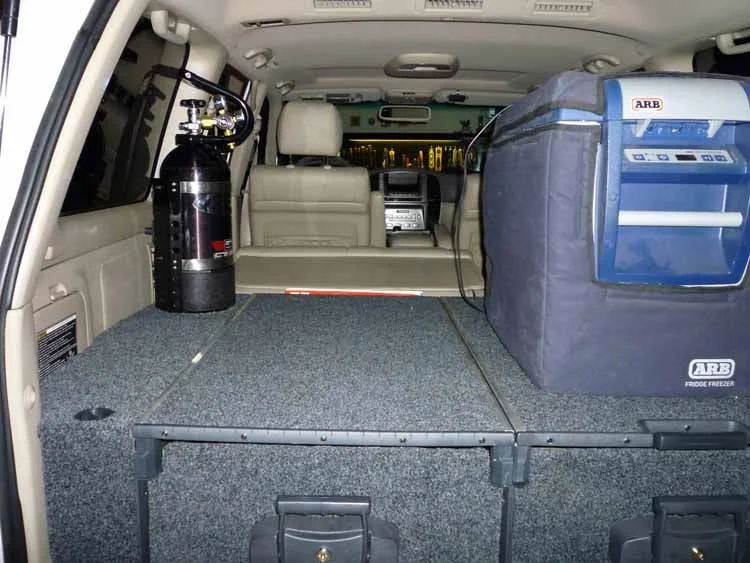

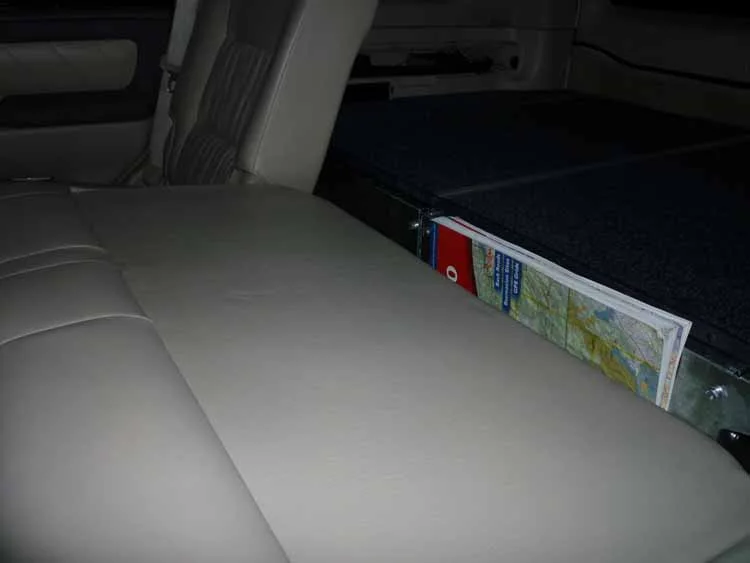

Here are pics from my setup

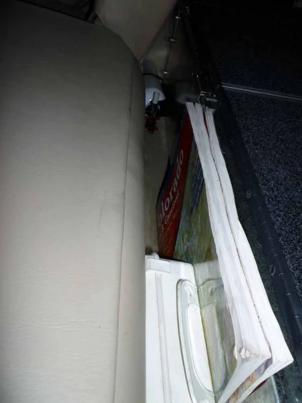

Romer- Great pictures of the drawers in relation to the seats. I am looking to purchase the ARB drawer set but often use the back of my rig for sleeping. Based on your pictures, there does appear to be a gap of 2-4 inches between the drawers and the seats pushed forward (not tumbled)- Is that accurate? Also is there a drop from the top of the drawers to the top of the seats? If so how much? That may be a bumpy night sleep even with a 3" memory foam mattress! Any additional insight would be appreciated as this could be a game changer for me!
I left I in. Both to eliminate potential rattles and because it SIGNIFICANTLY reduces road noise.
