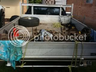

Came home from work on sunday to find this, delivered thursday
So now follow along as I spend more time amd money, in the quest for offroad fun

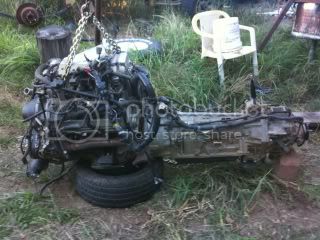

So yesterday morning tore into the crate, and this is what i have now
Good golly, lots of wiring
and the piece de resistance
the 2uz, and a750f

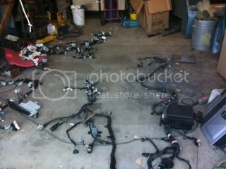

Last night had me laying out the wiring trying to piece it back together, sorting out what i need, and getting my head around all those plugs. So I decided to see what options I had with the a750, emails to Rodney ......... who tells me to chuck it and use an a442. BUMMER. I really like the idea of the really low first and 5 gears
So back to the drawing board, and Google, and Ih8Mud. The biggest problem I have is the immobiliser and coded key. I am now contemplating changing to a tundra computer without the immobiliser (no one is going to steal my junk)

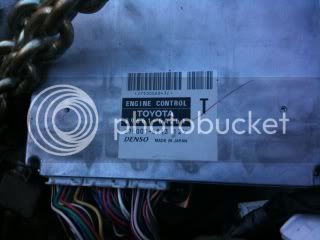

This is the computer
anyone got any ideas of a replacement?, pretty sure from superrunners thread, he used a 05 tundra ecu, a 05 engine and a750. Great. Looking at mine, it has different exhaust manifolds and no apparent sensors on the cams so I am not sure it is a VVTi motor
these are the exhaust manifolds, no air ports and no big flanges.

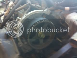

Can anyone identify from the picture or the ecu part number whether this is an 05 VVTi motor?
Paul
You're right that the VVT-i should have the cam sensors (also the control valves) on the valve cover.
Does there happen to be a VIN plate somewhere on the engine or transmission? You could at least determine the year using the 10th digit, and for US models, I can look up some of the info connected with the VIN.

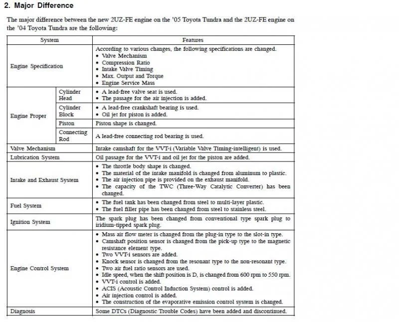

Rito, so is 05 Tundra VVTi? if it is not, I should be able to use an 05 Tundra ECM to get around the immobiliser issue.
I want an ecm that will fit my 05 2uzfe and a750f without the immobiliser
Paul
2005 is when they introduced VVT-i for the Tundra.
Thanks Don, I have just pulled the timing cover, 05 landcruiser in Australia is definitely NOT VVTi.
However, might have some joy with the immobiliser wiring, so might be able to wire it up as it was.
Paul

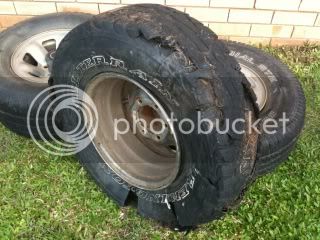

Anyway, I picked it up Sunday week ago (18th) drove it around for 2 days then decided to take it out to work 200 miles away. The PO has been driving it on the highway so I thought i would get away with it too.
Noo, 125 miles from home, this happened
Can't see too well, but that tyre is shredded, holes big enough to put a small child through.
And when I went to change it , broke four of the wheel studs on that wheel, double bugger

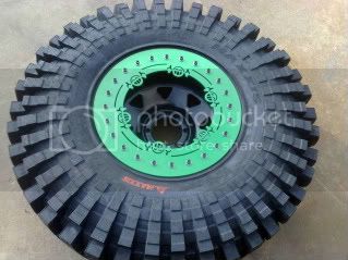

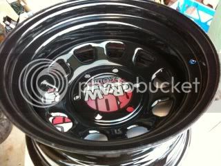

Had a few honey-do things to take care of but managed to go pick up these
15x8 with 3.75 inch backspacing
opening up the boxs reveals
some nice shiny pro comp wheels
I bought 4 of these babies, the 5th is on order. I double checked that they will fit and they just barely clear the caliper on the front.
I am also waiting for some weld on beadlock rings to be laser cut courtesy of Roctoy Designfab.
the beadlock rings I ordered
Roctoys finished product
