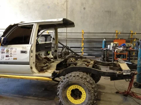

Managed to get into the cage on Sunday 23rd. It is all tacked in place with the foot plates all made, I will post up some pics when I get home from work, next week.

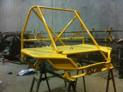

Come home from work last night. Managed to get some time on cage today.
Got floor plates all welded in
And roof bars all welded up

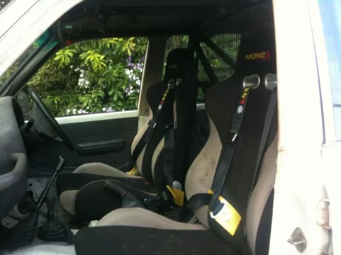

Racing seat installed on driver side (in Australia).
Should have the dash back in tomorrow, more pictures then
Paul

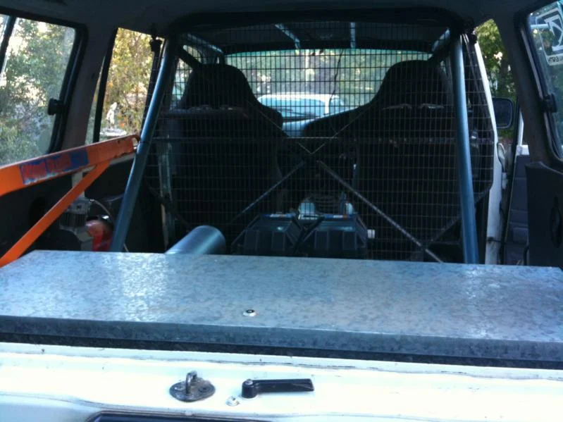

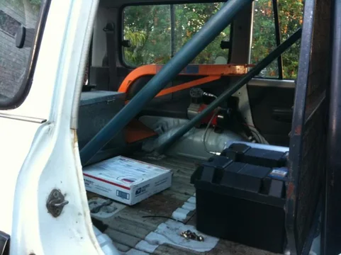

I managed to get some more done on the cage on the weekend. Made the sandwich plates for the footplates and bolted them down, installed bars for harnesses and installed rear stays to make the cage a 6 point.
Front footplate. Footplates must be 100x100mm and have 50x100mm in second plane.
the footplates and sandwich plates must have radiused corners and edges removed.
Rear footplate, same rules as front. These were made bigger to go over the cavity in the floor
Cage with rear stays and harness bars
Closeup of rear stay and footplate prior to welding.
Bellmouth for rear stay. Took about 2 hours each side, there is 4 different angles at work.
Should be more to come this weekend, hopefully knock over the cage and get into the winch bar
Paul

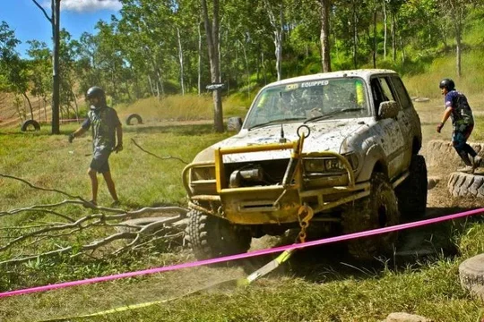

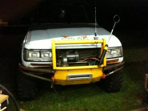

toojayzee said:
Whats the story on the thing that looks like a shock with a hoop on the end, bolted thru the massive bumper ?
It's a shock that allows the rope on the winch to remain taut enough not to unravel but still allows the pneumatic freespool to unlock the drum and play out the cable

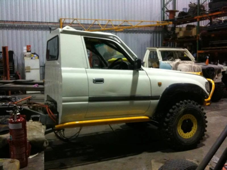

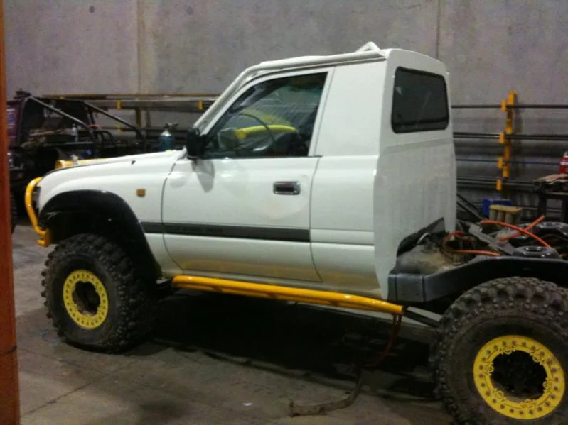

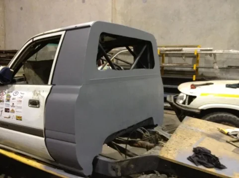

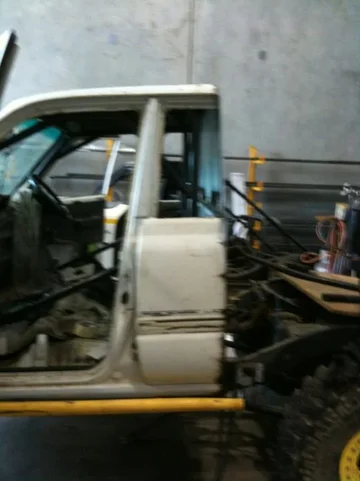

From there, we decided to get more serious, a shortbus style slice was planned and some more barwork added.

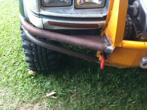

I fabbed up a set of rock sliders
And finished off the front bumper

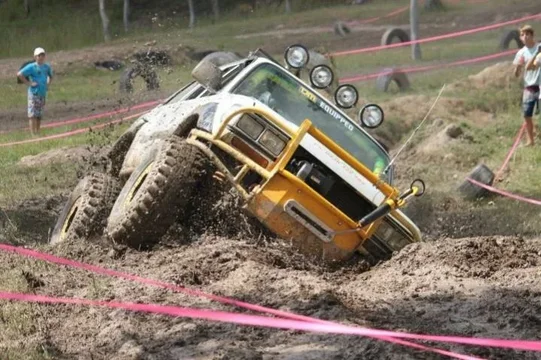

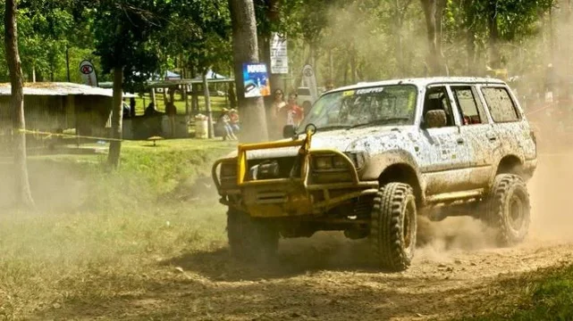

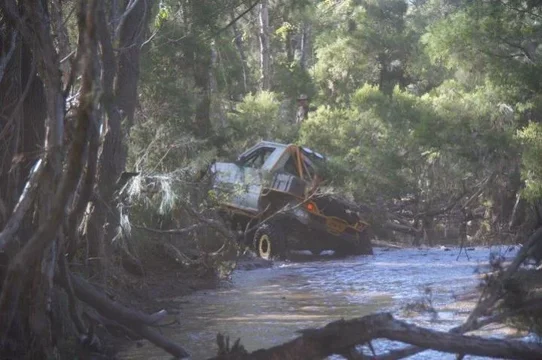

Before trailering it 400 km up to Mackay for their offroad challenge

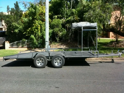

Trailer with rooftop tent, thanks Phil.
Mackay Challenge was very muddy with 12 inchs of rain prior
Thanks to Scotty in the red 100 series for teaming up in the 2 car portion of the challenge
