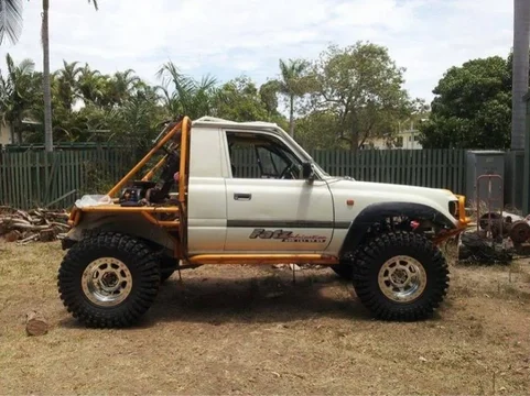

Got the back door stuck on a tree, and modified it and the quarter somewhat. I also like truggies, this seemed like a nice compromise between them and the rules that we have to follow over here
Very cool Paul! The 80 is looking sick, its come a long way since I saw it last, love the ute chop!

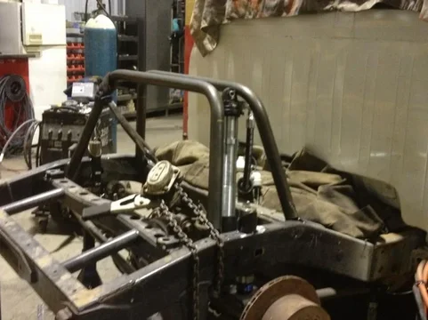

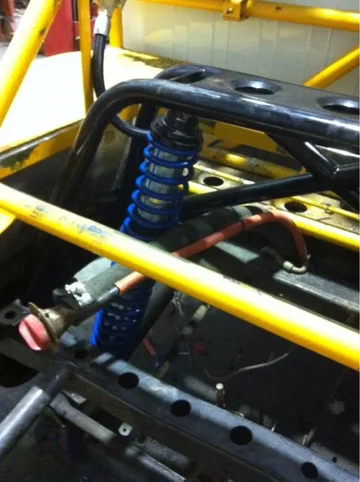

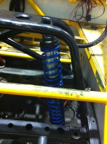

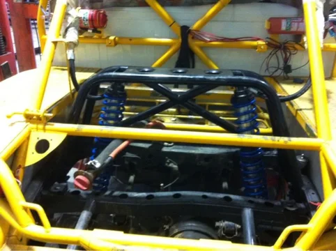

Latest round of mods, pneumatic bumps and coilovers in the rear
So seeing as the rear turned out so nice with the coilovers and pneumatic bumps, we decided the front of the car should get the same treatment.

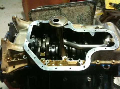

short motor assembled,
measured, tested, clearenced, honed, miked, torqued and checked till I am sick of it, 12 hours work so far, but I am confident it is all correct and will not come apart

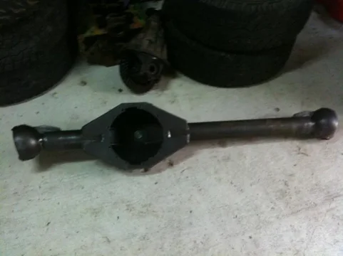

New housing has arrived

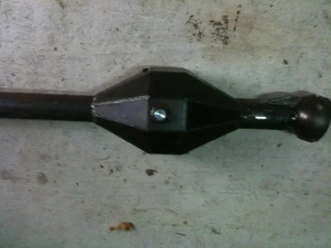

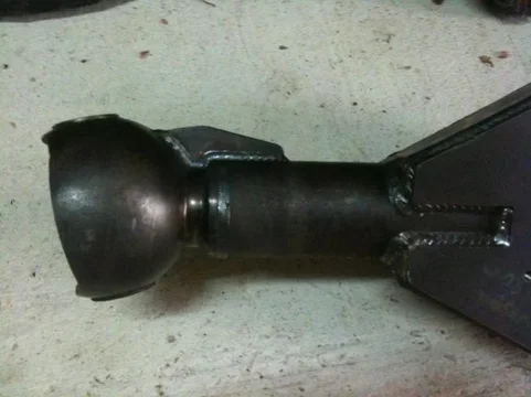

Buds customs hybrid, pootrol centre with 80 series knuckles
Knuckle bracing

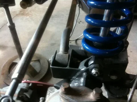

So this beauty is going under the front with coilovers and pneumatic bumpstops.
Also have a custom set of radius arms to go with this housing, so I need to get them all sorted, build some castor plates, install a panhard mount and coilover brackets to get this puppy under

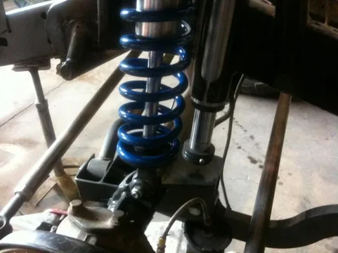

Another update with some more pics, front housing is all in, with coilovers and pneumatic bumpstops.
Housing mock up
Finished with coilovers and bumpstops
