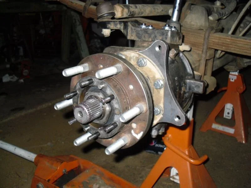

go to install the kit, which is a front end service, since the knuckles swap sides.

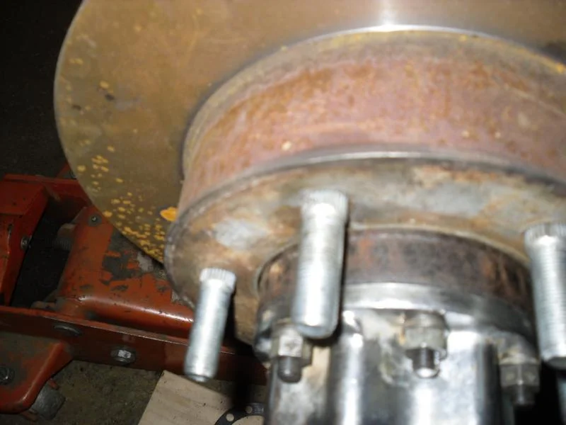

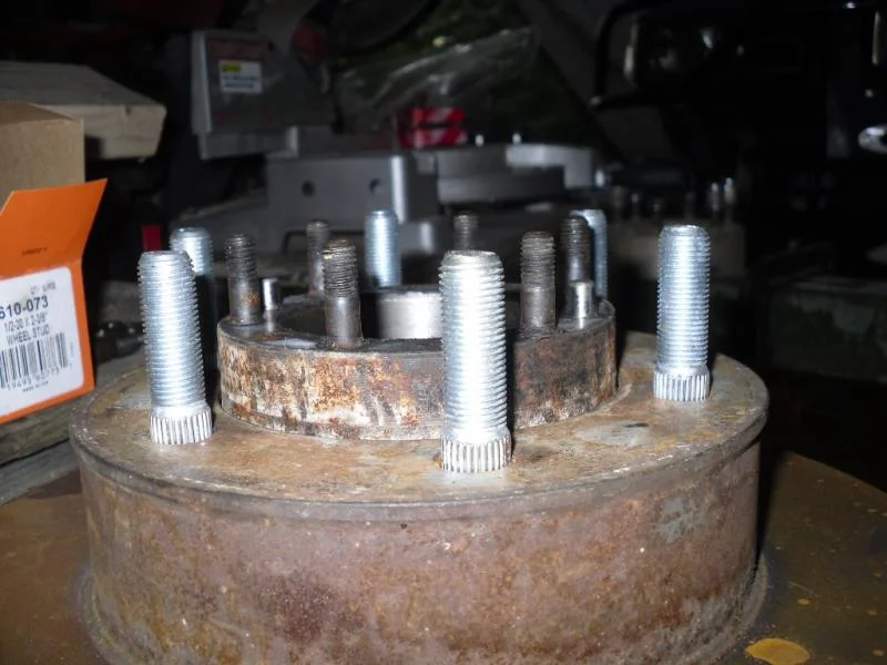

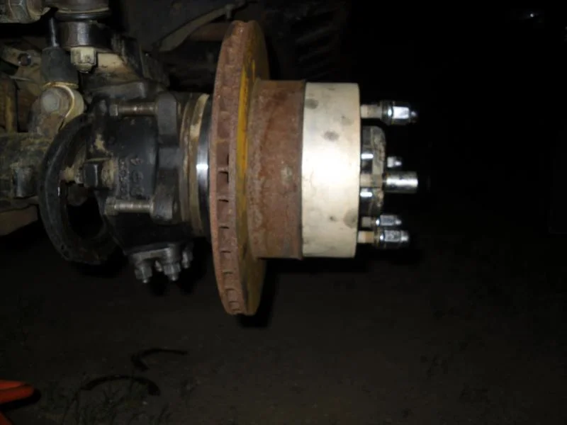

IFS wheel hubs, machine to fit under the rotor hat.
new studs in the knuckle and hubs, along with new longer wheel studs to accommodate the rotors and my wheel spacers.

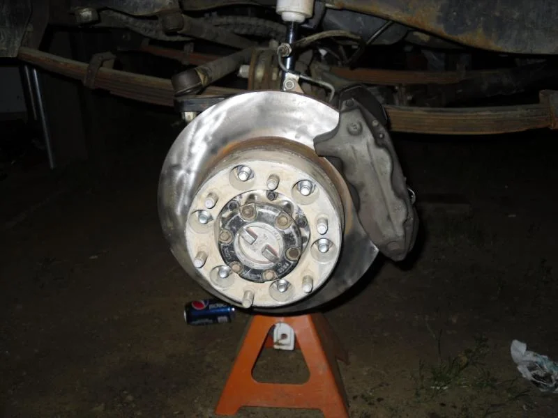

so i go to install the first knuckle and end up pulling thread on two of the new ARP knuckle studs at under the specified 100+ ft-lbs. so that set me back two full weeks. FROR did get me new studs and nuts at no charge. so i get it all together as pics show.

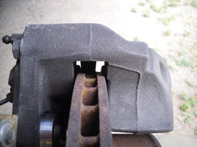

come to find out what i didnt notice, probably since i was working under the light of dark, was that the taco rotor didnt match the 4runner caliper. the pad outer edge didnt have any rotor to grab. pretty sure the size diff is 11.8 compared to 12.5.
some pics

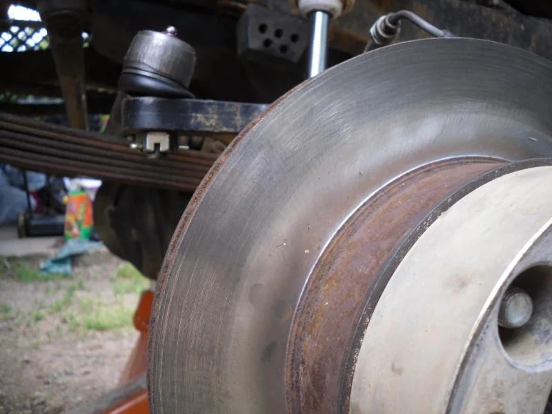

so i had driven the brake kit a little bit, but having pretty limited time make road tests hard. after messing with the truck yesterday i was crawling around and noticed kind of unusual wear pattern on the rotors.
