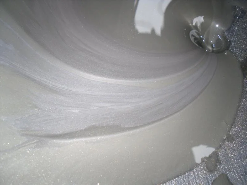

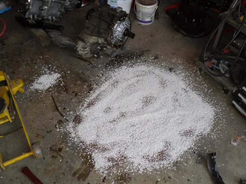

this trans fluid had 500 miles on it, maybe.
the jewel i had to get.

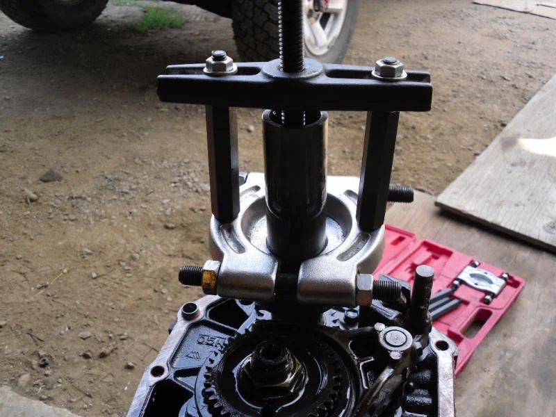

how i got it off.

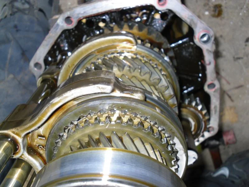

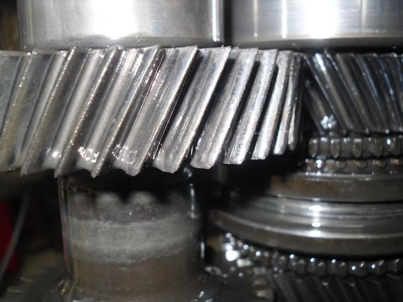

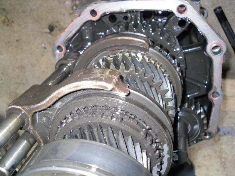

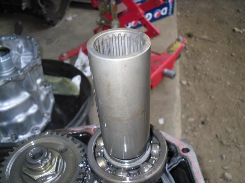

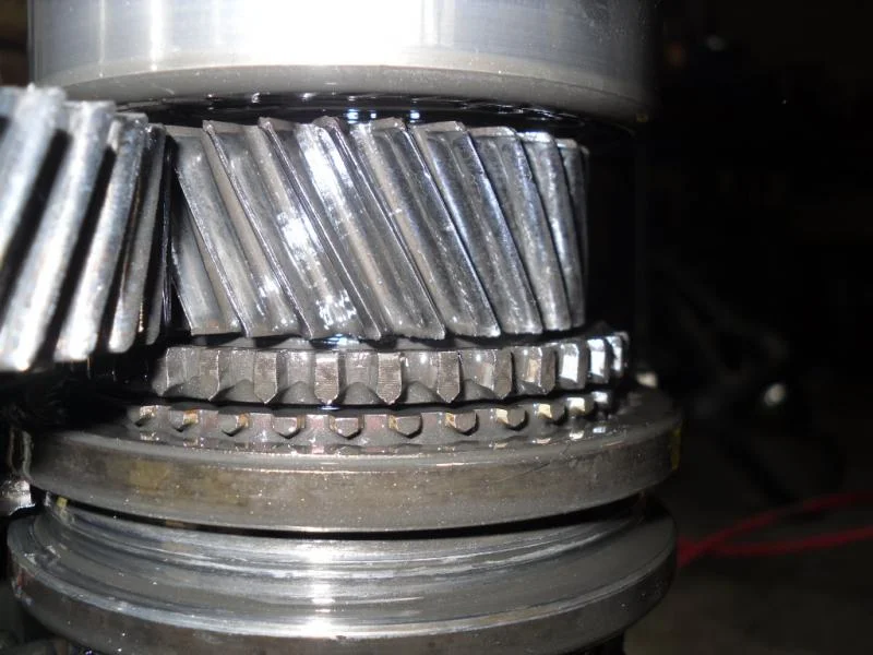

so this first group of pics is what i found in the bad trans.

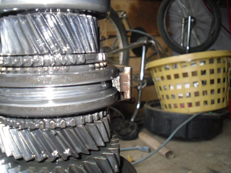

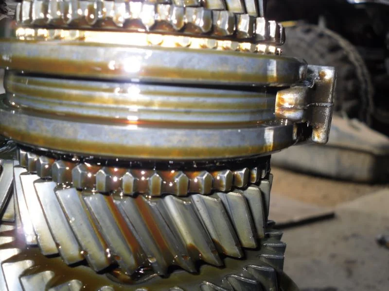

the third-fourth shift fork was broken and ground terribly.
the input gear and counter gear are wasted from a lack of lubrication, you can see the wear patter on the gears. in the last pic, you can see the residue from where the shift fork filings had been falling off onto the counter gear shaft.

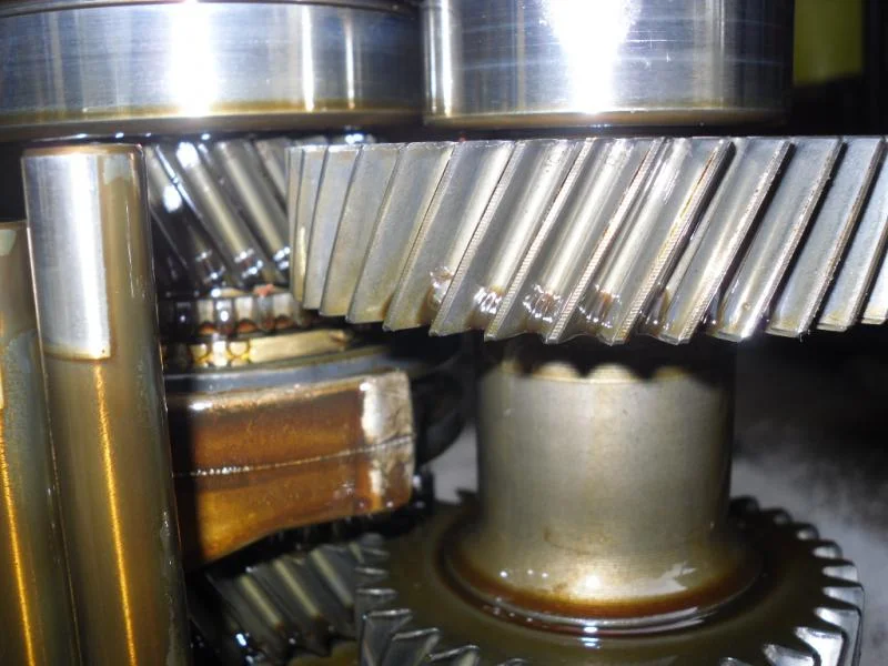

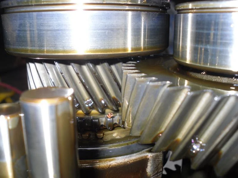

i was able to bust this job out in the last two afternoons. just got back from a test drive. it really is nice to have a QUIET trans with ALL working gears.
honestly after opening the bad trans, and then opening the good one. i almost nutted. and its all in the pudding, it was like driving a totally different truck. even more badass than before.

i am not 100% who i should blame this mess on. . .
either me or jerod forgot to drain the trans before trying to pull the case :o
also a couple more showing the fork damage

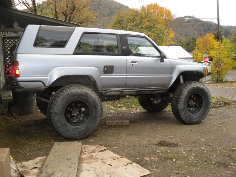

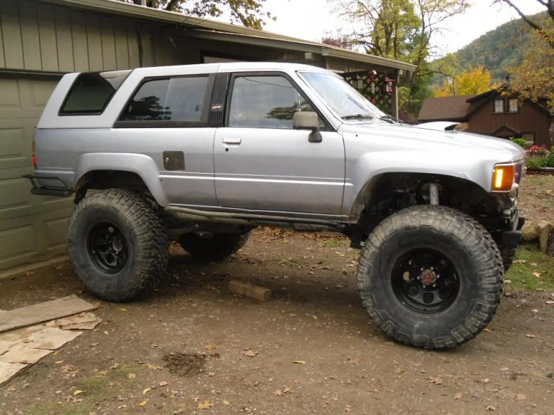

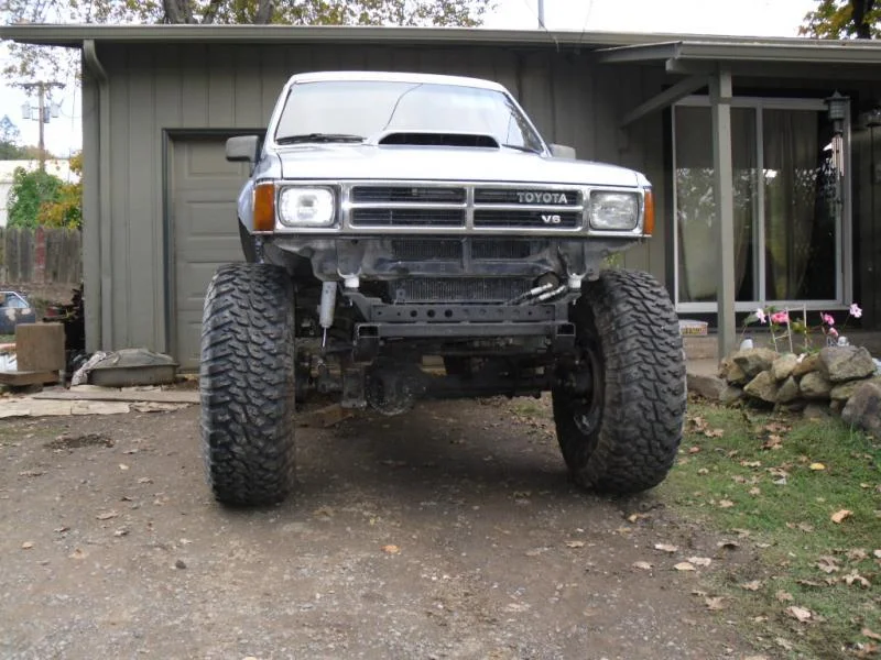

the other day at pre run garett was asking about my "mcgrew mods"
not a whole lot has changed with the runner in the last year.
basically after the flop, i had to replace the top and a marker lamp and also beat out the DS fender.
even prior to that day i was wanting to get the truck a bit lower.

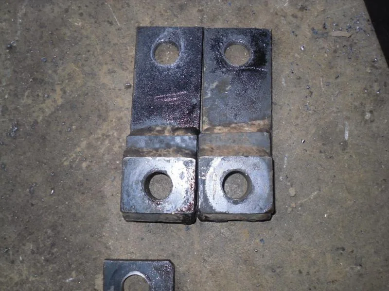

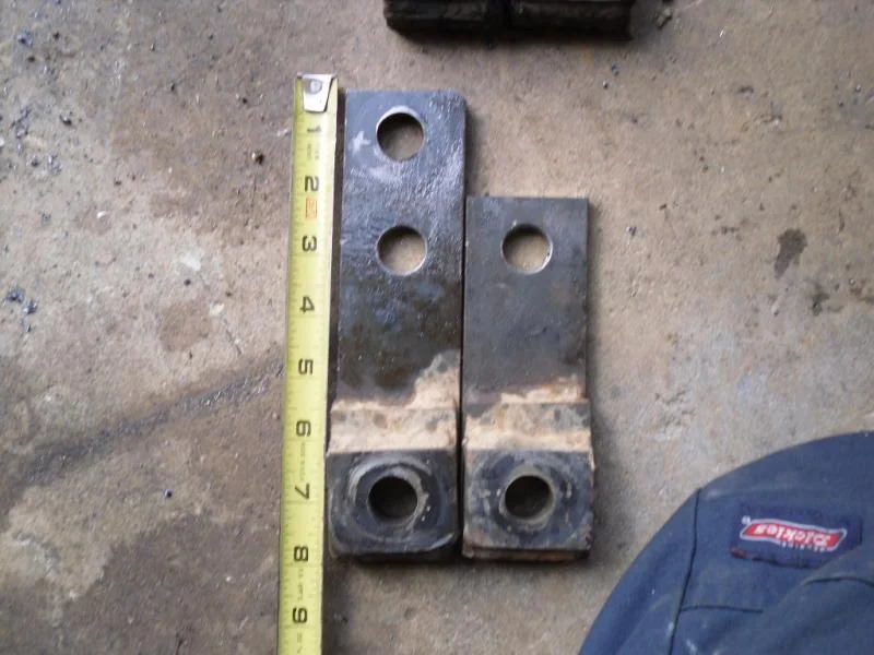

i ended up cutting the front shackle down from a 6.0 to a 4.0

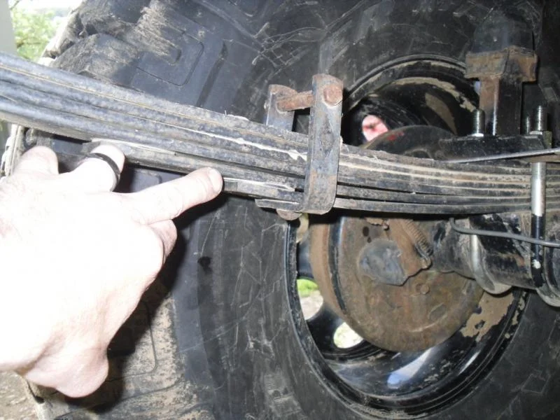

i also ended up pulling another leaf out of the rear pack.
