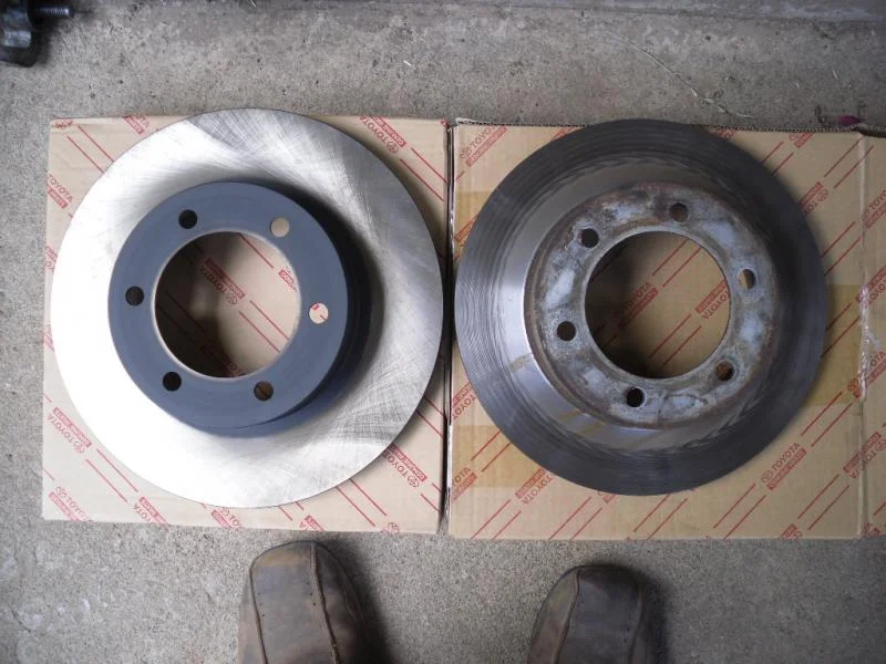

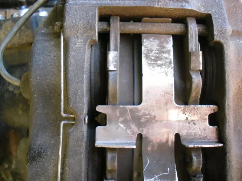

pics of the rotors side by side
pic of the parts all installed behind the 17s

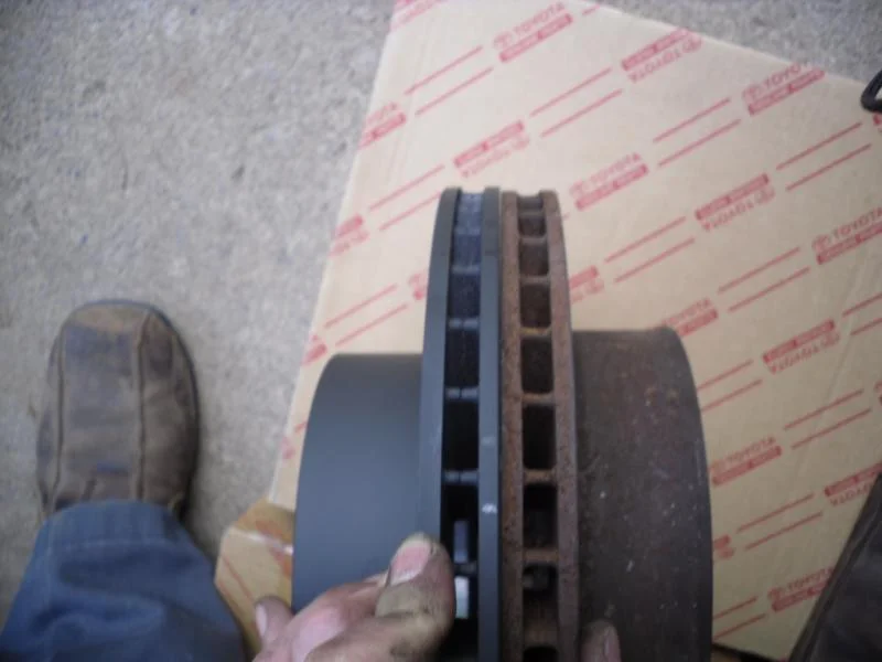

part number for the 12.5" rotor for the 16" wheel 4runner is 43512-35210
brakes are better, pedal is a little softer. i need to go to a new master. the one in there is an aftermarket. it is a definite improvement. with the other brakes, the pedal was kind of hard and didnt want to stop the big rubber too fast.
the new brakes will skid all four on pavement. new master will be much better.
much larger caliper, and rotor. i thought i took caliper comparo pics, but i guess not.
the seller is that it uses IFS wheel hub for gained width.
uses all bolt on stuff, nothing "hacked" IMO
the rotor becomes a "slip on". as apposed to having to tear the wheel hub off to take the rotor off for service etc.
IDK, bling factor. :flipoff2:
i was just kind of with the school of thought. i have to tear the whole front down, do an upgrade.
if it werent for the fact that the old brakes went to my buddies 40. i would ALMOST regret the whole nightmare. i really, really, really, really hate when a 6 hour job turns into 6 weeks.

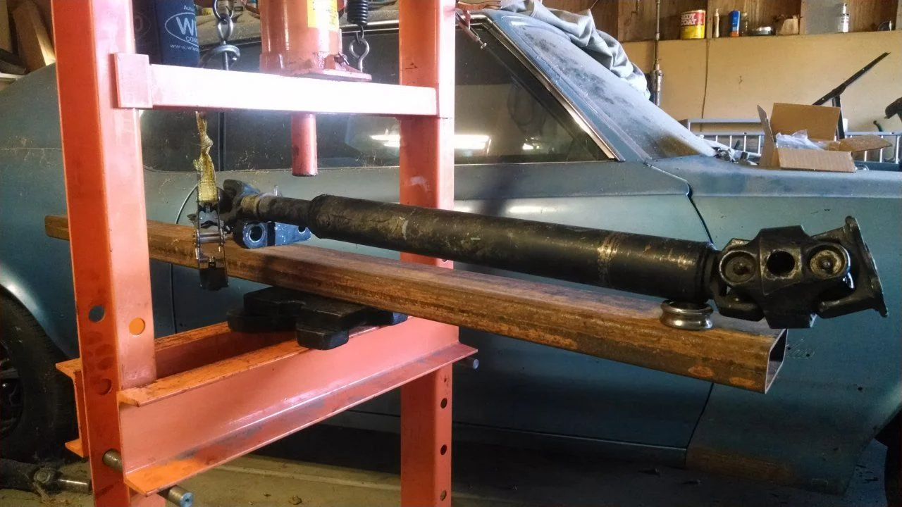

I did actually change the bent axle shaft from rubithon'13.
I was going to try and straighten the rear dl but rain and back problem kept me on the couch.
I plan on repainting the half top and possibly building a small roof rack.
I think i wheeled four times since CTW.
I sure as hell thought about the repairs every second i was in the seat getting filling shook out
So id had this vibration coming from the vicinity of my rear drive shaft.
My eyeball seen it. Dial indicator thingy said .250ish runout.
So i had an ideaer.
Took a couple trys, but got it back to .030 ish.
Took it tor a rip....soo much more better. :)
