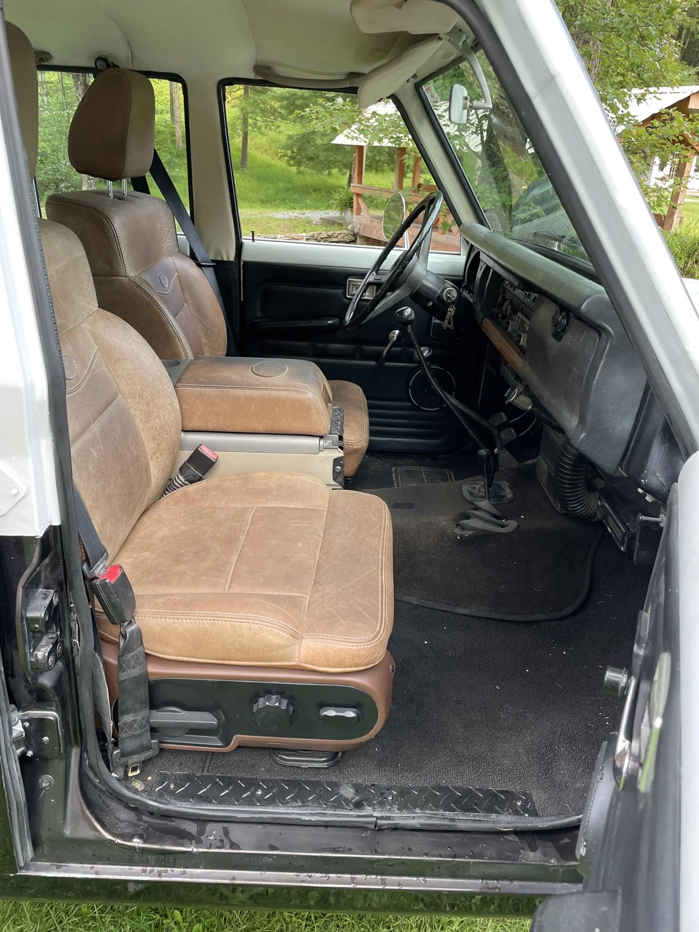

Someone was running a King Ranch seat up from too, so might answer your domestic size question?

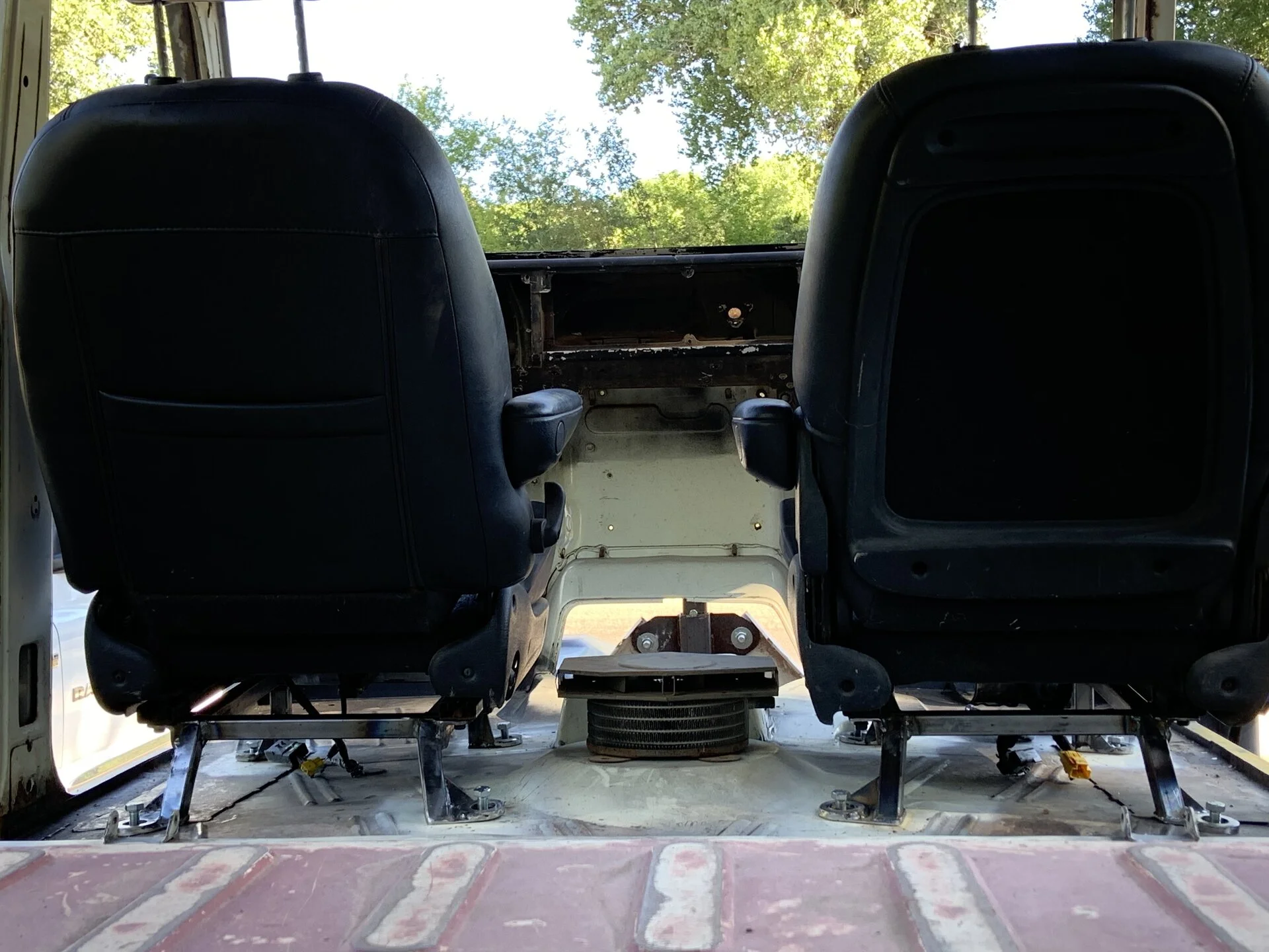

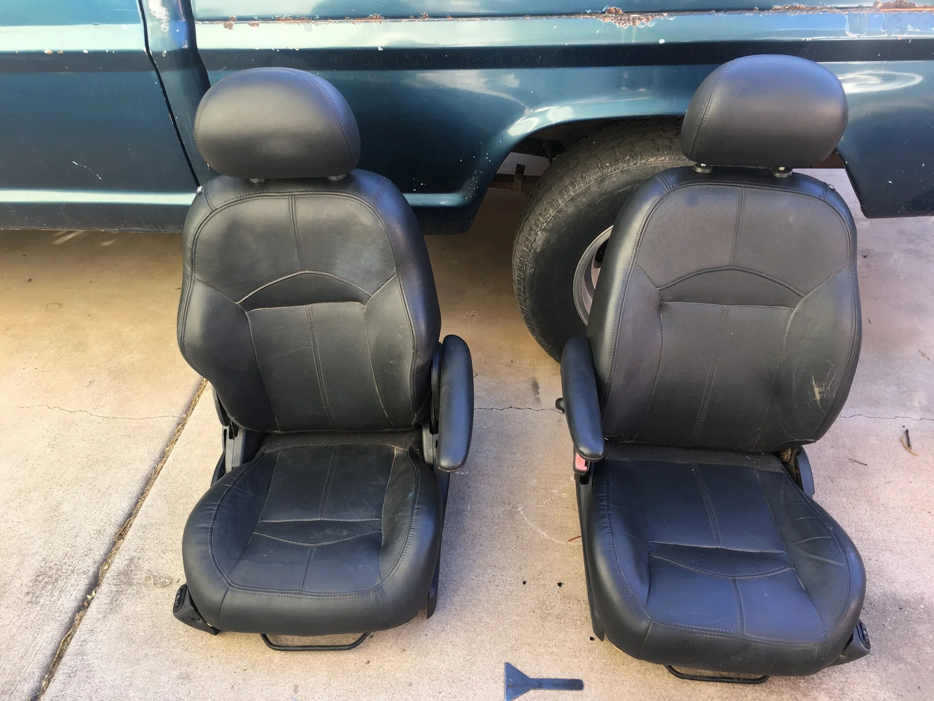

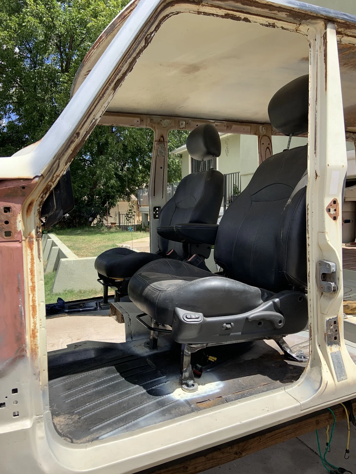

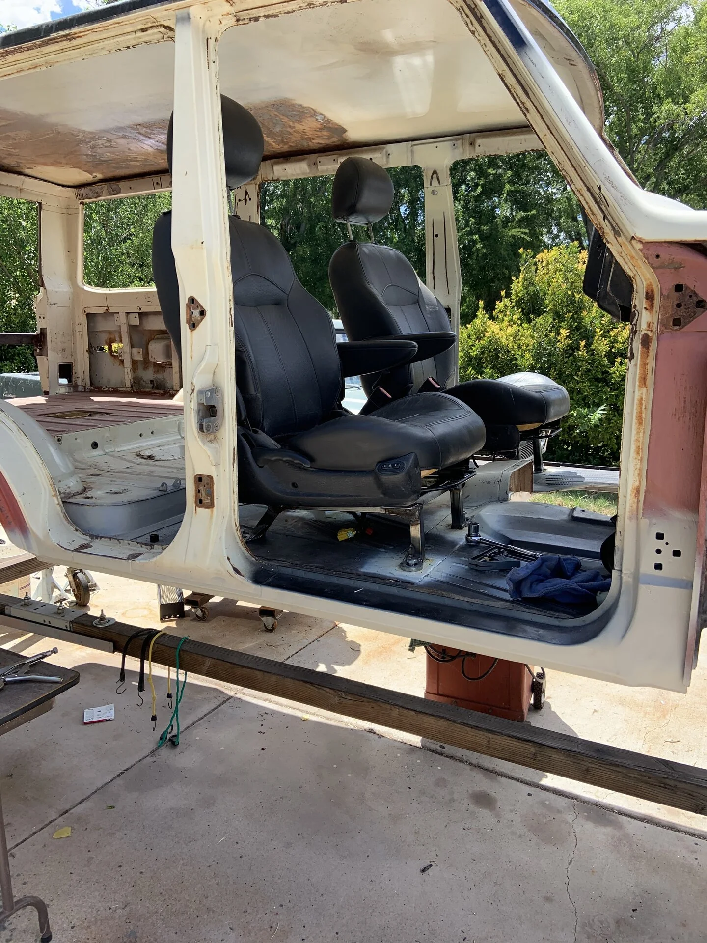

I’m going to use PT Cruiser seats (2003 - 2005 IIRC). Not a super popular selection, but they checked all my boxes.
Flat bottom mounting
All manual adjustment
Integrated seatbelt buckle
Could easily be mounted to cross bars attached to stock mounts. I went beyond, got rid of stock mounts and built independent mounts.
Inside arm rests won’t work with a center console, and were since removed.

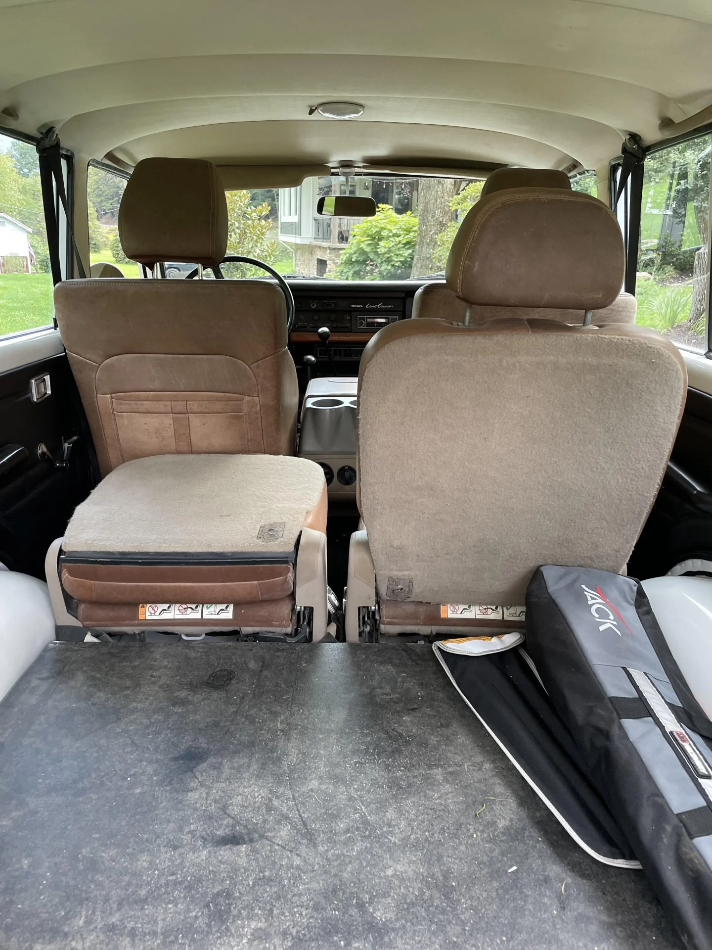

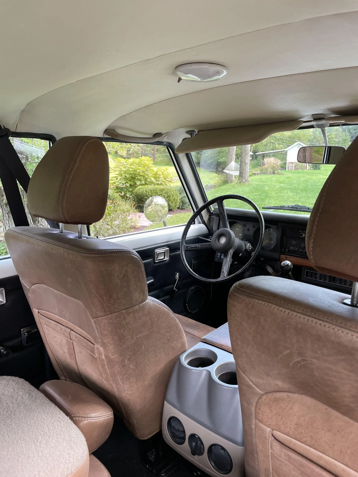

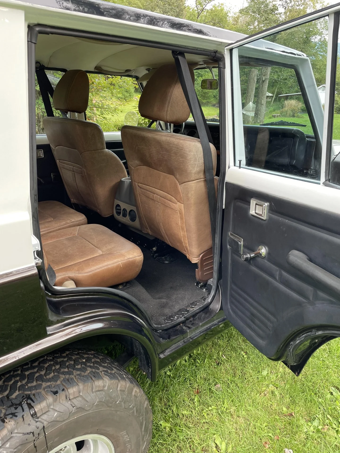

I’m using 2004 F150 seats up front. Integrated seat belts. Manual lumbar adjustment. Same dimensions as King Ranch. Super easy mount without removing the oem pedestal. Very comfortable and supportive. Have an Fj60 console mounted between them. Also available with electric adjustments.
Thanks rush55. I like the clean slate. I’m kind of leaning towards the bmw seats, now that I see yours mounted in the truck.

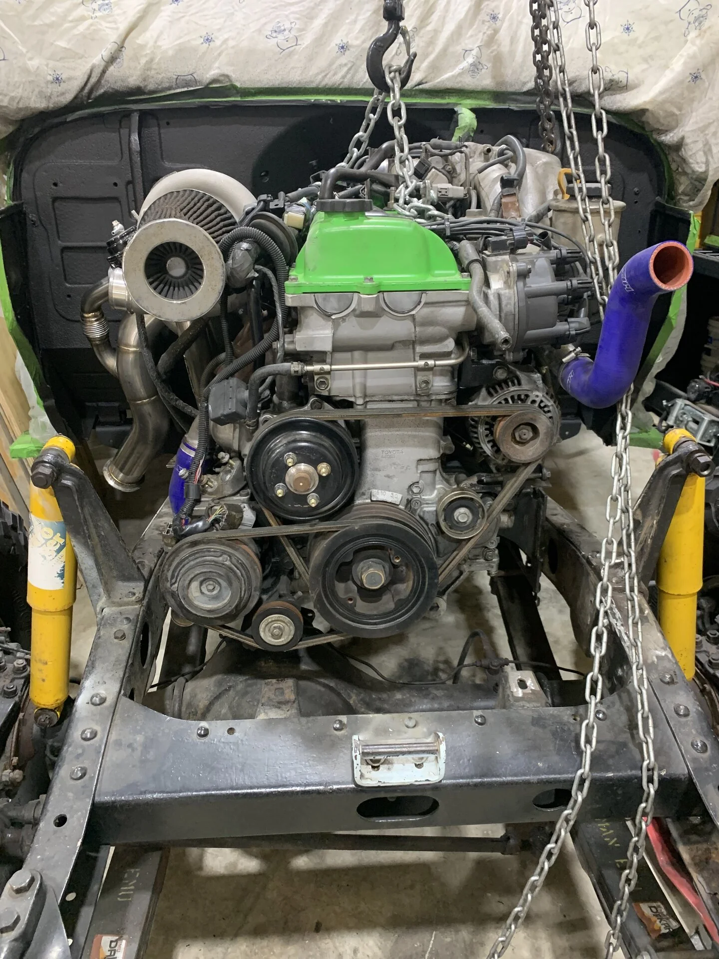

This is the turbo 1fz and h55f in the LV that I bought from @greenbeast (the green valve cover isn’t staying).

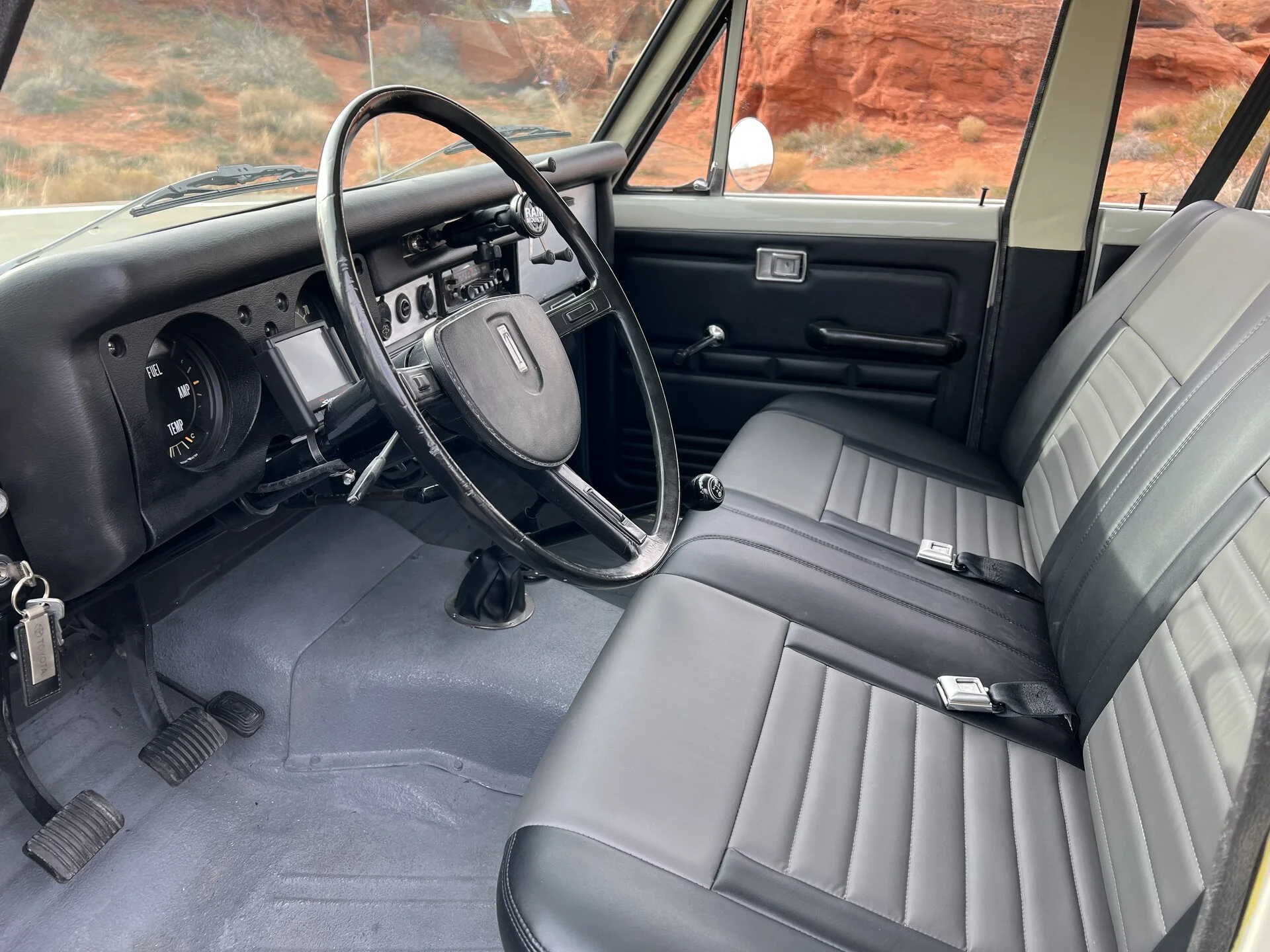

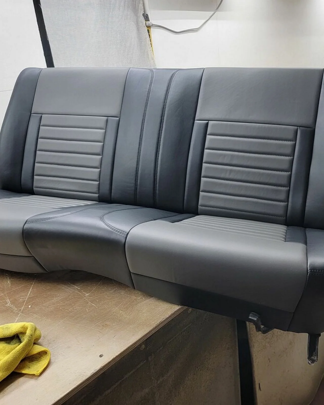

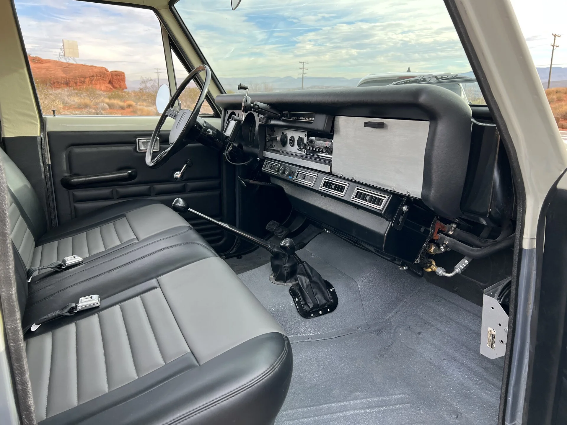

Thanks for the callout Bob! I think that most of us pig owners fall into two seat categories:
1) keep the stock bench seats
2) put in some new bucket style seats
I fall in the bench seat group. I just like the look of a vintage bench seat! With that in mind I pulled off the covers, removed the foam, fixed the cracked frame, fixed quite a few broken springs, and painted the seat frame and springs. Then I worked with an old school upholstery guy , described my vision of vintage look with more comfort, reviewed a few designs he came up with, selected a two tone black and gray style using aircraft vinyl that’s long wearing and heat resistant. Really happy with how they came out.
