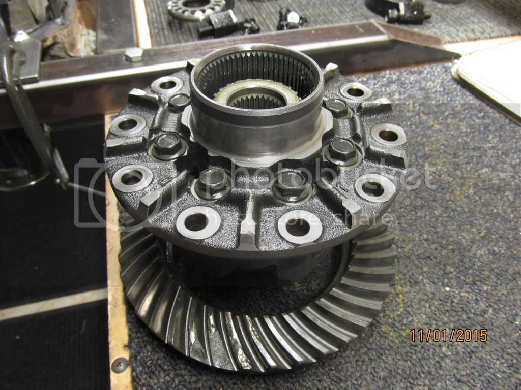

Send that back Akarilo. This issue with yours, as you know already, is not the fault of the actual gear install....or the Nitro brand. It has everything to do why the 8 long case bolts continue to loosen up. That will ruin the strongest install in no time. I suspect nobody on the thread has ever heard of such a freakish thing..... all the case bolts loosening up for no apparent reason. And, if they have, please speak up. Right now, our best guesses might be a case that no longer has a flat surface for effective clamping action.....or the 8 bolts were severely over-tightened in the past and they are now in the stretching mode and continue to elongate even at the recommended 35~40 ft/lb.
Akarilo- I can locate 8 good V6 case bolts. But I seem to remember that they might be a tad longer than the e-locker case bolts.....just measured a V6 case bolt and the best measurement I can get is 2.905" from the clamping surface to end of bolt with standard dial calipers.
Be cool if you could find a busted e-locker that still has a good case...and good bolts. But I'm not so sure they are easily found.

Here's the 2 related pictures where I noticed the bolts were loose and I just figured at the time that the previous installer must have forgot to tighten them.......
bolt1_zpsdhpeop6s.jpg~original
bolt2_zpslqb9i414.jpg~original
OK....I'm doing an elocker install as I type so I will measure the length of one of the good bolts now....I measure just at 2.501"
Riley----If you measure your bolts and, if they are stretched, I would expect you should see 10 or 20 thou over that number.
