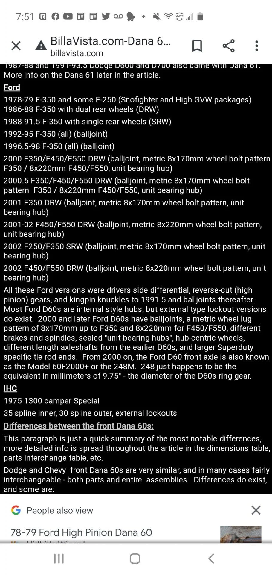

Just to add to this for anyone searching back through threads. Most ford front D60s are HP. There are a few that low pinion. This is a list. Include all new super 60s also, this list was made a while ago.
There is more info in the Dana 60 bible on pirate.
