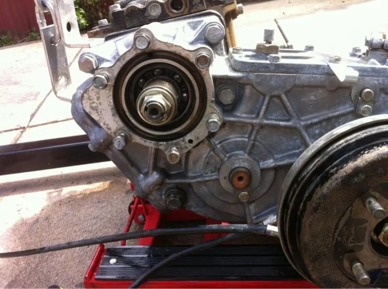

All clean! One problem, the aluminum on the transfer case look all oxidized. Does anyone know how to make it shiny again? Baking soda and water? I can't tell if it's from the oven cleaner and engine degreaser or if it is from hard water? Bummed about it. Hope I can figure out how to make it shine again.

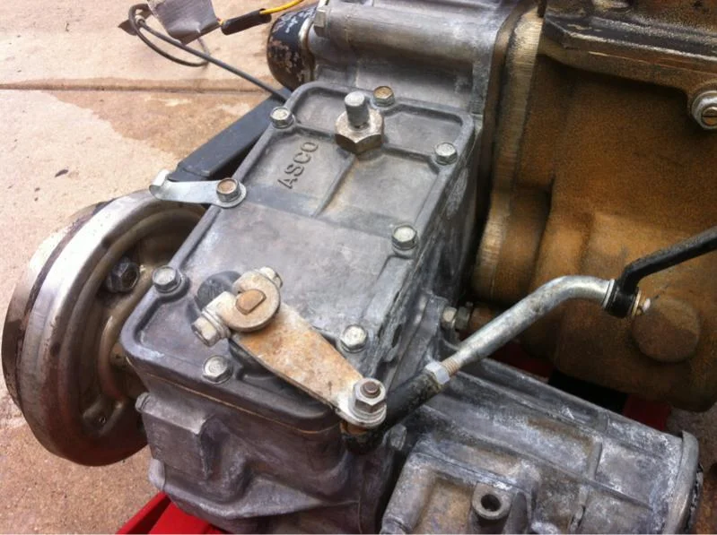

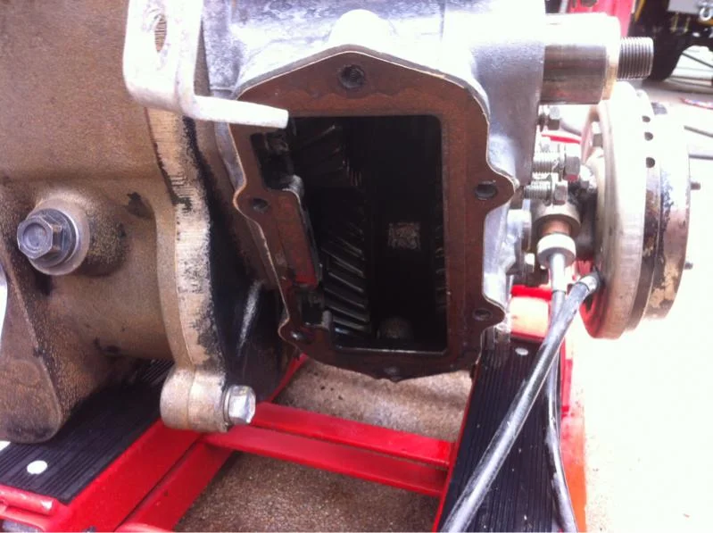

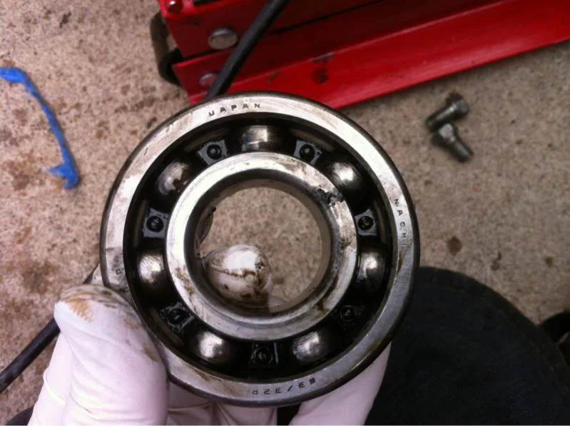

Side cover removed. It looked really clean up in there. The gears looked really good to me. I think there might have been some work done on this case before. The staked nut looked really new and the bearing looks brand new ! Non OEM gasket sealant. All signs that this cases has been serviced. Bonus !

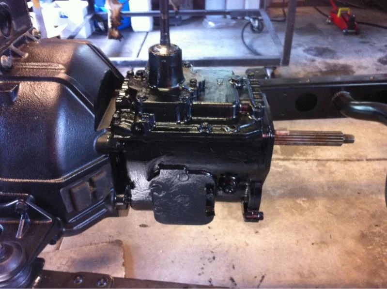

Tranny installed and then painted with a coat of chassis black. The light rust will be perfect for the curing of the chassis paint. Here is the big question. Will I be able to put the transfer case on while the tranny is installed? I measured and I have like 1/4 inch of room at best to get it on . I have my doubts though. If not then off it comes. No biggie I guess, but then I will need another person to help me do it. Hoping to get my transfer case saver ordered tomorrow. I ordered up a new nose boot and fork boot. Now off to work for a few days.

Broth, I would not use oven cleaner on aluminum. I'm not sure if you have done this before but it has a known chemical reaction emitting gases and oxidizes and even eats up the aluminum. I remember this from science class in 5th grade.
Take aluminum foil, spray it with oven cleaner and fold it up. It will literally get so hot it can catch on fire and gases begin pouring out, pits and eats up the aluminum. Notice that no part of an oven ever has aluminum in it.
Just figured I'd give you a heads up.
Cliff
Cliff
Thanks cliff for the heads up, but unfortunately I had already done it. Good news is there was no pitting , but it did oxidize the hell out if it. I have spent the last 2 days with a wire brush and aluminum polish getting it clean. Luckily I didn't leave the cleaner on for very long so the damage was minimal . Just a PITA to make it shiny again.
