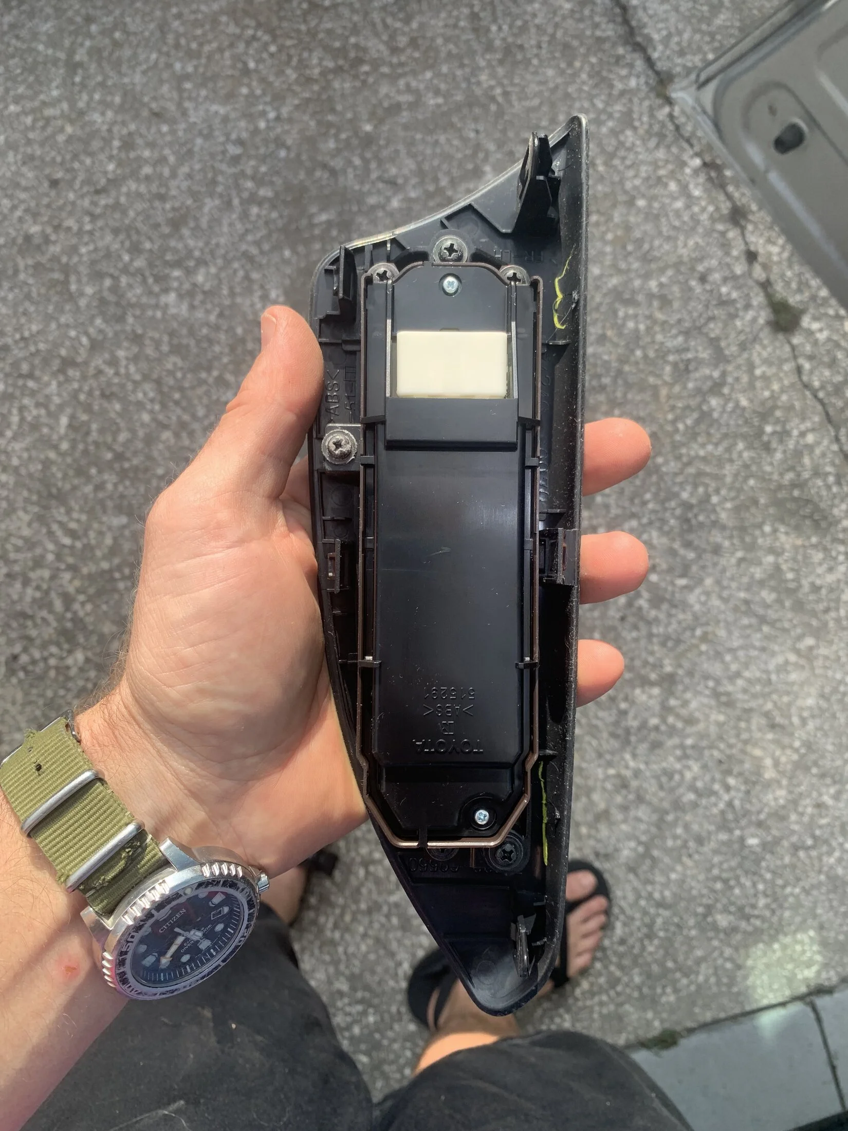

Photo that might be of relevance
The “switch” module pops out of the door really easy-like 4-5 clips…I used one of those little stereo removal blades (very thin) to get under and pop the plastic up.
The pins on the buttons connector look pristine and there doesn’t appear to be any evidence of moisture in the door panel.
The unlock feature continues to work when it’s hot/dry in the afternoon….but in the morning, only the drivers door will lock or unlock w the button, proximity sensors, or fob.
There appears to be a larger module that the cable leading from this button module leads to in the door. I’m starting to think maybe that module is the culprit, since it’s not just the “button on the doors” that causes issues…the fob, proximity unlock (for all handles), button on the door, button on the front passenger door all don’t work if it’s cool/wet/humid.

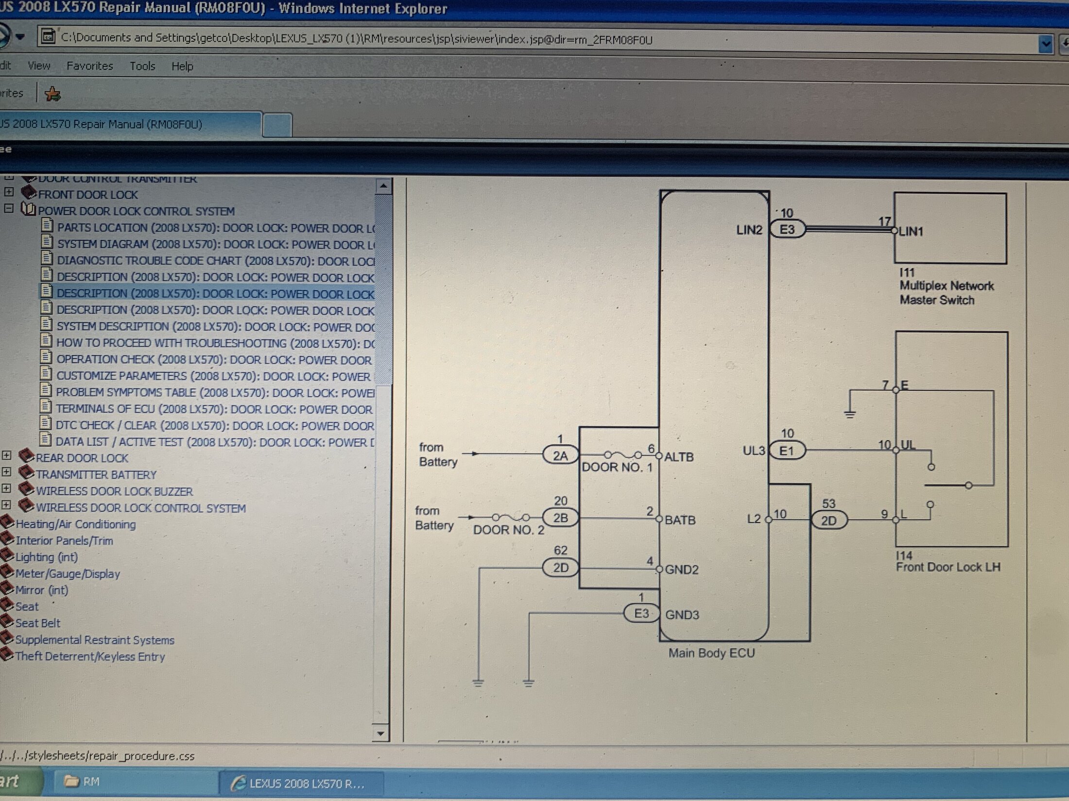

According to the manual, the main body ecu receives switch controls from the multiplex network master switch, and driver side door key cylinder switches from the front door lock LH. the main body ecu activates the door lock motor on each door according to these signals.
Manual seems to indicate that all switches lead to main body ecu (cowl side junction box lh)
Supposedly the terminals of the ecu that may be of utility (found in the power door lock control system portion of the manual):
2D-2 (ACT-) -body ground
(front passenger unlock drive)
2C-23 (ACT-) - body ground
(Rear door lh lock motor unlock drive output)
2D-2 (ACT-) - Body ground
(Rear door rh lock motor unlock drive output)

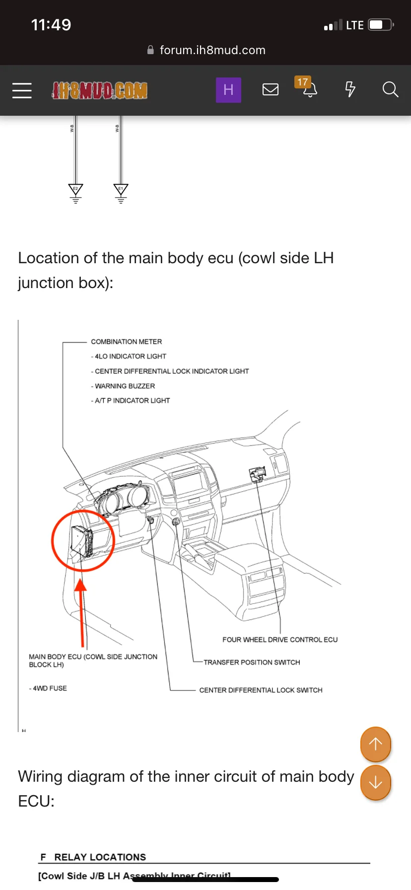

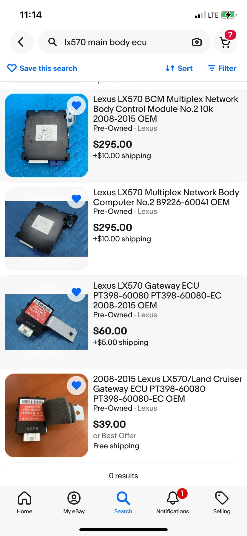

Would anyone happen to know whether one of these are a “main body ecu?” I cannot seem to find the exact part by that name via google
It’s looking like the main body ecu may also be called “cowl side junction box lh” and have a part number 8273360374 and cost around $800.

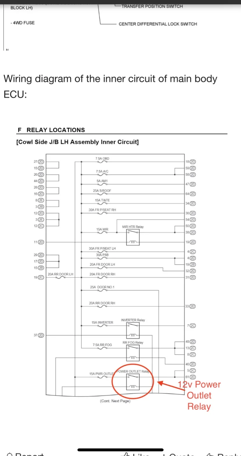

This section of the vehicle and type of part seems to have caused similar issues for 100 series:
“whenever I hear of strange electrical gremlins. I look for water entry signs, from poor windshield install. Water can run down "A" pillar into electronic, causing all kinds of issues. Typically when they dry, issues goes away. But if not corrected, than often over time, water damage become longer lasting or permanent.”
I’ve also seen mentioned that others have merely had a relay within this area go bad…or partially bad.
Considering the Lx570 seems to have two separate “stages” of door unlocking, it may be the case that the “driver door” stage of the unlock function is intact…but the secondary circuit that unlocks ALL doors seems to have some issue that arises in the cool moist mornings and often goes away in the warm dry afternoons.

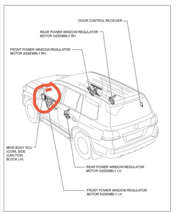

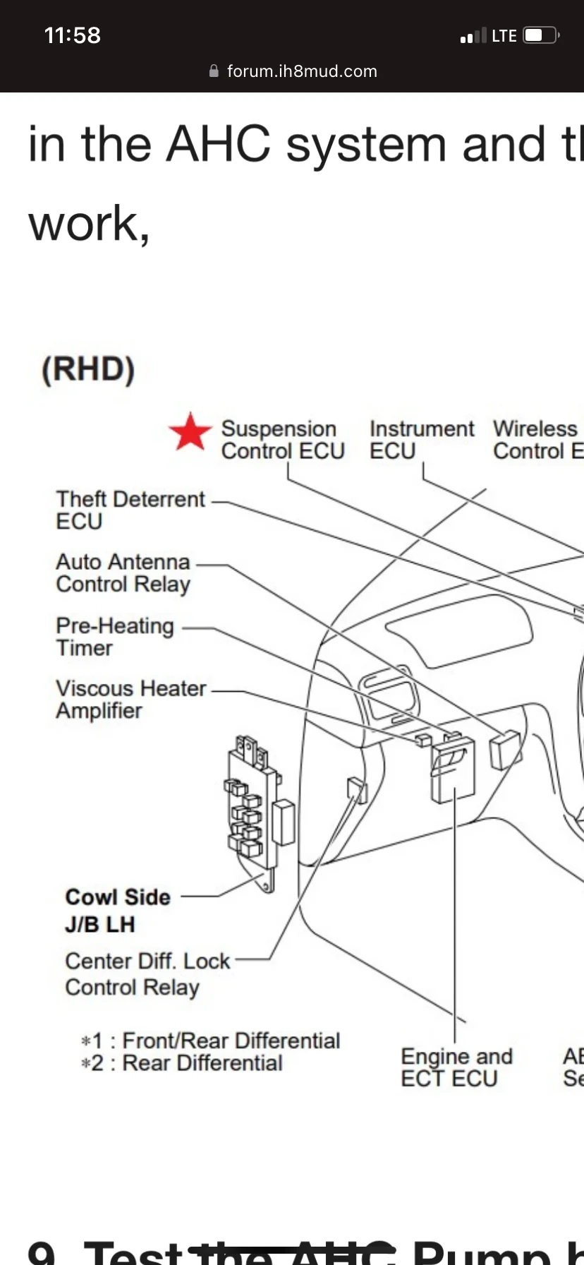

I think I need to find some sort of instructions for how to access this “main body ecu”/cowl side junction box lh/box filled with relays.
I expect it’s tucked behind the dash perhaps above the miniature fuse box that is near the driver’s left foot under the dash

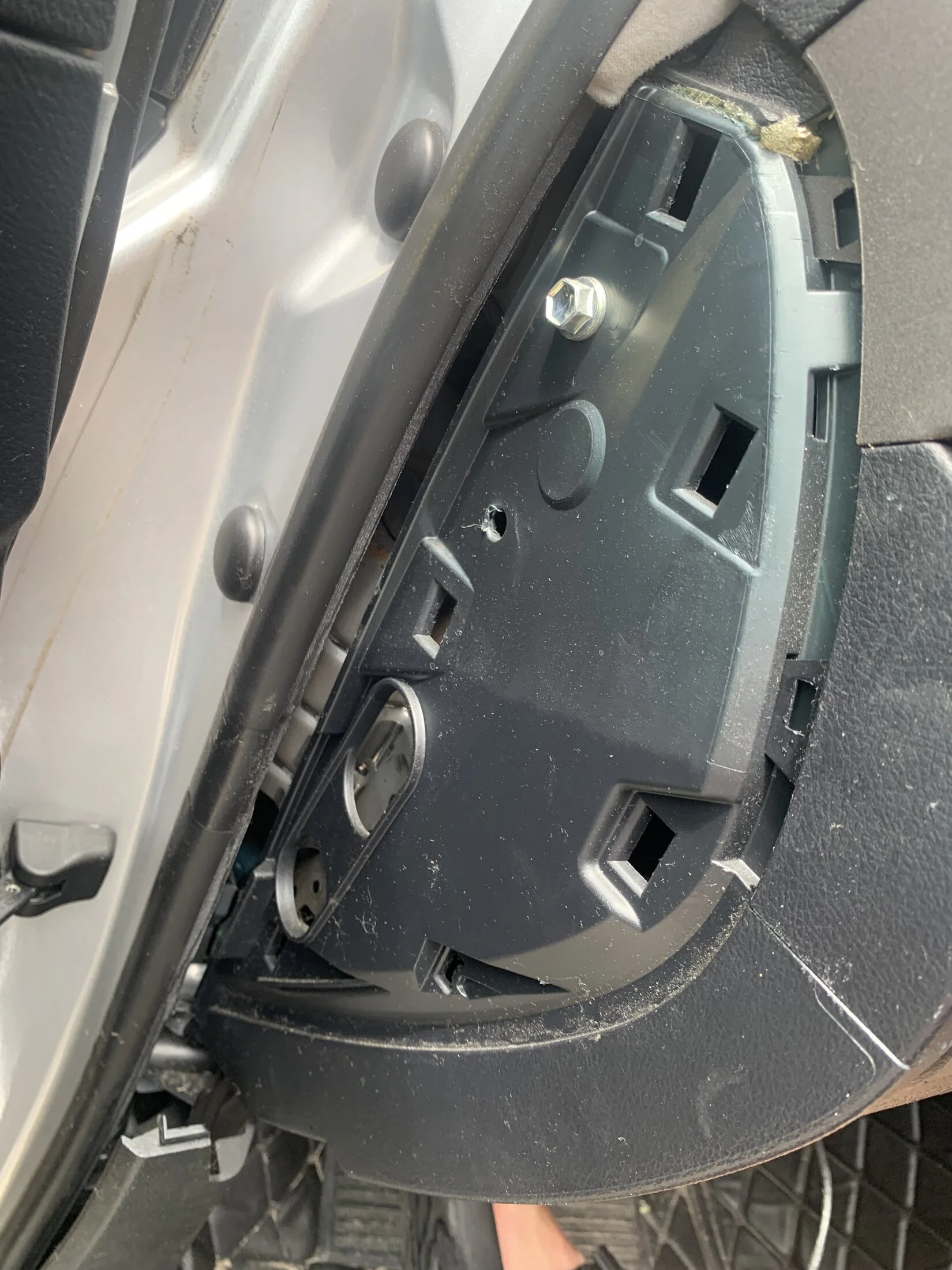

So all actuators still lock. But only the driver door will unlock.
I think the main body ecu, which I think receives the signal to unlock and then dispersed it to each door is here behind this panel. This is directly to the left of the left most driver side air conditioning vent.
