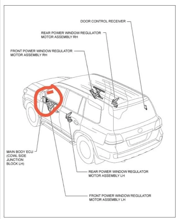

For your information, there's an ECU in the LH door...
