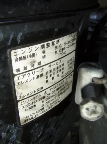

Engine oil & oil filter service:
Engine oil: CD class: 10w-3 (When really(?) cold: 5w-30: Hard to make out what it says)
Oil change: Every 5,000 kms (Something about 6 mos. Hard to make out)
Every: 10,000 kms (Something about 6 mos. Hard to make out)
Oil filter change: Every 10,000kms
Do not fill abovfe the "F" level
It might say the same thing in my truck but it's pouring rain and I just got back from getting a shot in my throat at a clinic and don't feel like going back out again! :hillbilly:
HTH's!

Thanks MOT! When you go check it out I'd be curious to find out more about it (what it says).

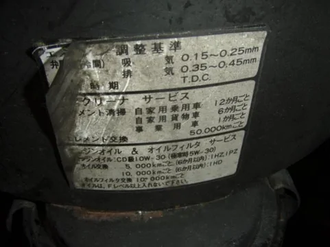

Engine oil and oil filter service
Engine oil CD grade 10w-30 (When uber cold then 5w-30)
Oil change interval: Every 5,000kms (or 6 mos): 1HZ, 1PZ
Every 10,000km (or 6 mos): 1HD
Do not overfill
HTH's!

He said it first folks! Just kidding!
Good to know. Thanks!
Confirms what I've known intuitively from checking the oil and listening carefully to engine sounds... 10,000km / 6 months with Dino
Japan, Europe and Australia recommend different oils, its kinda funny if you ask me.
I am curious to see how running 10w/30 and 5w/30 will be comparing to 15w/40 Rotella

Mot,
Is there any indication what region the label came from or was meant for that you translated. I´m here in Centroamerica and I´m running Motul 15w-40. That is the standard weight oil for any diesel around here. Approx 6 months in the 1HZ and before that about a year and change in the original B. Altogether two years so far, so good.
