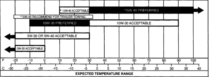

It all depends on the temps you are on.
What can kill an oil is an extremely hot or cold condition.
Too cold = Higher Viscosity = More resistant to flow = Might not be able to reach some parts at the correct time = wear = less engine life.
Too hot = Oil too thin = Loses lubrication properties = less lubrication = wear = less engine life.
You have to play with the oil and find which suits better your engine.
You are in San Francisco where average temp is 14°C (57°F), 15w40 wont brake your engine as your mechanic says. You can change it and verify oil pressure and fuel consumption. If you think your seals and gaskets are in good shape try using full synthetic. If I were you Ill start with 10w40.

The only reason to run 15W40 is it's cheaper. 10W40 or even 5W40 performs the same at high temps but better at low.

Yes but you're in Auckland where frost is unheard of so 15w40 is fine.
As you get colder you need an oil that flows better in the cold.
