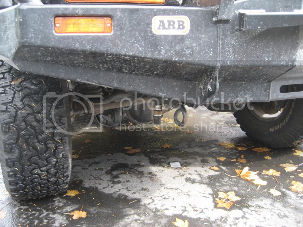

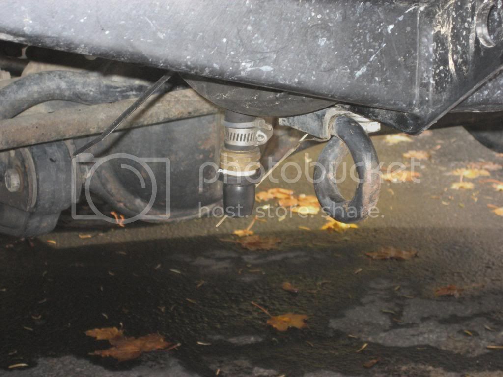

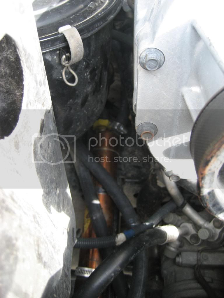

The R&M Beast is selling is a heckuva deal! Here are a couple of pics of that same heat exchanger in my Cruiser:
Installed on the frame rail, you can slightly see it between the battery tray and SC..
One of the quick disco's visible:
further away.
