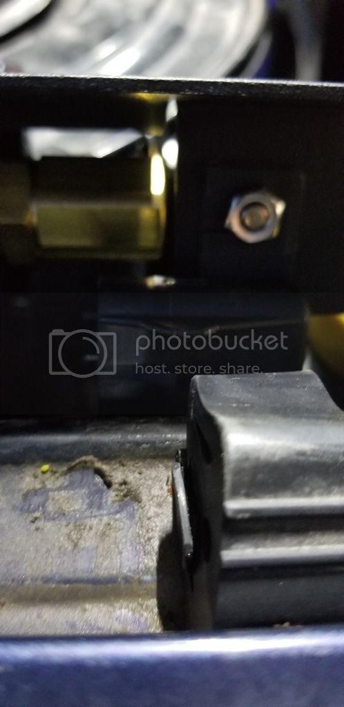

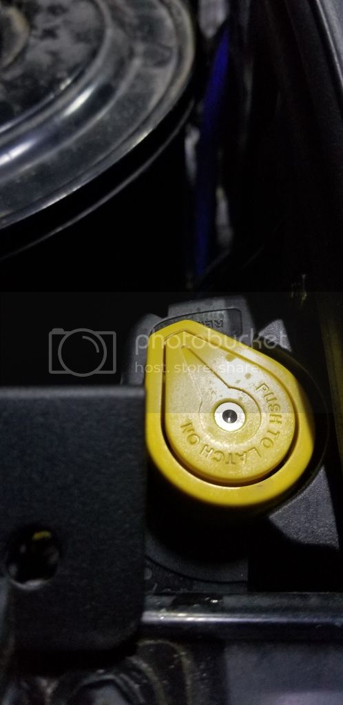

Quick test fit/mockup and I have a small issue unique to my particular install. I have my acr switch mounted on the battery box pretty tight to the fender. The fuse holder is in direct contact by a good 1/2" in 2 directions. My acr has basically zero slack on the "in" wire, so moving it would be a hassle. I think if I rotate the fuse holder to the left and Notch that part of the bracket, it should fit. Otherwise I could probably move the fuse holder to a totally different location. The next issue would be the inlet from the compressor being about 1" from the acr switch. I'm sure a low profile 45 degree fitting would clear. Any idea what you're going to use for fittings from the compressor? Hopefully the pics make sense. The 2nd one is just the switch holder rotated as I explained.
I don't know if it is possible with your installation but I used the manifold end closer to the battery for a 90* to the air tank rather than the bulkier AN fittings I was using from the coalescing filter. That might buy you a little more space near your ACR.
