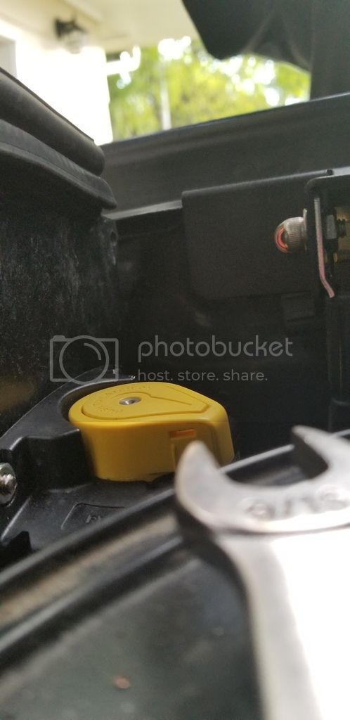

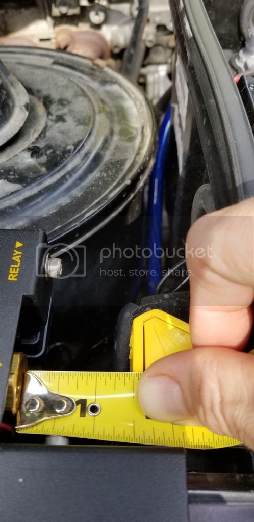

After looking at this again, I think it'll be a close fit, but it should work. I may be able to lower my switch a little over an 1/8" and with turning that holder sideways, it should clear. I've got about 1.25" from the fitting to the switch body, any measurement on that elbow?
I'll measure in a few minutes.

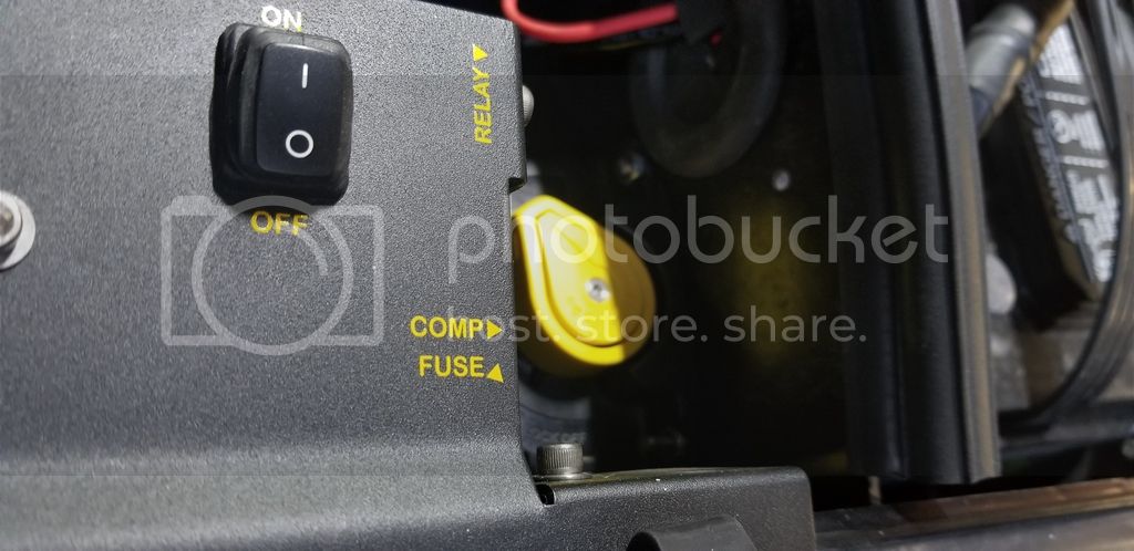

Would that go right into the manifold, or would I still need the fitting that is already there?
That "fitting" is there as a one-way check valve. What you could do is switch sides. Then the only issue is the markings don't like up but a black paint marker can take care of that. The manifold doesn't care which port is which.

Ah OK, didn't realize it was a check valve. Looks like I have plenty of options. Just need to get everything fitted and measured before I decide.

Yeah if nothing is in the way then the path I set up works out really nice and compact. But that doesn't work for some as you've found. That's one of the reasons I didn't tighten any of th fittings. The ends are 3/8" NPT and the others are all 1/4" NPT. Move things around as needed.
Finally got a chance to play with it again. I really didn't want to cut the bracket and switching the fittings around with mismatched labels would've irritated me every time I popped the hood. So, I pulled the battery tray and found I actually had enough slack in the battery cable to basically double it back around so it wasn't shooting straight up to the lug. This allowed me to move the acr switch down a good 1.5". Plenty of room for activities now! Shouldn't be a problem to fit everything as intended :).
