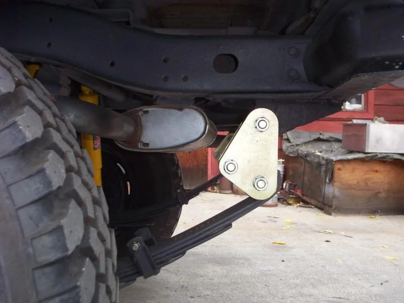

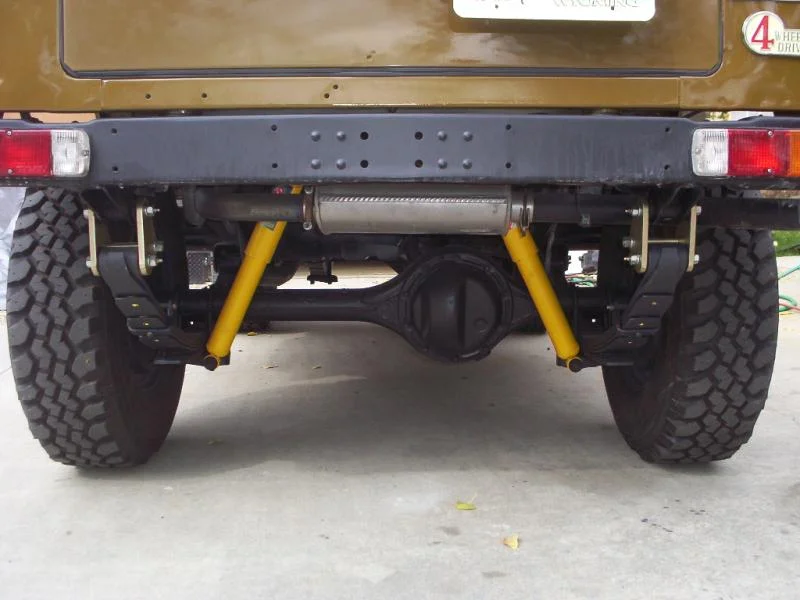

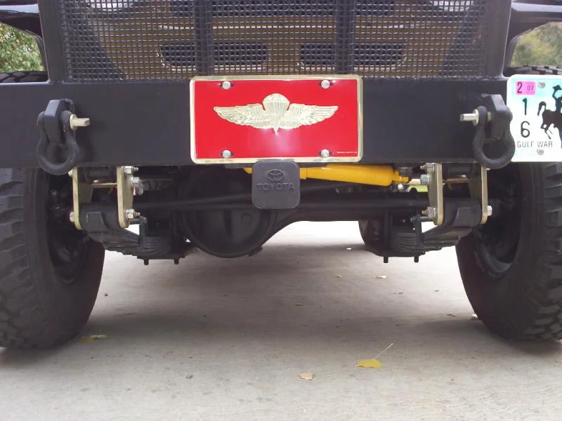

Would love to see some pics of your shackle angles as well as a side view. I had finally made up my mind to buy these and started hearing all this stuff about them having bad shackle angles because the springs are too short. Please post some pics if possible. Thanks
I got my complete setup from Man-A-Fre for $1215.00, plus it was $200.00 shipping here to Wyoming. With shipping, this $1400.00 is what most places are asking for the setup before shipping. It was the least expensive place to buy that I found, and I looked hard. I am sorry if I didn't buy it from one of "the good old boys" but $200.00 isnt worth the fuzzy feeling.

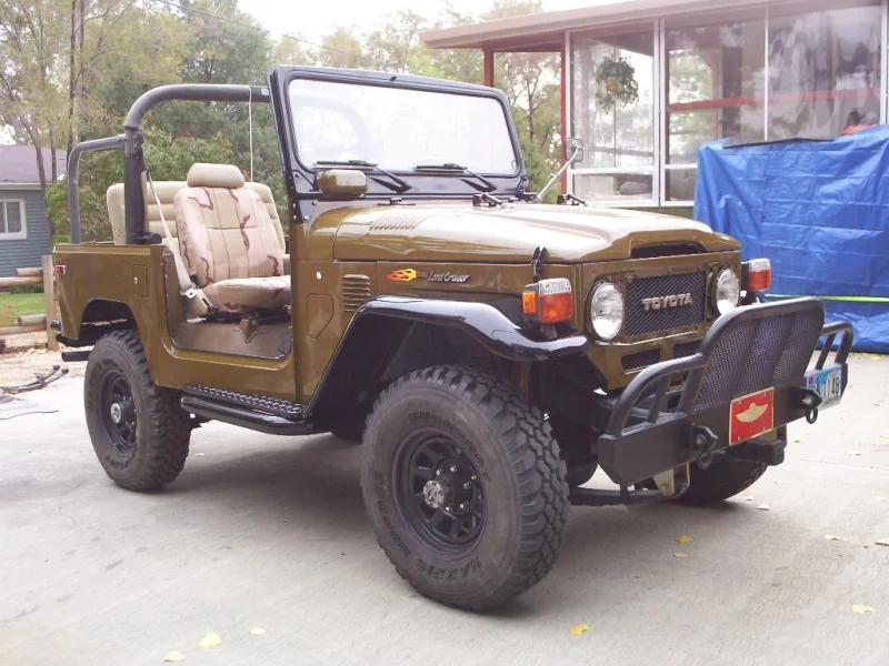

Here they are:bounce: the first one is just after repaint
Thanks for the pics...nice truck!!! What size tires are those? How difficult and how long did the uninstall install take? Any pointers?
Also, what color is that..Olive brown?
Thank you! I am running 235-85-16's. They work great in the mud and snow. Color is the original Olive Green and I decided to break it up with the black. I think it took me about 4 Hrs. I used an air hammer with with a long round bit to drive the old pins out and it was very easy. I did it myself and could have cut the time down with another set of hands. Best tip is to search the forum for people who have done it and see what they did. Jackbrad has a good write-up on his. https://forum.ih8mud.com/search.php?searchid=1139062 The kit doesn't come with instructions so get a game plan before starting.
