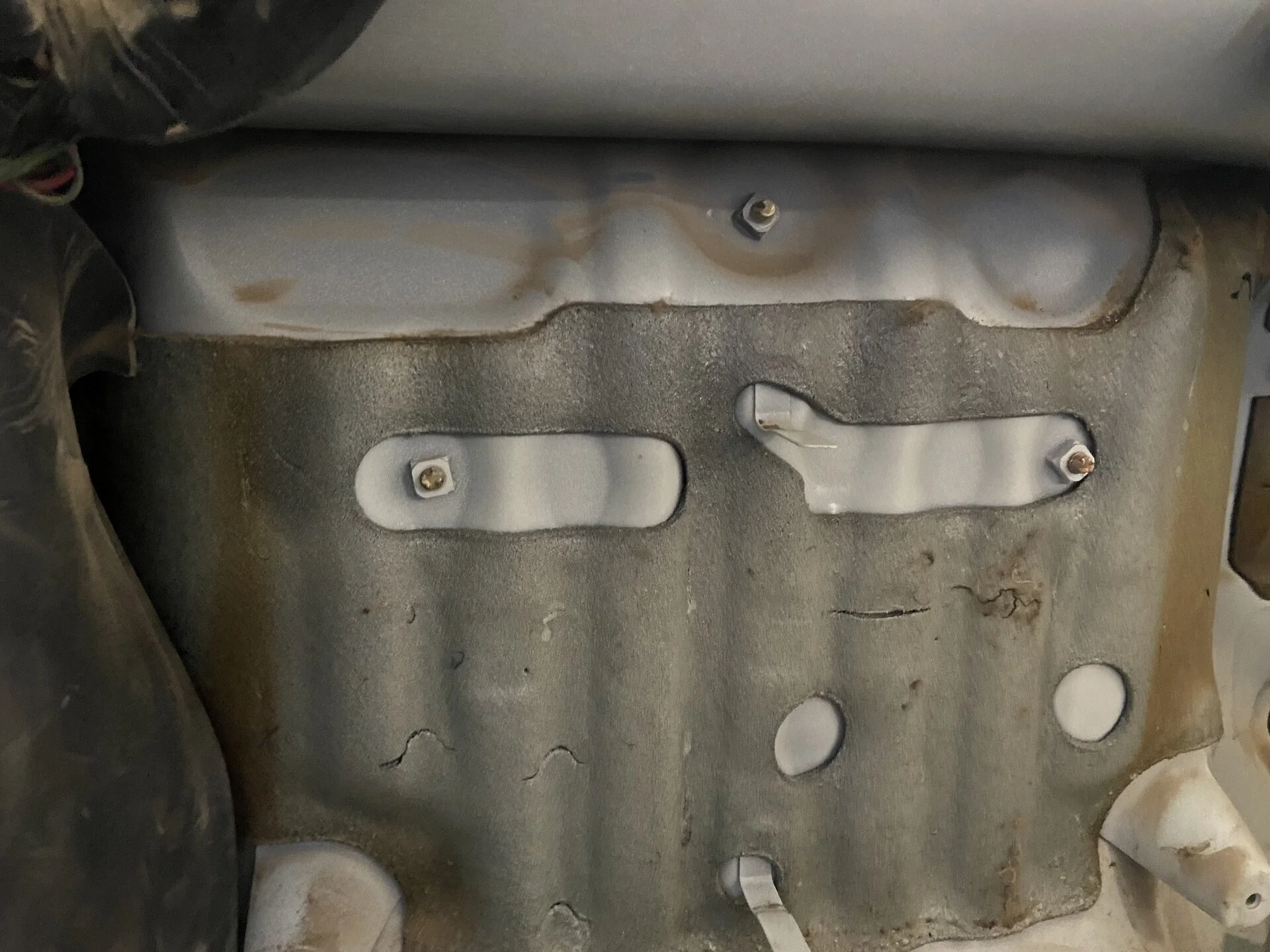

Will be time to cut into a perfectly good firewall once parts arrive.
Apologies in advance for hijacking your thread a little, Paul.
There are two styles for the heater lines through the firewall. Close together and far apart. I used the close together version, partly because that was the heater core I found. The other thing I would suggest is to consider having the radiator shop braise on another inch and a half of length so that you have a bit more sticking out of the firewall. It is looking very good Paul!

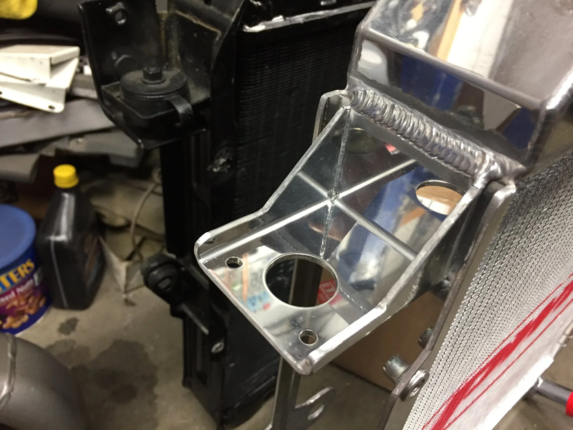

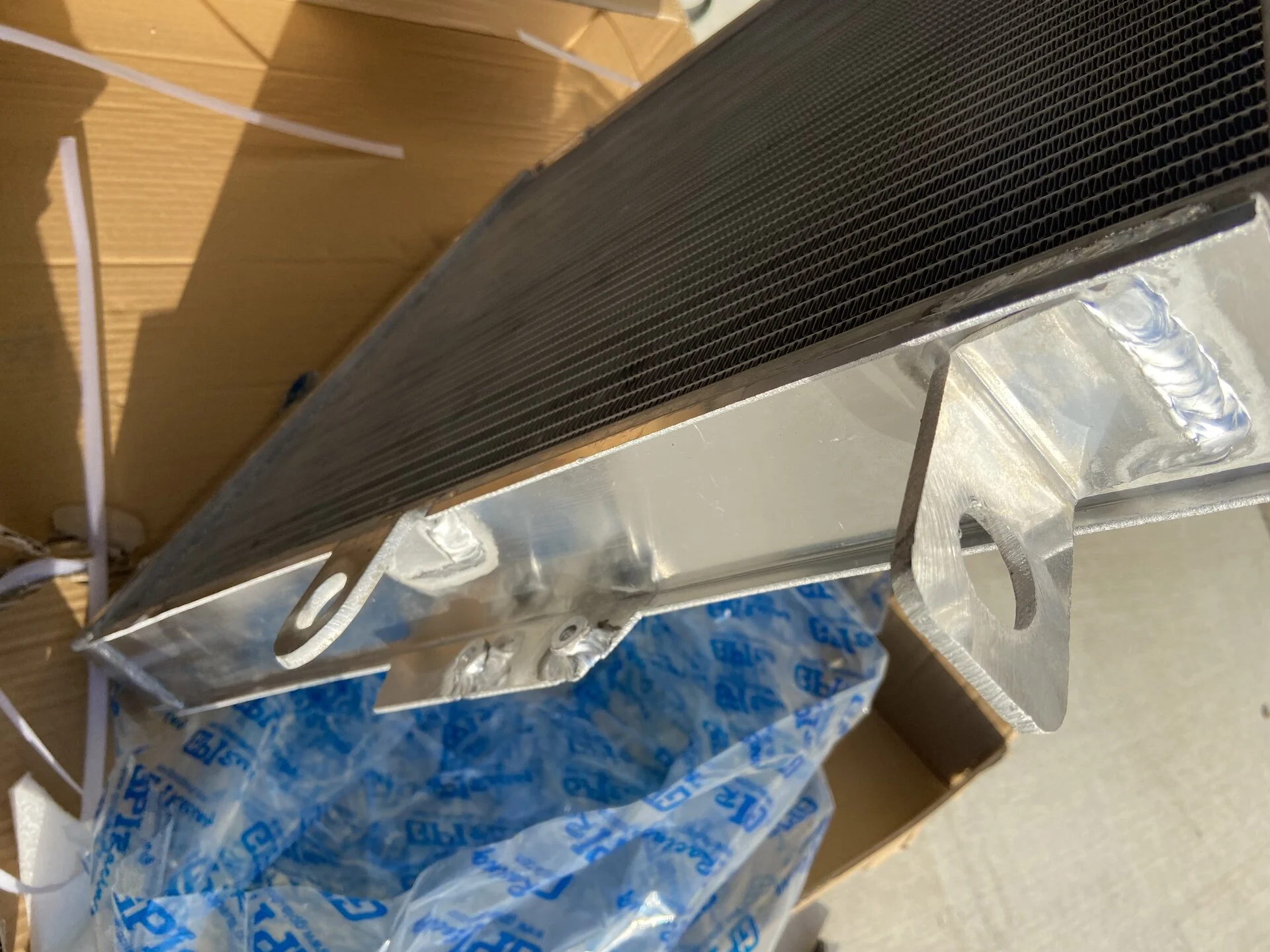

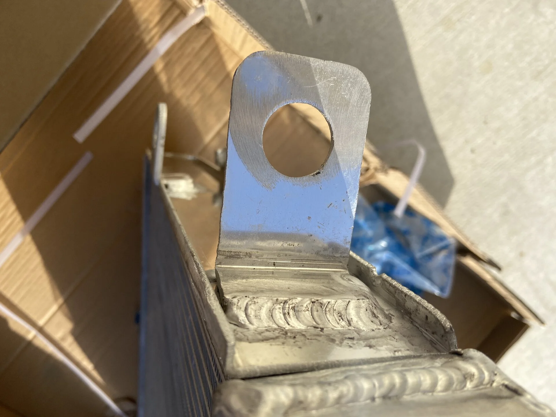

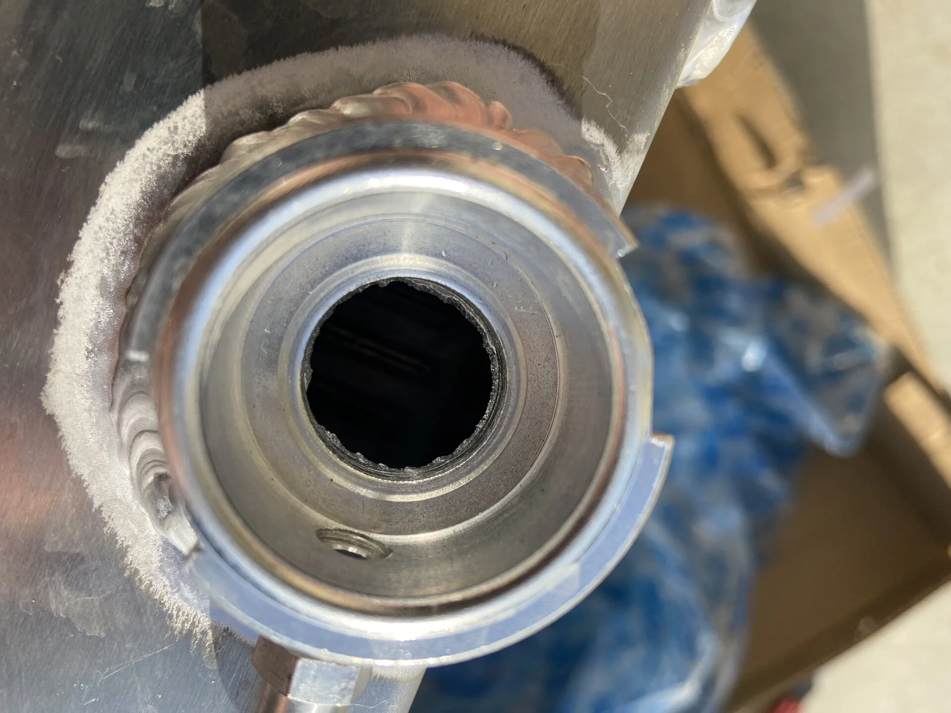

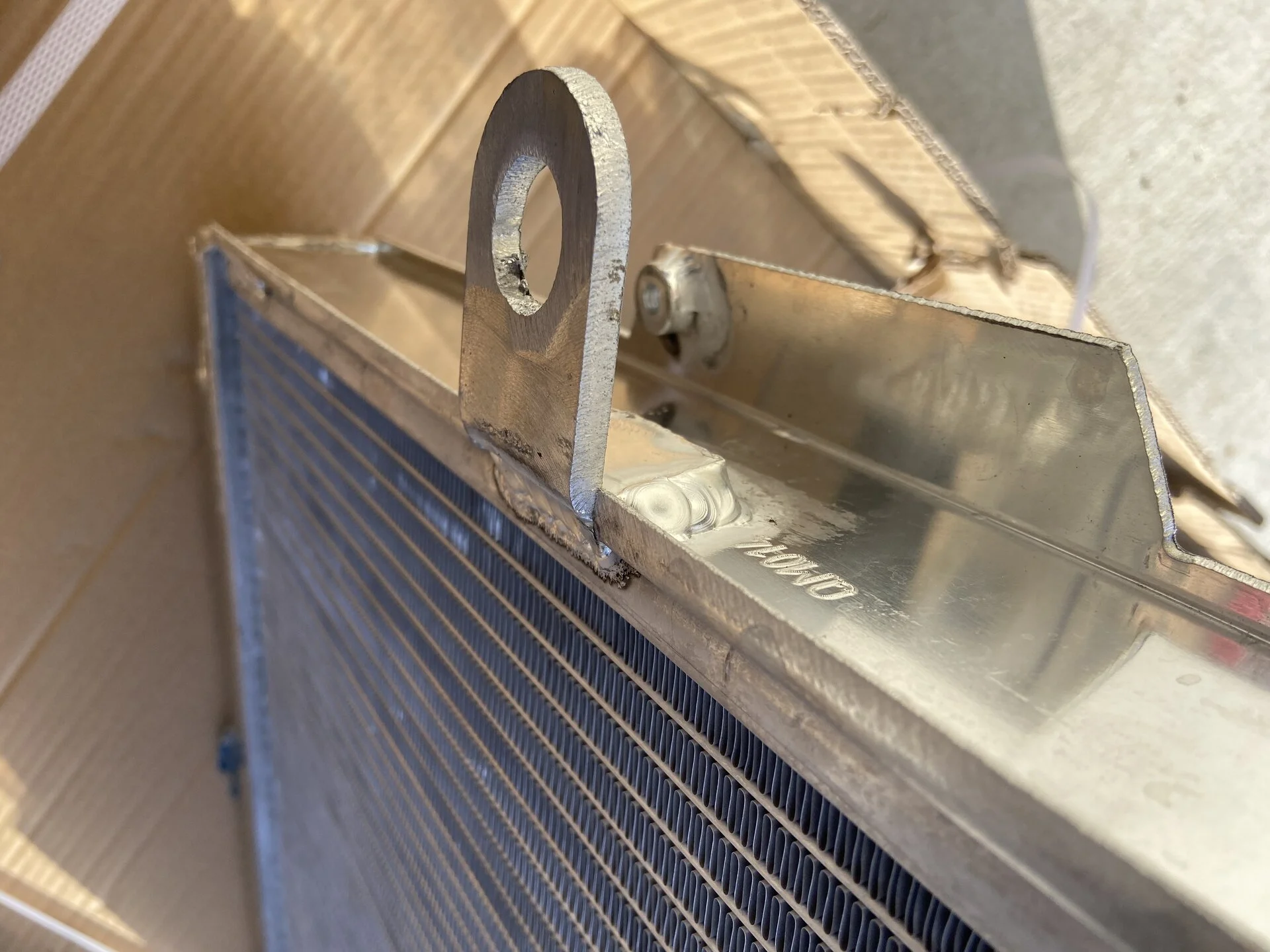

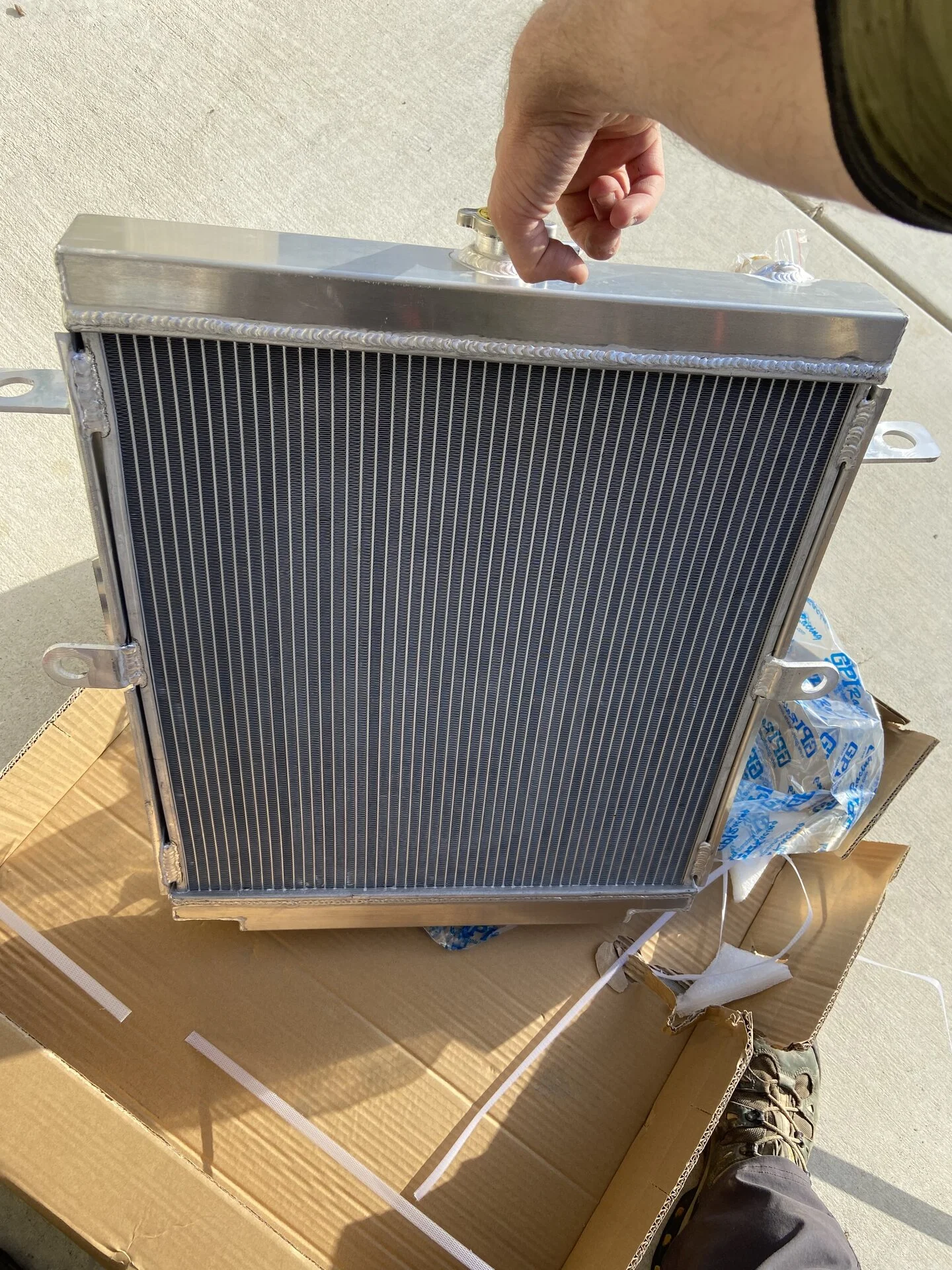

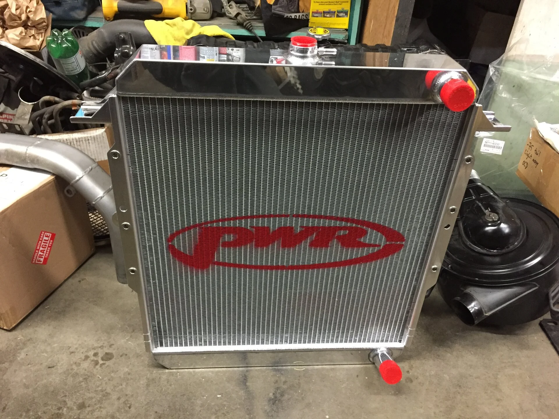

Got my radiator in today. Definitely looks to be slapped together. Will look to see what a local radiator shop can do with my old one.

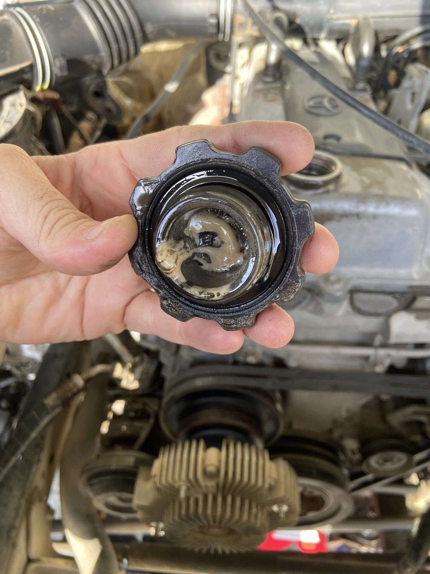

My oil cap has white "gunk" under it. Head gasket?

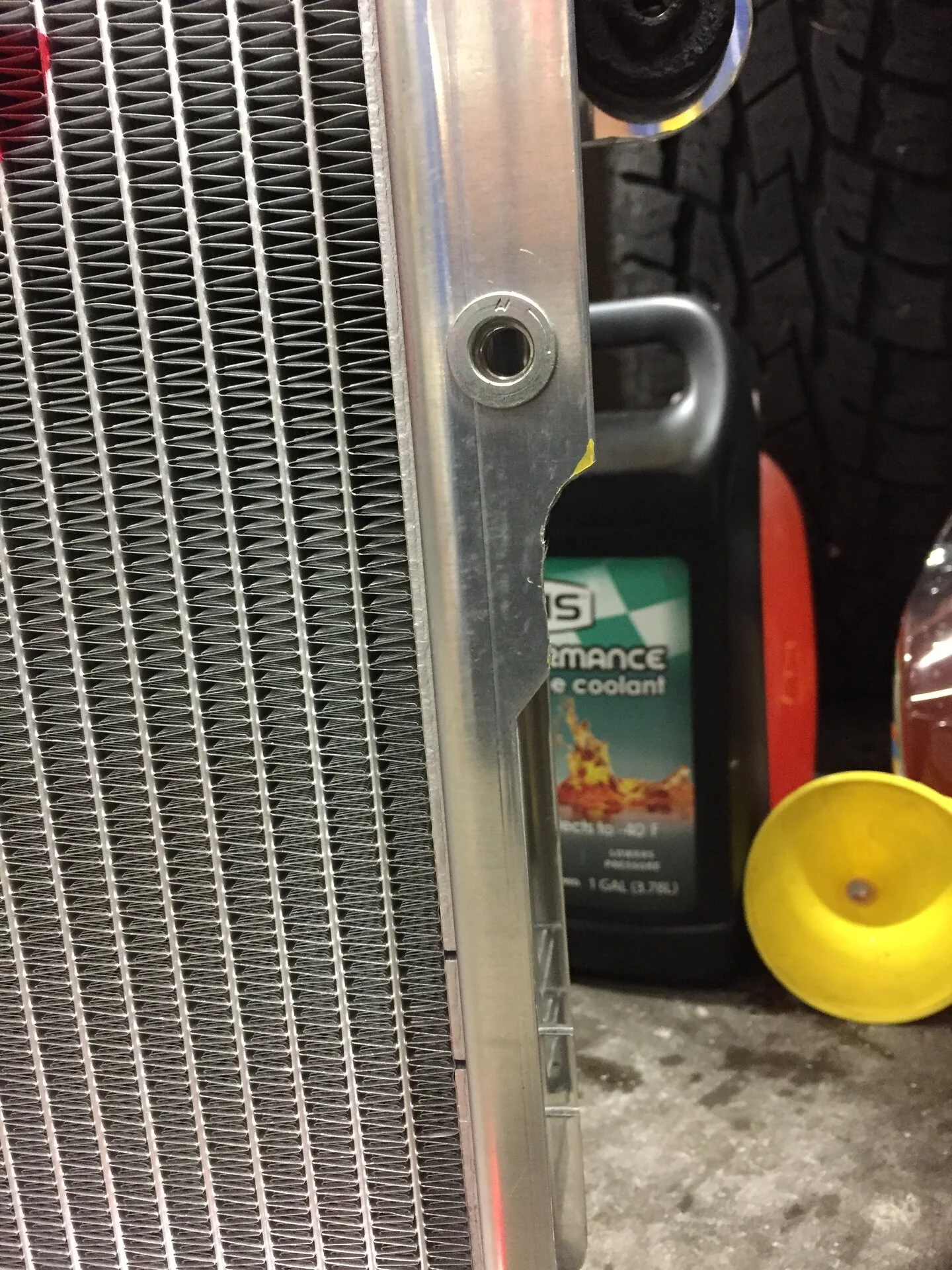

PWR wouldn't build me one with the sides. They kept saying my sides on my old one would mount to their core. I sent them your pictures but nothing would make them budge. I don't understand it.
You have a Hz right? They should have the specs for a HZ rad. I believe someone on here got one from PWR recently for their HZ. Maybe first contact PWR in Australia and then they’ll tell you to contact the US office. When I did mine they sent me some 2H rad drawings that I could then modify for what I wanted done. Just weird.
1FZ-F carb. I talked to their US subsidiary, they said they wouldn't make any modifications. Unsure why as I was willing to pay the price.
but first, a small diagnosis, its been winter, have you been doing mostly short trips with it? it could simply be condensation buildup from not running/driving at operting temps for long enough times.
I have been doing short trips, under 20 minutes because the thermostat isn't reading on the dash and didn't trust the radiator.
Hoping this is the cause, but need to get a new radiator and reinstall the dash before taking her back on the road.

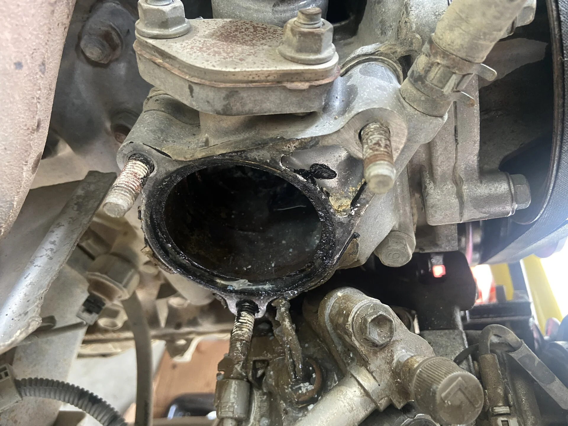

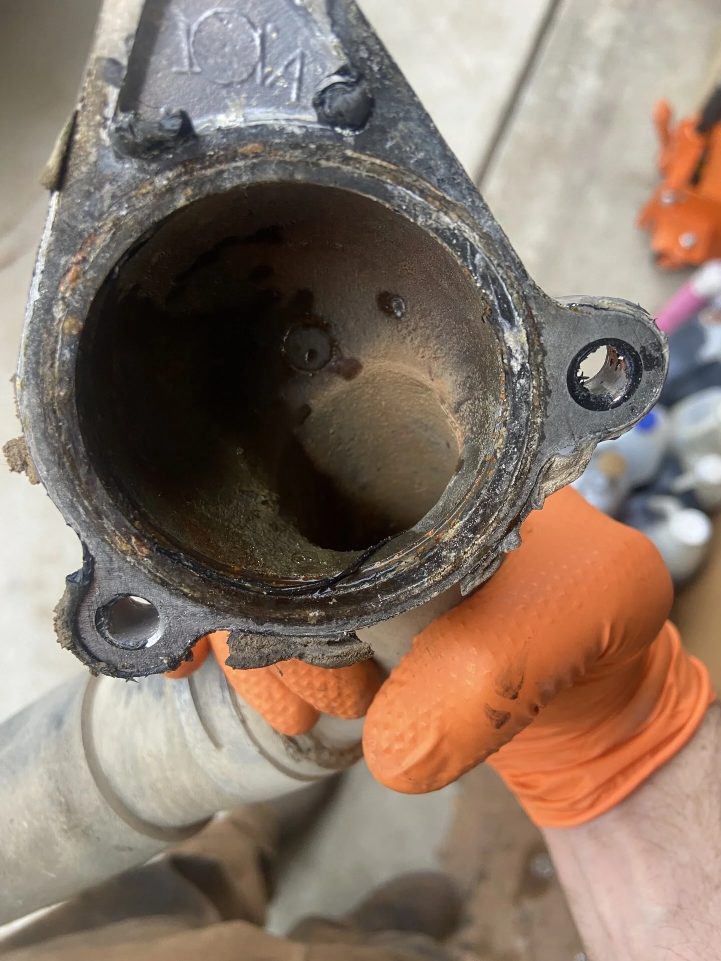

Believe I have figured out why my engine temp gauge wasn't working.
They removed the thermostat completely last time this was changed. Water inside has mineral deposits, need to do a very very thorough flush of this cooling system once my radiator comes in.

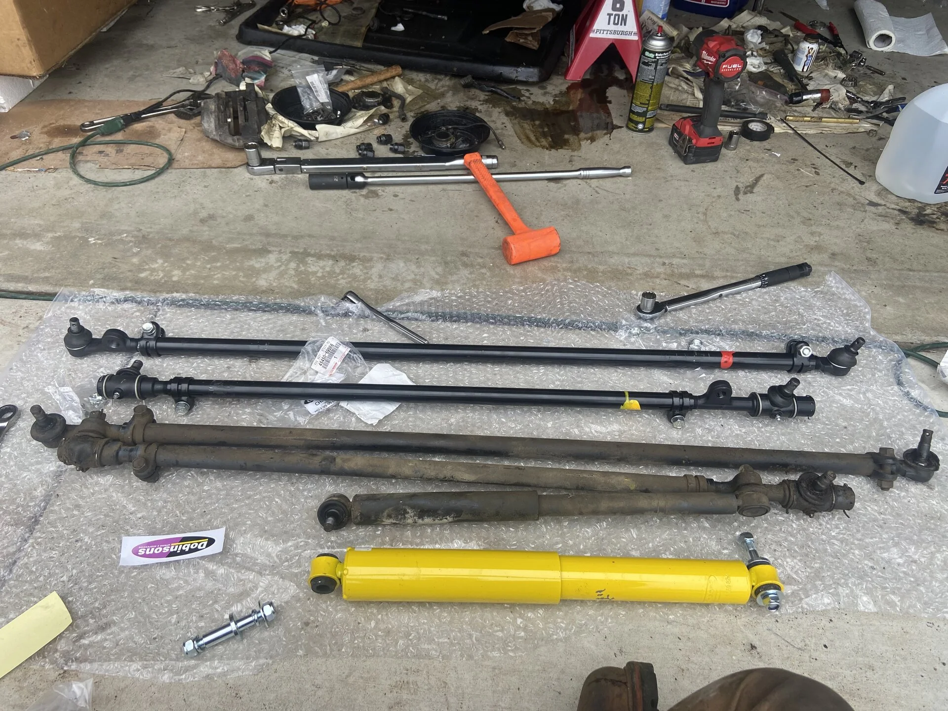

Also installed new tie rods/tie rod ends and the Dobinson's big bore steering dampner.
Will get an alignment once I put on my lift.
