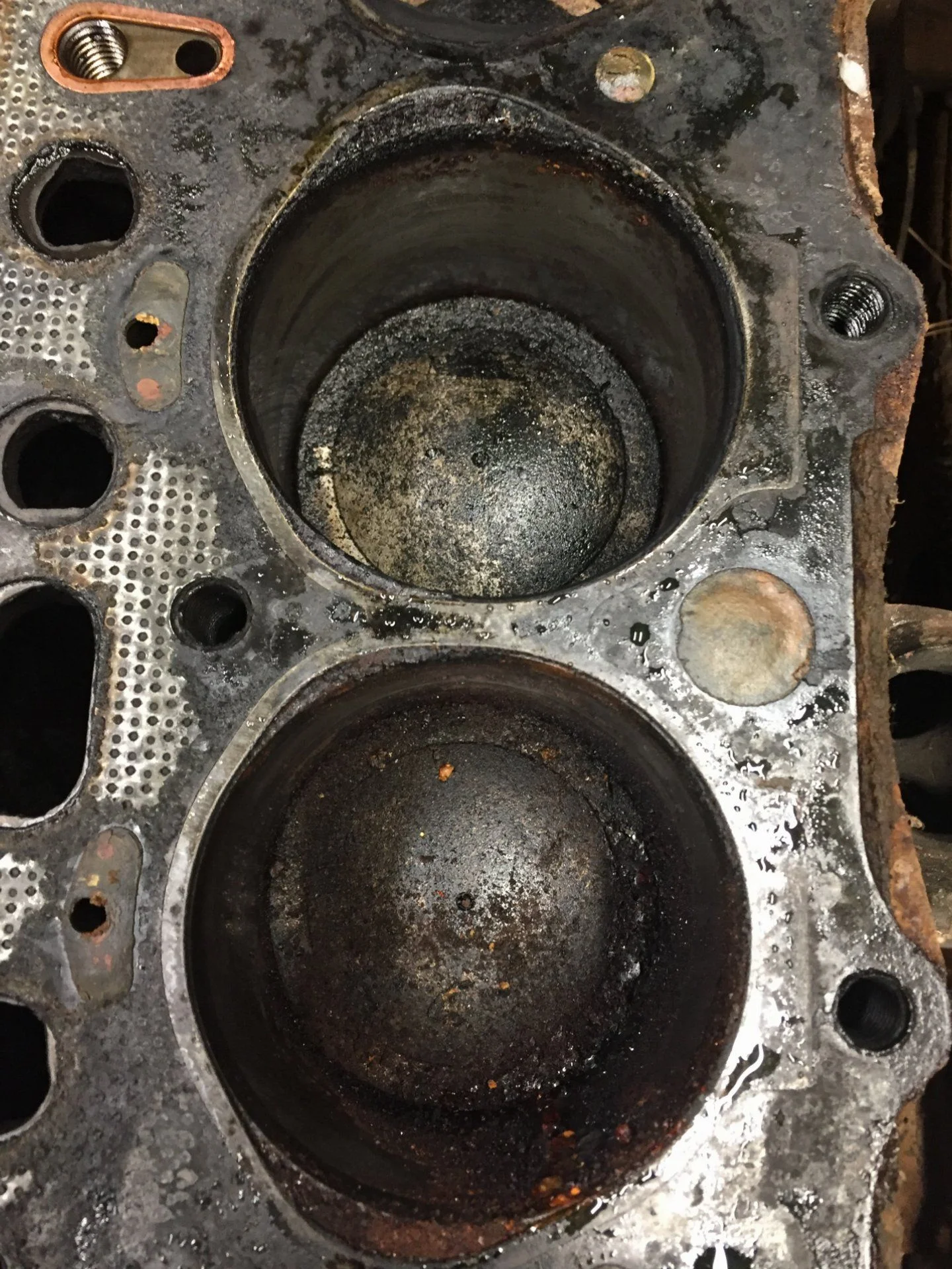

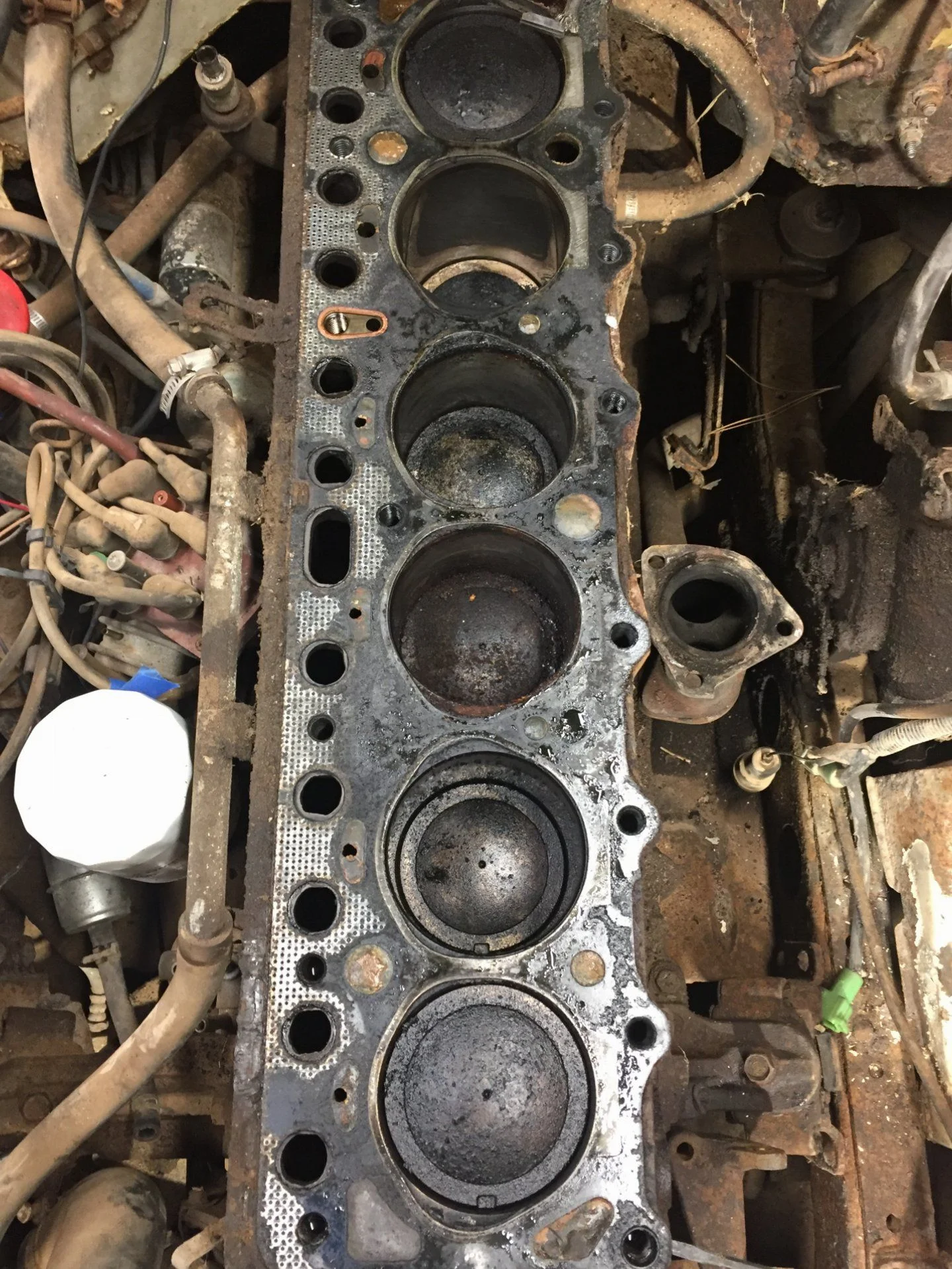

Right now I'm working on getting the 2F in the red '79 running. Got the head off the other night. Four cylinders look ok, but two have some rust in them. Called around to some machine shops. Got quoted $550 - $600 to do the machine work to resurface flywheel, rebore cylinders, crankshaft etc etc. Going to have a mechanic buddy of mine take a look and tell me if he thinks it's worth it. What do you think?

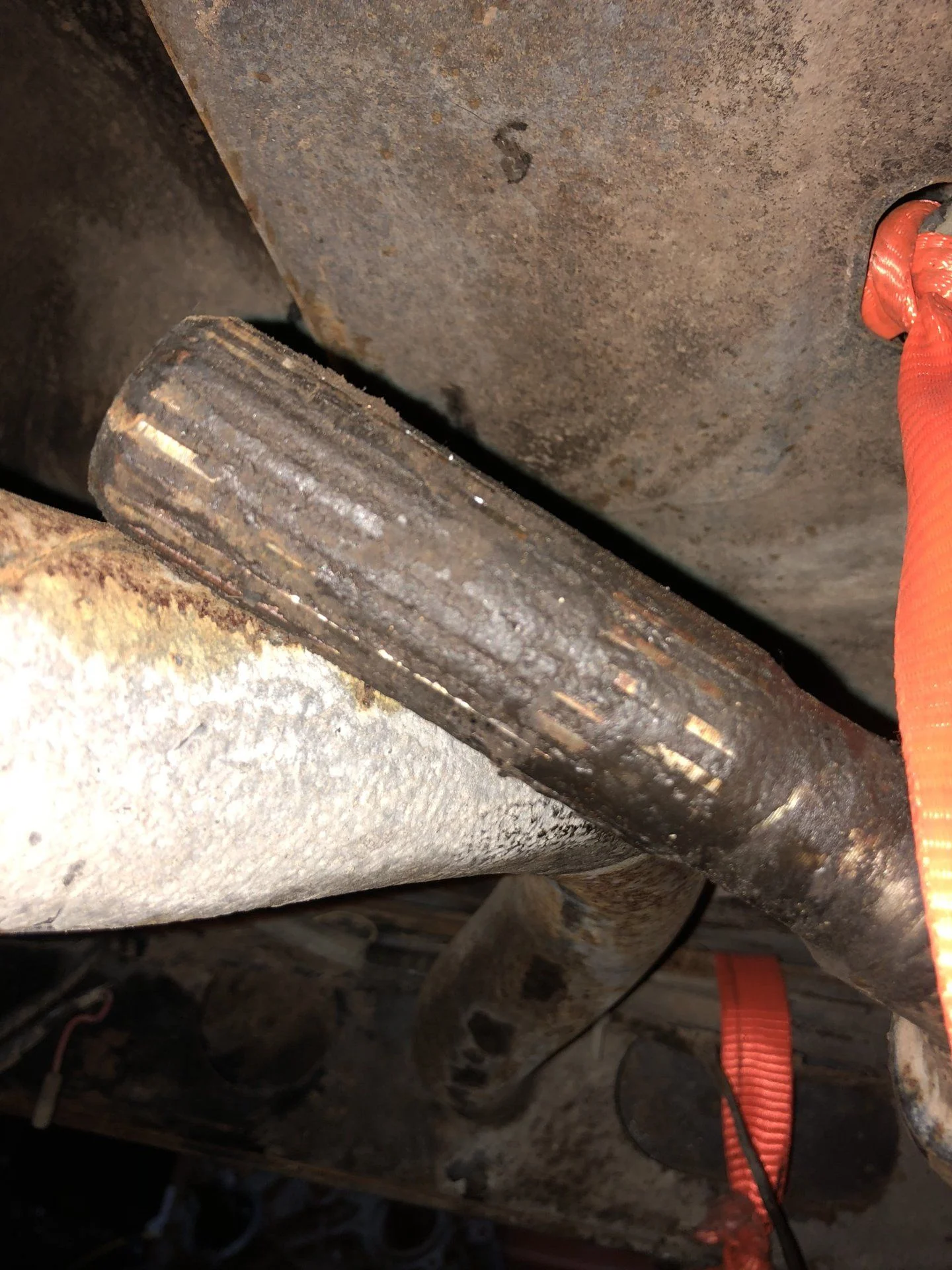

Hello all. Got back to Washington in November, but just unloaded the 40s at my shop last week. I’ve been so busy since the move that I never had a chance. Turning a few wrenches today, trying to get the green one disassembled. Can anyone tell me an easy way to distinguish 3 spd front driveshafts from 4 spd ones? The transmission and transfer case in the green one were left open to the elements for years and so I think they’re a total loss. I do t know if they’d been swapped before or not.....
Flange chart (4-speed '74 model year and later). Cruiser Outfitters
spotcruiser - thanks for the link! Definitely helpful.

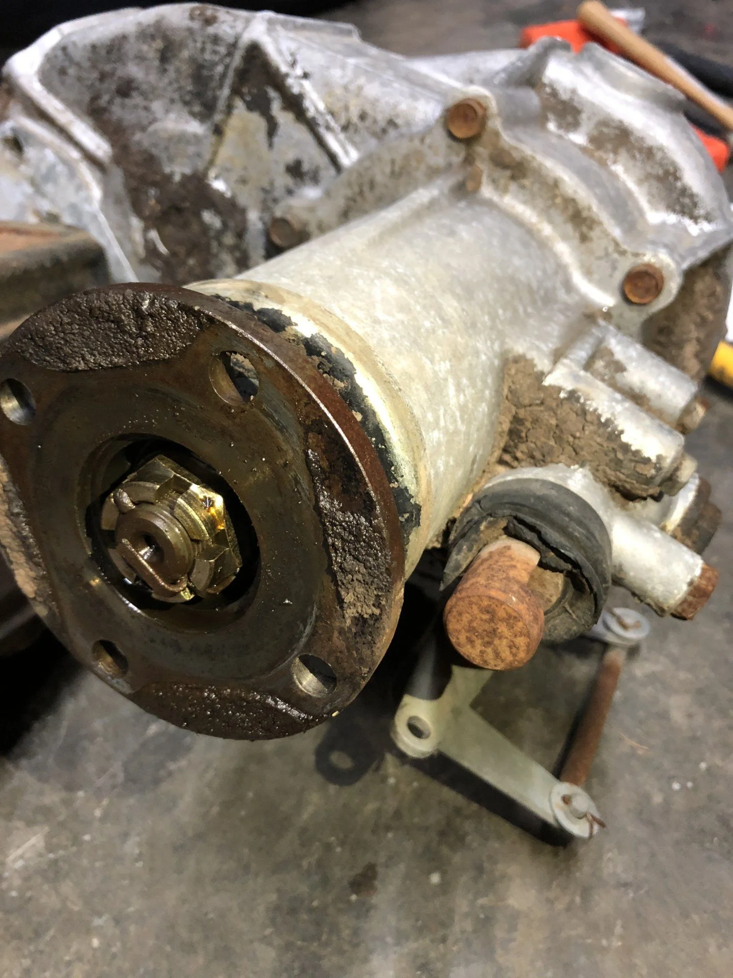

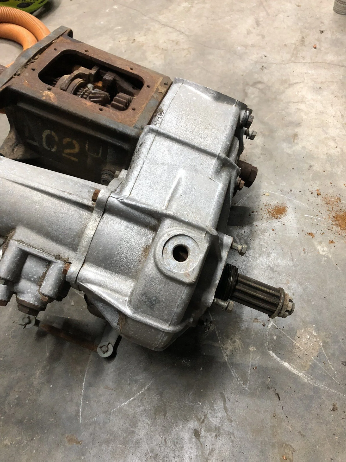

Another question I had: given the option of completely rebuilding a 3-spd transfer case (with new internals, as the existing are covered in rust) or cleaning up a 4-spd transfer case (hopefully using the existing internals) what would any of you do? I plan on driving my 40 primarily on hard-surface roads in good weather, probably not much freeway time. Are there shops that will do this work for me, and if so, what price range would I be looking at? I'd like to do it myself, but might not have the time.

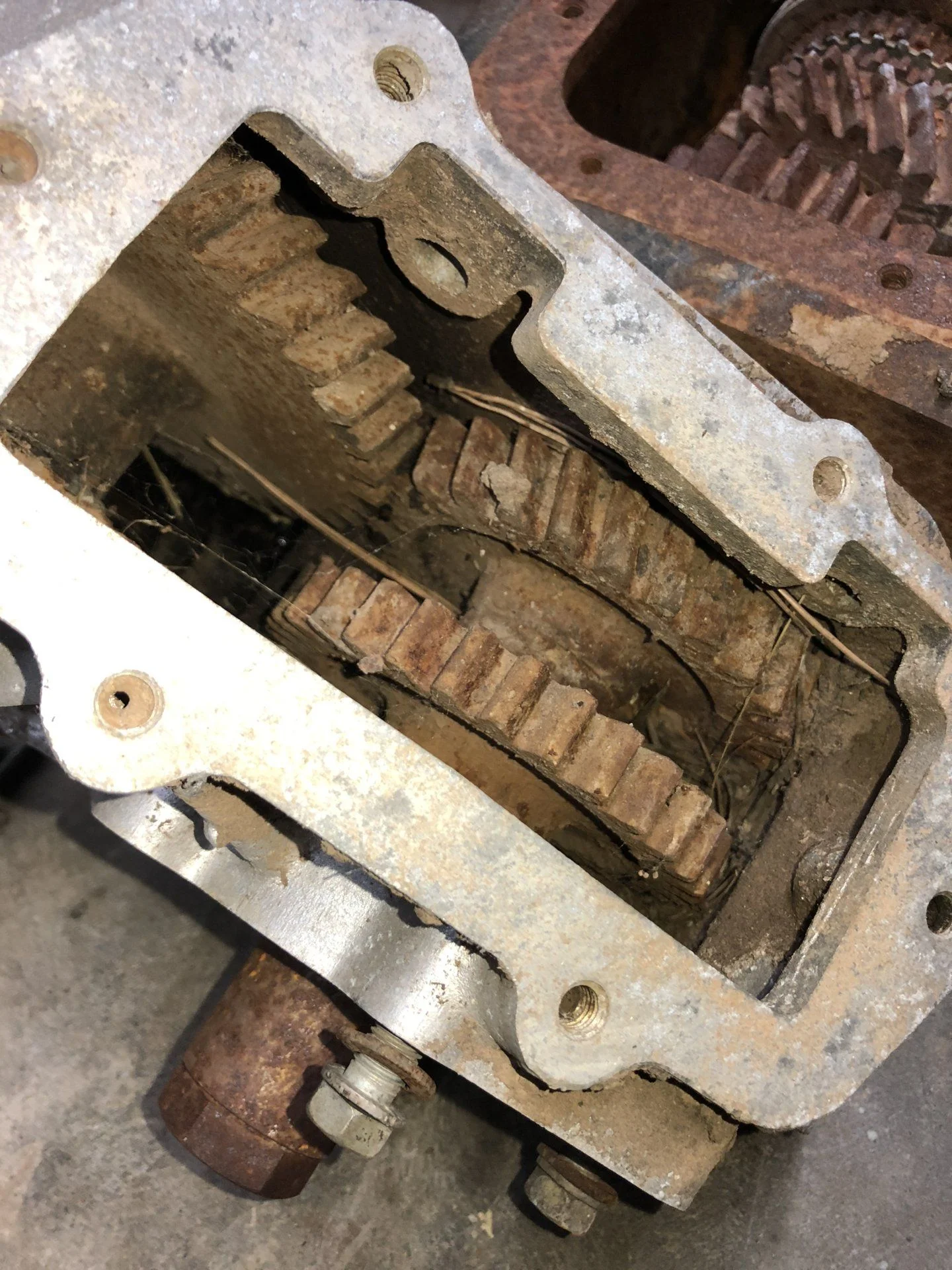

These input gears in the transfer case aren't salvageable right? Is there a good source for replacements? The case itself looks to be in decent shape. Is it cost effective to attempt to rebuild it or should I just try to source a working replacement?

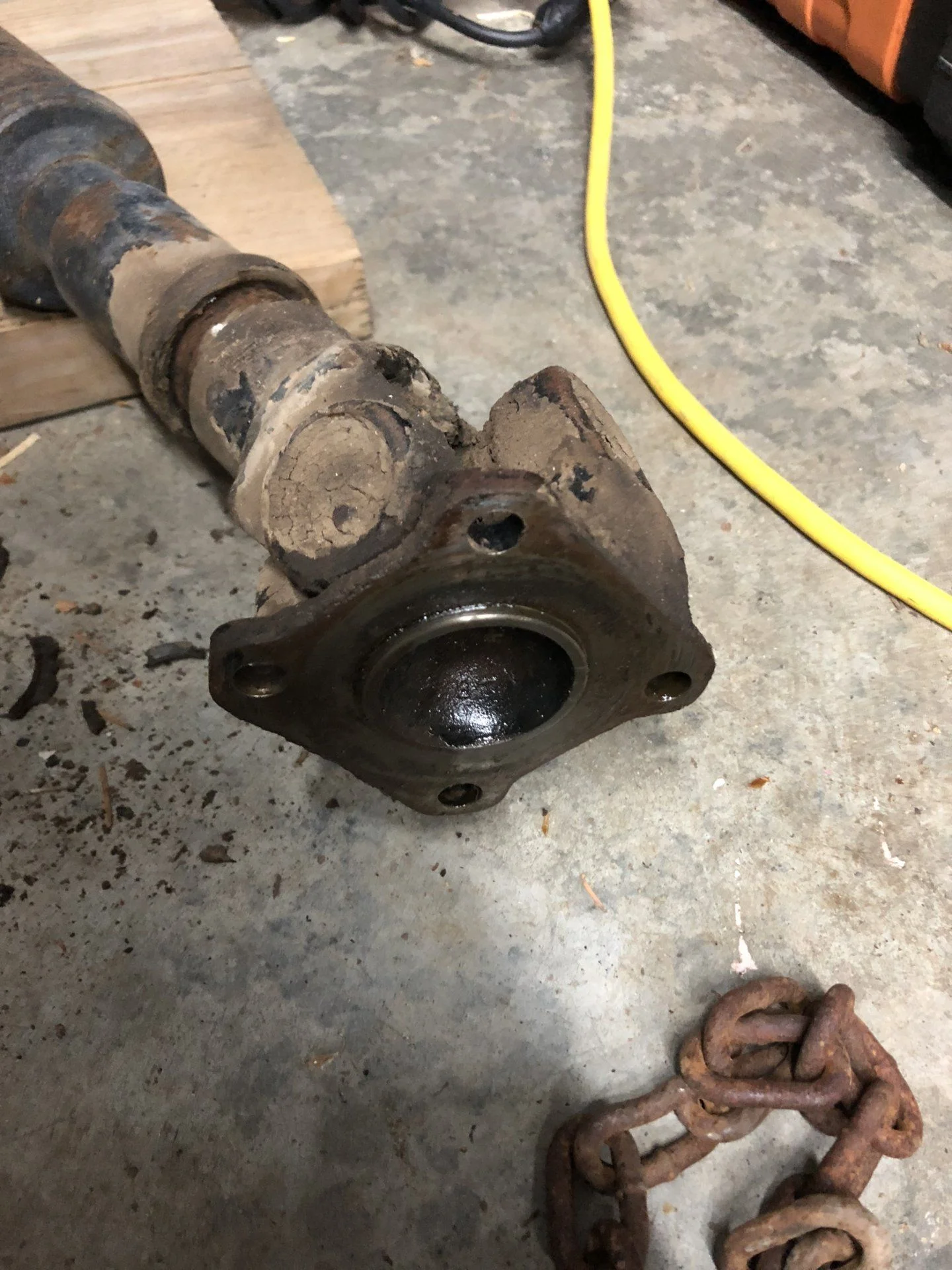

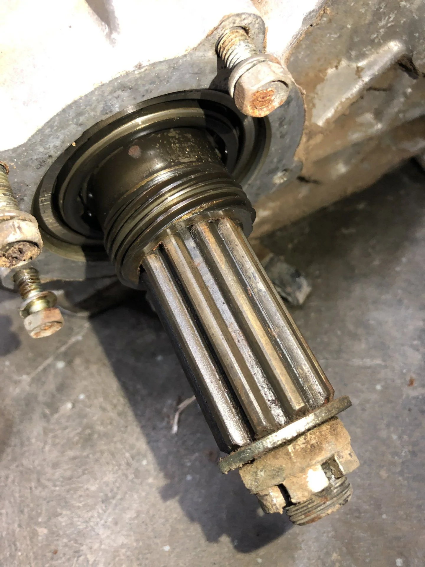

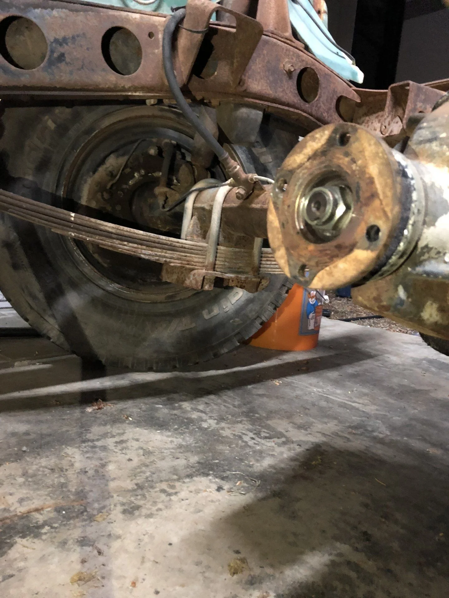

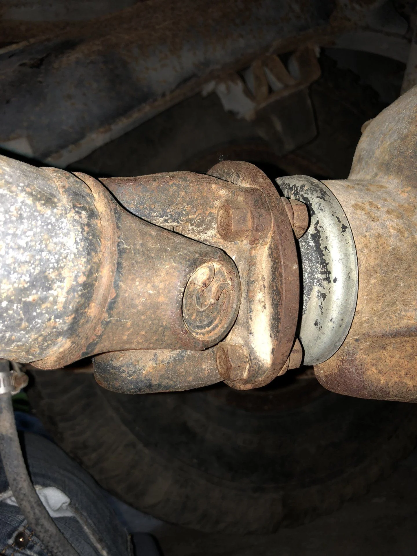

Can anyone tell me what they think is going on with the driveline components that accompanied this vehicle? They weren't all installed per se, but rather hung haphazardly beneath the vehicle in various states of attachment. Based on the link to the flange chart posted earlier, I feel like I have a mix of early and late components. 10 spline, 27 spline, different flange shapes, etc.

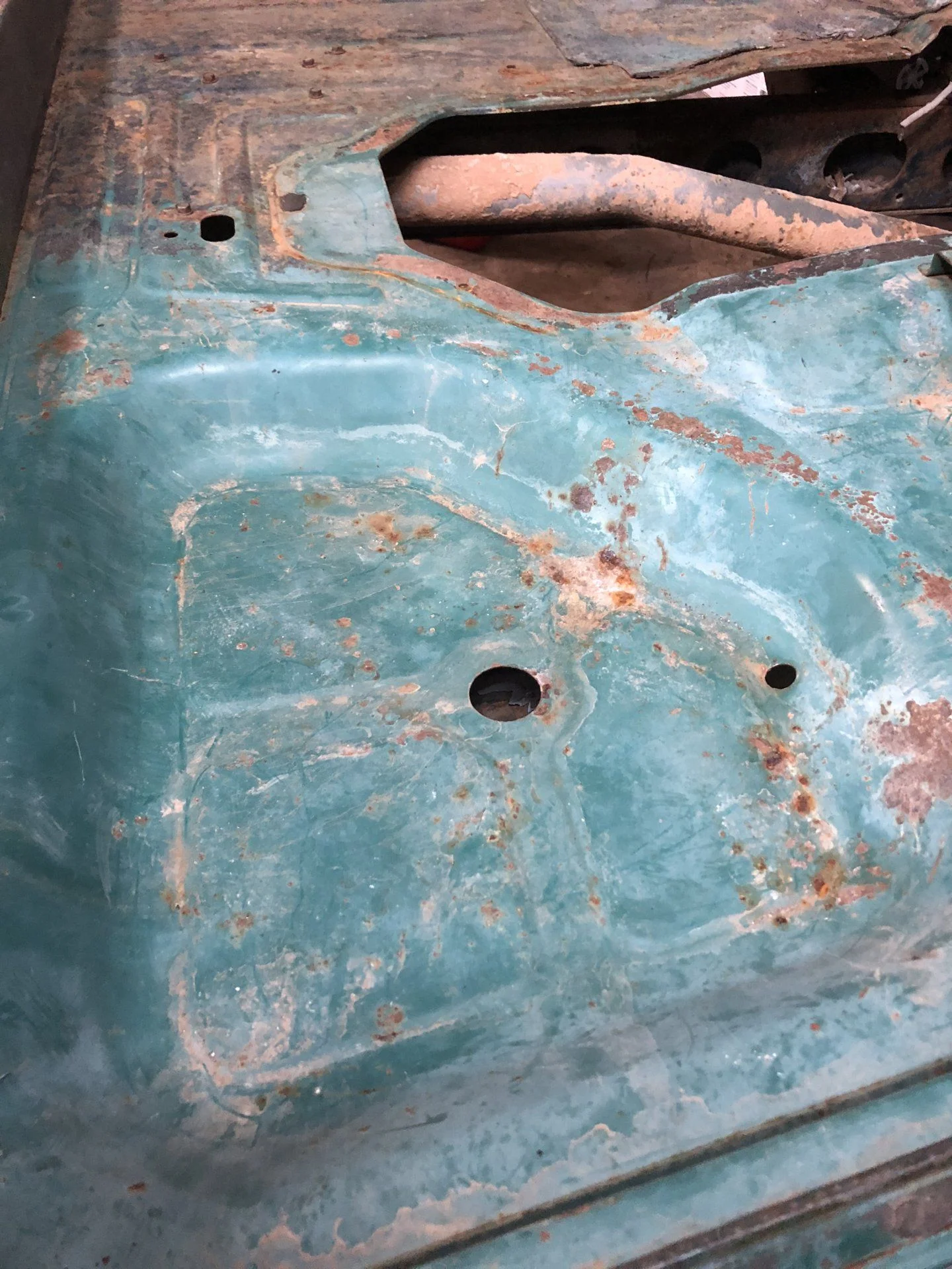

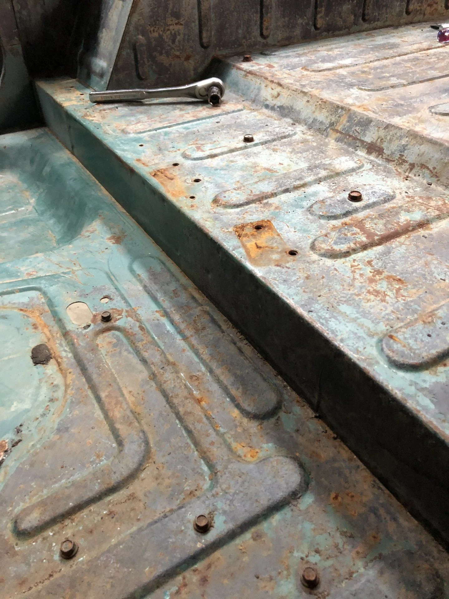

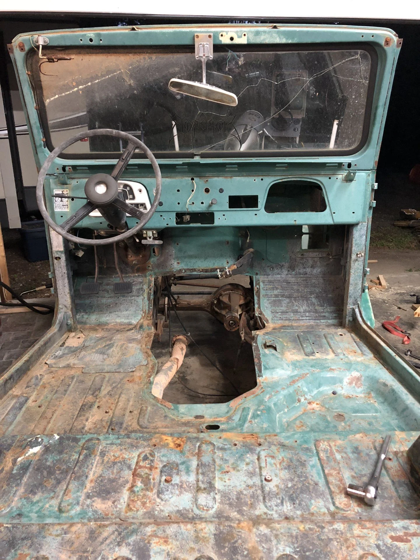

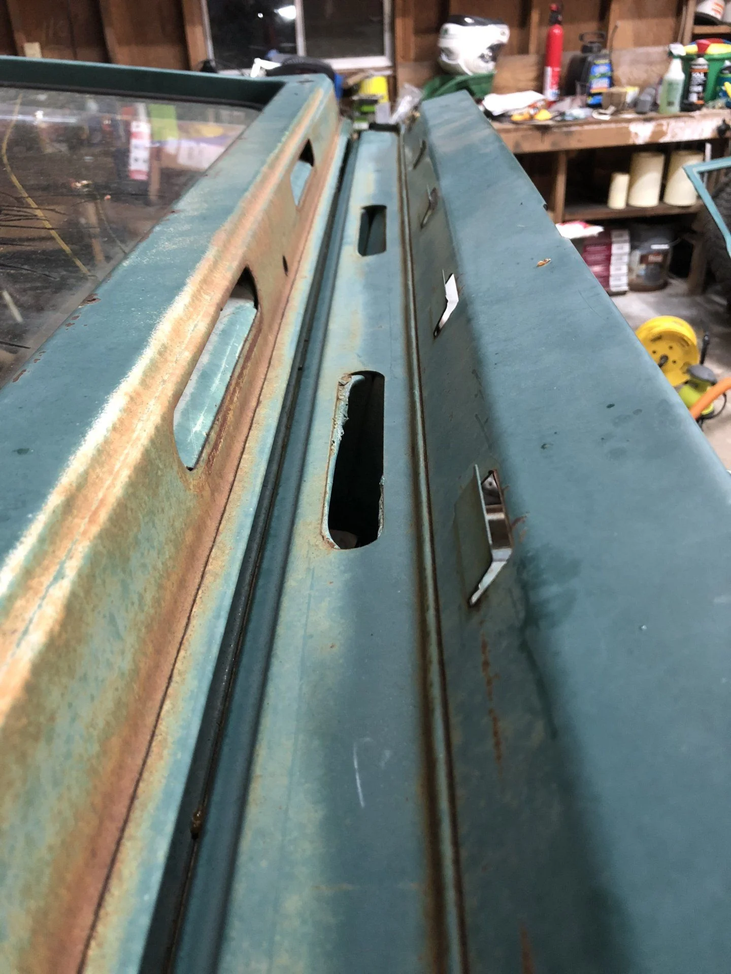

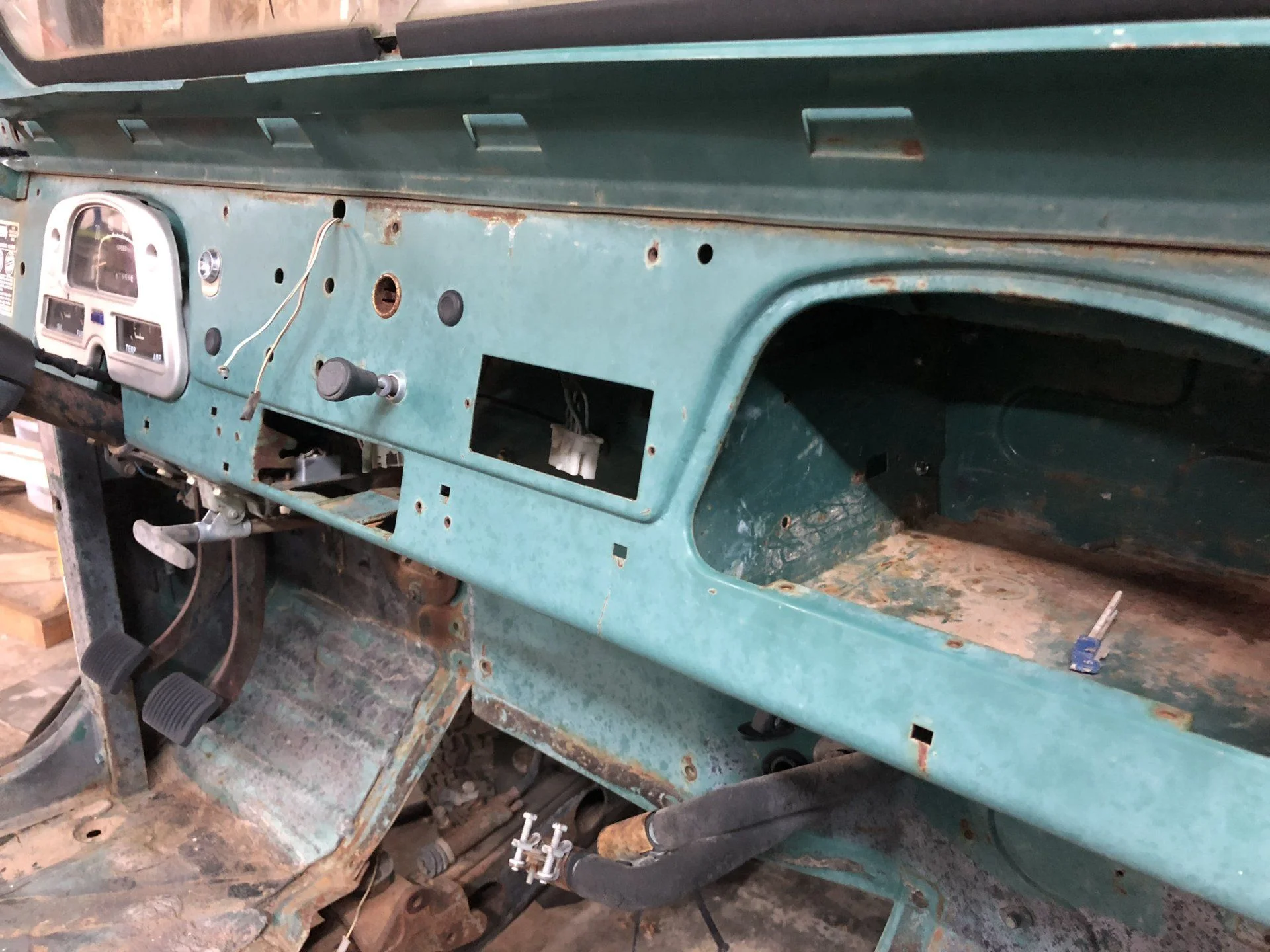

Spent some time last week pulling things apart. Progress is slow, but on the plus side, sitting outside in the PNW for 5 mo this doesn’t seem to have done too much additional damage. I’m glad to have this 40 in my shop for good though.
