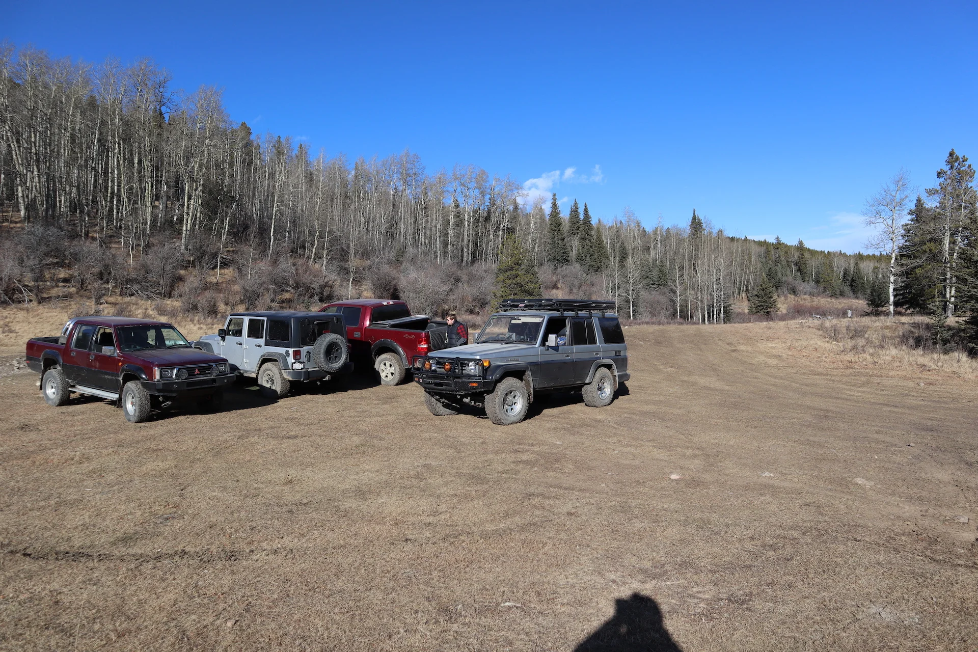

Well, it only took a year, but I finally got this rig out for an ACTUAL trail ride with some buddies. I've been 4wheeling IFS since 1995 so it was definitely a change to have a solid front axle. We didn't do anything super gnarly, and of course I got zero pics of the few cool spots, but it was nice to get out and see what she could do. I still need a lot more seat time to get used to the gearing, the corners, and the approach/departure, but it really was a great day. I loaded it down with all my gear including water, so I could get a realistic feel for how it was going to work. (still waiting on longer shackles to level up the rear, so that will definitely help with departure).
Wheeling a diesel without boost is also going to take some getting used to. 😂 But in some ways its actually easier.
Only dropped the PSI to 22 (hardly aired down at all) but even at that level, the ride was pretty comfortable. The suspension seats helped immensely. There was one hill that I've done in previous rigs that I only got halfway up before I started to bounce and dig on the loose gravel. Likely poor gear choice, combined with a lighter front end (levelling the back end should help), but overall she plodded through wherever I pointed the wheels.
Down the road a locker would be excellent. But for its inital 4wd run, I was super happy...
Here's a vid capture from my buddy driving behind me... my other buddy and I were seeing how slow we could go without stalling... LOL.

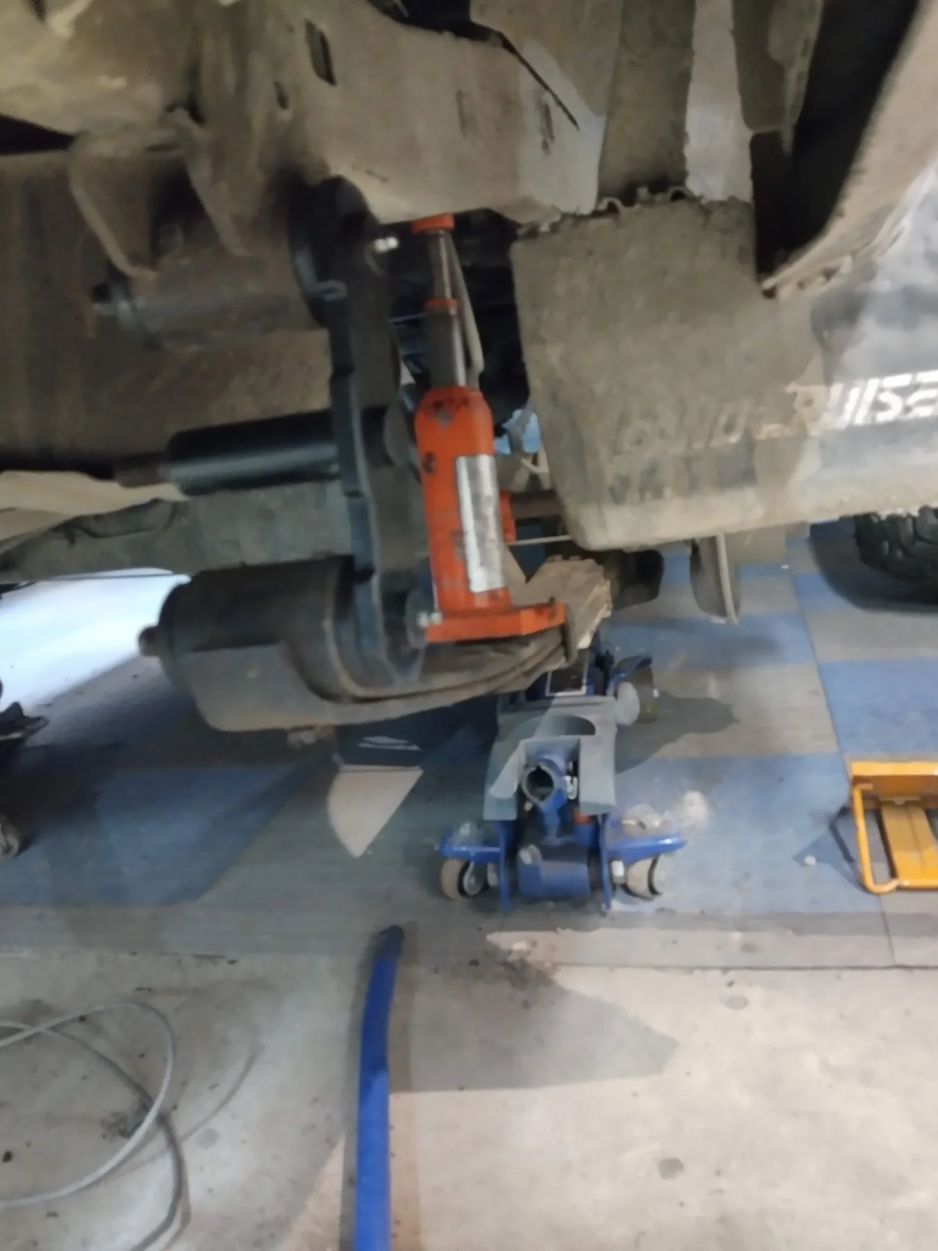

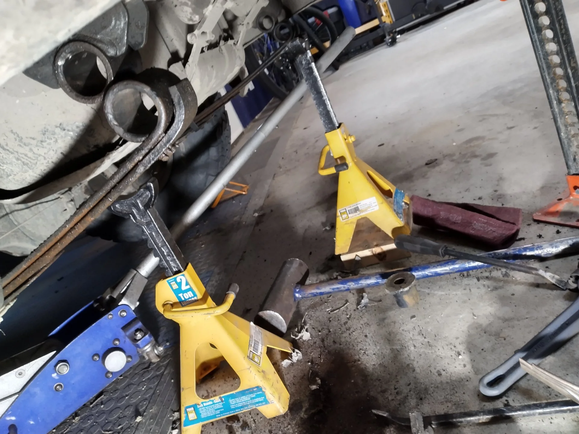

So while I was waiting for my resistor to arrive, I figured I'd install my new extended shackles, to level up the rear. Yeah... Now my truck is down again. Arggg
Had OMESB1 bushings on hand, and spent half the afternoon knocking out the old ones (there was a drill involved, along with BigBertha the sledgehammer, who usually only comes out for special occasions). Cleaned everything up, started greasing the new bushings, when I realized they were too small. My bushings appear to be OEM, or something close. Spring eye is 40mm, but my ARB bushes are 35mm, so no go. Now I have no attached spring on one side, and am waiting for OEM bushes from overseas.
Yes I know this counts as a JDM Journey, but honestly, wouldn't it be nice if plans went to plan now and then?
It's nice to see all those different brands getting along so nicely on a backroad adventure! 😜
Sorry to hear about the bushing woes my friend, I also had a heck of a time getting the 19yr old bushings out of mine when I was installing the lift! Sheesh!!
Thanks buddy. Can't always go by what the PO tells you, right? Since I had to ship the bushings, I also tacked on a couple of filters. With winter coming, an extra spare FF is never a bad idea.
My resistor is still floating around LAX somewhere, so I'd have to wait regardless. Remains to be seen whether she'll fit OUT of the garage once the back is levelled. :cool: This just forces me to take my time and be more thorough with getting everything cleaned up thoroughly.

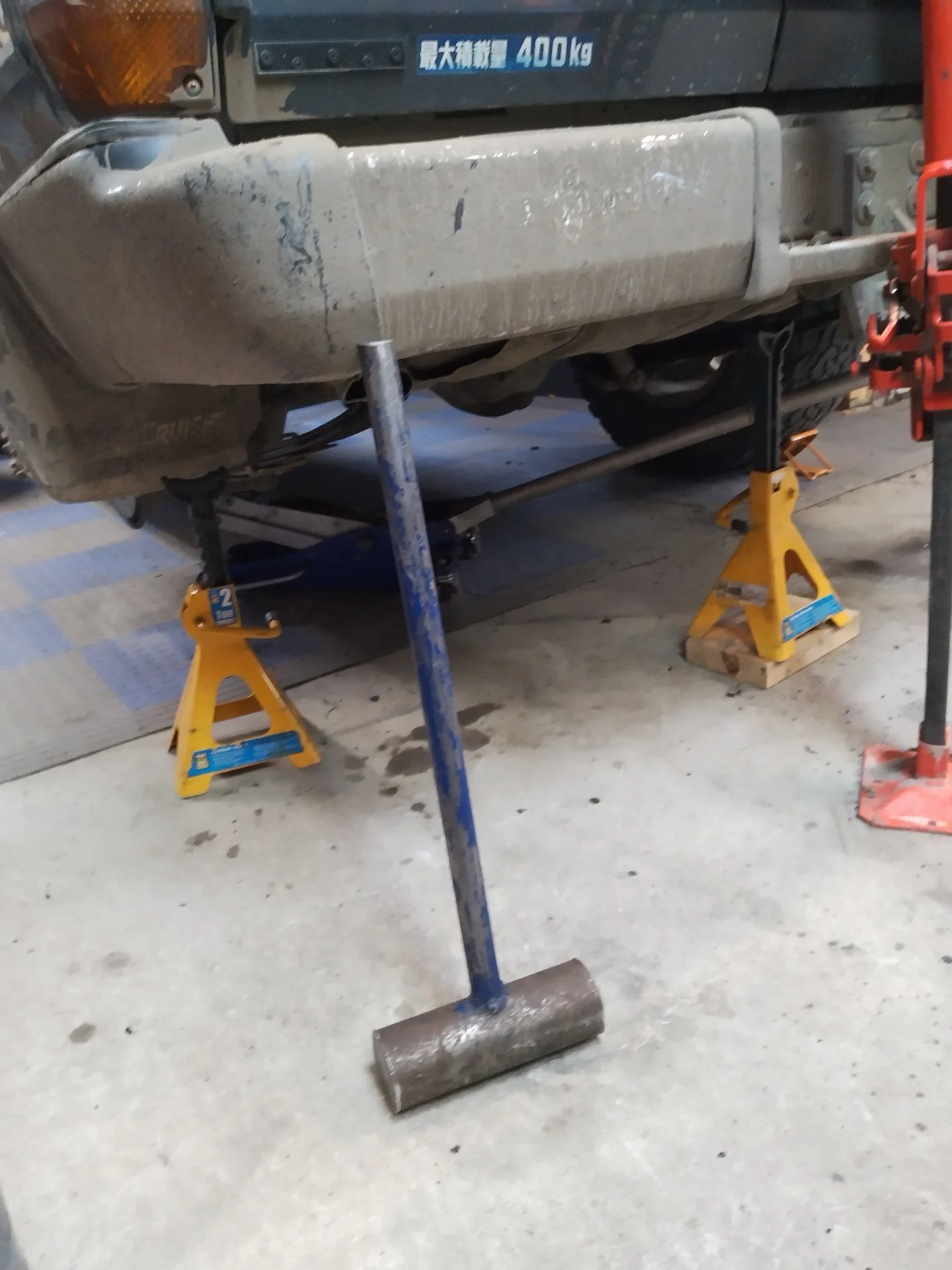

In the meantime, I still have to get the other side apart. Sigh. Big Bertha will be happy to be called upon again...
Big Bertha indeed got the nod for round two. She's a 14 pound sledge (incl solid steel handle) that my brother fabbed up for me years ago.
Some pounding got it moving. Then I Swiss cheesed the bushings. Finally I cut the shackle in half so I could twist each end out one at a time. I know heat would've helped but my Tiger torch crapped out. Need to get a new one...
In any event, both sides are now out, spring eyes are cleaned up, and ready for new (greasable) shackles and bushings. The old pins were pretty rusty, and not greasable like the fronts, so I'm hoping to get a little more travel from the rear leafs when this is complete? Plus another inch under the fuel tank...

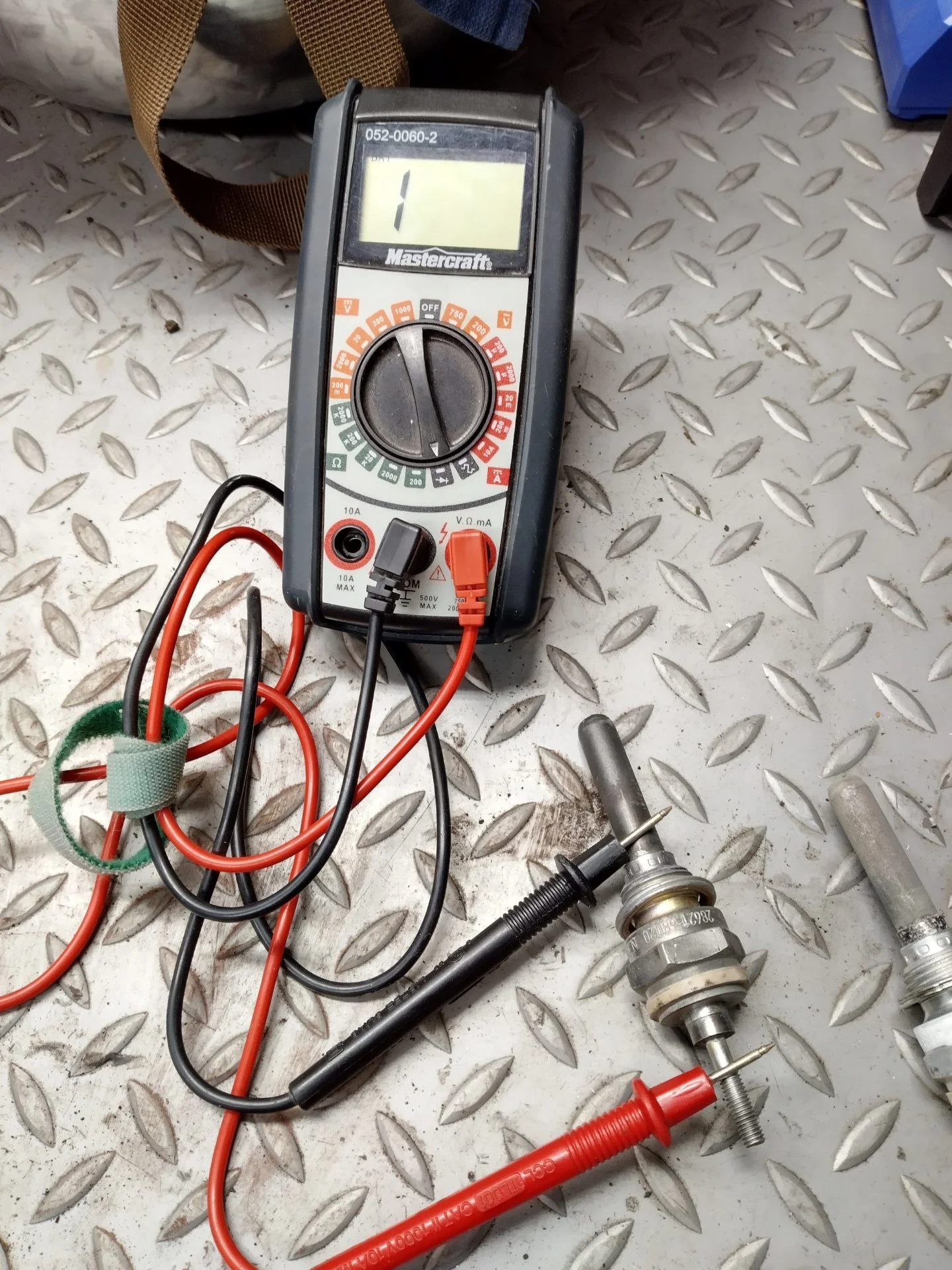

If you look back a month or so, you'll have read about my secondary glow system being inop, and my theory and diagnostics leading to the resistor in the intake mani...
Today it was time to cross my fingers and put my theory to the test. To delay a little, I tested both for continuity, as per fsm. New one passed. Old one didn't. So far so good...
Guess there was no more excuses not to install it?
Bolted it up (24mm socket)… put terminals back on... And turned the key.
Glow light on. Glow light off, start it up, small puff, and then smoooooooth! Secondary glow FTW! No more billows of white smoke. We are back to a proper 24v start again! Woohoo!

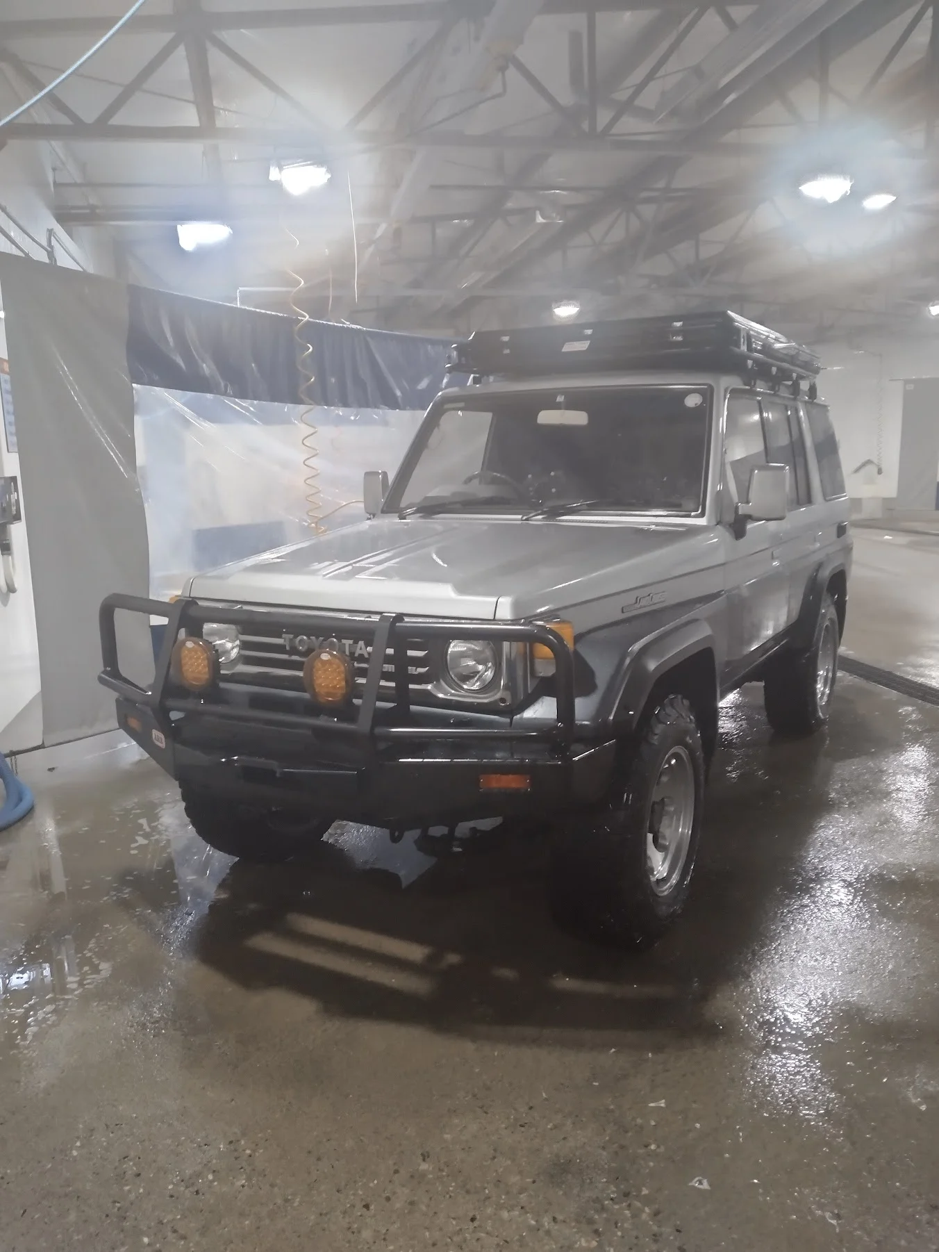

Since my last time driving this rig was early November, my first stop was the carwash, to rid her of all the accumulated mud...
I might discern a little more flex out of the rear springs, but it could just be "wanna be" from the butt dyno? Either way, she's now sitting level, and I can move back to setting up my cargo area.
Oh wait. When I brought her home from the car wash and shut her off, the stereo stayed on. With no key. Arggg. Guess I need to haul dash apart? I used the mystery converter beside the glove box to power it originally, and it worked properly until last night. (By properly I mean red/yellow power and memory did the things they were supposed to do. Until now...)
The converter fixed itself. Lol. Dunno what else to say about that?

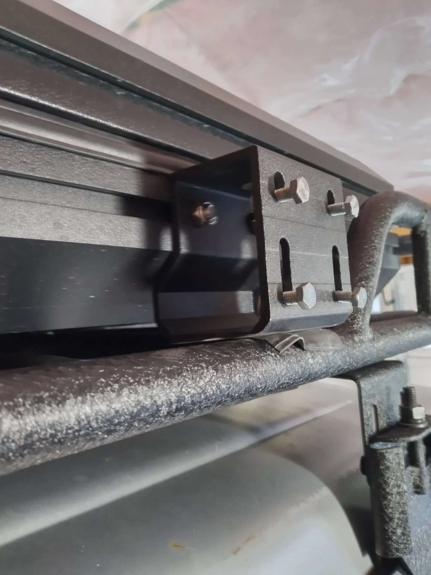

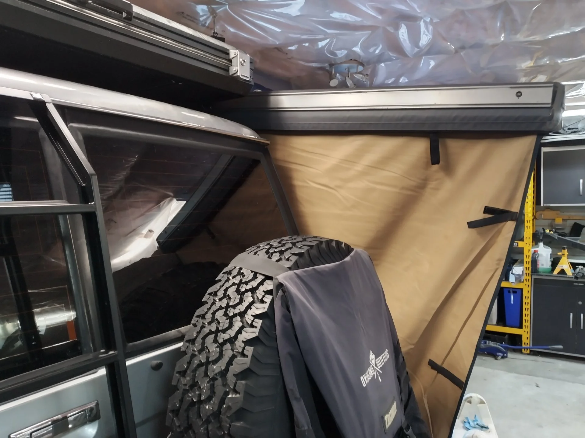

Today I started work (finally) on attaching my awning to the t-track on my tent.
I used some very trick awning brackets from hitch-web. I've been planning on getting these since early fall when I got the tent, but man alive they're pricey.
I tried to find an alternative but there just wasn't really anything as simple/ effective. So finally I bit the bullet and ordered them.
Doing it by myself wasn't a lot of fun but some wd40 on the awning grooves helped a little.
I don't have a pic out of the garage yet, but it went on very securely, and although the limited space meant I could only turn the fixing nuts 1/16 of a turn every time, after a while I got the bolts secured.
One bracket was really close to the rack as you can see in the pic, so I had to clearance the bottom a little.
Ultimately these brackets are necessary to allow enough clearance for the strut on the side of the tent...

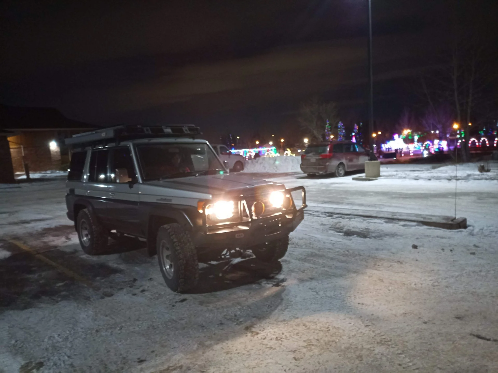

Took the old girl to work yesterday in the snow, ice, etc. So much fun! Nice to be able to start it (with no plug in installed) and not have a smokeshow that lasts for ages!
Really is "driving" when there are no electronic nannies helping out. Love it!!

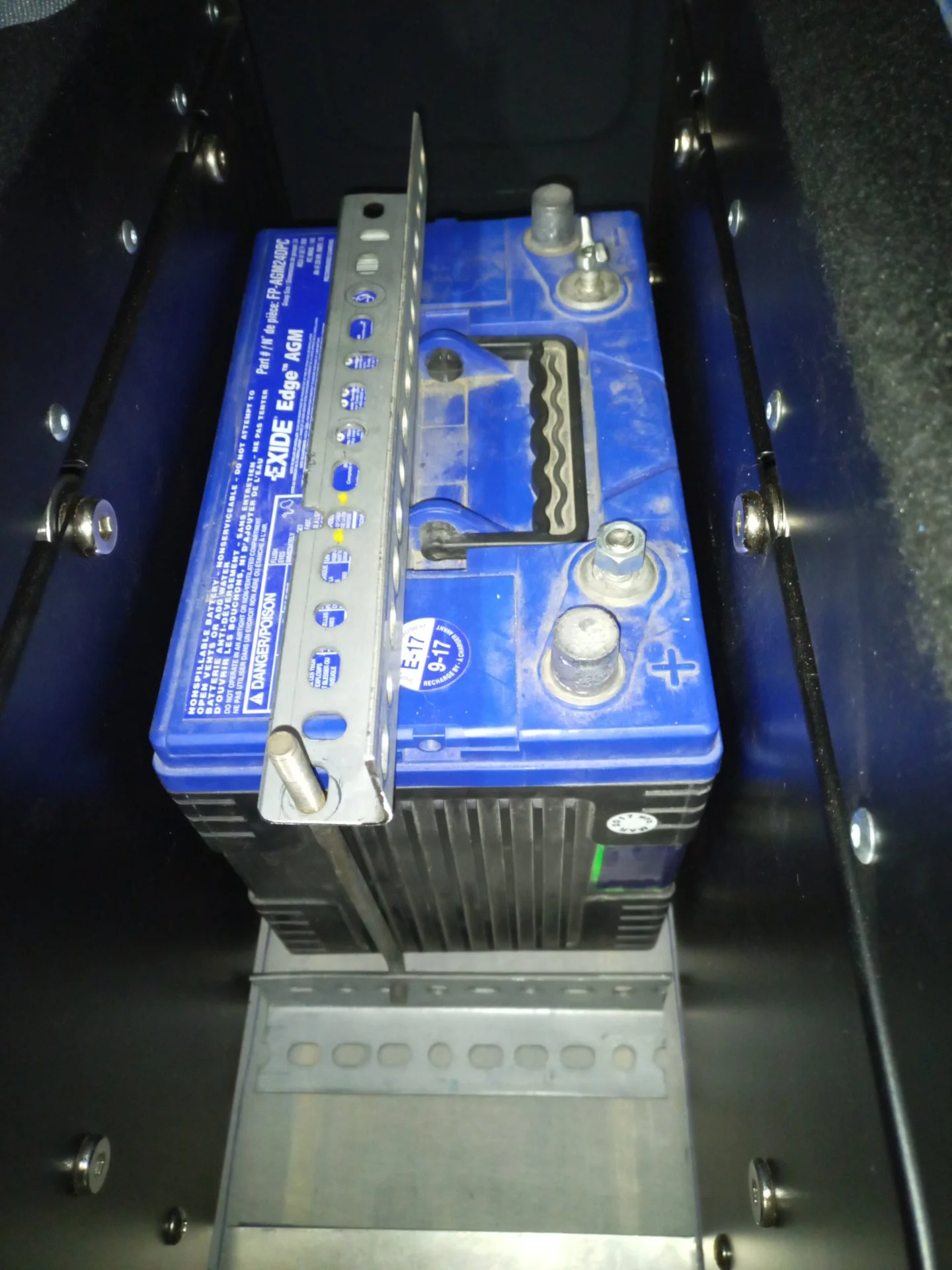

Battery tie down is getting closer. I'll put a bar across perpendicularly to keep the top bracket from sliding sideways. Not ideal to have a tie down going lengthwise, but no room to go width wise in this spot.
Perhaps I'll make the tie down out of wood instead. We'll see. For now, at least I've got a way to keep it secure. There is a raised portion on top of the battery that will keep the bracket from sliding. I'll also be lining the battery tunnel with rubber matting.
Battery welding is fun and all. But not in the back of your truck. :cool:

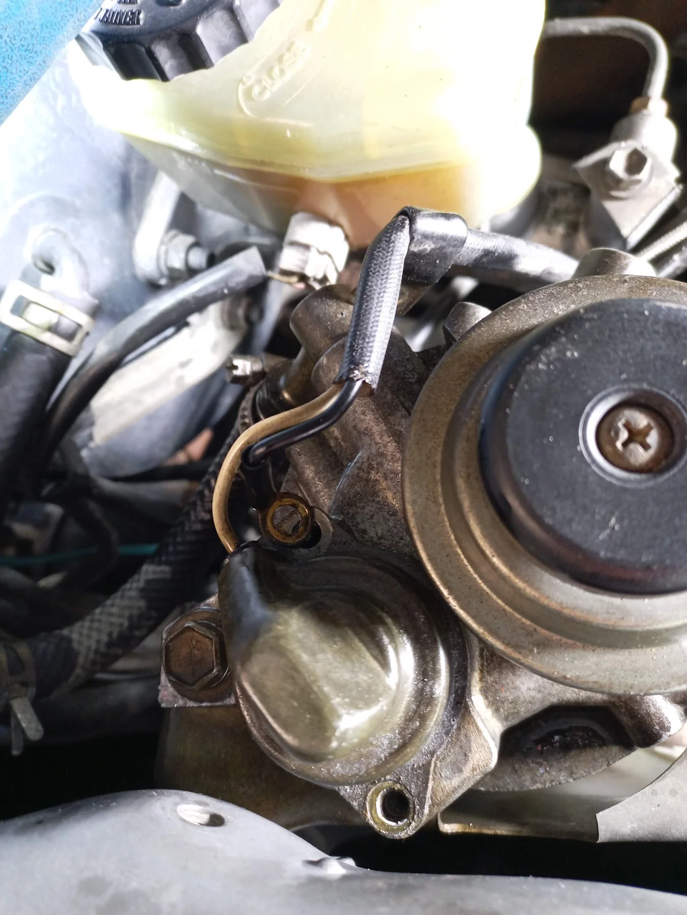

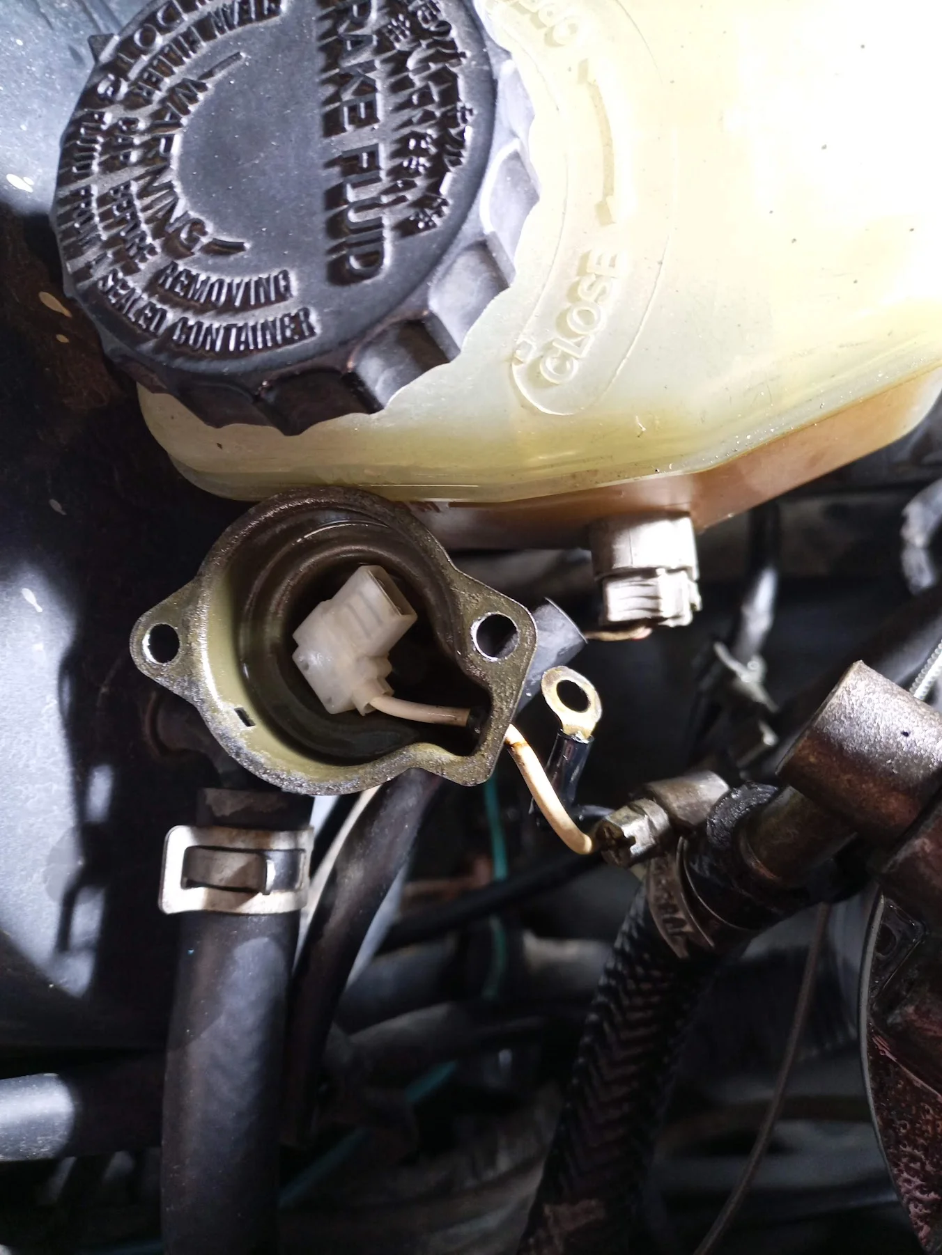

If you've been following this thread (and really, why would you? :rofl: ) then you might remember a few weeks back I was driving her home from work, and appeared to experience a freeze-up. My theory was that the early Oct fuel I was still running was likely summer diesel, and temps had dropped, so I was getting gelling at the filter.
Fast forward to yesterday (after I got fuel AND added some diesel 911) I decided to swap the (pretty new) filter, just to ensure I wasn't going to have more issues. Meanwhile, our temps have plunged into the -30 degree celsius and below mark, and although I put the heat on in my garage, I only managed to get it to 10C, near the heater.
Anyways, finished the filter change. Started it up. Ran like crap. Pumped the primer, took it for a drive, white smoke, still ran like crap. Came home, pumped the primer some more, and lo and behold: MOHR LEAKAGE. But not just at the filter to housing o-ring. Nope, at the bottom sensor seal too. GREAT.
Today I removed, reinstalled and tightened everything. Pumped it back up. Seemed to be leak free? Whew. Started it up. So far so good. Went to go for a drive, got halfway around my loop and it started losing power again almost like it was freezing up. See a pattern here? Limped it home where it barely idled in the garage, with lots of white smoke. Pumped the primer which seemed to bring the idle up, and watched for leaks as I did so.

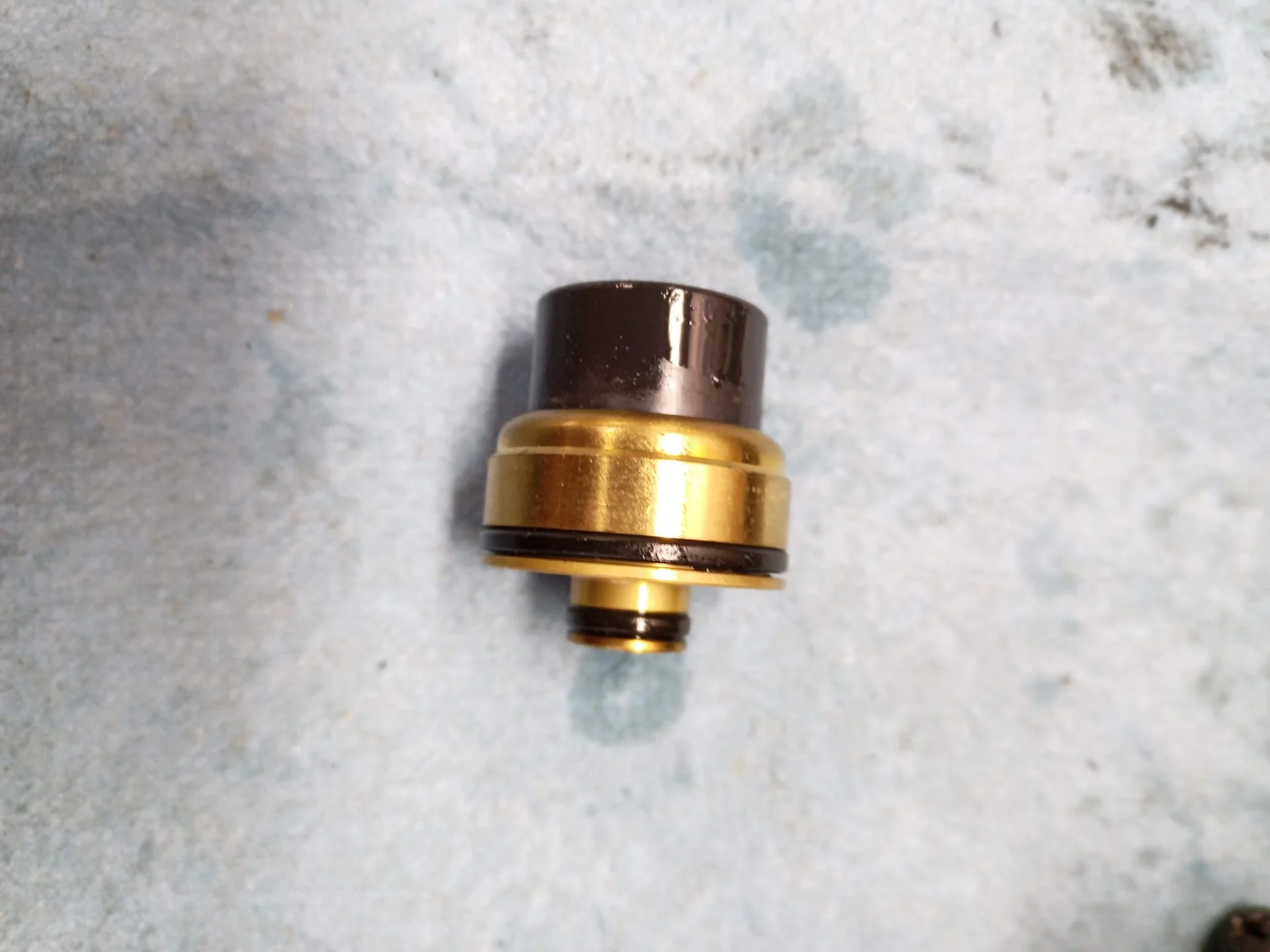

Wait a minute. Bubbbles? At the edge of fuel heater element housing.
CURSES! I just found my air/fuel leak. Arggg. Looked at new orings for the heating element, but it seems like it might even be leaking where the plastic meets the metal housing?
As much as I'd like to retain the heater, I'd prefer to keep fuel PRESSURE, and the heater housing is NOLA, so I ordered the one without the heater (23301-17050) as well as a new o-ring for the water drain (23344-54010) and a new fuel filter to IP fuel hose (95332-10040) just in case.
Cold weather quickly points out the weak points of your fuel system, even as it frustrates you to the point of madness.
