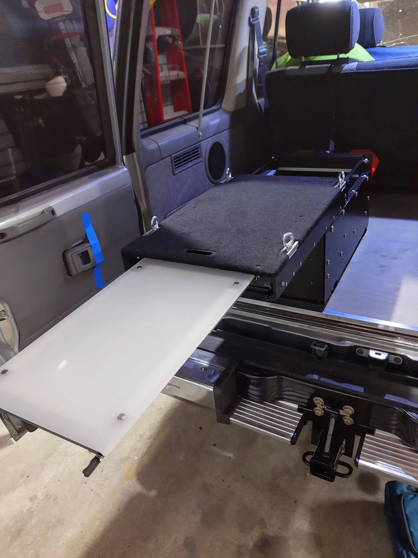

My overland vehicle systems drawer came the other day, so a test fit was in order...
Has a sliding top and a slide out work surface underneath, as well as the drawer itself. It appears to fit my needs, so now another is on the way!

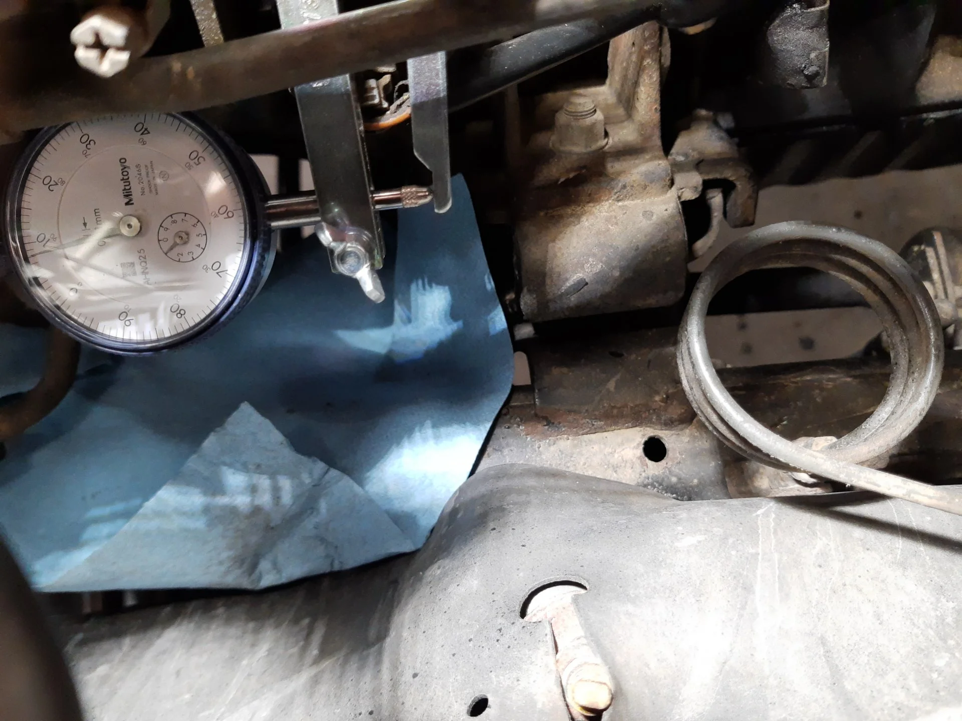

I'm not sure what the sweet spot is, but apparently 1.09 might be a bit advanced for this rig. Slightly bumpy on start up and lots of fog until it makes some heat. I'm going to go back in and retard it a little to see what makes it happy.

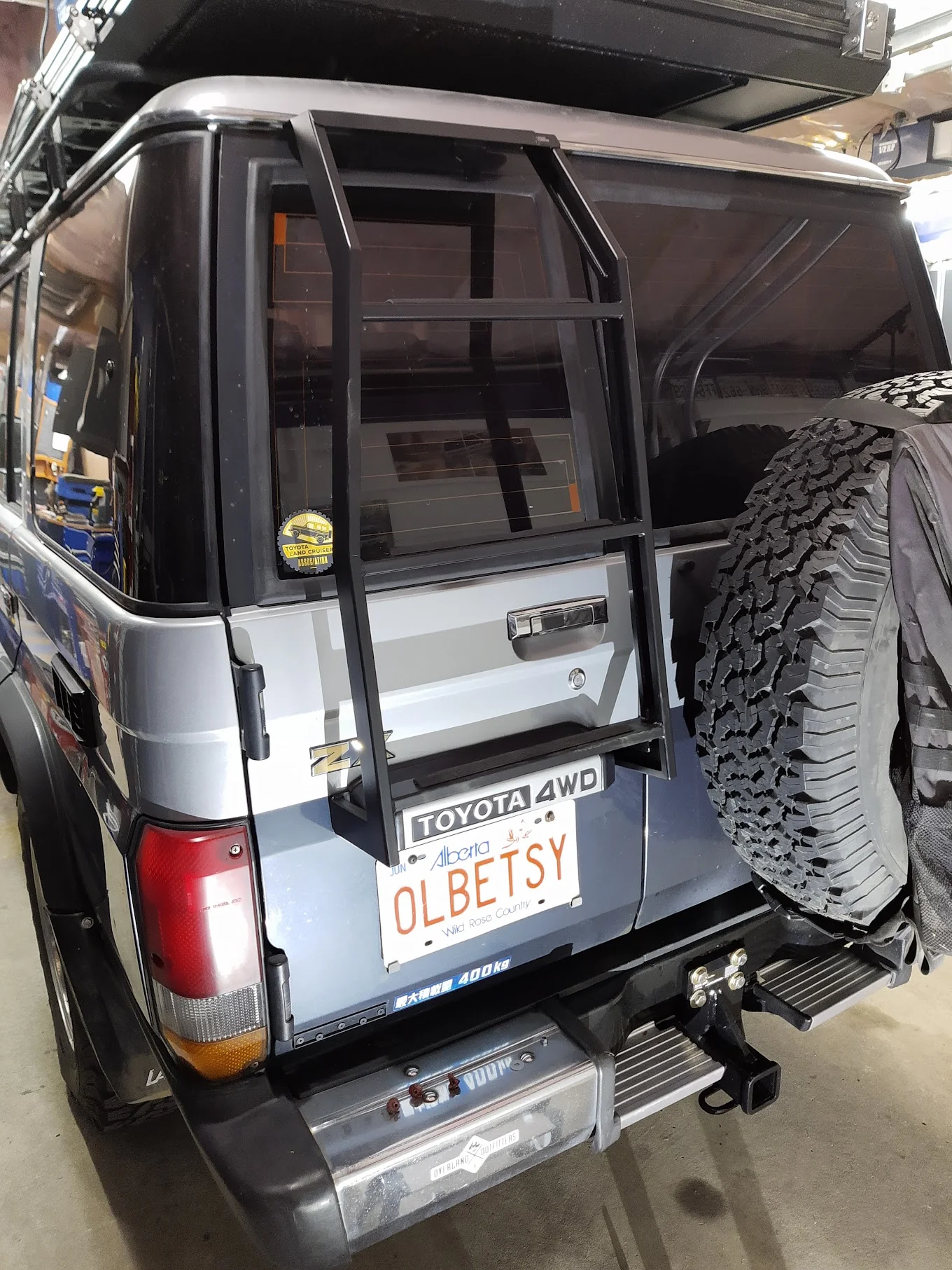

Meanwhile, more work out back. After waiting three weeks for the correct ladder (they sent me the troopy ladder at first), I now have the one for the 76. It was the right one, but fitment was... meh. The holes sat a few mm too high to line up with the existing back door holes. What should've been a quick bolt on, turned into enlarging the holes, tweaking the ladder, etc until ultimately it stretched out to span the distance. I can't imagine the 76 door is any different dimensionally than the 77, but anyway. It finally went on.

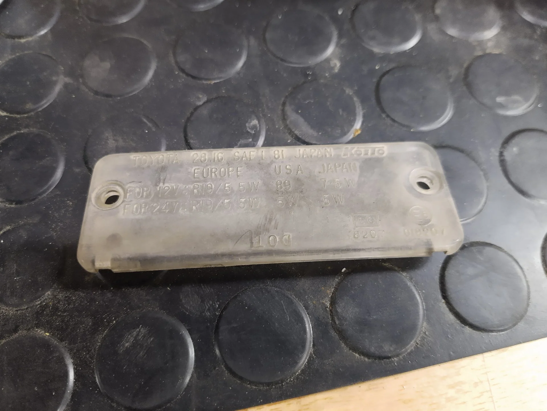

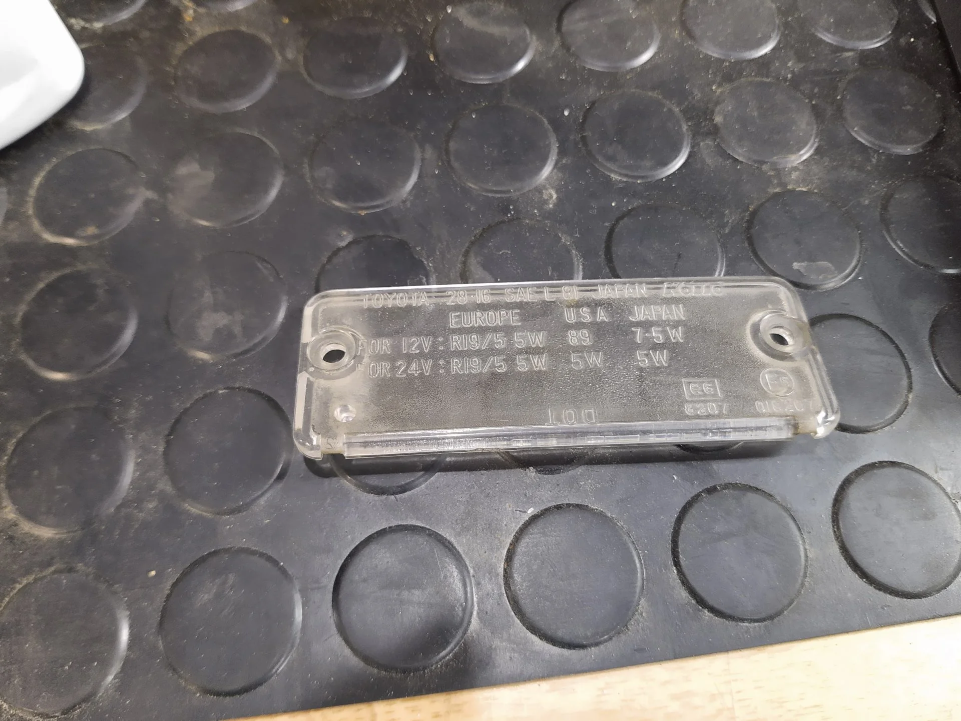

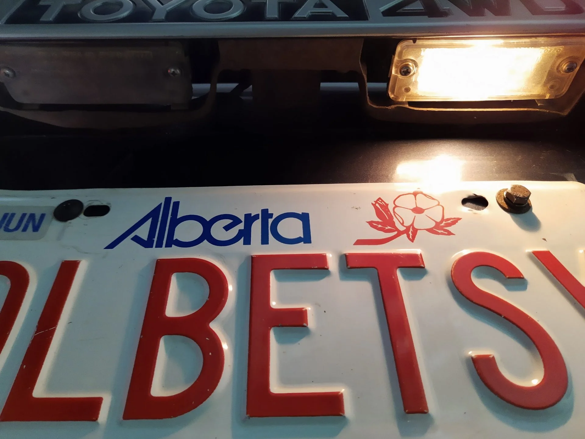

Replaced some broken door card clips, went to button it all back up, and ... oh. Wait. No license plate lights? Did I somehow mess up the wiring in the process, or were the bulbs gone and I didn't notice? Confirmed the circuit was good with my voltmeter, and then started taking more things apart.
Bulbs were blown. And of course the the lenses were cloudy. Couldn't put those back in place... sigh.
Out came the plastic polish. There... that's better:
One more to go.

1.08 seemed a better fit. I did have to pump the fuel primer a bit. Seems like air gets into the pump via the bolt you remove to insert the timing gauge tool?
But once the air was purged, things were better. It doesn't start on half a turn like it did when I first got it, but once it's going it runs so much better. Minimal black smoke, much more usable power band.

I got my second drawer and have been playing around with interior organization some more. Fun stuff! Also got a net for the roof, where my sleeping bag can live and not get in the way.
I did decide to put the drawers in with a gap in between, in order to store water at the centerline. Pics once I have a few more things settled, but a weekend trip out seemed to favour this setup.

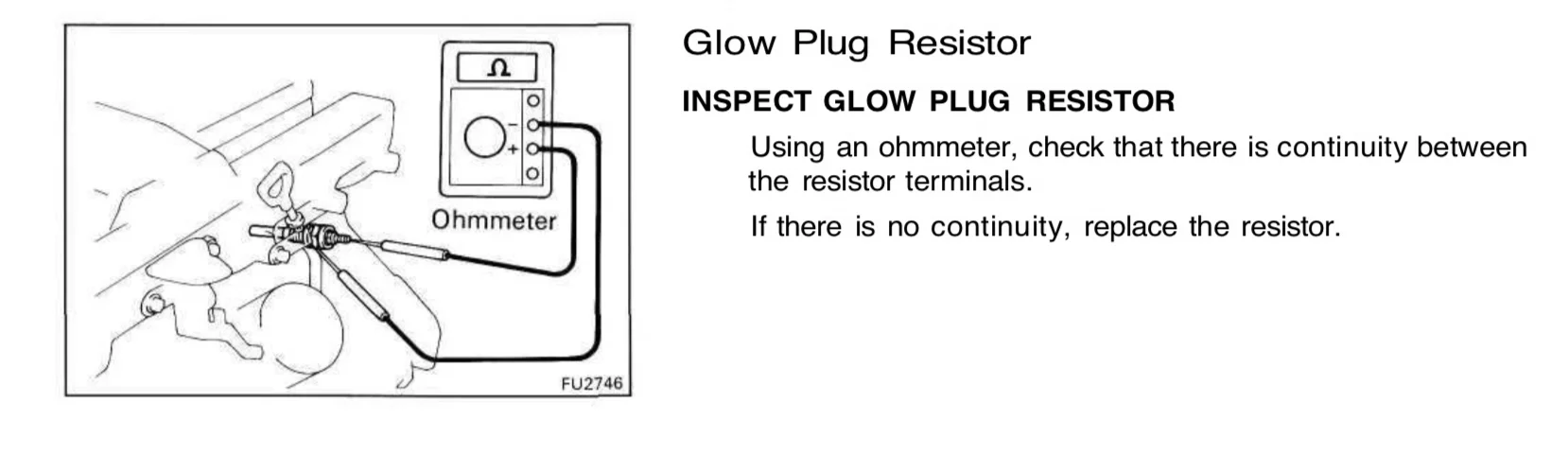

As the weather has crept toward winter, the white smoke on start up has gotten worse. It started as soon as I began monkeying with the IP timing, so I assumed it was related. Turns out it may just be an unhappy coincidence. No amount of messing with timing makes any difference, so I've gone to the glow system, which any sane person would've started with...

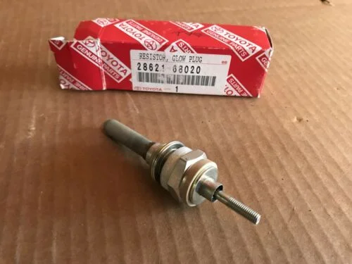

I've already posted in the 24v section, but the resistor is a mythical part that not too many seem to have answers on. In a nutshell, I get 22.4v to the glowplugs on initial start and then within a few seconds it goes to zero and does not come back up, so it would seem no secondary glow, and the white smoke billows. I ran through the factory checks, and my test of the "resistor" showed ZERO continuity between contacts, when the FSM says there should be. I'm going to assume that said resistor should normally allow a portion of juice through after the initial full burst of the primary circuit. No continuity seems to say no secondary glow?
Enter the world supply chain cluster-cluck.
This guy is sold out all over...
So I appear to be down and out or at least a gross polluter until I can source this. :cry:
(edited to add a capture of the service manual check of the resistor)

By the way, for anyone who reads this in future, I had a hope of maybe subbing in the resistor from the 60 Series, but I just managed to come up with the specs, and it doesn't appear to be a match. Close but...
The 70 Series resistor, part no 28621-68020 is stamped as 7.7 volts.
The 60 Series resistor, part no 28621-64011 is stamped as 5.9 volts.
Other than this, they look identical in pics I've been able to see, but not internally the same. How much difference this would make is not my area of expertise, but in the interest of keeping it OEM, I won't be going down this road.
Here's a shot of the little troublemaker, allegedly causing me so much smoke? I rechecked continuity out of the truck. Still NADA...

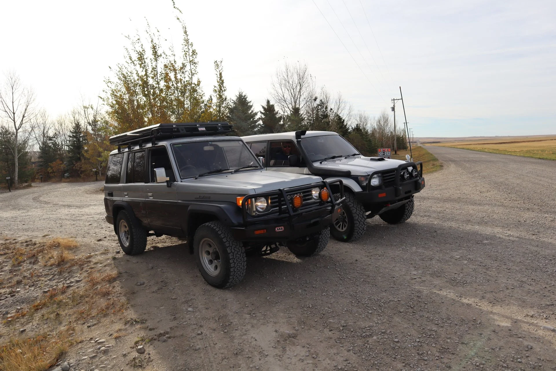

Betsy 10 is reminiscent of B5, except for the extra cylinders, solid front axle, and a few other things LOL. The guy I sold her to became a buddy, and we actually went out camping last weekend. So here, for the first time, are Betsy 5 and Betsy 10, doing stuff...
