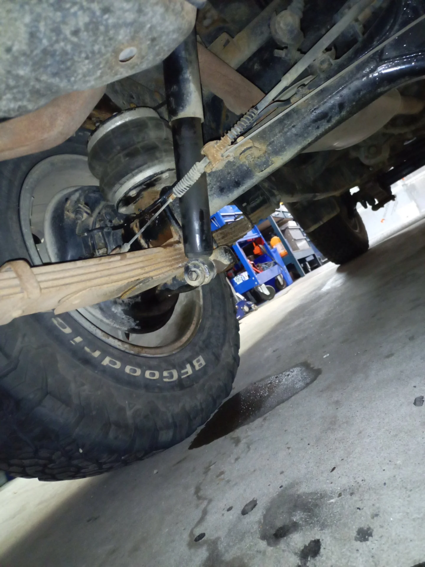

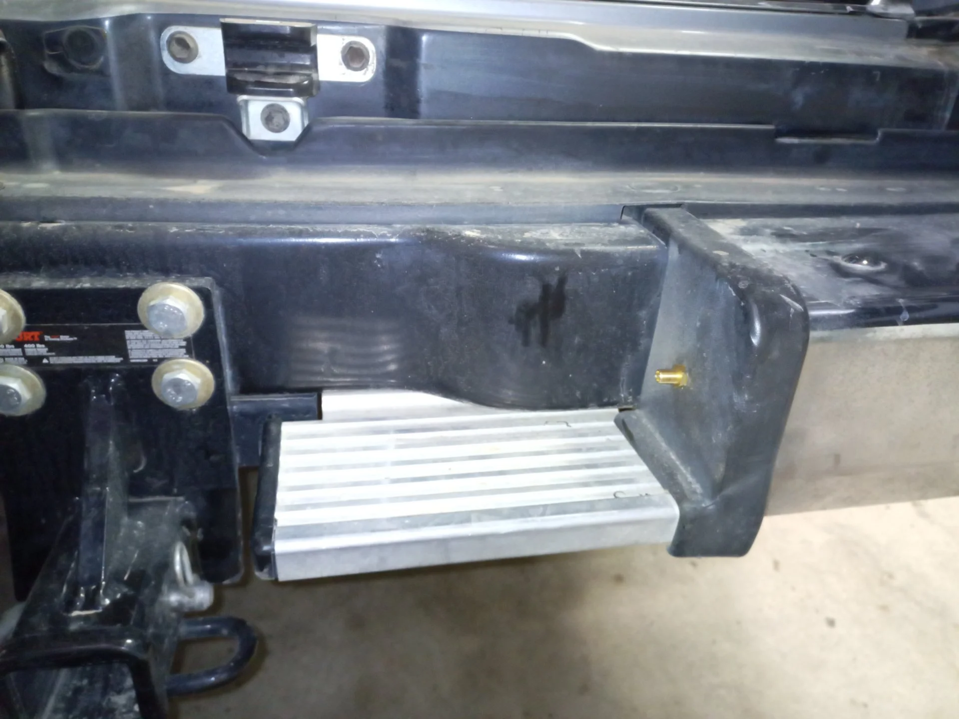

My BOSS airbags are now installed. Here are a few terrible pics...
i tee-ed them together and currently have a single valve in the side of my plastic inner bumper cap.
They are capable of levelling the truck (loaded) without having too much pressure. I'll need to do some experimentation to find the sweet spot, for both load carrying and ride quality, but for now I was able to easily bring up the rear to match the front, despite having most of my gear onboard.
Eventually it'd be nice to have the option of airing up and down from inside the cab...
A few install notes for the BOSS airbags on a 70 series...
Because I didn't have a lot of room, I deflated the bags and close the valve to make them as compact as possible. Then I put a floor jack under the leaf spring u-bolt base plate (after cracking loose those nuts! OMG they were tight!). Finally, I put my hi-lift under my hitch receiver, so I could raise the body away from the leaf springs a bit.
These airbags clamp under the rounded part of the u-bolt on top of the axle, which means you need to loosen the u-bolts. On top at the frame side, they bolt in in place of the bumpstops. My bumpstop rubbers were already missing in action, so it was simply a matter of unbolting the left-over plates. Wait, did I say "simple"? Yeah, not so much. One side unbolted with some liberal penetrating oil, but on the other side BOTH bolts broke off in situ, leaving me hours of quality time with a drill, various bits, and a thread tap. Once that was sorted, I put the bags in place, slowly let the air IN so they'd fill the space, then bolted the uppers to the frame. Finally, I tightened up the u-bolts and ran the air lines. Lots of faffery to get them there, but it'll be obvious if you ever tackle this job...
Note: The LHS unit fits right in, no issues. The RHS had some interference from the diff breather fitting. It was too tall. I ended up removing it, and will be ordering a smaller right angle 1/8" NPT fitting to replace it. I also shortened the tubing that clamps to the axle just a bit, so the breather hole wouldn't be covered.

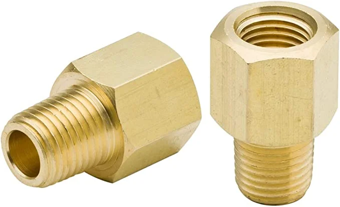

Also, these bags came with a simple 1/8NPT to valve stem fitting. I certainly didn't want to crawl under there with an airline every time I wanted to fill or empty them, so I bought a 1/8 to 1/4 adapter, and an airline kit, with tees and valves.
Where the airline came close to the exhaust, I sleeved it. Both lines join in front of the fuel tank, and for now one schrader valve comes through the bumper for adjustment.
One last note on the airbags - mine were purchased used, and were originally on a 60 series, which also fits (almost) perfectly on the 70 series. This 'Mud thread was very helpful in helping me decide to go ahead... Note that the OP used a different type of bag early in the thread, and later switched to the type I put in. The thread becomes a clearing house of airbag type installs and questions, and is super helpful.

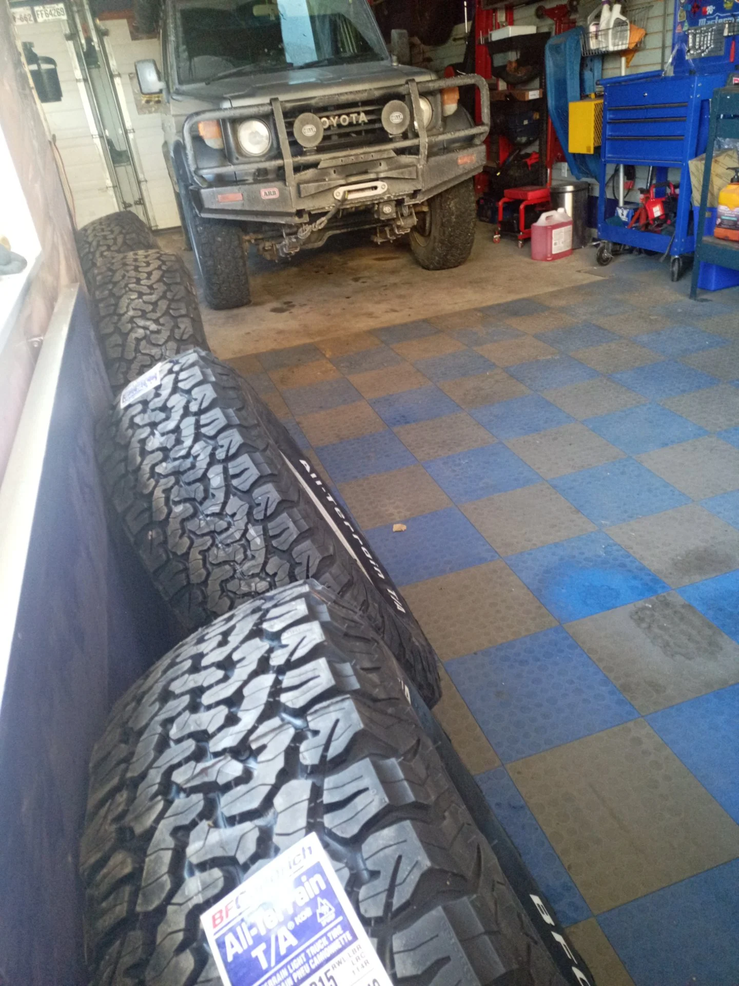

Well, at risk of taking a step back in time (as if I haven't already with this rig) I ordered tires today. But not some fancy 17 or 18 inch with 20 ply sidewalls. Nope.
Fifteens. In quite possibly my favorite size. 33x1050. On my favorite tire: BFG ko2. Load range C.

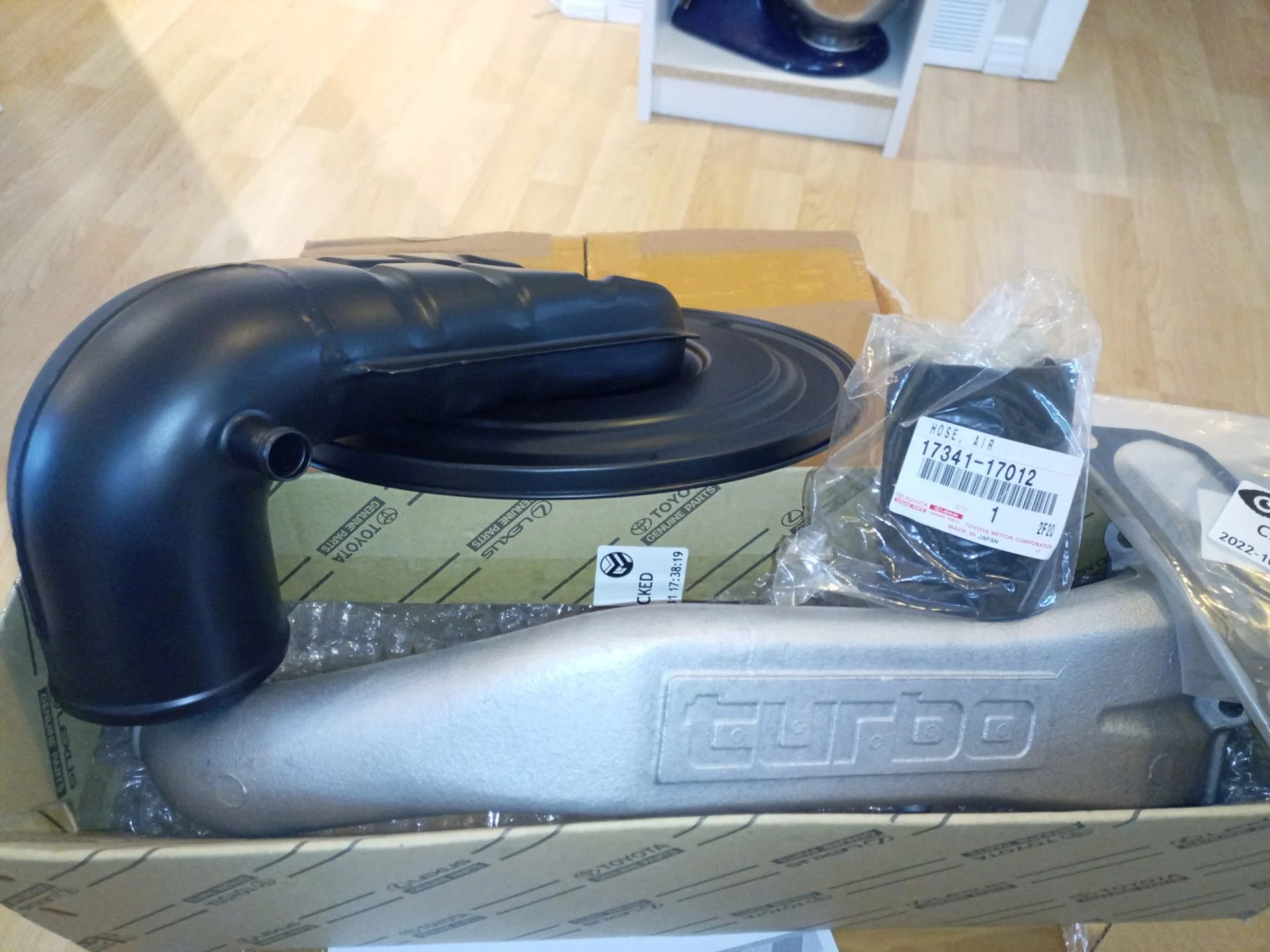

Oh boy. Parts are beginning to arrive for what was originally going to be a "someday, maybe" project.
This is pretty exciting! And the fact that this stuff wasn't a king's ransom for brand new makes it even better.
I'm currently waiting on some oil lines, a manifold adapter flange, and a sump bung from Mitch Simpson at Simpson Offroad engineering. Super nice guy, and I love to support small companies, even if they are across the world from me. Once this package comes, I'm about ready to start getting serious. Maybe over Christmas holidays, if all goes well?
I'll still need a few bits - boost gauge for sure, and likely a few other small pieces?

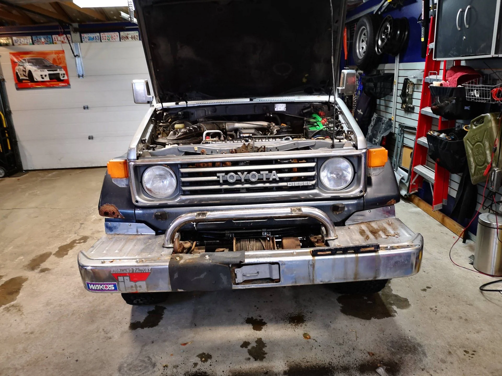

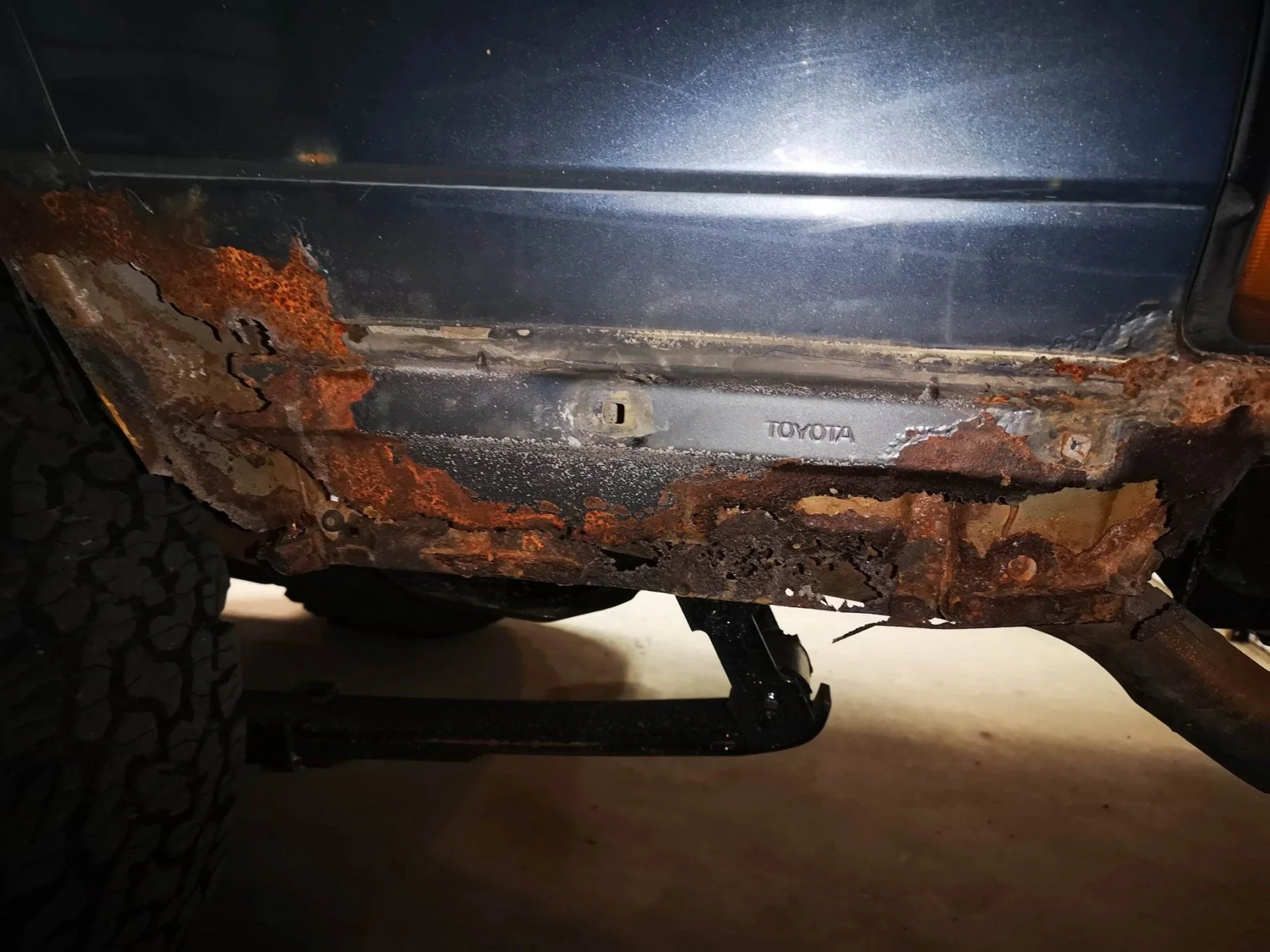

This rig, as I mentioned, has some rust from 30 years of wearing the factory flares. Here's what was under there (flares were pulled before I bought it, so I knew what I was in for)
Front fenders could be repaired I suppose, but they are bolt on, so I've bought new ones. One is now onhand, the other one will be delivered soon (shop I bought them from thought they had a pair, but turned out they had a lot of lefts, no rights). So I'll soon be able to replace these.
The rear quarters are also done for. The LHS is the worst one... rust on the outside and inside panels.
I pulled the bumper endcaps so I could see exactly what I was in for. I'm still shopping around for options here. Landcruisers direct has FULL quarters, but I only need the lowers. Everything else is solid. And shipping to Canada would be pretty pricey on such a large piece. Still investigating possibilities here. Right now I'm thinking patch panels (if I can find them) and a rear bumper from Coastal to wrap around them.
Here's the right side. Much better, in comparison...
This is the only serious rust on the truck, so once I get this sorted, I'll be good to move on.
I put the front porch on it, but OMG I just couldn't stand it! It was there a week, and I had to pull it again. I'll figure out another way to bolt up the PTO...
No offense to those who have and enjoy the factory bumper. Just not for me.
