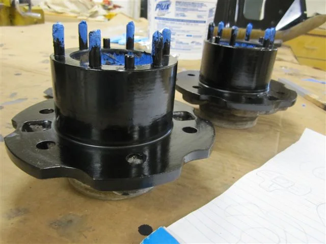

More pics of the axle parts.

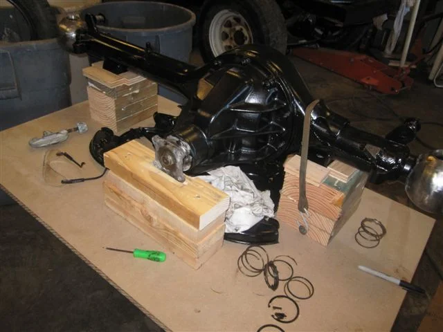

I made a little rack to hold the axle while working on it, and transporting it to the knowledge center of the world. Also TLCA headquarters.

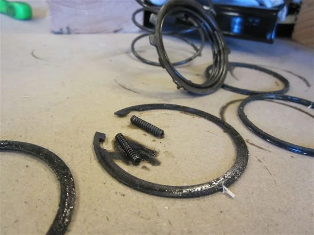

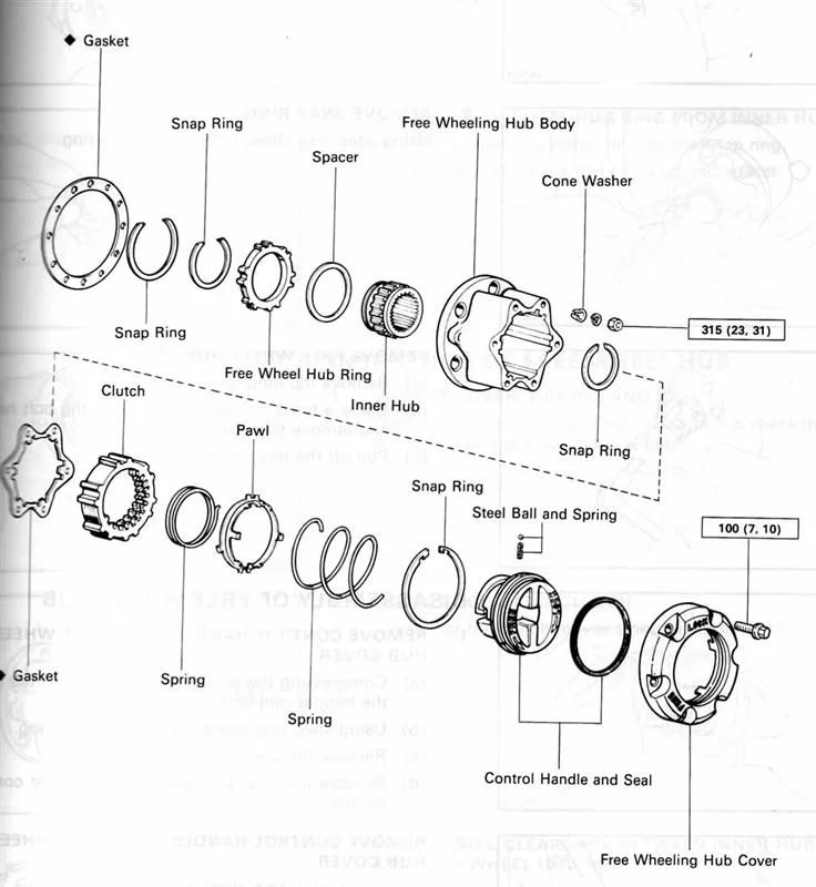

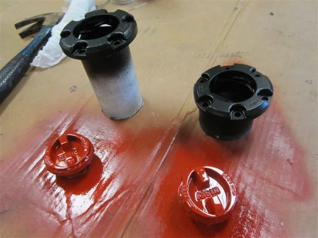

Took apart the axle locks, and painted. Only problem is I think I lost the ball bearing or something that holds it in place. See last pic of the spring that I found on the floor, but I have a feeling I am missing a ball bearing or a short rod or something. It would go on the side of the Red center selector. Anyone know what I should be looking for? If anything? I am hoping it is metal so I can find it with a magnet.
THanks,

Yes, but I lost my balls!
Well, at least they are steel balls
Make sure you replace that o-ring at the same time. Probaby any smallish ballbearing or BB will work depending on size.. that is a detent ball.. If you can compare it to the size of a shot shell # I could probably cut open a shell and get something.

Good idea on the shot for a ball bearing.
I found one of them after a half hour crawling around, so I can size the other one. I do have a set of 6" digital calipers from harbor freight. Worked pretty good.

Oh, on the o-ring. Mine came out as a flat O-ring that was angled, seemed pretty specific. Have you had luck using an standard o-ring?

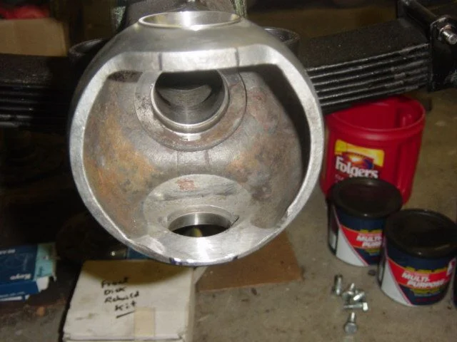

YOu ever get those birfs off the inner shafts? and if so did you test fit them into the bell on the axle? they won't fit. We can grind at my place or you can pre-grind now. On flats of bell on axle.
you can also put your rotors on the wheel bearing assembly.
No, I could not find a short piece of steel tube. I hated to shorten my cheater bar. On the grinding, I will see if I can see a picture on guppy's writeup. If I see a picture, I usually can do it.

grinding
So, it appears that I need to grind the housing, to accept the larger axles, top and bottom. I will take a stab at it.
picture is from 1973Guppy writeup on FAQ.
Kelly
yep, best accomplished with a birf that has no inner shaft attached. we can do here if you have trouble removing inner shaft from birf. just stuff a rag in the inner axle hole, grind top and bottom to fit when it goes in past the flats, birf oriented top and bottom flats with top and bottom flats on housing your golden.
i have spare birfs here if you need
I just had to do that on my 40 so I could fit longfields in it. Pretty easy.

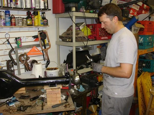

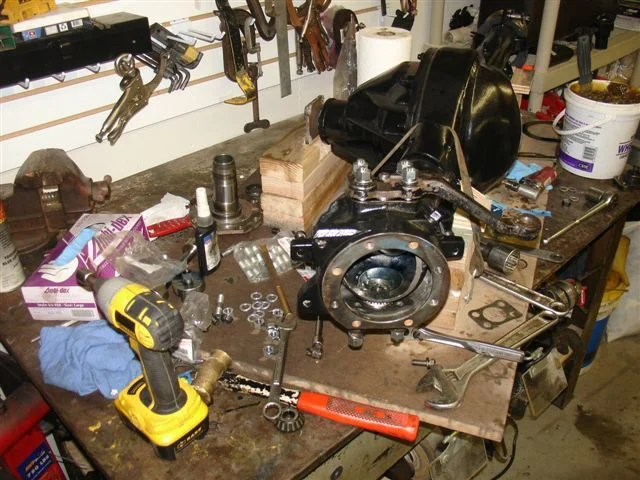

Erik opened his shop up for the axle rebuild (and his parts boxes) and we were able to get the entire axle built up. It looks awesome, and it is also done right!
First, Erik has the SST, that precisely determines the shims needed to center the axle and keep your seals intact.
Second, Erik has the original factory service manual to describe exactly how to do the work.
Finally, Erik has the knowledge in his noggin' to know what do to do, and what not to do, to make this rebuild last!
So, this 1975 axle with Mini truck fine spline birfs is ready for the transplant into the 1968. Hopefully, I can get it swapped in soon. I need to order the tapered things for the tie rod ends, and a bunch of parts to replace all that we used from Erik's boxes.
Thanks Erik for your time and expertise, and mostly for teaching, not doing the work. As you said, I should be able to help others now after having done it.
