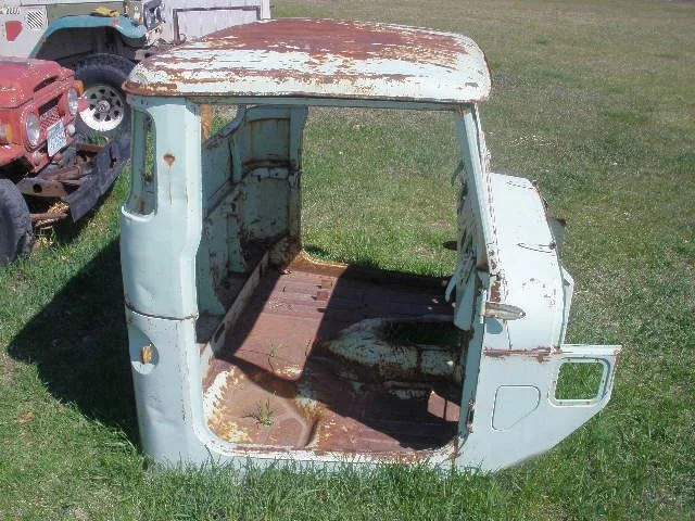

Picking up the project the 7th of August in Colorado.
Will gain me 3+ inches of legroom, and a removable top. Since I sold the 40 i miss a removable top. It also will give me the ability to complete the cab then bring the 45 home.
