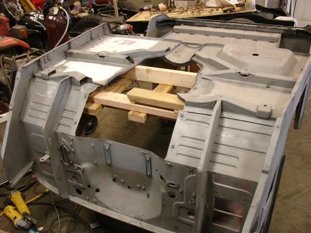

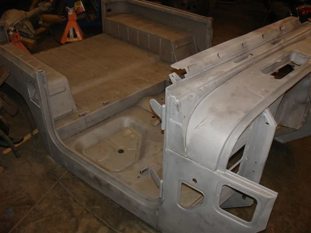

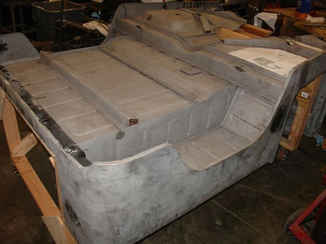

Here is the progression of the tub. Got it upside down on a mobile table I whipped up ready for degreaser, metal etch and por15

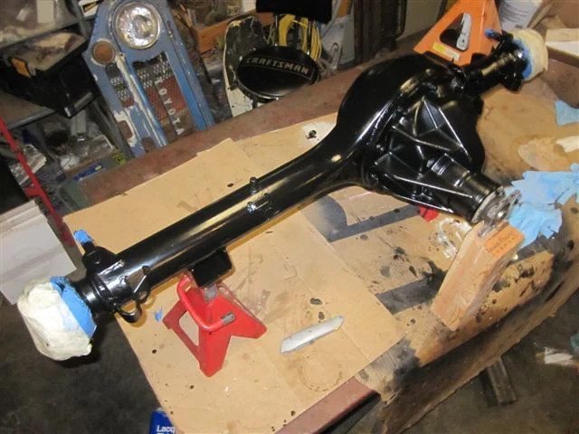

Here is the axle ready for POR 15.
I ground down all the welds, and cleaned all the welding spatter that was all over the axle ends. The old felt gasket had two holes in it that were caused by two weld spatters!! I hope this was not Toyota factory.

So, my plan on the axle is to POR 15 it, except for the ends that the knuckle go over.

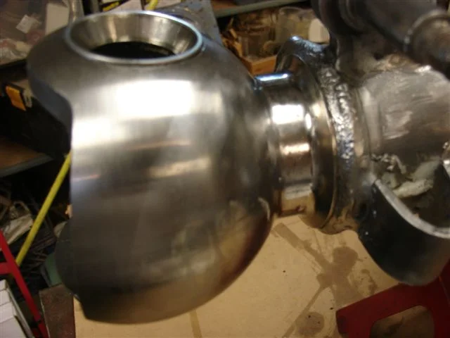

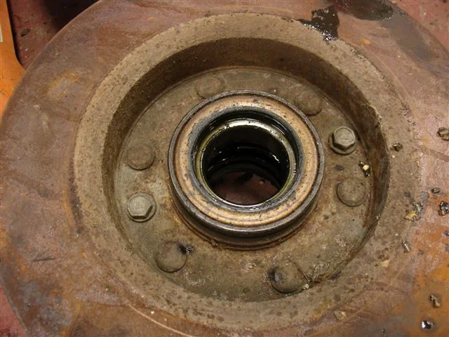

I don't know what to call it, but the do-hicky that has the seals (see pic) --- should I paint the outside of this part? I pressed off studs and removed the rotor....
Sure.. I've been known to paint em on the truck but if you have rotor off and no lockout on it then it is the perfect time to paint it.

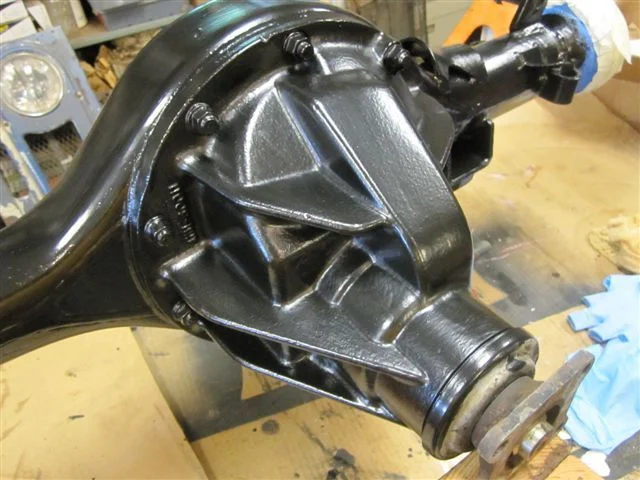

Anyway, did the big POR 15 party last couple days. Here is the axle.

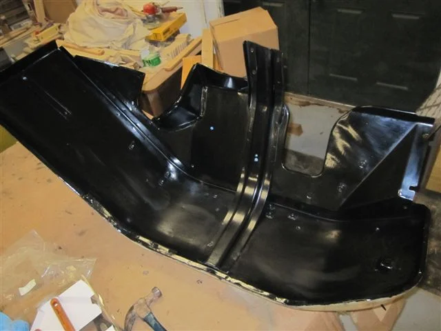

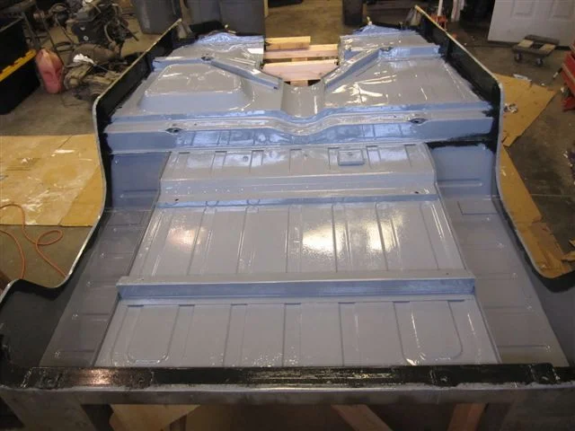

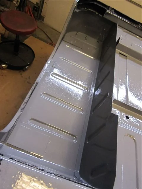

Here is the bottom of tub.
I decided to use POR15, instead of epoxy primer, as when I did the tub on the 75 last year, I found that spraying is very difficult under the fender lips and all the places that usually rust bad. So, with POR, I was able to paint all the diffcult places really good.
I had a can of grey that I needed to use, so I used it for most of the work, then came back with black in the edges. All of it will get black undercoat soon enough. Now, I am debating if I just go ahead and undercoat, or if I flip it over, prep it and spray epoxy first. My only concern is that when I did the marine clean and metal prep for the POR process, I had to get it all wet, so there is flash rust everywhere.... I was going to scuff it off, clean it and epoxy ASAP. Any thoughts?
