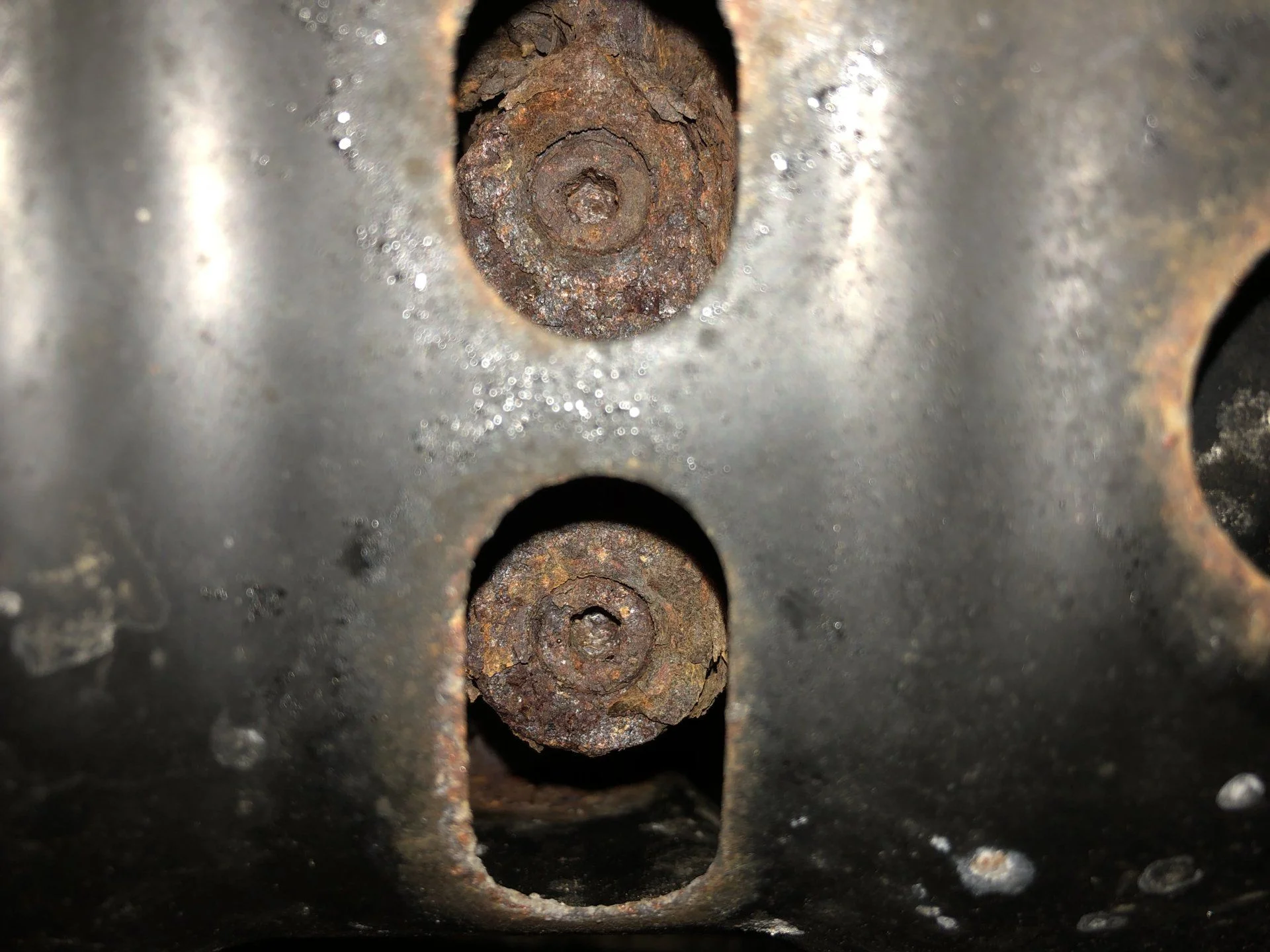

Mine only had 40K miles, and much less corrosion than that. If you decide to take a look at it, make sure to check the KDSS bleeder screws, search here about them. Take a 5 mm hex drive on a ratchet and some Rust Buster.

Just read this on the KDSS/side lean thread very helpful, again, thanks Markuson. I'll try to take a look today, if that guy allows me to crawl under....
"Murkuson is exactly correct. If you want to fix that lean park on a flat surface, reach up there with a 5mm hex drive and release those nuts 2.5-3 turns (NO MORE!!!) jump on the running boards and give it a good shake. Close the valves, done.
Since you're in RI, check for rust. If you're not sure post a picture here and we'll tell you how to proceed. don't try and brake them free with force if they're rusted."

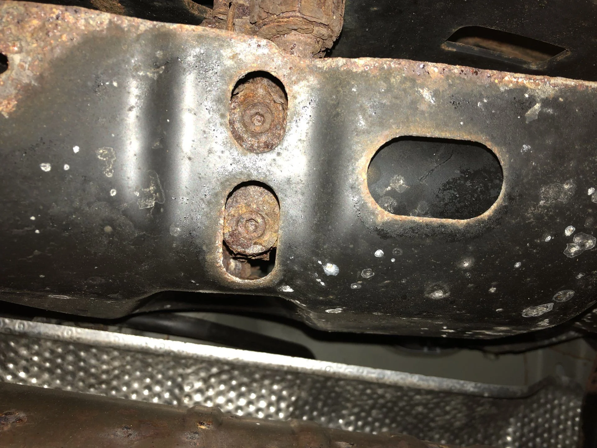

Just went under the truck, so glad I did it. The two screws, other bolts & be screws around that area (control arm connections?) all rusted into crumbles. I was able to brake the flakes. I doubt anyone can turn them. I’m gonna skip this time & aim at a newer GX460. I think the GX are built equally strong & to aircraft spec.

Ya, honestly the first words of my response SHOULD have been to check KadSS screws.
Agree.
That’s a deal breaker right there...
Glad you caught that.

The KDSS screws look pretty s***ty IMO. I would try to turn it at the dealer before u buy to see if it’s shut. If not, just wire brush, paint and u good.
