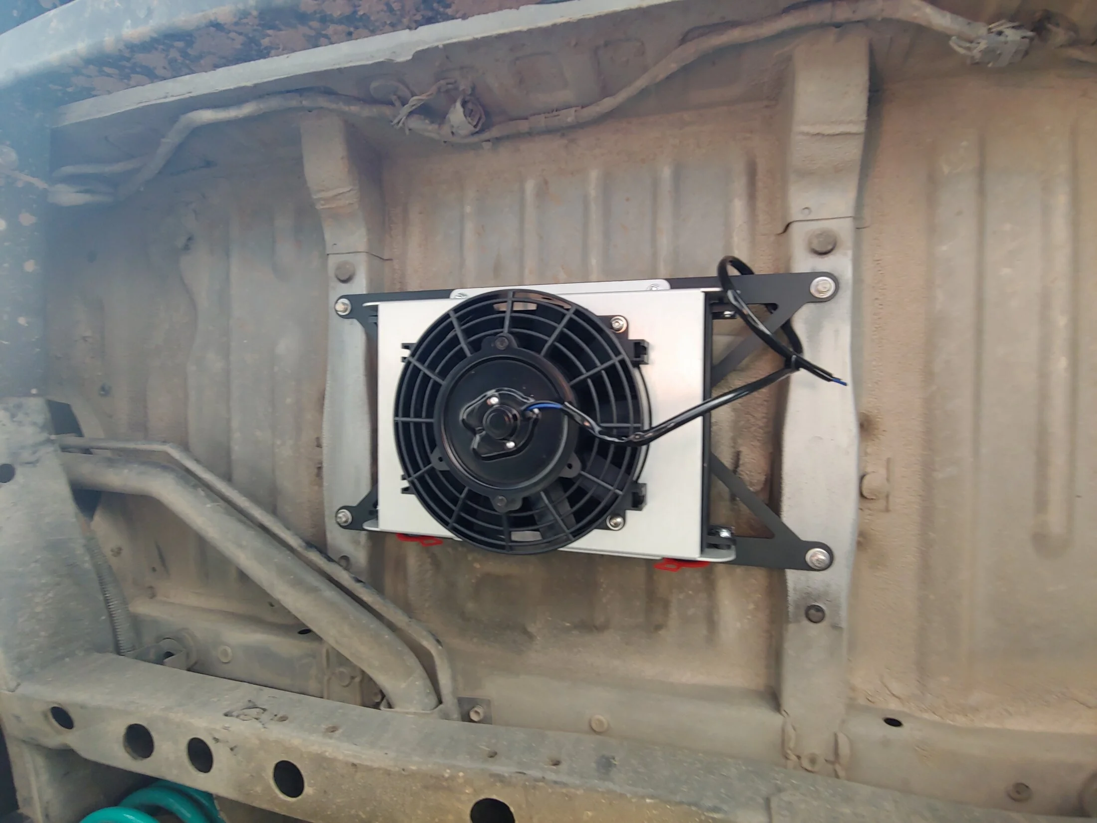

For that same reason why I installed an Aux tranny cooler fan. May not need it but it's for my peace of mind. And now getting my turbo installed hopefully my tranny will finally benefit from it.
For that same reason why I installed an Aux tranny cooler fan. May not need it but it's for my peace of mind. And now getting my turbo installed hopefully my tranny will finally benefit from it.View attachment 3786791
Older thread here, but can you tell me more about this trans cooler?
I installed this kit before knowing cruisers and Company was going to be selling them when I was prepping for their Turbo kit. @Cruisers and Co now sells them but its front mounted.
Mine was a derale kit for our 80 series by 99mfg. The kit was basically the mounting bracket but the Aux fan can be purchased just about anywhere....(Summit).
