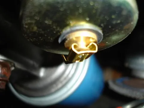

if anyone wants to keep the oem look, a long computer geek style flat screwdriver inserted in the stock plastic fitting (from the outside end) will flatten the little clip that holds the stock female spade connecter in, from there, you can cut off the oem female spade and crimp on your new aftermarket female spade. make sure the aftermarket spade has the small tab on the back that sticks up and slide old oem plastic fitting over it. voila. just like factory, only aftermarket. i even think i know a place that has new aftermarket plastic thingys if you want to make that aftermarket too.:D
Lostmarbles, in post #20 the terminal you show in the first picture is actually the correct OEM terminal. Notice the flat brass springy "tab" between the two sides that grip the sides of the post? That tab presses against the TOP of the post and aids in keeping the terminal from coming off. In old worn out connectors that tab has been mashed making the terminal loose.
Lostmarbles, in post #20 the terminal you show in the first picture is actually the correct OEM terminal. Notice the flat brass springy "tab" between the two sides that grip the sides of the post? That tab presses against the TOP of the post and aids in keeping the terminal from coming off. ...

So..... Here's a pic of the comparison between the correct terminal (on the left) and a 6.3mm spade:
(Note that the spade terminal on the right has been bent/deformed from my attempt at fitting it to my oil sender.)
And I retract everything positive I said about the fit of a spade terminal on the oil sender. As you can see, I bent a 6.3mm spade while trying to force it on:
And once I had forced it on the result was a loose and unreliable connection.
So now I really do dispute the claim here that a female spade will do the job! Because my experiment (now that I think I've finally done it right) suggests it makes a very unreliable connection.

you just used the wrong aftermarket spade connector. go back and find the correct aftermarket spade manufacturer and it will work just fine:flipoff2:
I was just thinking that too.
The term "spade connector" covers lots of different types.
And the right one for an oil sender is not the most common type you find in electronic shops. (At least it isn't in this part of the world).

Lostmarbles, the reason you are not having any luck with the particular spade terminal you chose, is threefold: One: the terminal shown is thin brass, two: it's not designed for the task, three: It's not insulated which allows the terminal "ears" to easily expand. The terminals others are using may be much heavier duty terminals (made from thicker material) therefore they fit tighter.
Toyota terminals (they came from two different manufacturers) are stamped from a thicker brass then most aftermarket terminals. They hold their shape better, but they too will eventually fatigue from multiple insertions. Modern terminals are actually rated for a surprisingly low number of insertions. (How many times do you actually unplug your heater switch for example?)
Bottom line is this, use the correct terminal whenever possible for the job and in an emergency use whatever is available.
