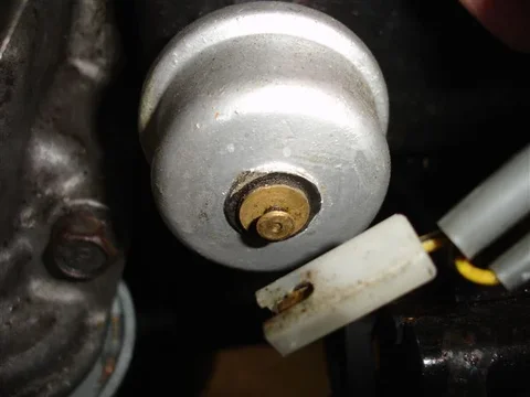

My clip has come off the wire for my oil pressure sending unit for the second time now. It doesn't look like I'll be able to make it work again. What have you all used as a replacement?

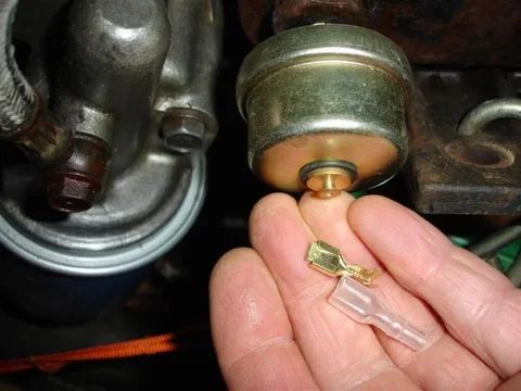

Regular ol' female spade connector...

A female spade wouldn't work on mine:
(Or at least I can't see how it would. But maybe petrol engines are different.)

slide it on from the side...
Those ol' female spade connectors swing both ways...

Female spades fit securely on male spades.

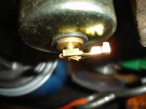

I agree a female spade connector will work, especially if you get the full insulated one and cut a slot in the insulator for the post on the sensor.

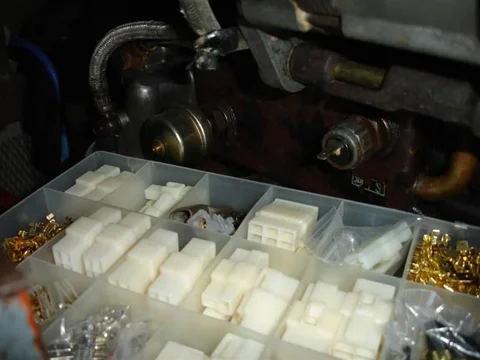

If you want the OEM style connector for the OEM look and with the weird terminal in a tinned brass version, which is "stiffer" (meaning it grips the post better) and more corrosion resistant than just a plain brass terminal, then there is another choice.
BTW these connectors are as tight as any young, well you get the idea... ;) :popcorn:

I have used the female spade as well. Very tight. Also on the brake master switches. :meh:

This morning (a few minutes ago) I went out to my spare engine and tried fitting a standard (6.3mm I think they are) female spade onto the oil sender.
Edit 14 Sept 2012 .... Unbenown to me I wasn't trying out a 6.3mm spade here but instead was trying the correct style of female fitting so this whole post is nonsense (and is best ignored). See post #26 for more details.
Sure enough (and as you guys promised) it fits quite tightly even though there's no "indent type of thing" to fix it in the best correct position.
(I could actually slide this virgin spade completely off the round-male-connector in either direction .. but of course this would be limited to one direction once a wire is soldered in and a plastic sleeve is fitted.)

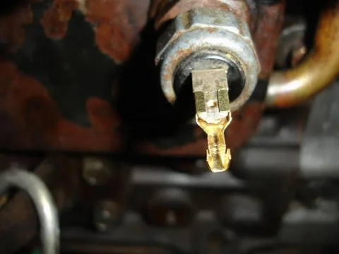

Edit 14 Sept 2012 - Again this whole post is nonsense too, because, while the plastic sleeve is indeed off a 6.3mm female spade terminal, the brass terminal in the pics is NOT a 6.3mm spade terminal. (Interesting that it fits a 6.3mm male spade terminal so well though.) See post #26.
You'd have to slit one side of the plastic sleeve as Mark/Coolerman says.
And the fit is certainly not as secure as on this nearby oil switch that my spare engine has (which has a matching male spade) where an indent tends to lock the pair in the act of full-thrust-coitis.
So while I've learnt here that you can successfully use a female spade I'd personally I'd still go for the proper connector that Mark/Coolerman sells.
