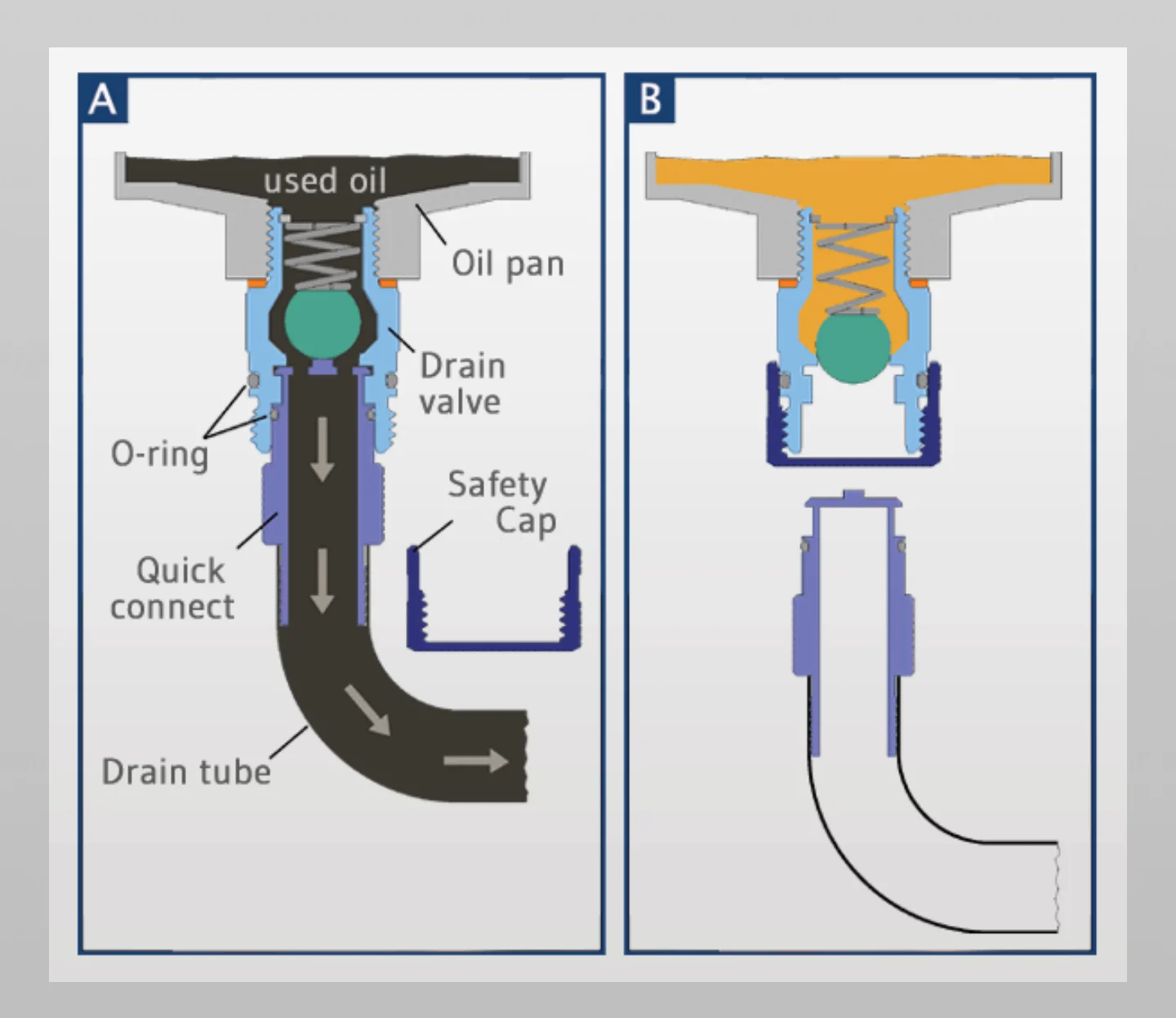

I'm confused. Is the Fumoto and the Jowett serving the same purpose? If I want to make my oil changes as easy as possible (never changed oil before, but I have done diffs/transfer case, trans drain/fill) what all will I need?
The Fumoto replaces the oil pan drain plug and is used to drain the oil from there.
There is a 2nd drain for the oil filter and the Jowett replaces the 2nd one so you want both.

The Stahlbus seems like another option if you aren't a fan of the Fumoto, but I only have Fumoto experience - all positive.
Came across this thread yesterday, and pulled the plug on one of these Fumoto FN133 oil drain plugs. Is the torque spec for the Fumoto, the 29 ft lbs like the original drain plug?

No. Per another thread at the moment the instructions say hand tight plus 1/8 turn.
