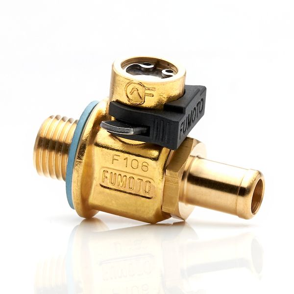

Are people buying the F-133S or F-133N Fumoto valve. Planning my first oil change on the 200, so haven’t been underneath to find out if the long nipple will pose any issue. the short nipple F-133S valves are out of stock.
See post #150 to see how the short version works, with the nifty hose kit. Not sure if the long one would be a problem, if you are still using the stock plastic cover.
Thanks! It looks like the long nipple should work (and what @terrapin purchased). Since the short isn’t in stock, I’ll give the long one a shot. 🤞
There is lots of room there for the long one, and the hose will stay on better with the long one. (filter drain)
The oil drain I put the 90 degree one, as then it is easier to put the hose on with the skip plate. On the oil plug one I would not put the straight one and would get the 90.

I use the F133n. There is still enough clearance, that I didnt need to remove the cover plate on the skid. I was able to reach up from the side, remove the clip, pop on the hose and open the valve easily. In fact, I have an extra if anyone needs it. Ordered two by mistake.

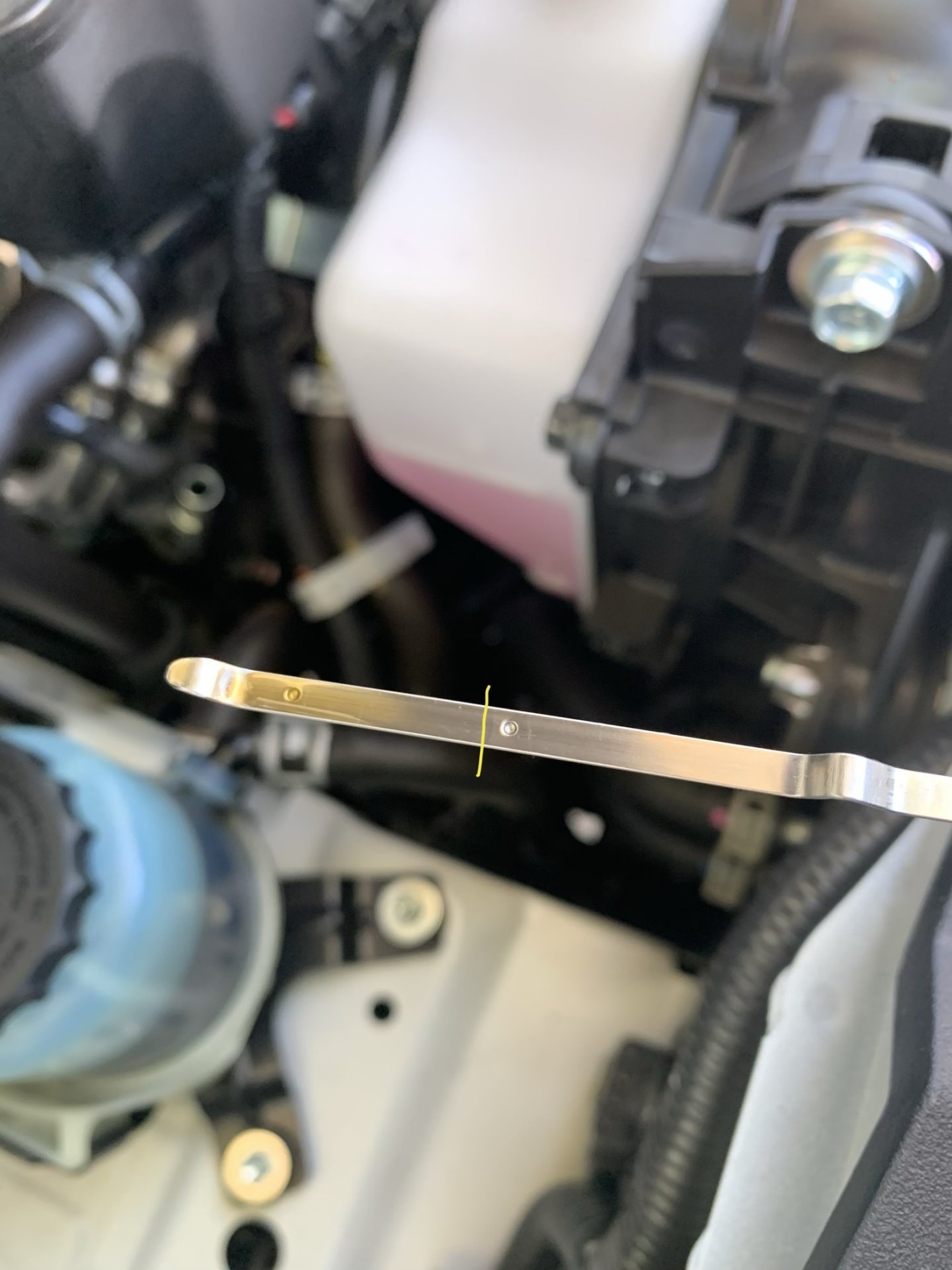

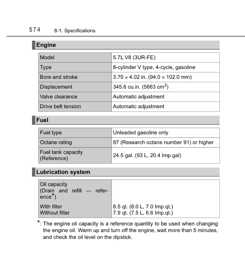

How much oil are y’all putting in the ‘18+ to get near the fill line?
I put in 8 qts, plus I always “pre-fill” the cartridge filter with maybe 0.25 qts. So all in, I’m just a bit below the 8.5 qts specified.
Looking for some other baselines, as the 0W20 is :censor: hard to read on the stick, but appears slightly high. Next time I will try total of 8 qts.
Since I’m OCD about things, I drained 1/3 qt (11oz). Looks good now, just below the full line. Seems total 8 qts is about right.

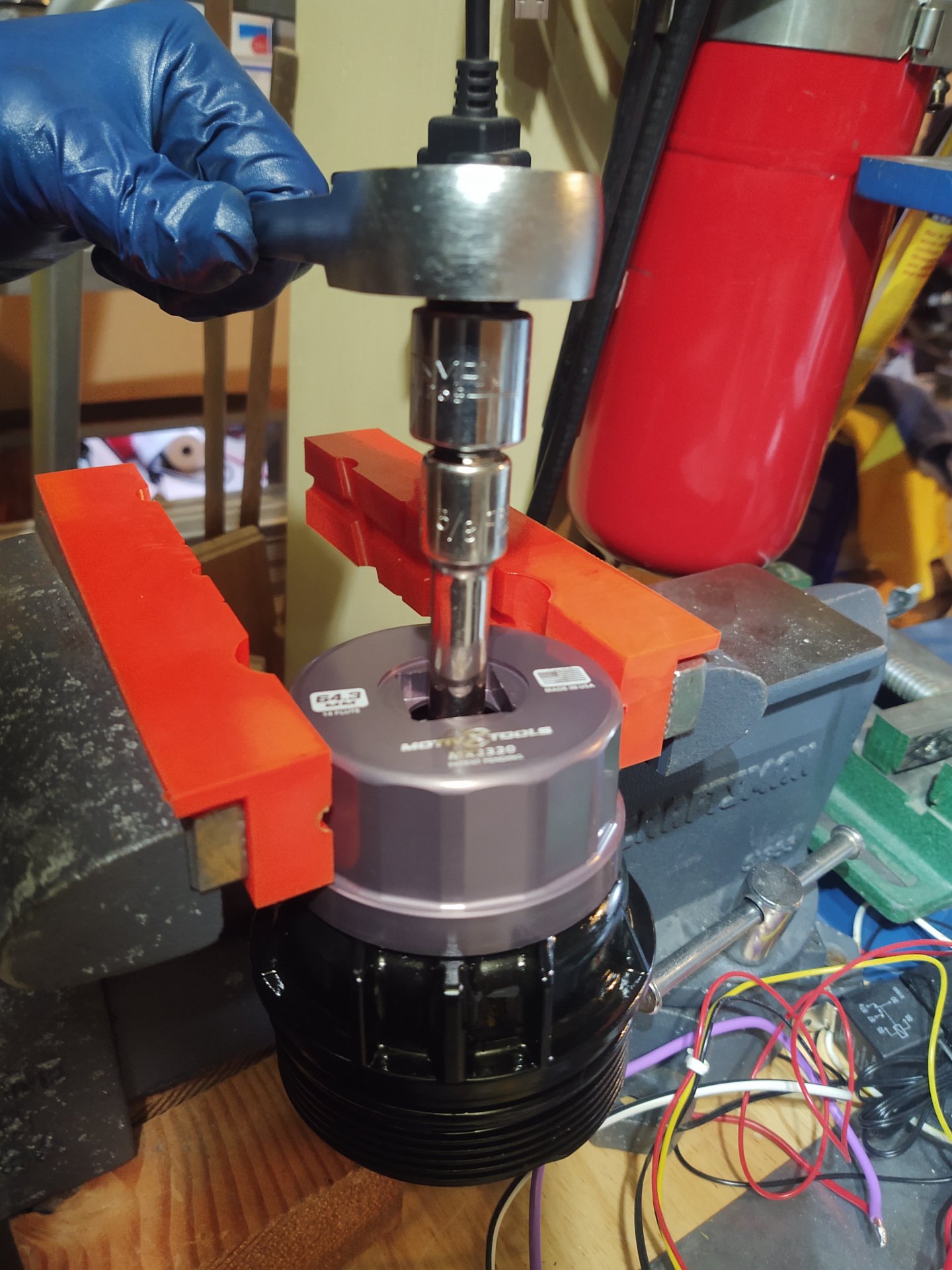

The cap was damaged but still functional on my truck. The plug was stuck and so I had to get creative as I needed to move it to the new aluminum cap (it does not come with the cap). Lucky I had this Motivx oil filter wrench from amazon so I could remove the red nut (see pic on amazon) and have access to the plug while the filter was in the wrench and the wrench was in a wise.
